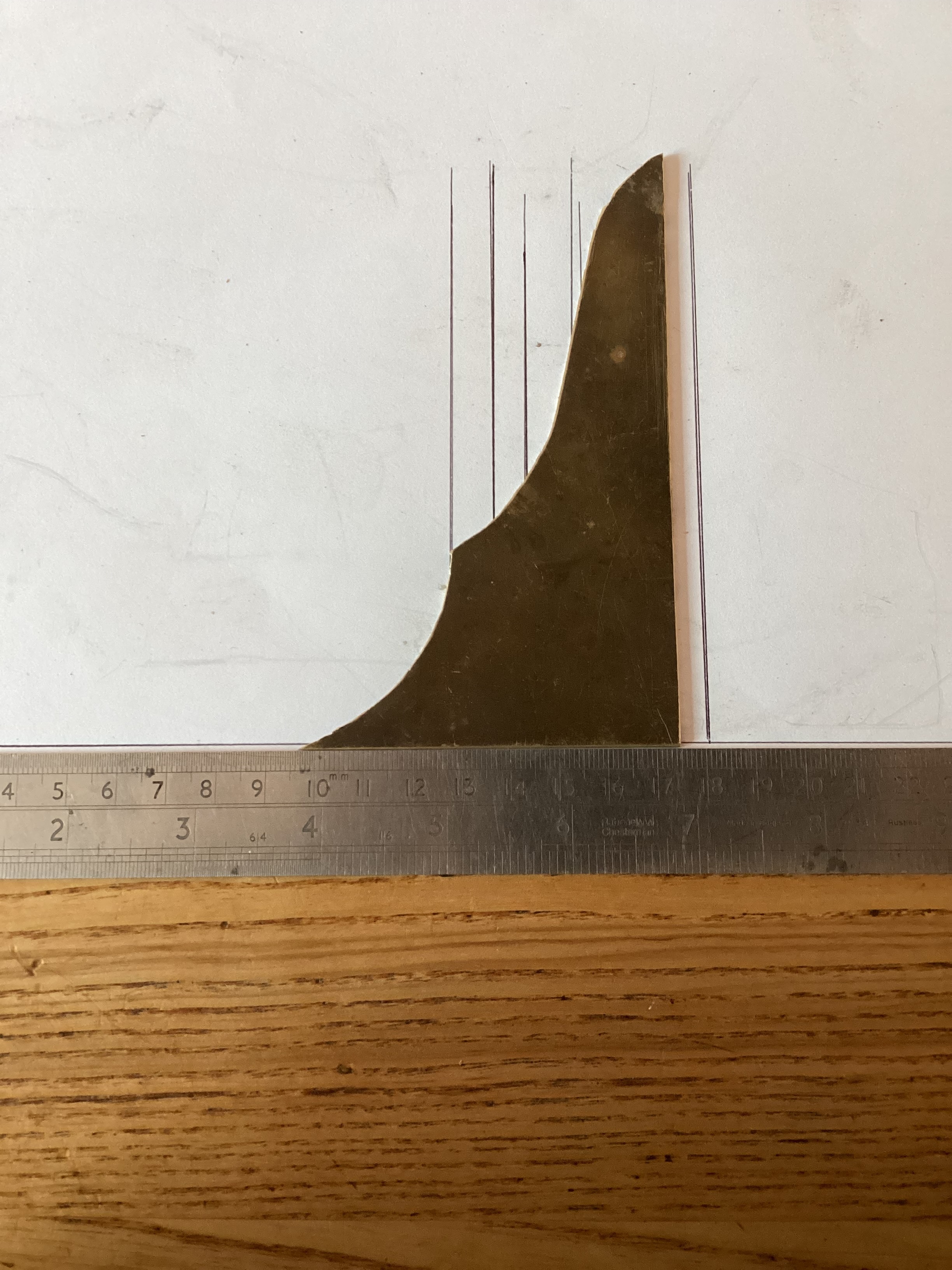

Attachment 49432
This is an offcut. The corner was almost square to start with. The curve IMO is attractive, so rather than put it in the scrap bin, a little bit of filing and testing makes a homemade tool. You probably know that if you flip a square over against a straight edge, the error is doubled.
