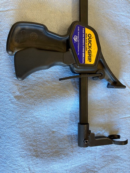

Started with a Quick-Grip 6" Mini bar clamp, some tubing and some flat stock.

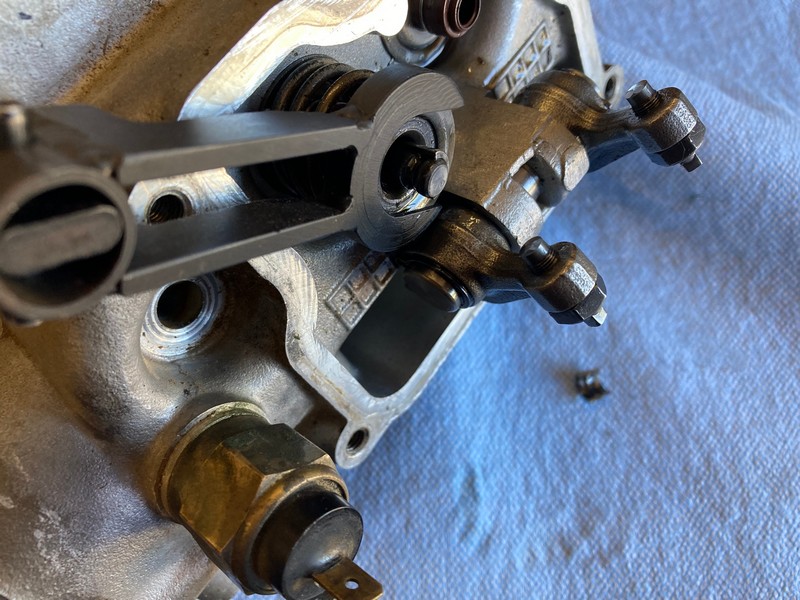

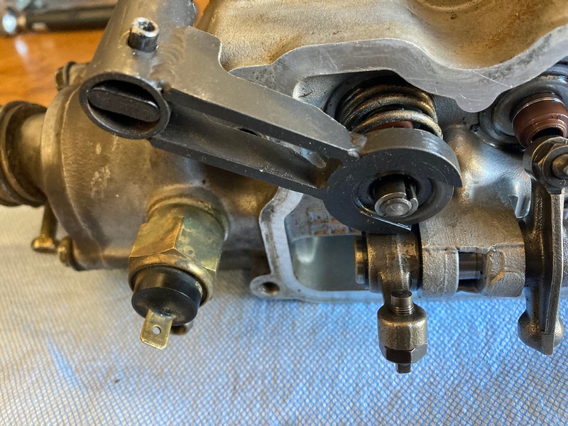

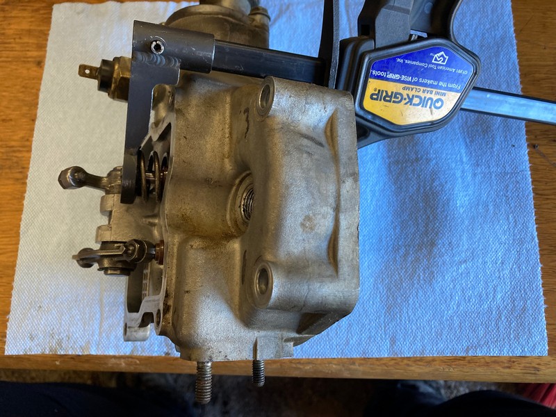

The Quick-Grip has plenty of force to compress the spring(s), then it's just a matter of not losing the keepers.
A magnet was held nearby to catch the little buggers.

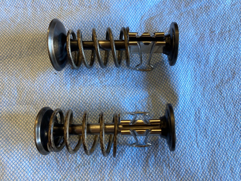

While waiting on parts for assembly, I kept the valve, valve spring, spring cap & keepers together by clamping a binder clip on the valve stem with the other parts in place.
The idea should work for other engine heads that have the valves in them. A regular 6" QG clamp would have more force for bigger springs and more depth to clear the head if they are larger than what I show.
