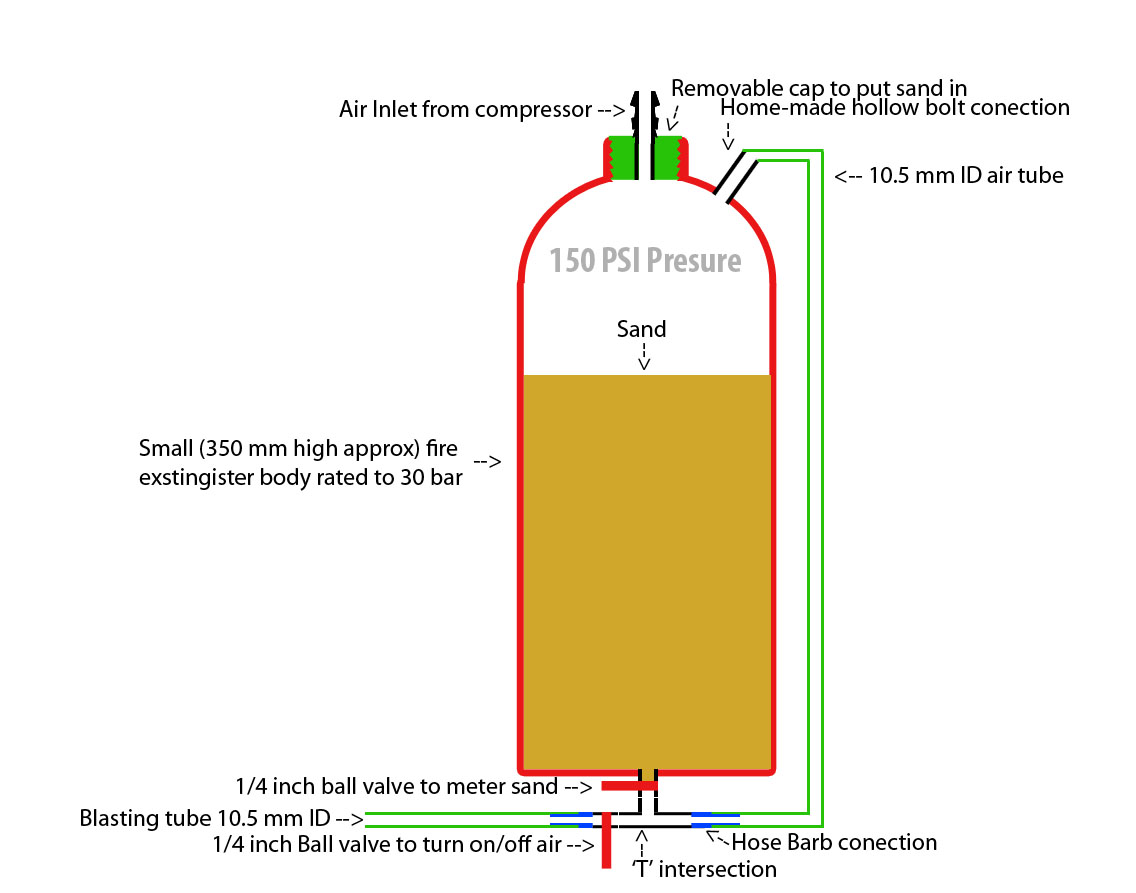

Hello everyone, new to this forum.
I decided to make a sand blaster a few days ago and fiddled all day trying to make a siphon and gravity fed sand blaster... i concluded they are too annoying to make and wont ever be as good as a pressure pot type sand blaster.
So now i decided to make a type of hybrid... a small pressure pot that is constantly being refilled from our main big compressor. have a look at the image i quickly made to explain.
Attachment 4157
(click it so you can read it)
Do you think it will work?
Thanks!
