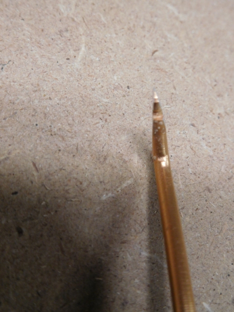

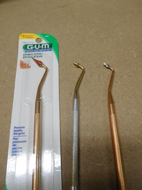

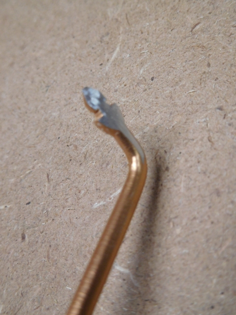

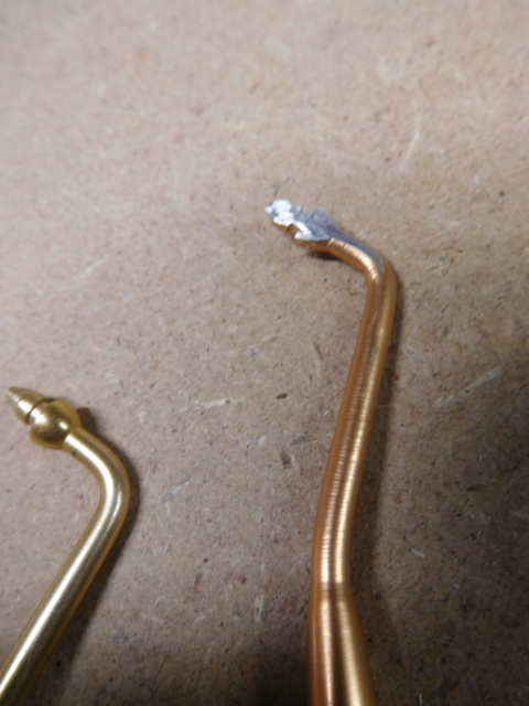

    Got a new dental tip. What to do with the old one? I filed the point and made a marking knife for small spaces. It's aluminum and not as hard as steel but it does leave a mark. Give it a few strokes with a file to resharpen.

    An aluminum marking tool doesn't seem ideal given the softness of that metal. Would it be possible to drill a small hole into the handle and epoxy into it a bit of music wire? Still not ideal but certainly more durable than aluminum.
    An excellent choice for this application and other marking tools you might build in the future would be phonograph needles, as originally used in the old Victrolas. Believe it or not, they're still sold...
    https://www.amazon.com/Phonograph-Ne...ograph+needles
    and are very inexpensive.
    I built a beam compass...
    http://www.homemadetools.net/forum/t...-verburg-27353
    and used a phonograph needle for the pivot. Not exactly a marking application but it's stayed sharp despite the tool having been repeatedly used to draw arcs on metal.
    Regards, Marv
