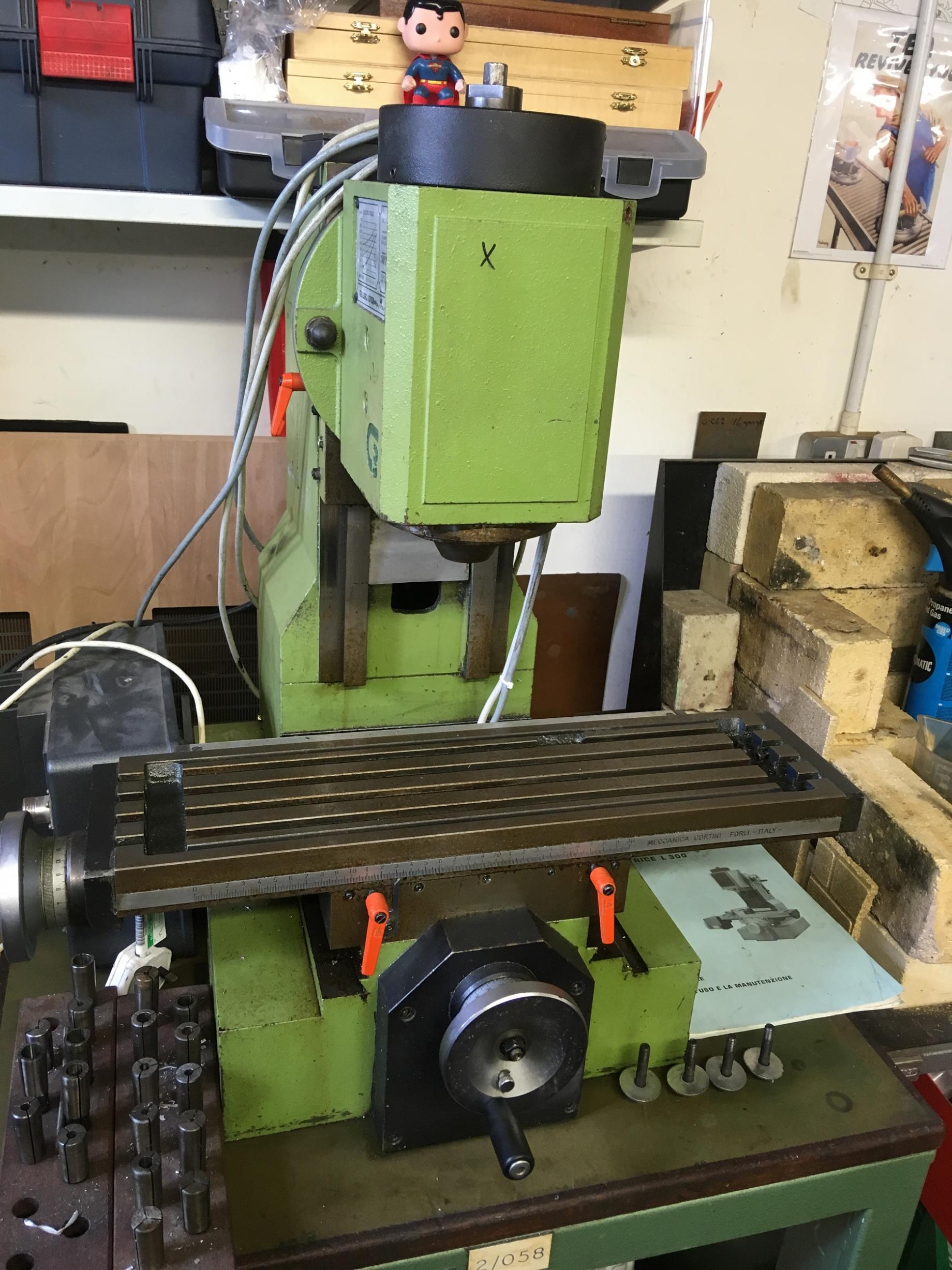

Hi All
This is a photo of the machine I am looking to convert to CNC. This was bought as scrap as the company wanted it gone quickly. Right place right time so lucky to get it.
Attachment 23392
