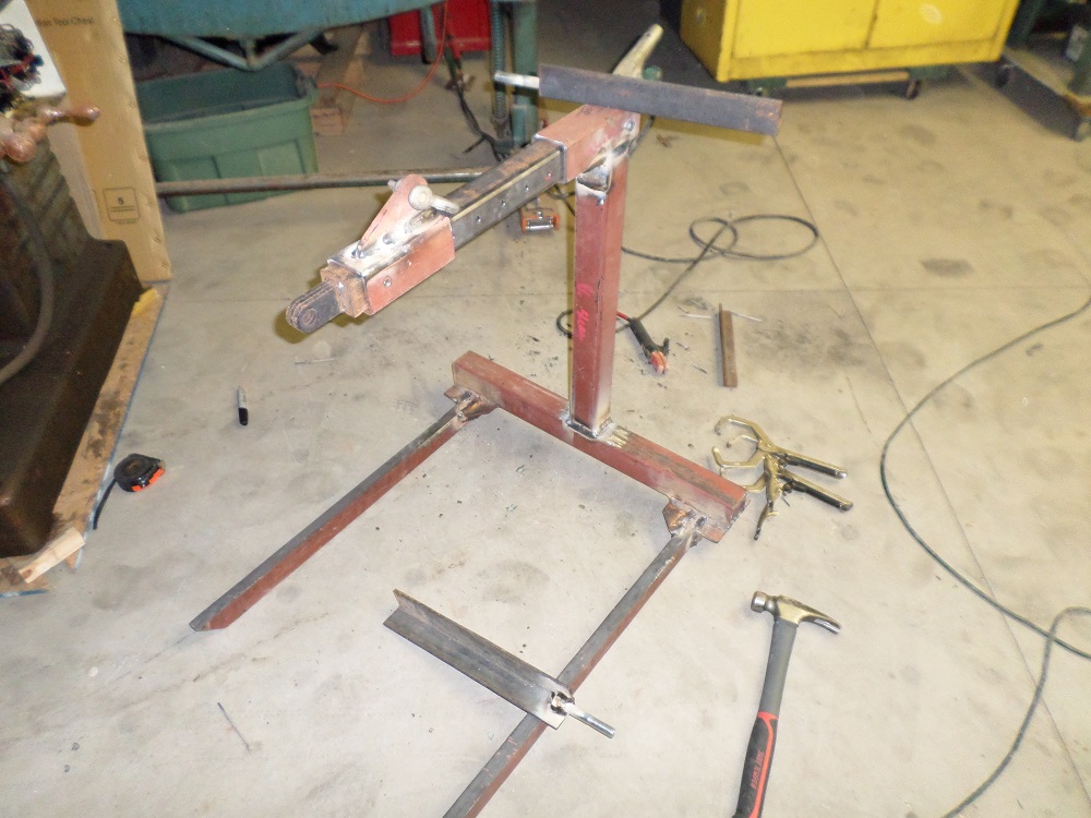

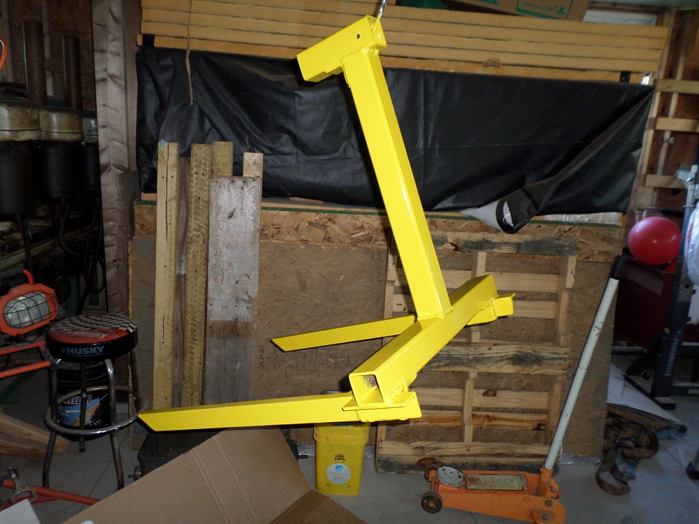

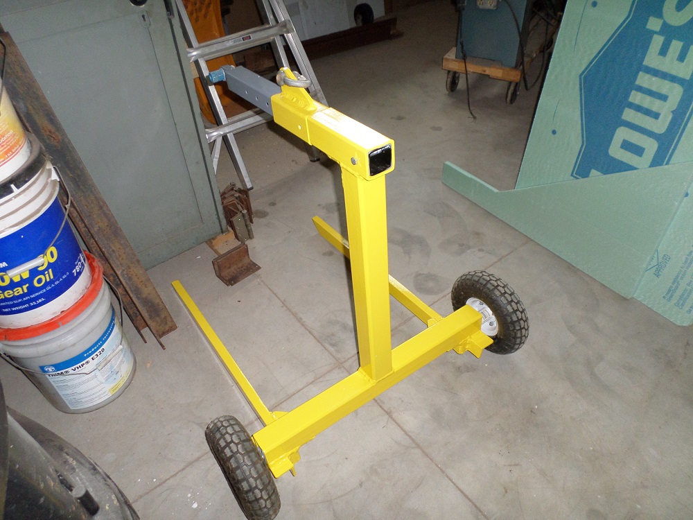

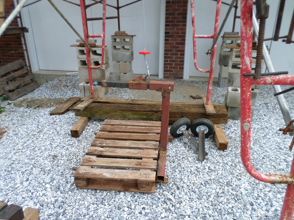

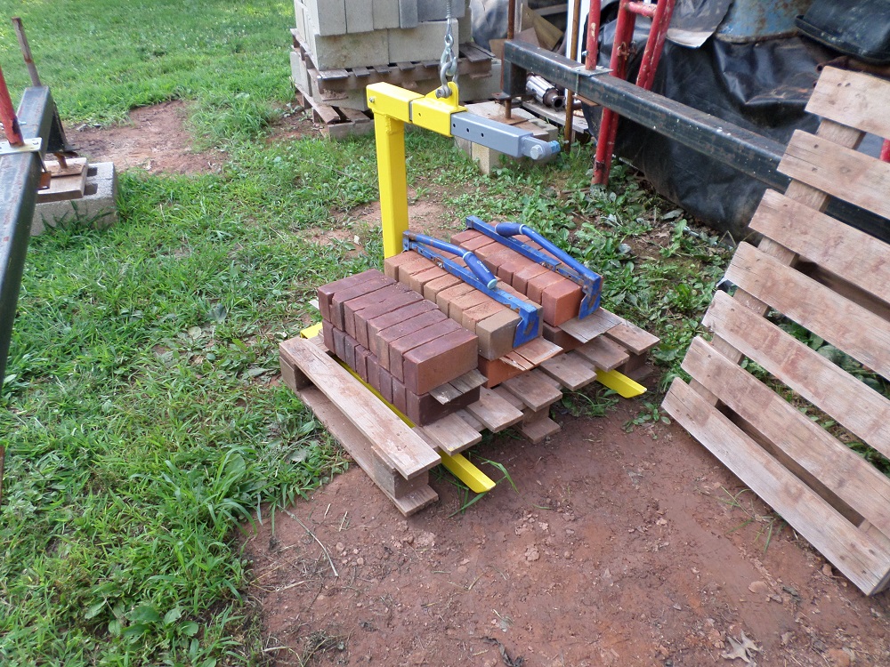

I thought I would do a detailed post about the construction of the pallet lifter that I use with the scaffold crane.
http://www.homemadetools.net/forum/s...-lifting-65547
I needed a small pallet lifter with about 100lbs or less capacity. I looked around at my material stock, worked up a basic design and then did some cursory number crunching.
I came up with the following....

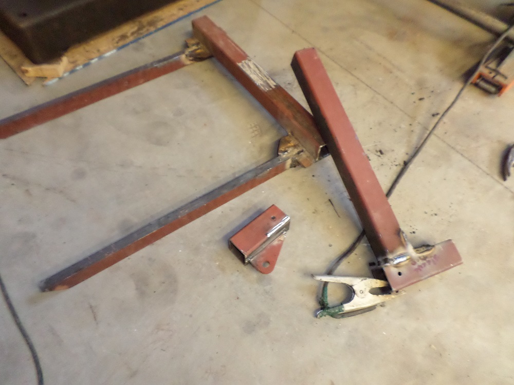

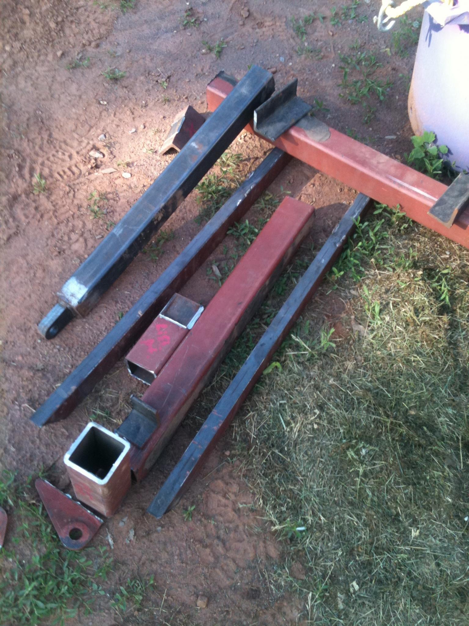

Here is the steel bar and tube cut out.
Attachment 21237

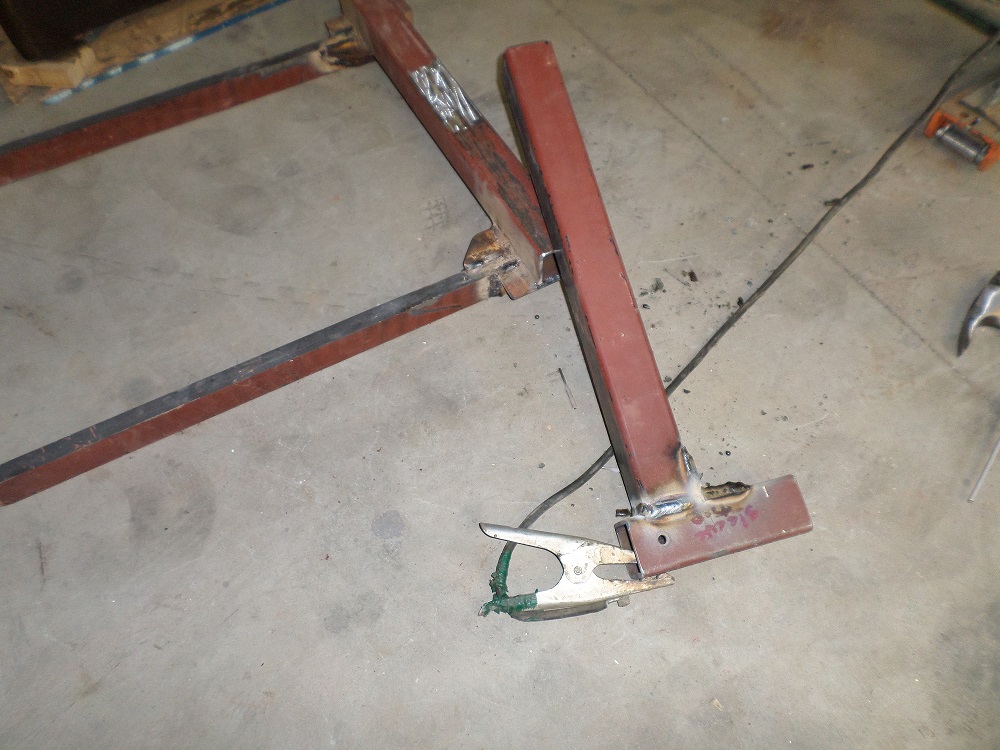

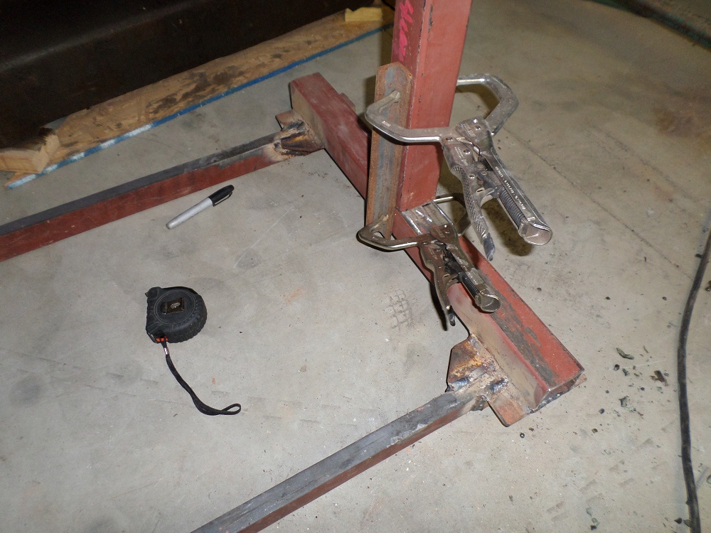

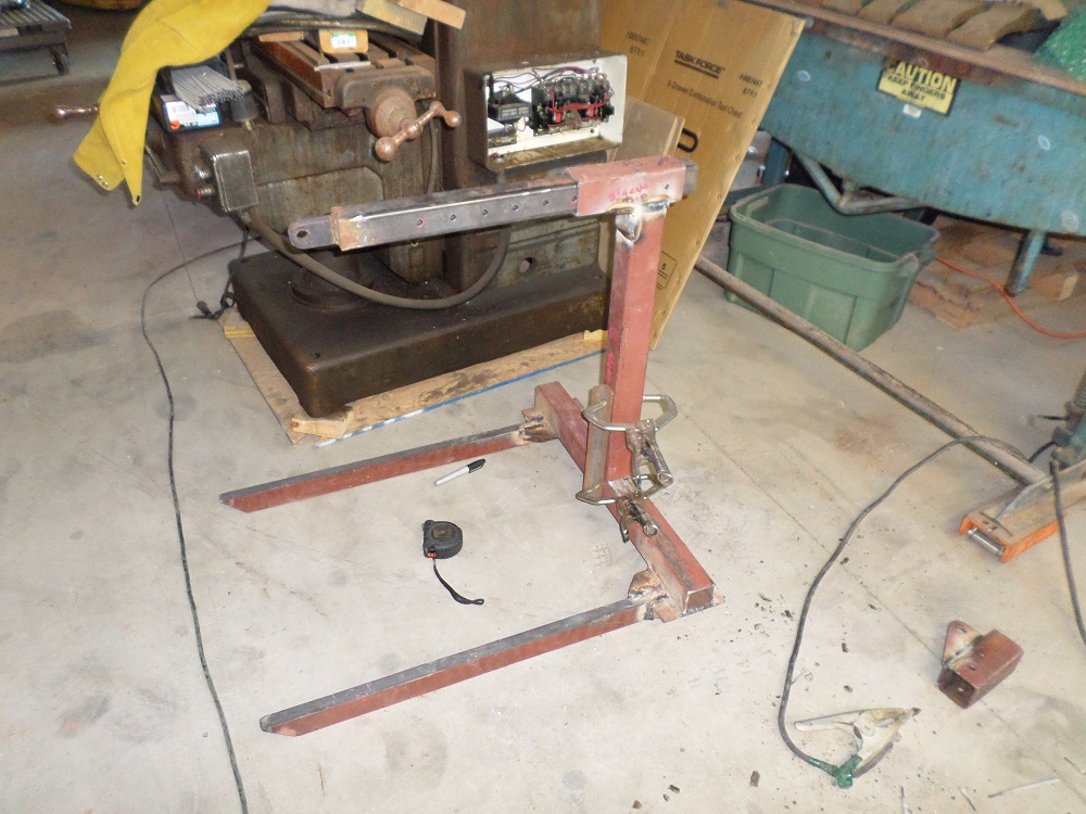

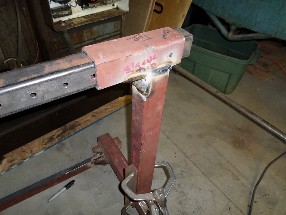

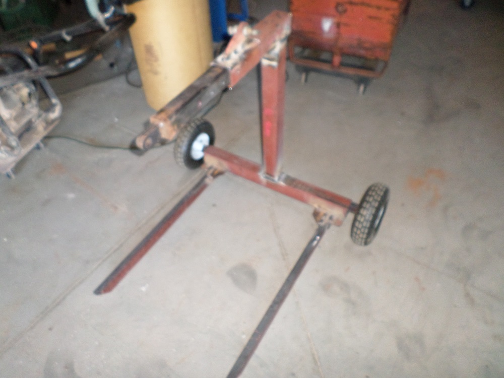

Then I started welding things together.
Attachment 21238
Attachment 21239
Attachment 21240
Attachment 21241
Attachment 21242
