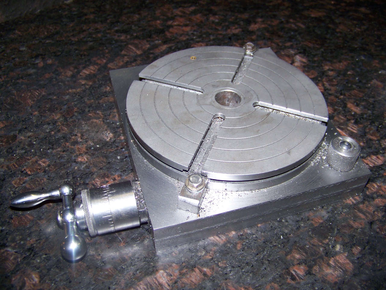

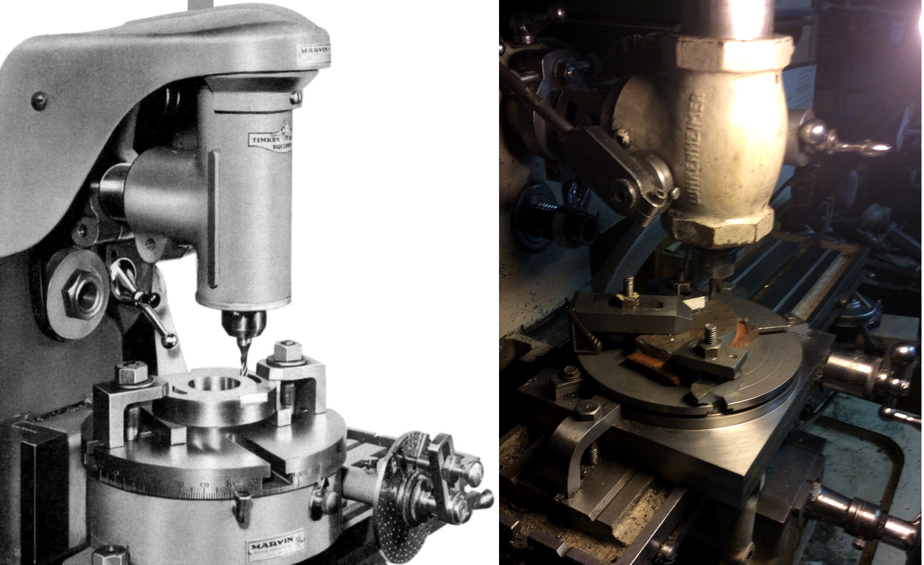

This is a rotary table I made to use on my small Atlas horizontal mill. It’s a one-third size imitation of an old Bridgeport accessory but uses steel plate and a plain bearing instead of castings and roller bearings.
Like the Bridgeport it’s very low compared to its diameter, and like it, and I think old South Bends it pivots the worm to rotate the table freely. A pair of clamps lock the table in place and can be set to drag a little for milling things like grooves.
It’s about 6-1/4” square and 1-9/16” high. The table is 5-1/2” diameter with four 5/16” slots for standard 1/4” t-slot nuts. The worm drive is 90:1, with a zero-adjustable dial marked in 0.1 degree increments.
The body and hub are mild steel, but the table is from some harder scrap. The spindle is turned down from an old Morse taper adapter, and the main bearing and worm gear are bronze.
Attachment 30587 Attachment 30588

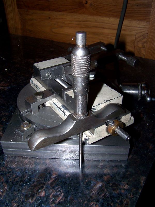

Side view, and comparison with the Marvin rotary table marketed for use with Atlas mills
Attachment 30589 Attachment 30590

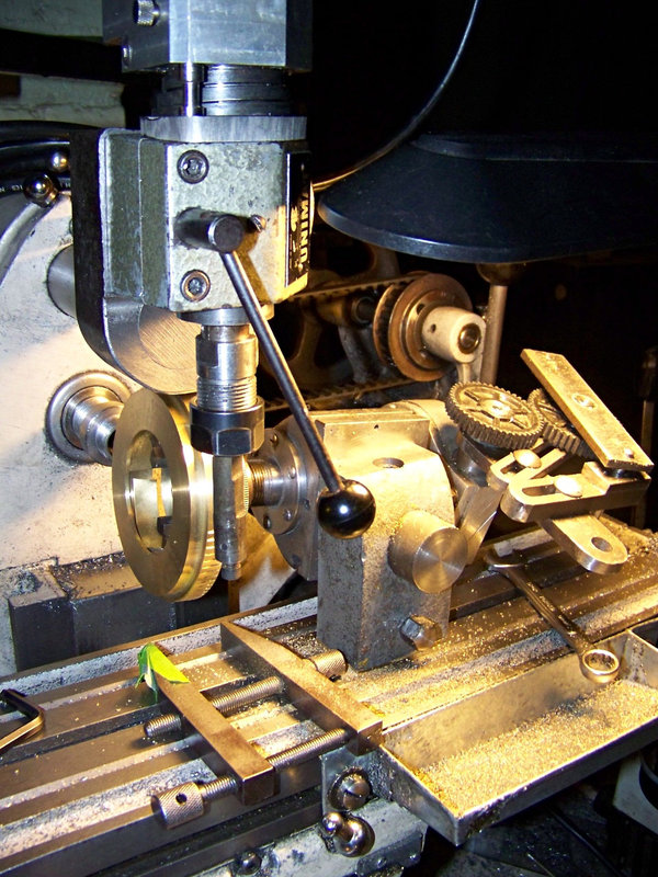

With my 2” vise, and gashing the worm gear

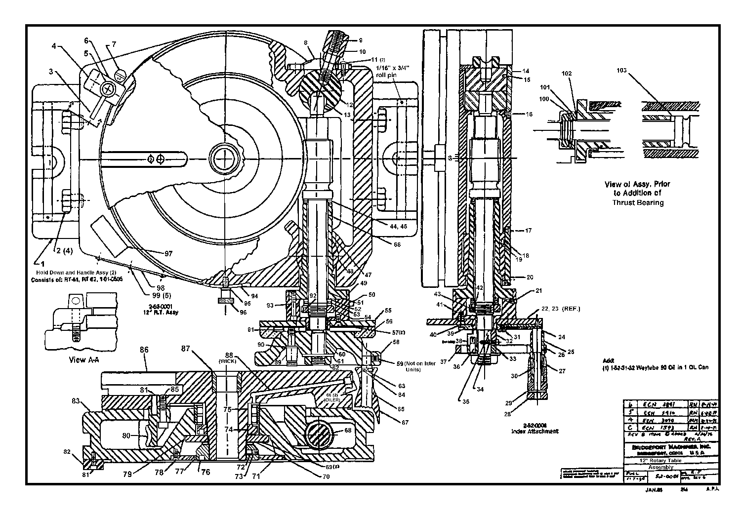

The 5-1/2” rotary table sold by them is 1-7/8” tall but isn’t geared. The 6-1/4” Marvin table is 2-5/8” tall and geared, but looks like it’s not enclosed. Both now seem to sell for prices more like collectibles than tools.

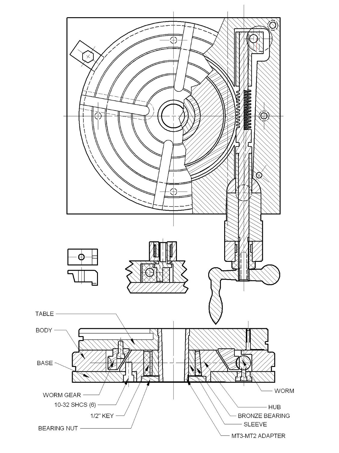

So I rummaged through my scrap and looked at pictures of different designs for something compact that resembled the pieces I had, I think 5/8” and 5/16” plate.
The Bridgeport seems to be very well thought out, and I’m sure I overlooked many details.
That sketch is pretty much all I drew, except for screw positions, though some things aren’t clear in it. The worm releasing shaft can be adjusted in the center of the knurled knob to set how it meshes when the knob is turned to engage it. The bearing hub is made from a discarded shaft coupler, and is bored with a taper so the bearing which is keyed to it and slotted like a collet can be adjusted by pushing it farther in with screws like on some old lathes.
The feed handle, and the design of the bent spring friction dial are from mini lathe parts.
