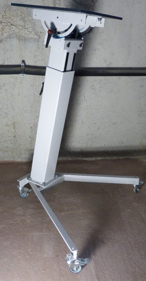

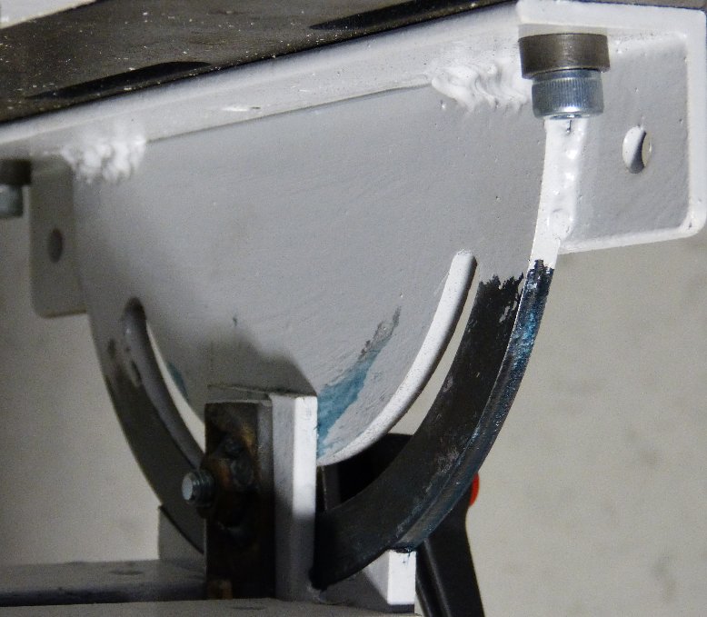

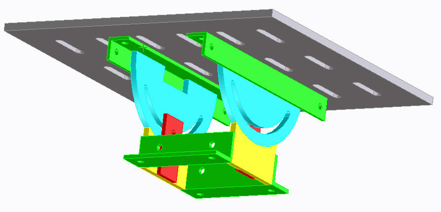

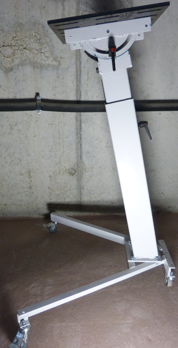

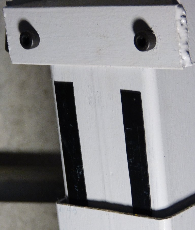

A few months ago I design and built a small swivel welding table.
As I had not a lot of room that time I choose a rotating design over an ajustable foot :
Attachment 12307

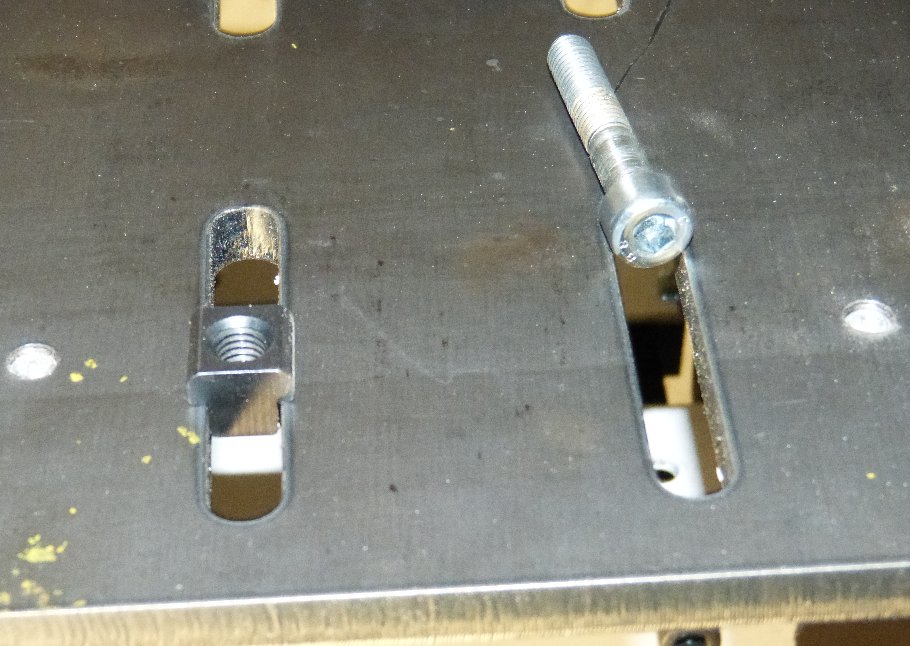

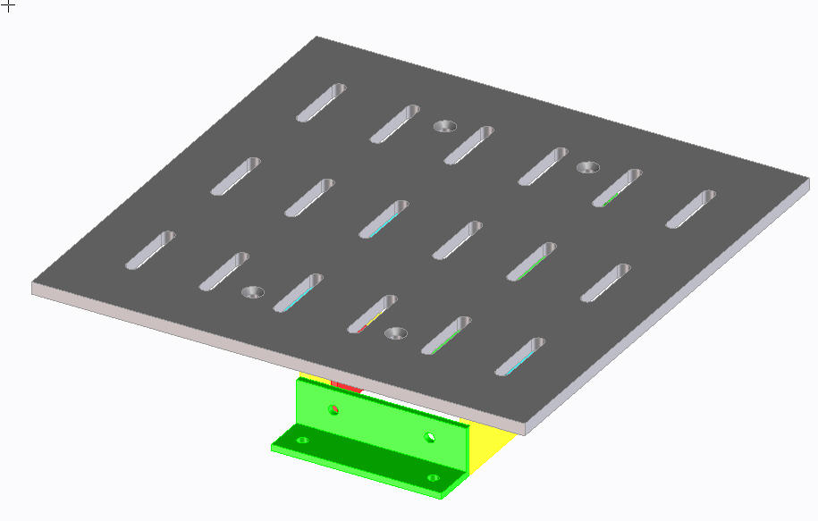

To fix easily pieces to weld I choose to use a table with oval-shaped holes with the right size of T nuts for mill :
Attachment 12308
I bought a laser cut steel plate (10 mm thickness), the circular hole plates was laser cutted too.
