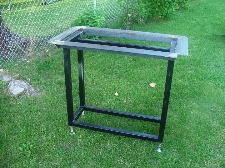

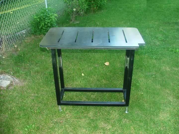

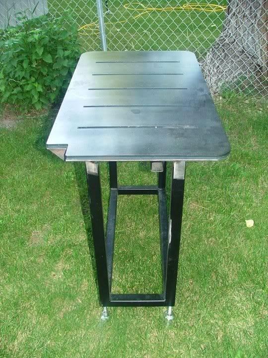

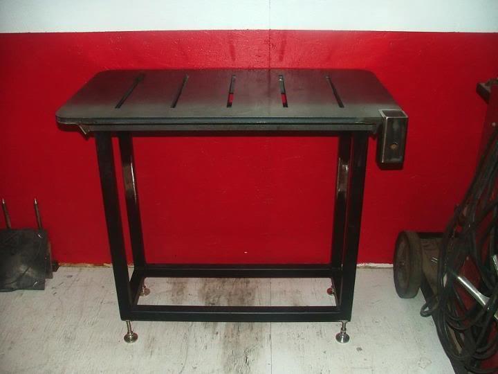

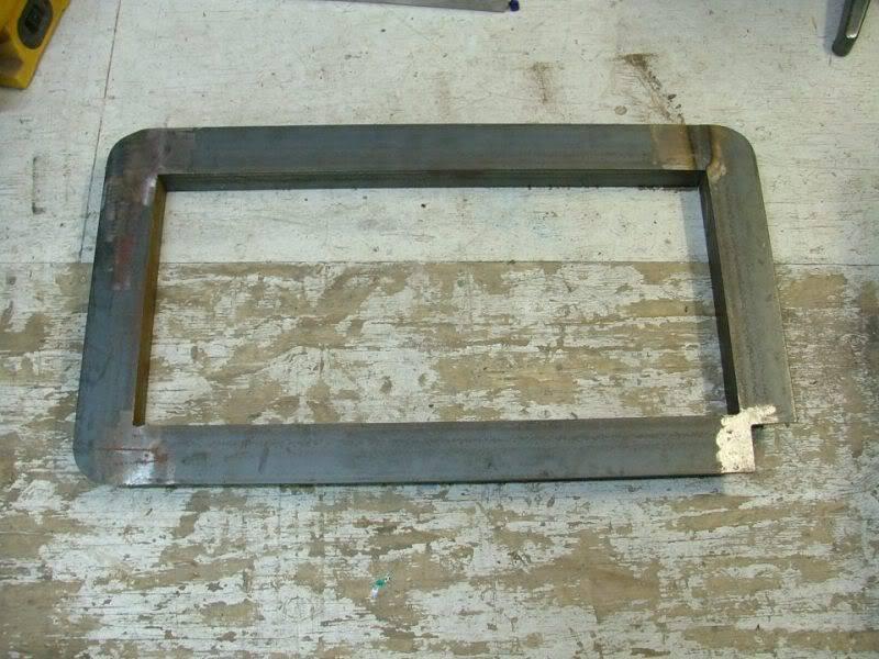

I'm new to this forum but thought I would share with you my take on a small welding / fabrication table. For the most part I'll let the pictures explain everything. Here they are:

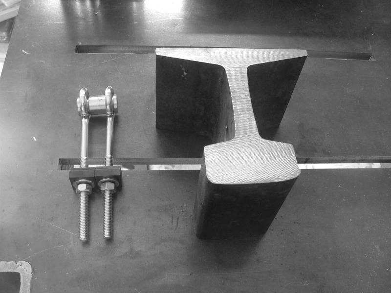

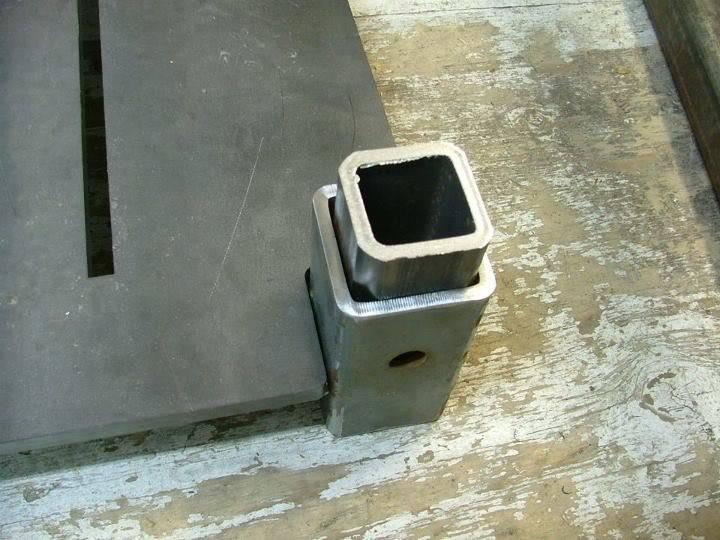

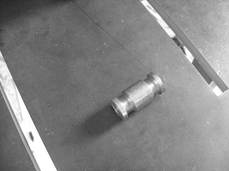

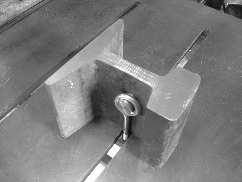

The table top is laser cut from 1/2" thic plate and the slots are 1/2" thick to accept 1/2" T-nuts.
