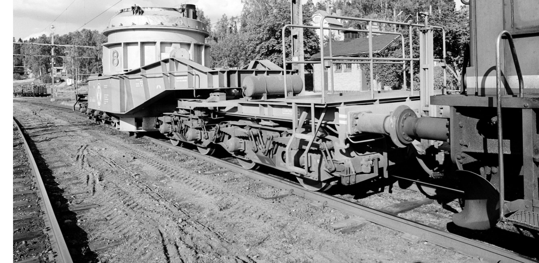

Attachment 38920
From https://sv.wikipedia.org/wiki/Sp%C3%...stransporterna
"The Melt", as the 600 ton cargo train was nicked:

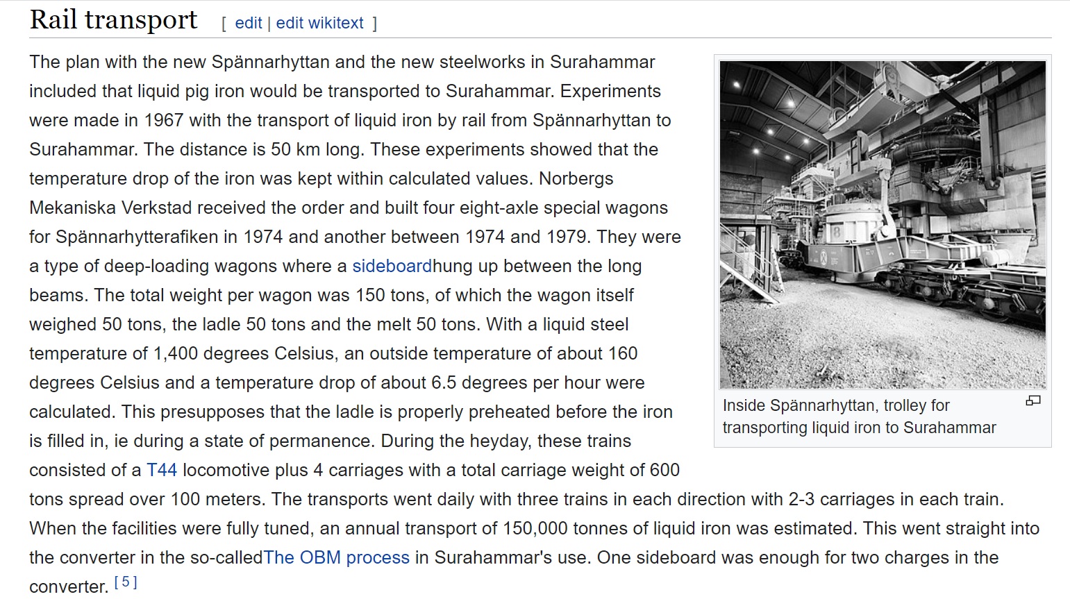

Attachment 38921
Pic: Roger Lundberg, from https://www.flickr.com/photos/gamla_...n/photostream/

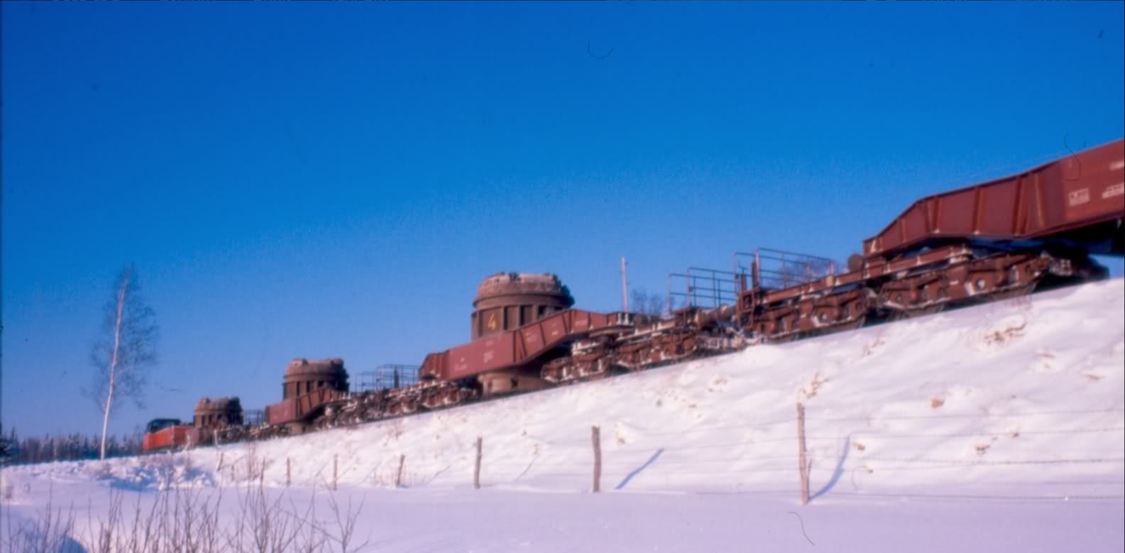

Attachment 38922
From: https://digitaltmuseum.se/0210180776.../media?slide=0
