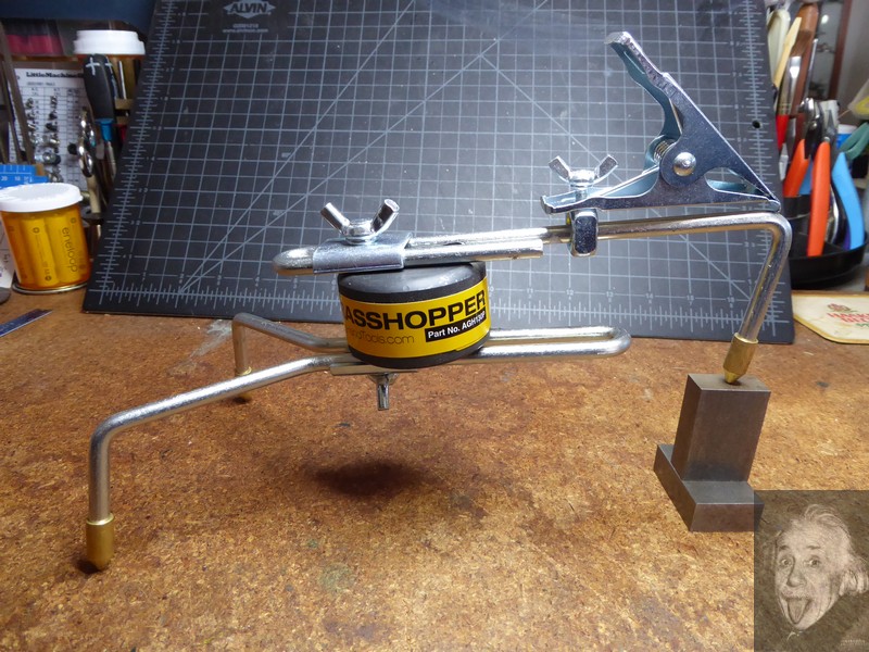

My welder's Grasshopper (TM) third hand tool works well for silver soldering (I'm not a weldor)...
Attachment 39589
but is way too heavy for more delicate work, especially thin wood used in modelmaking. What I needed was a really lightweight finger that was adjustable in both attitude and pressure applied.

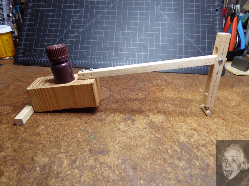

So I dug around in my scraps of brown stuff and came up with this monstrosity...
Attachment 39590

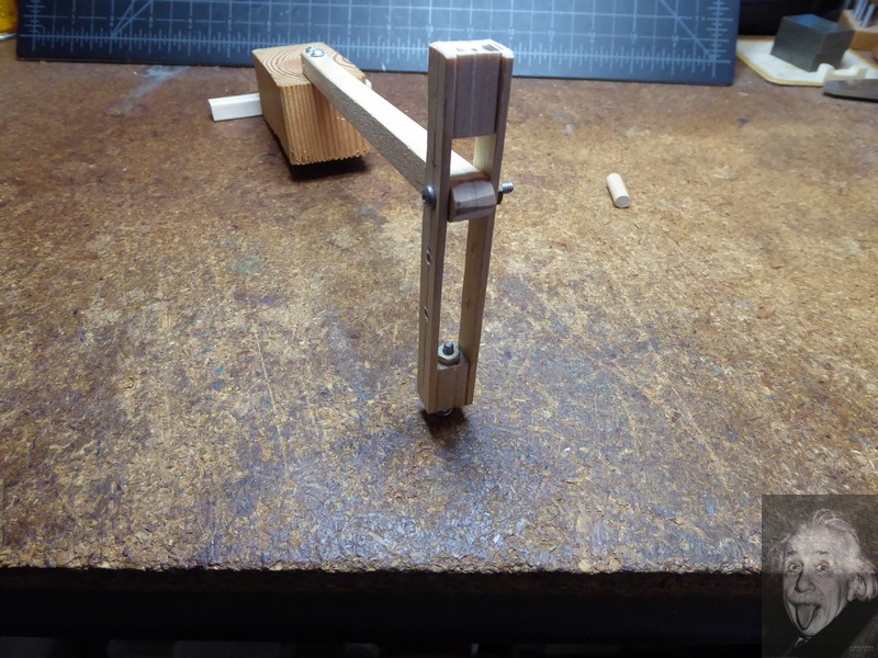

The body is a 2 x 4 cutoff and the "finger" is made of popsicle sticks with spacers cut from the length of 3/8 x 3/8" that forms the "forearm" and the "outrigger" that prevents tipovers. The body...

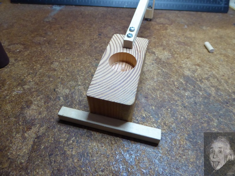

Attachment 39591
has a 1" blind hole that can be filled with washers to provide more finger pressure. The hole can also hold a small plastic bottle partially filled with bird shot (see second picture) for more precise pressure control than I'll ever need.
This photo...
Attachment 39592
shows the finger. Three adjustable height positions (more are easily obtainable with a 3 mm drill) and an axial hole through the "fingertip" that has a 4-40 bolt to allow various future attachments. (A spreader bar and a V-block for cylinders will probably be the first to be made.)
