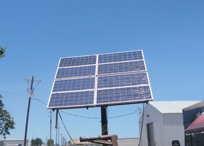

    Sure makes my little 1100 watt array look infantile
