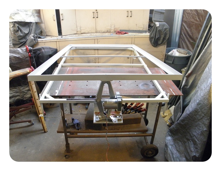

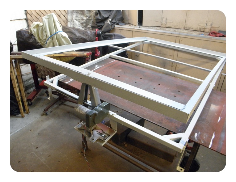

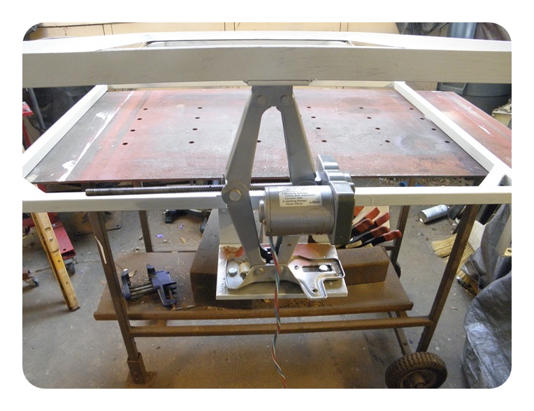

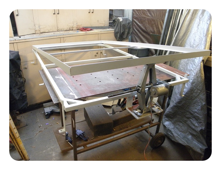

Solar Panel motorized roof mount hinged frame. Made from angle steel, square tubing,1 inch bar feet and 1- 12 volt motorized scissors jack, 2 hinges. This is a 3x5 foot solar panel roof mount 250 watts or 8.321 amps.
it will charge my RV battery's .
