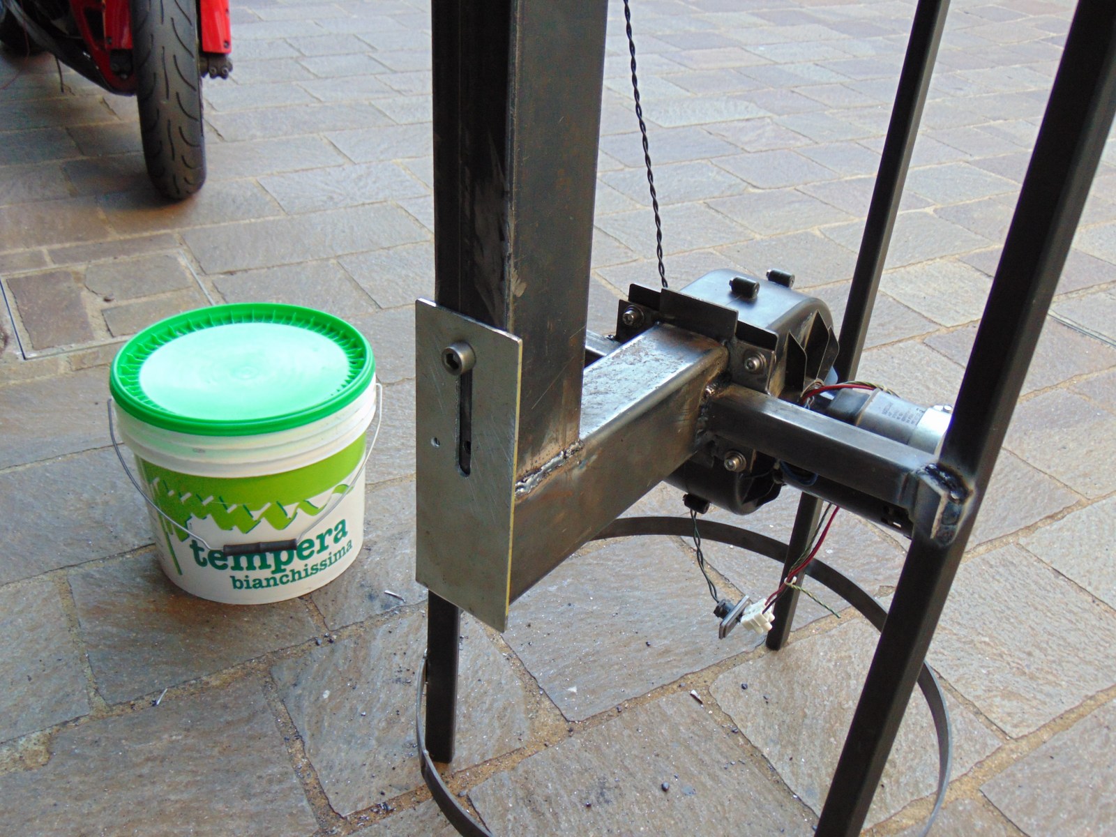

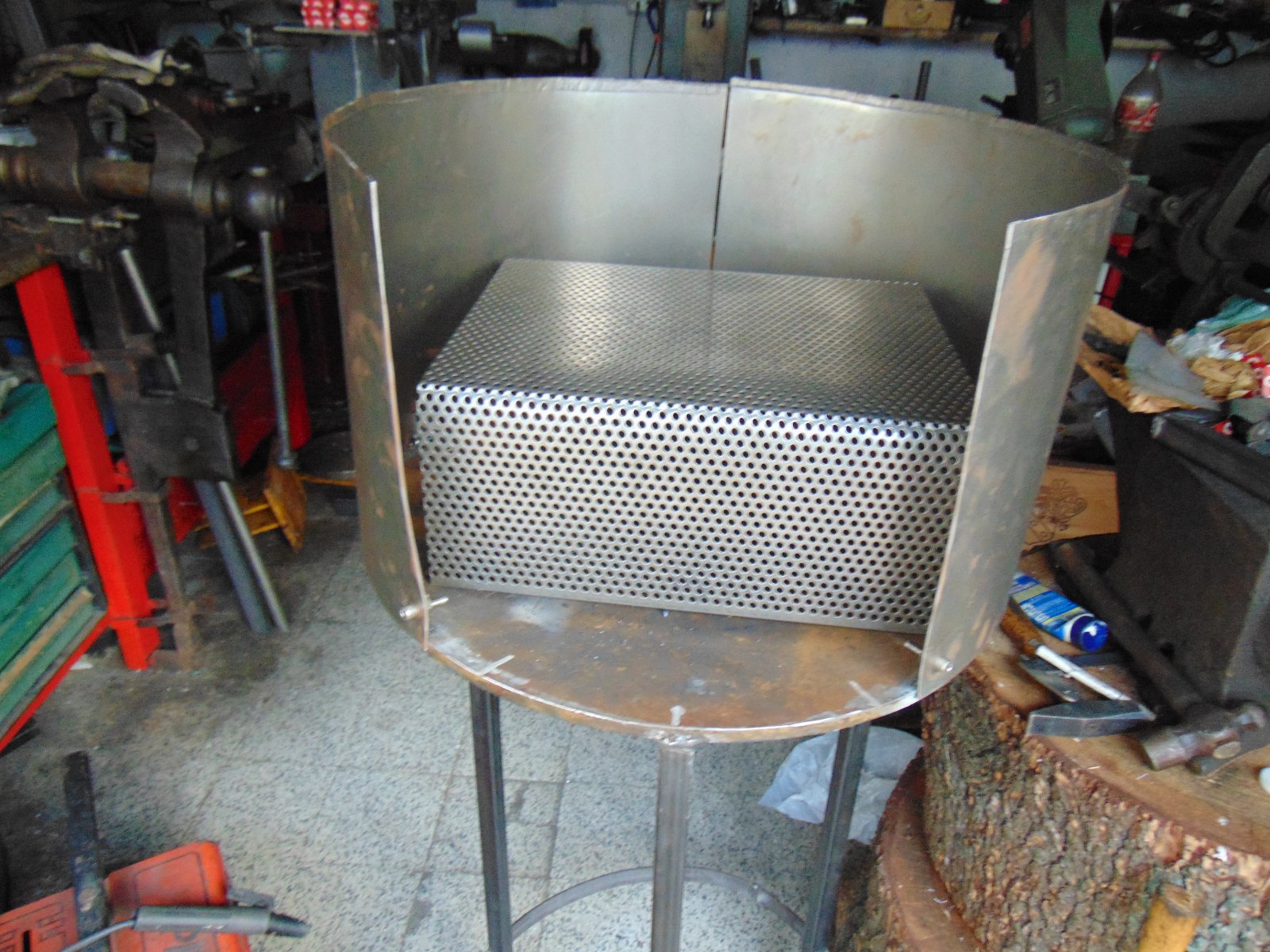

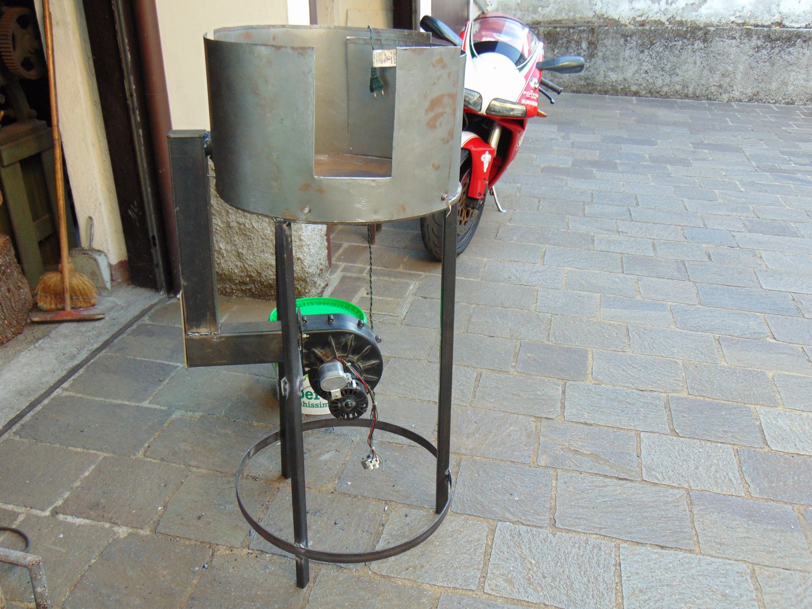

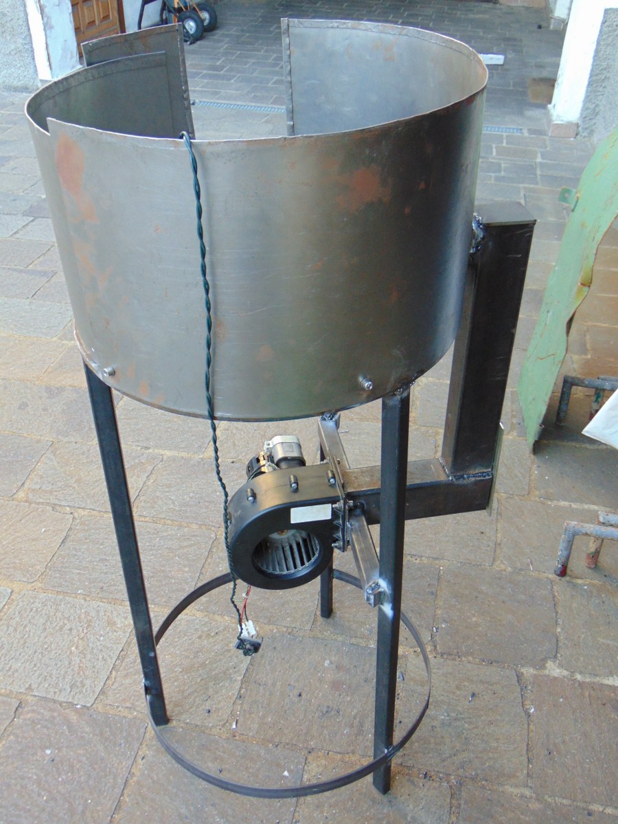

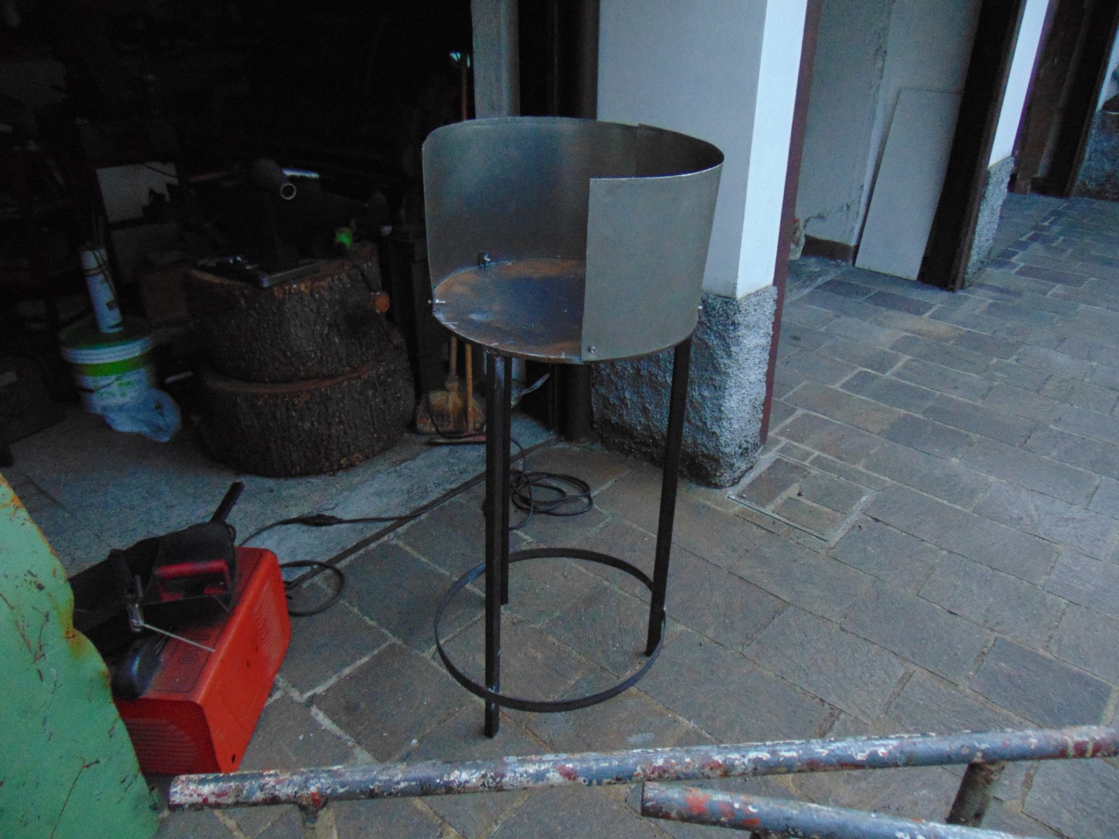

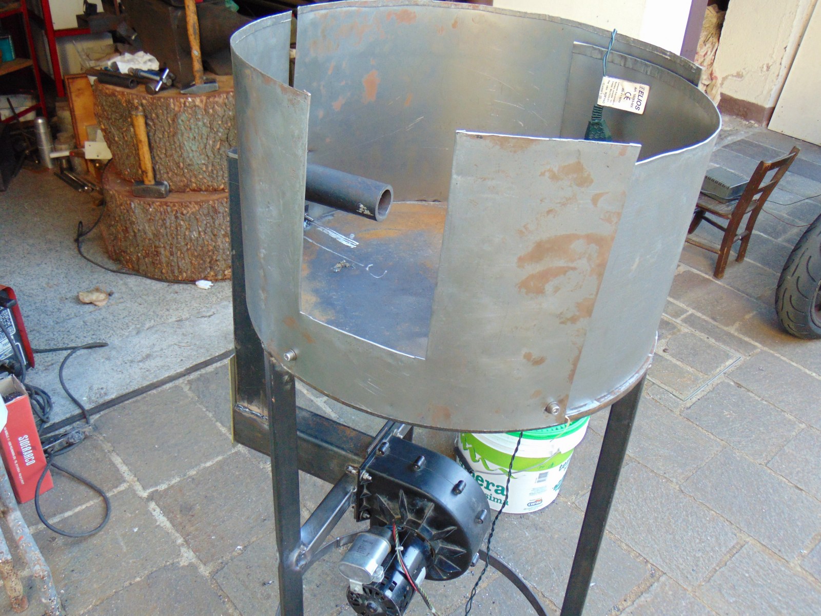

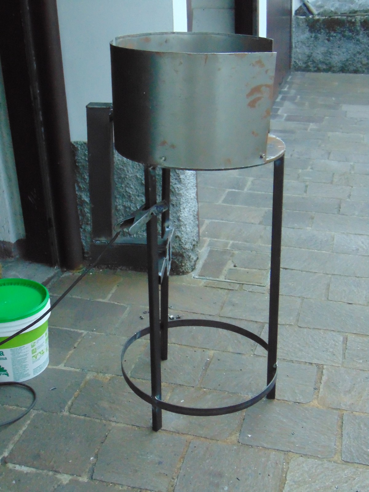

I'm trying to make a solid fuel side forge, useful even as a barbecue :rolleyes:

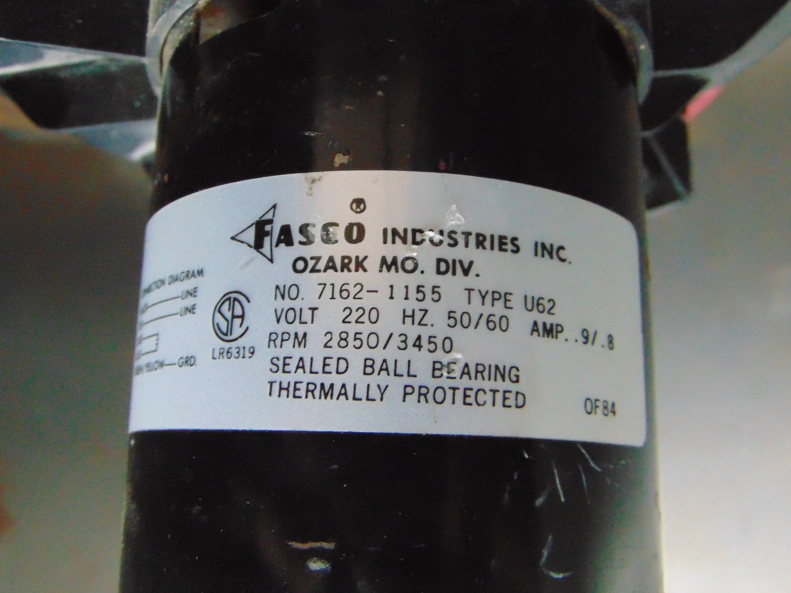

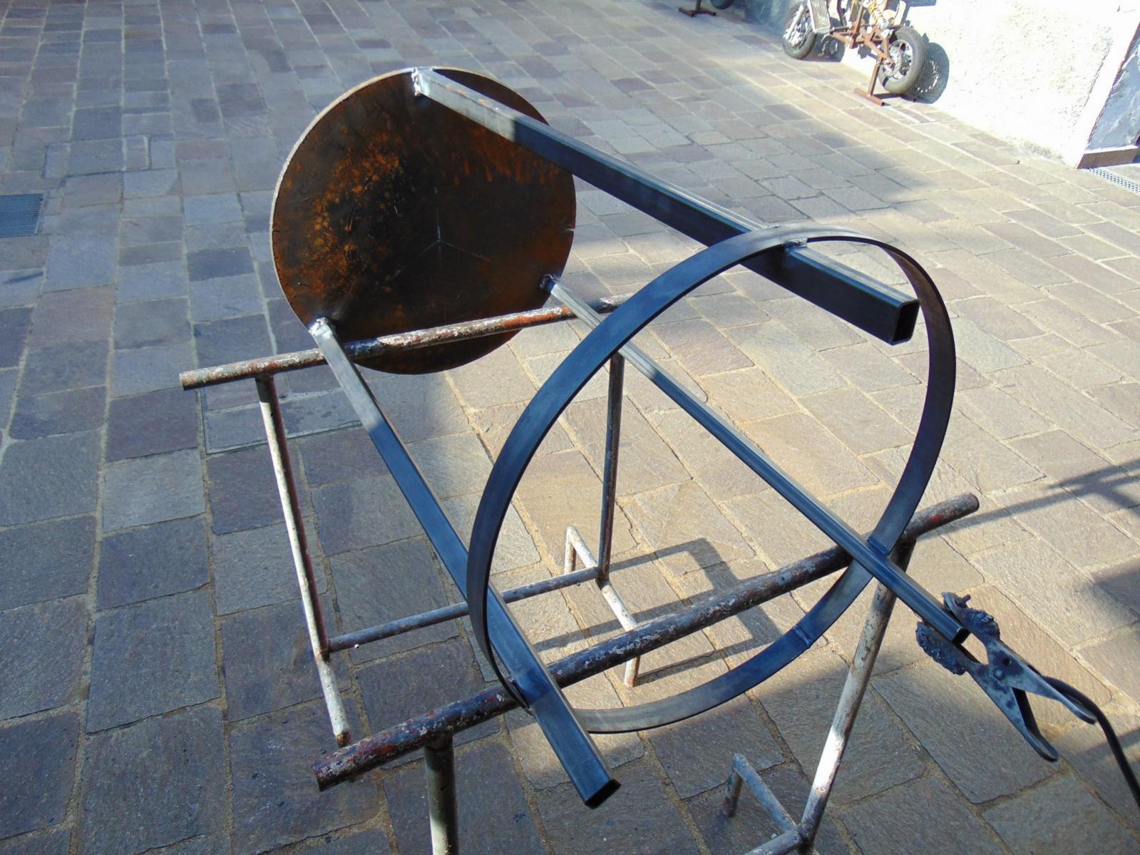

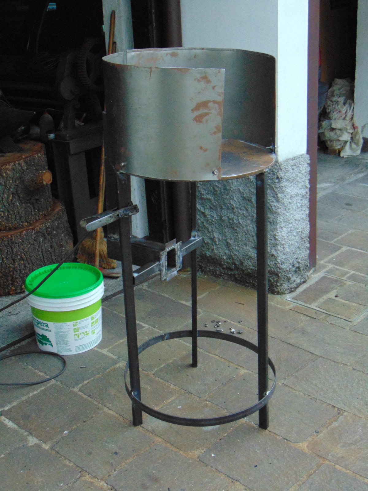

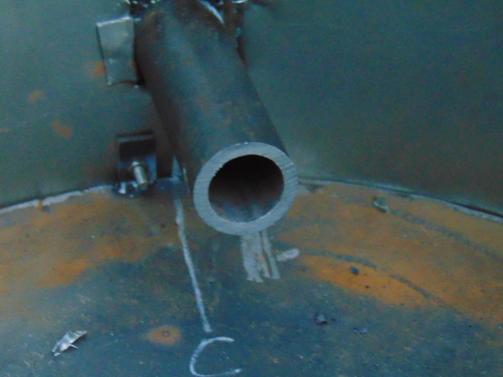

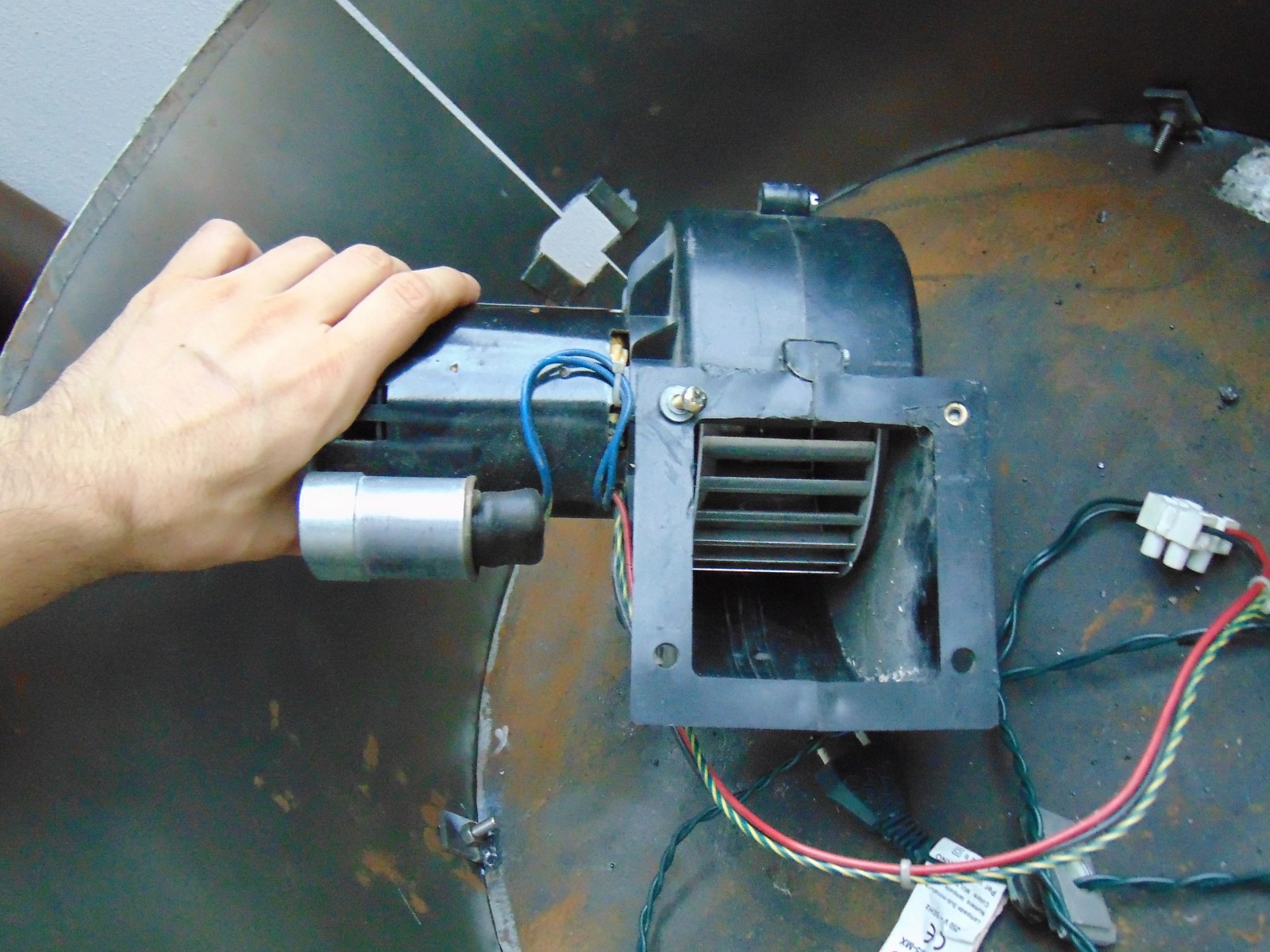

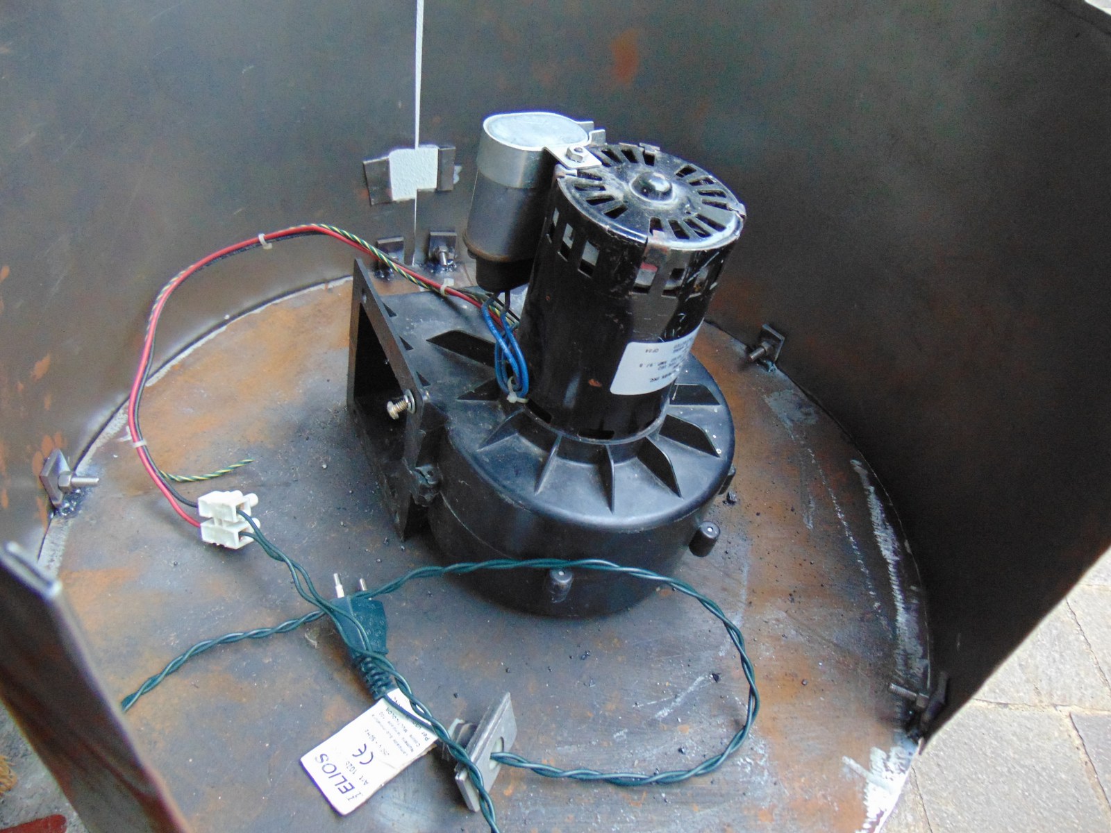

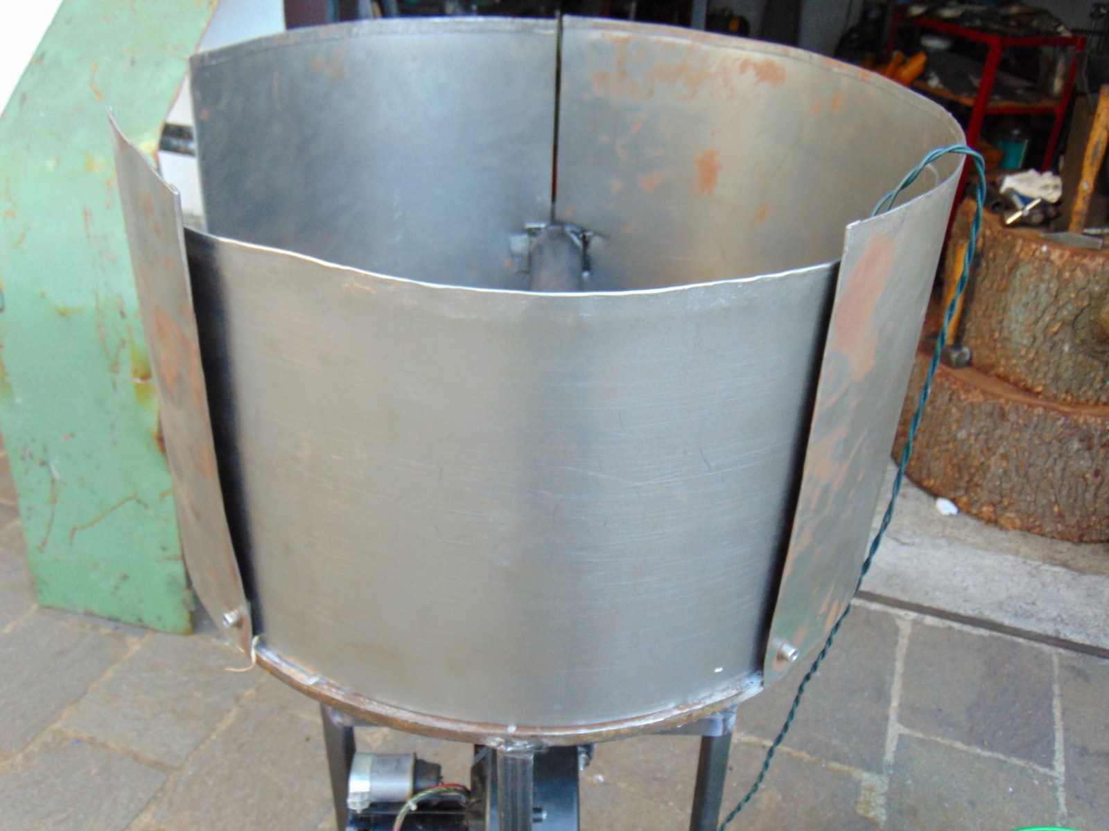

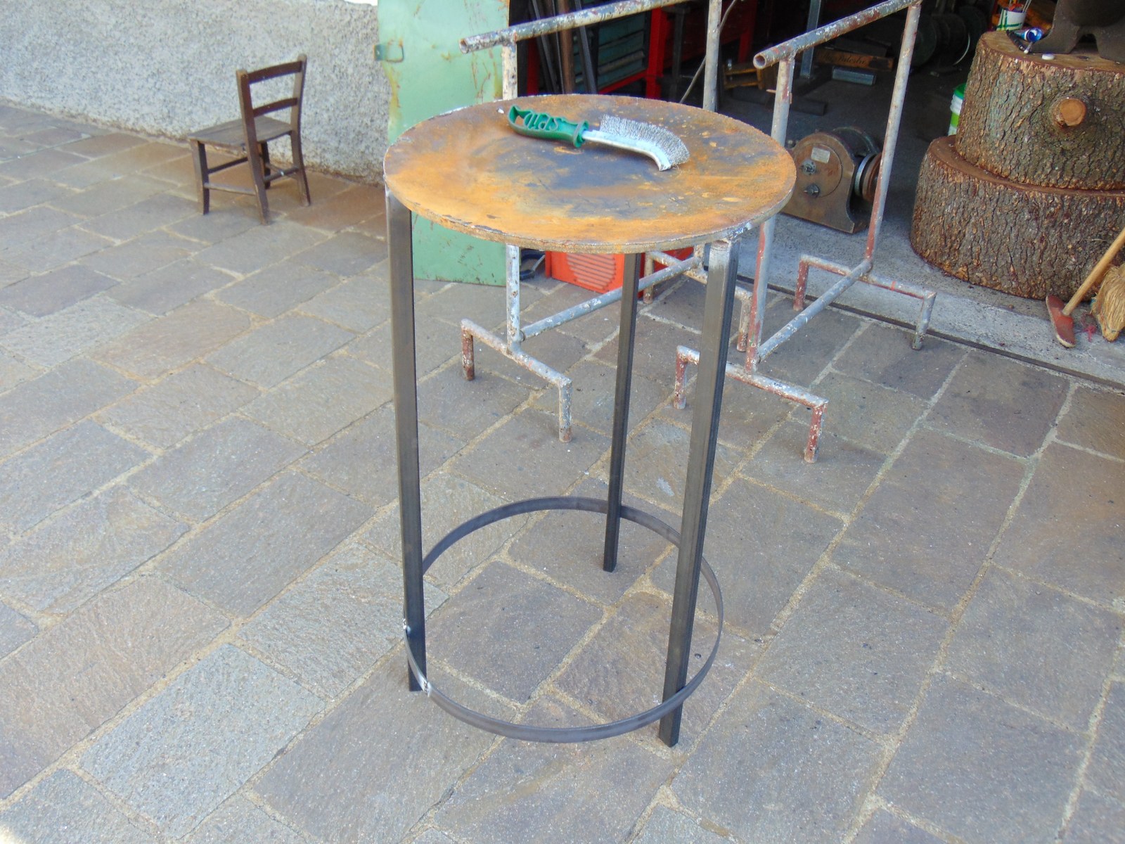

I found good metal scrap, a round part thick 1\2", good as base. I did air intake from square tube. A broken hairdryer, resistor is gone, will be the air source, I hope it will survive

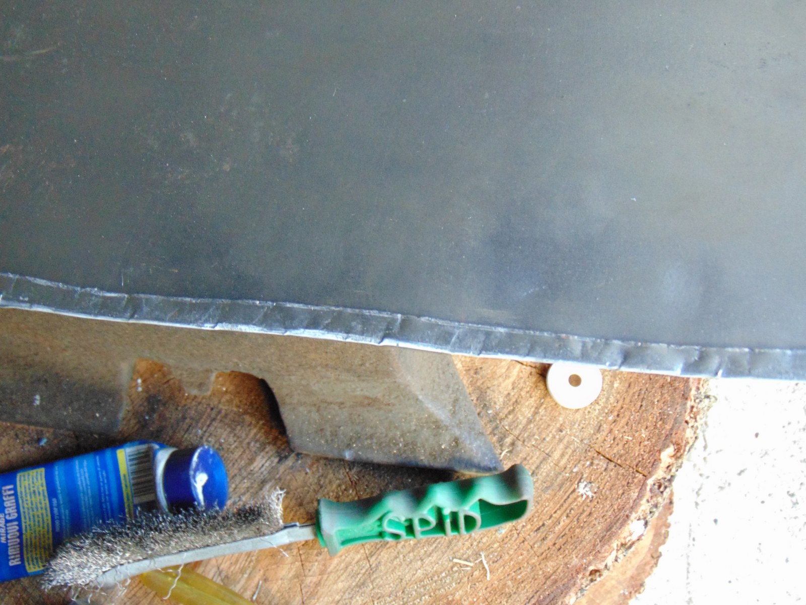

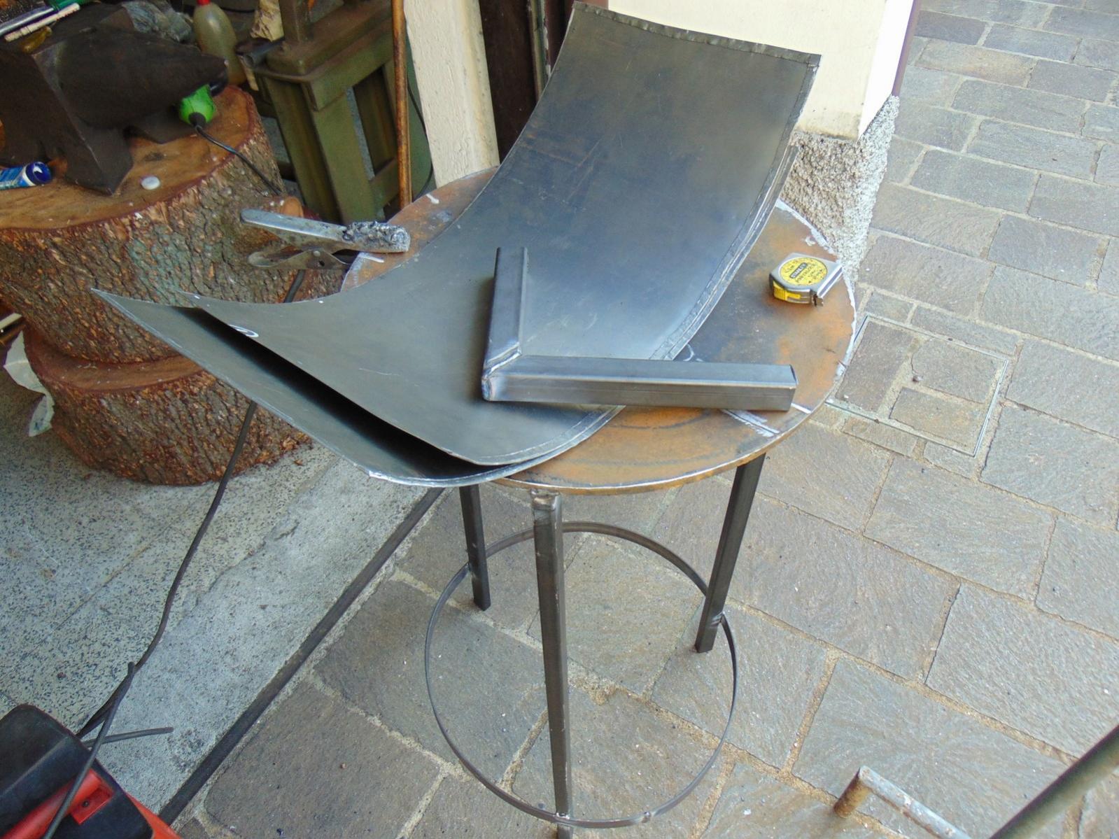

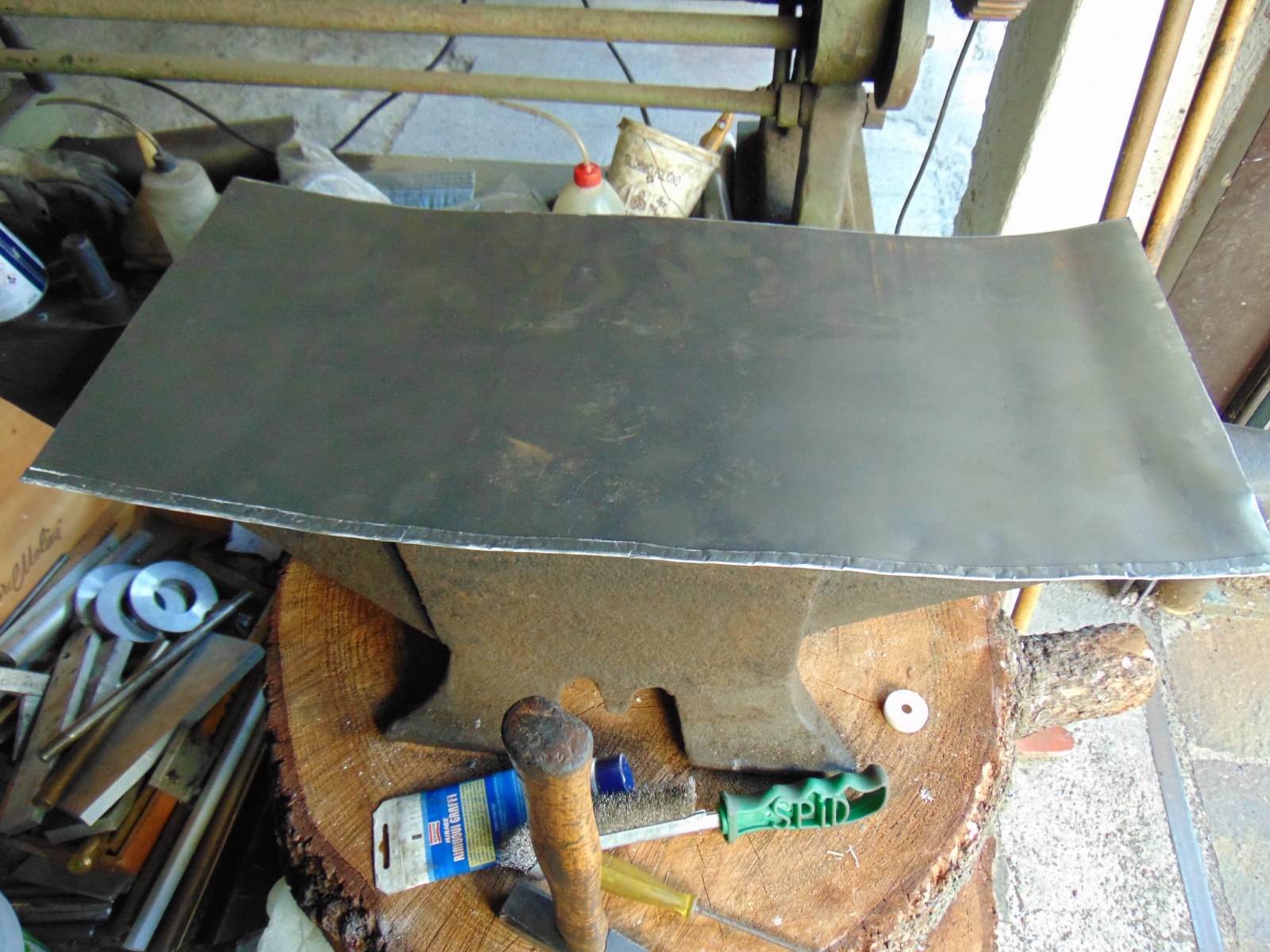

I built lateral bulkheads from 0,8mm steel, I folded with hammer the edges, because they are really sharp!
I'm thinking about making them detechable, in order to clean and to use as barbecue
