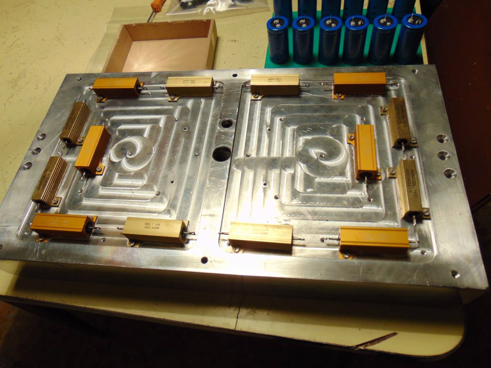

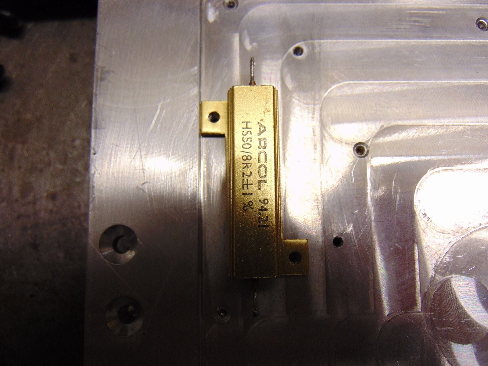

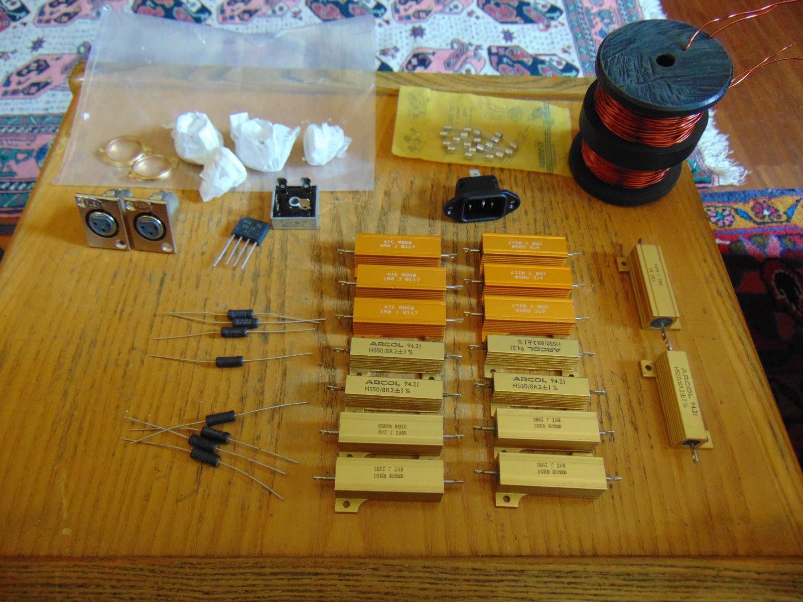

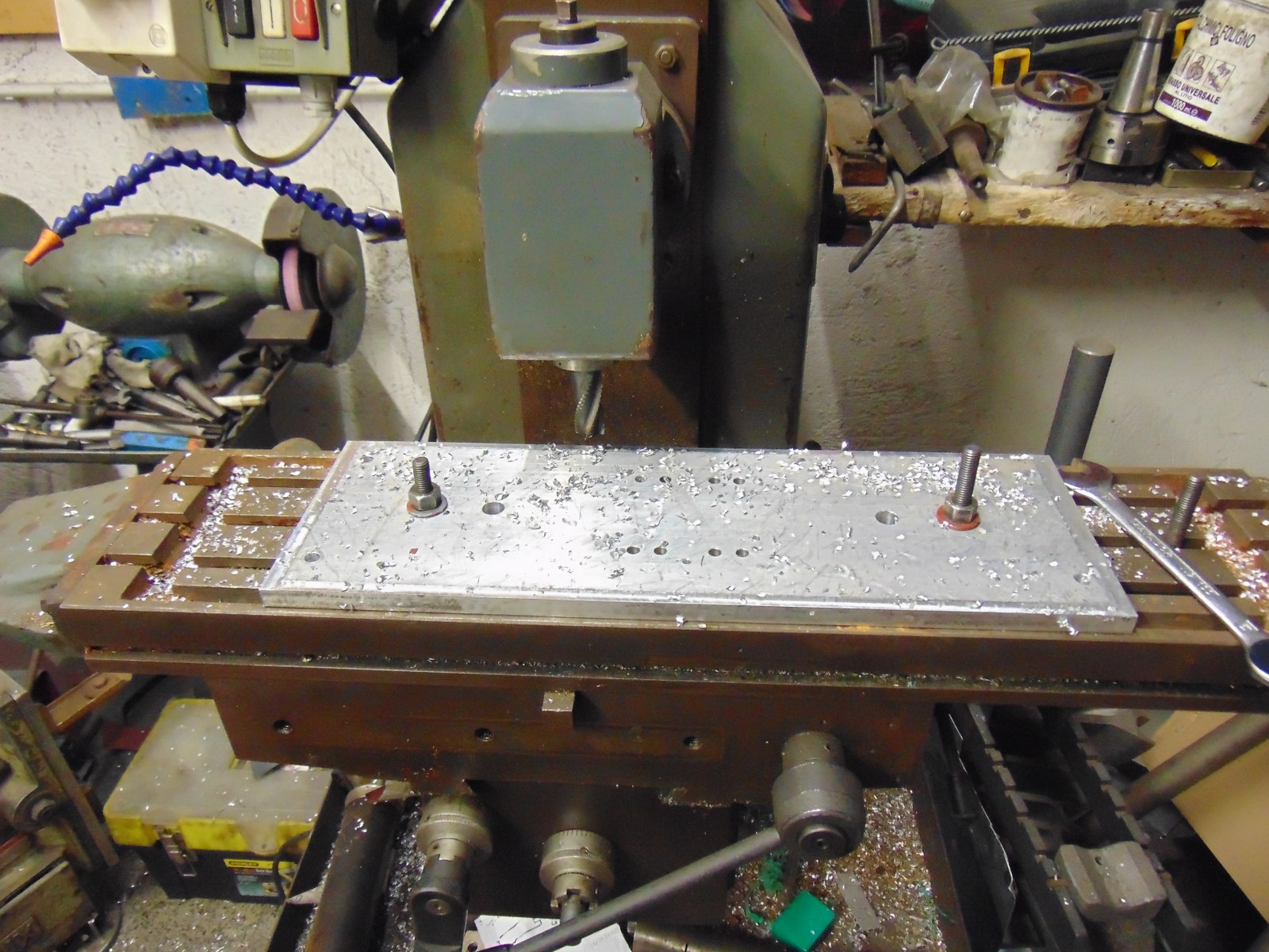

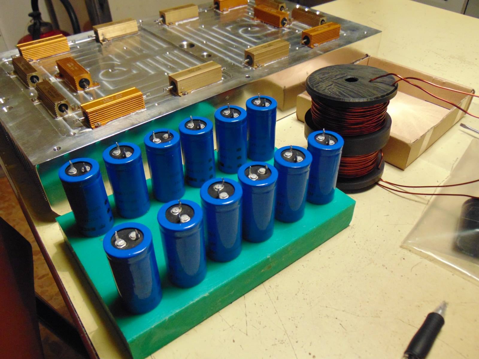

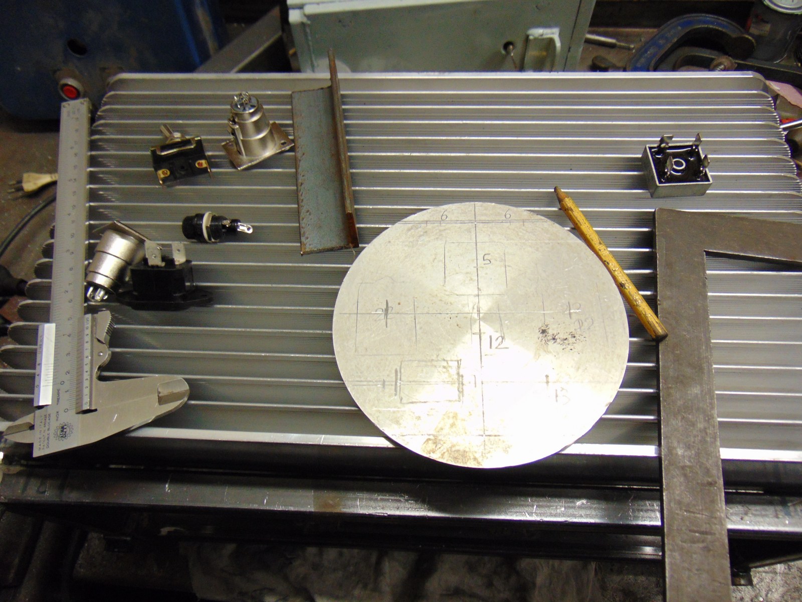

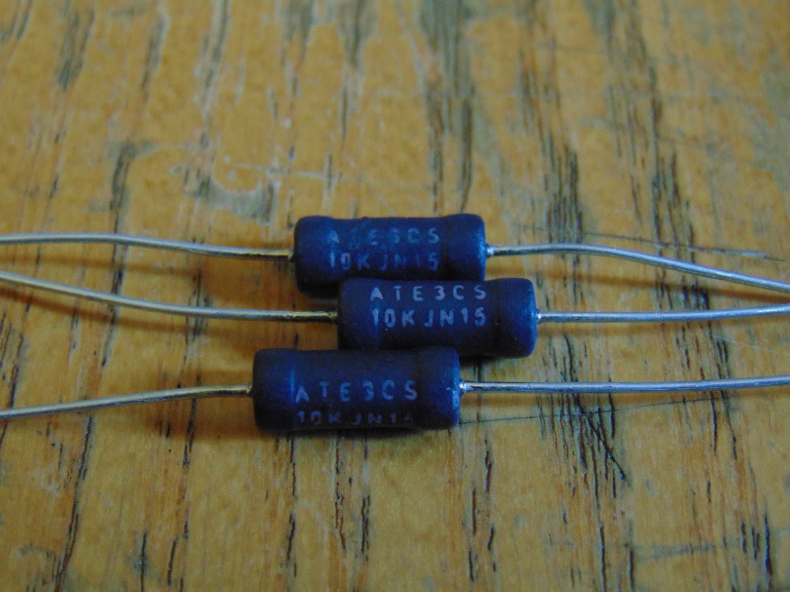

I bought very nice matched mosfet, IRFP 240 - vishay. Power resistor are rated 50w , 1% , circuit is mounted directly on heatsink.

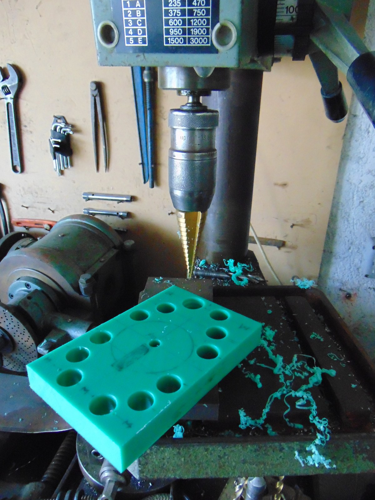

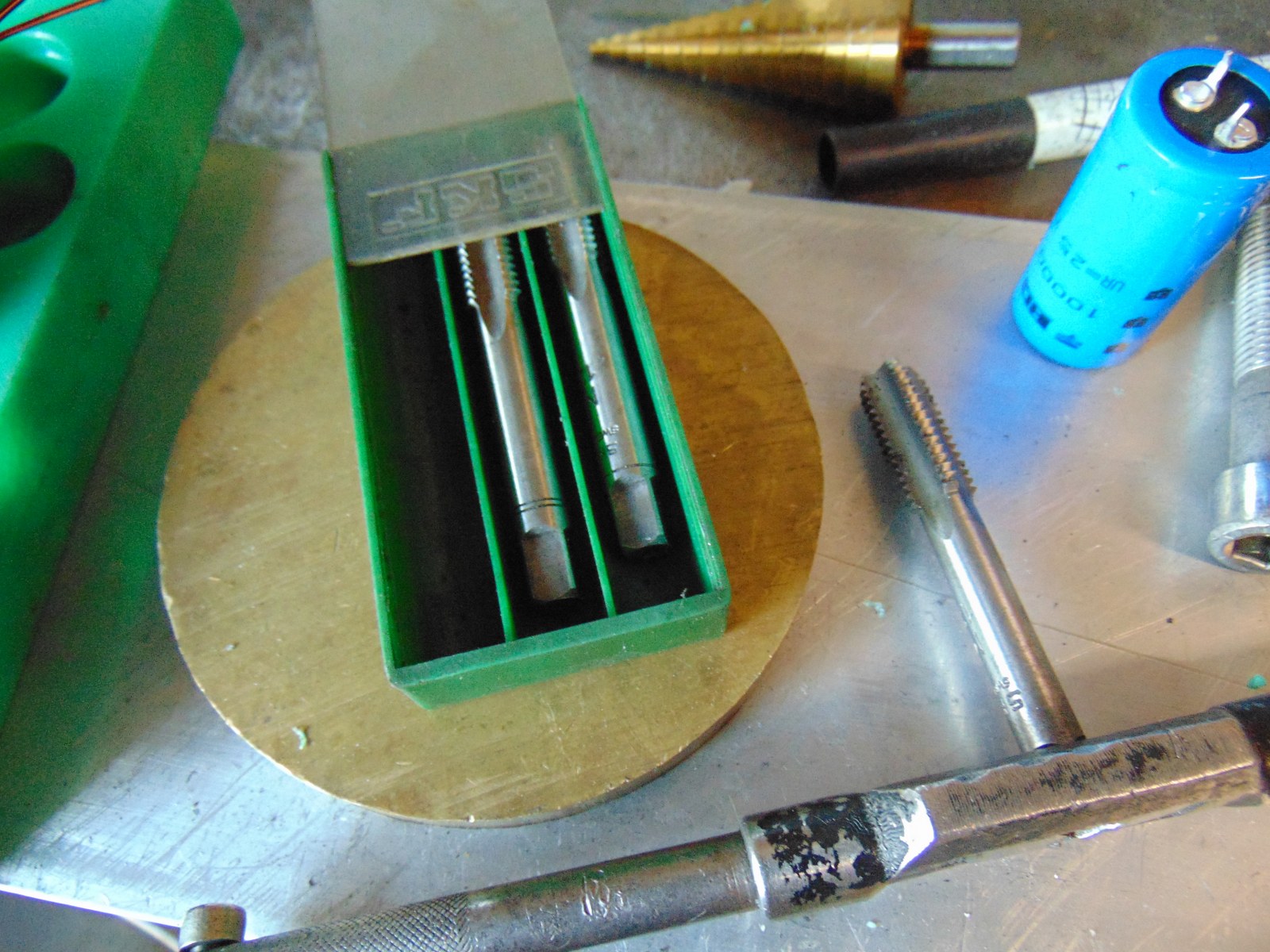

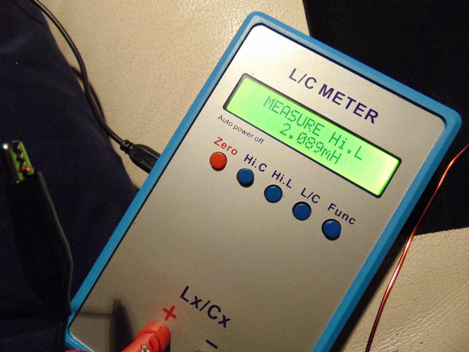

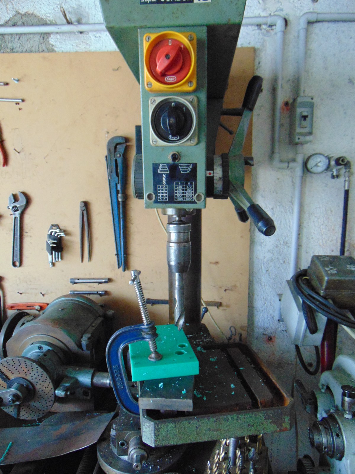

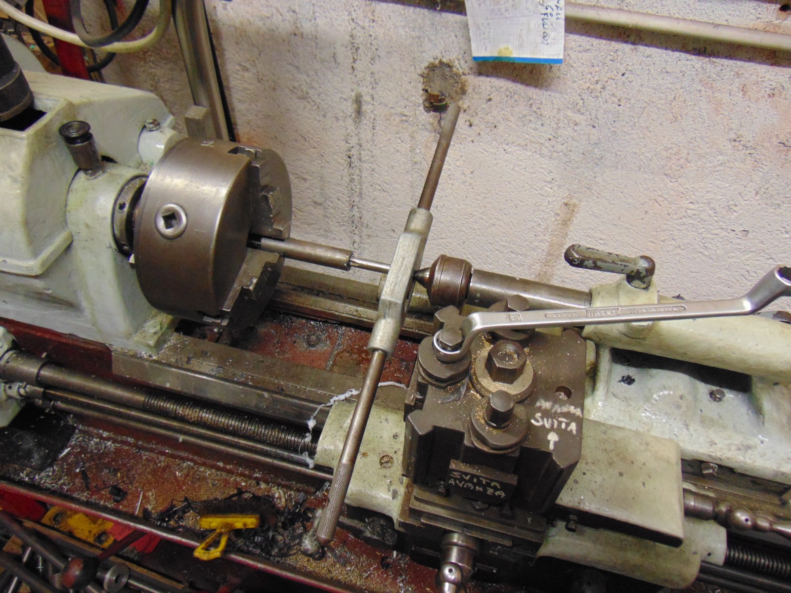

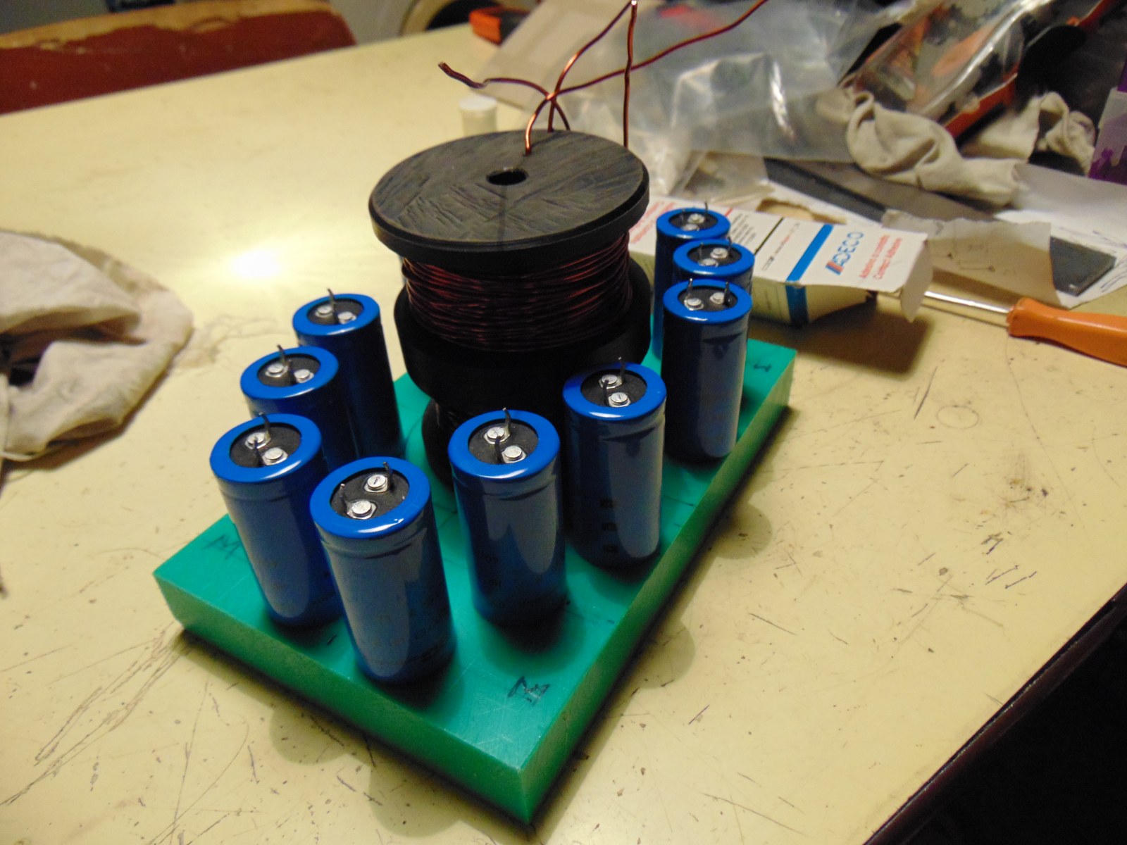

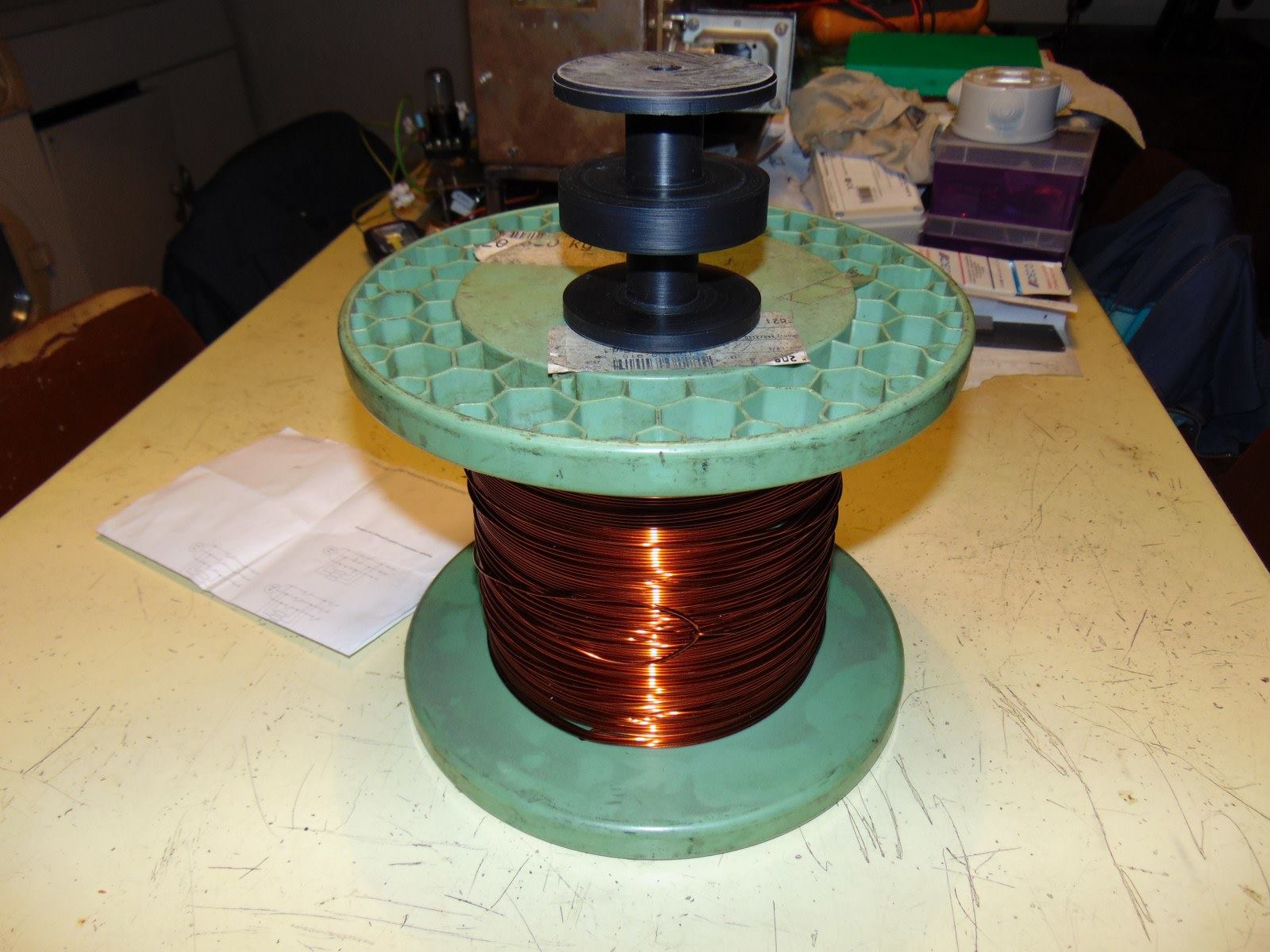

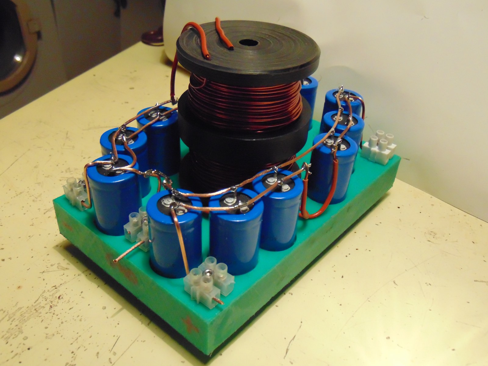

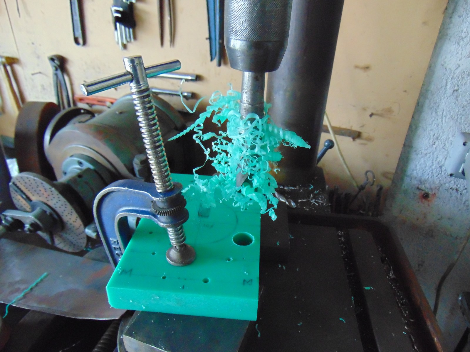

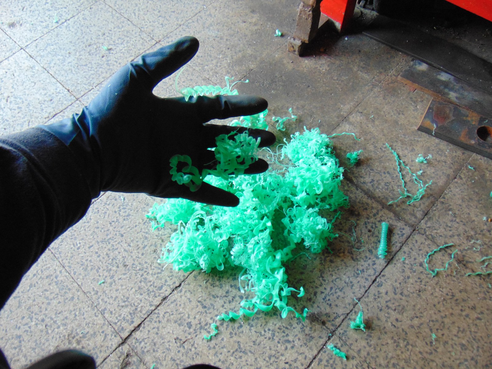

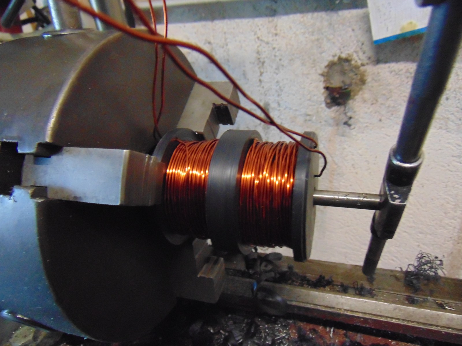

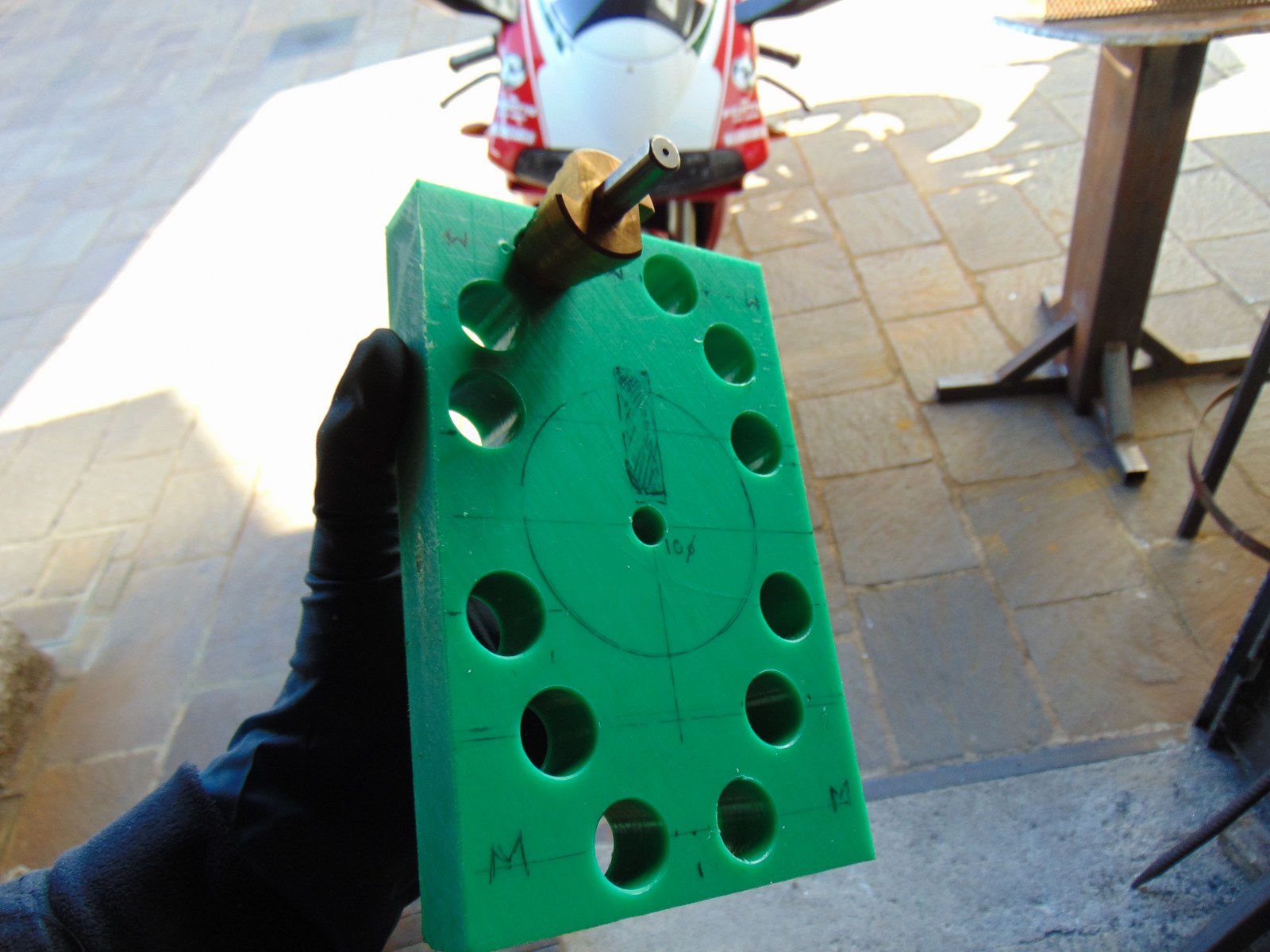

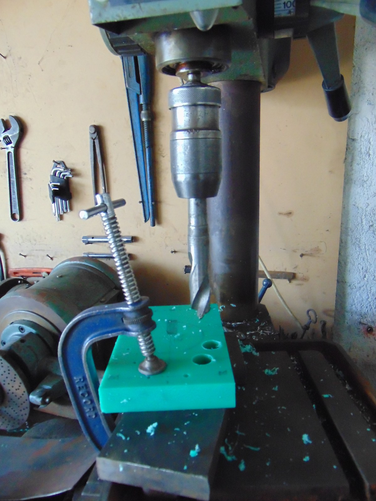

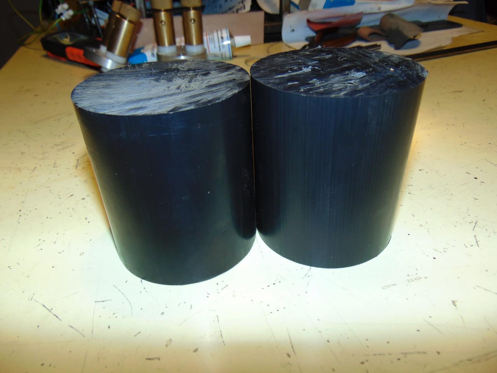

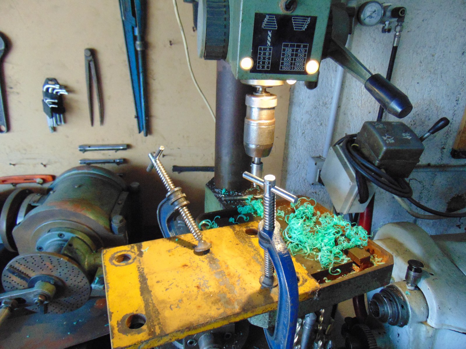

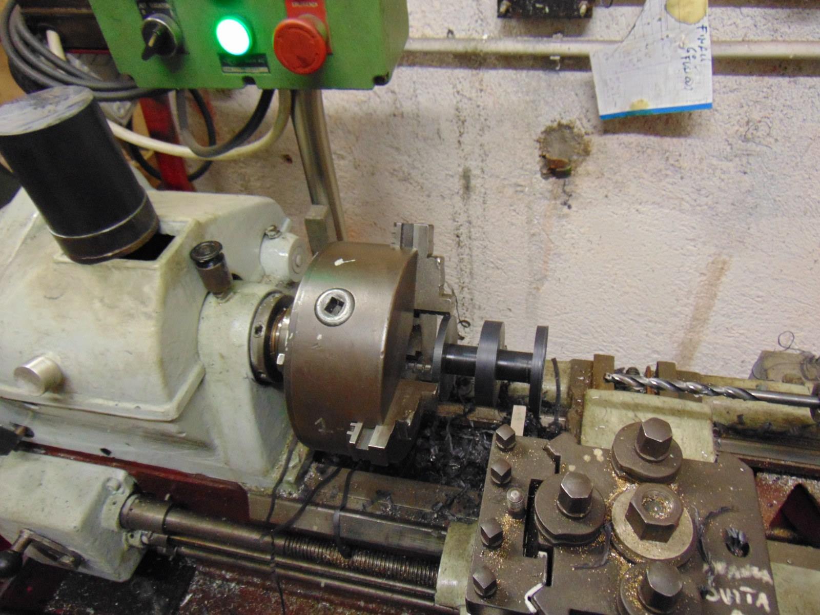

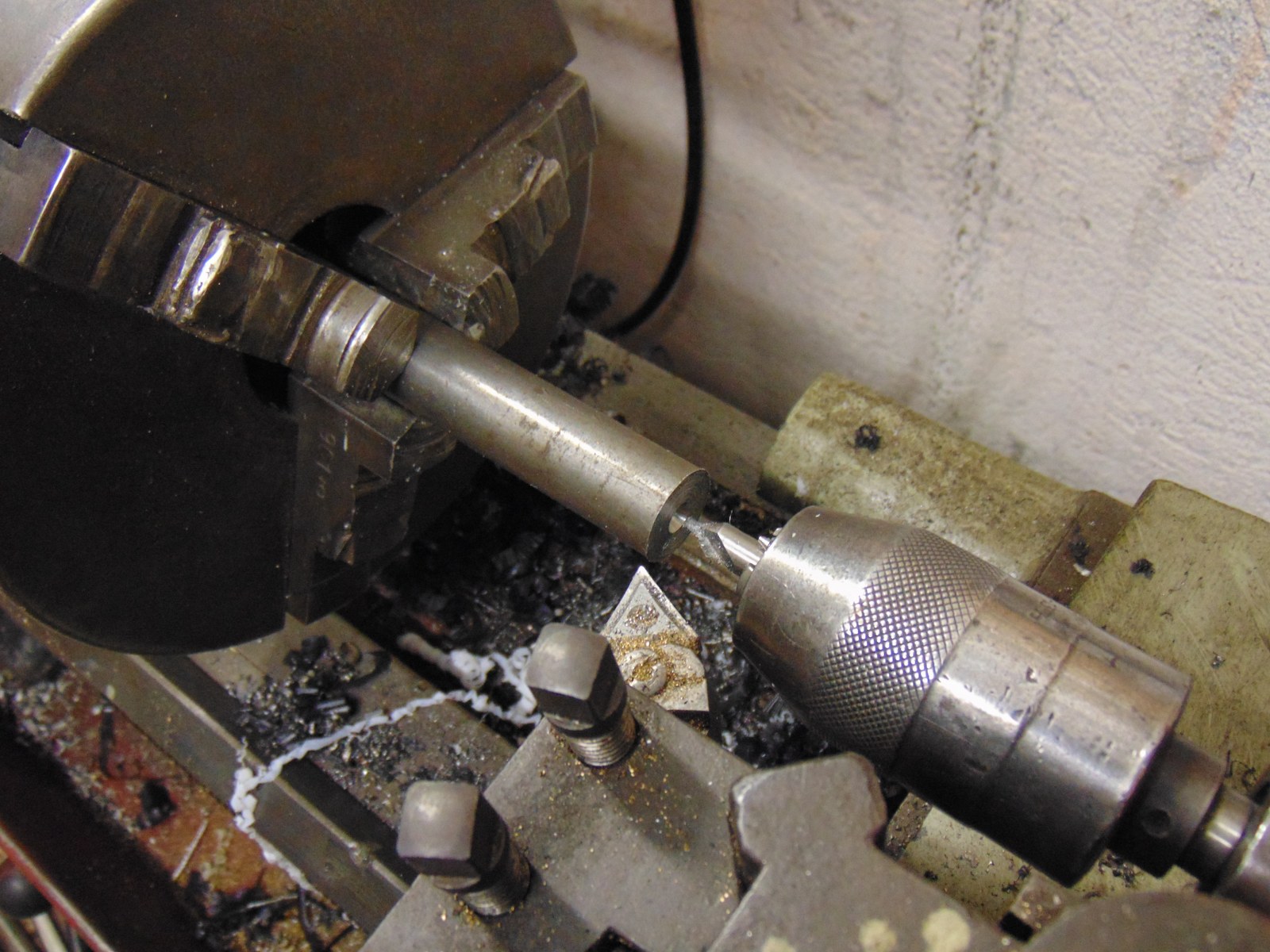

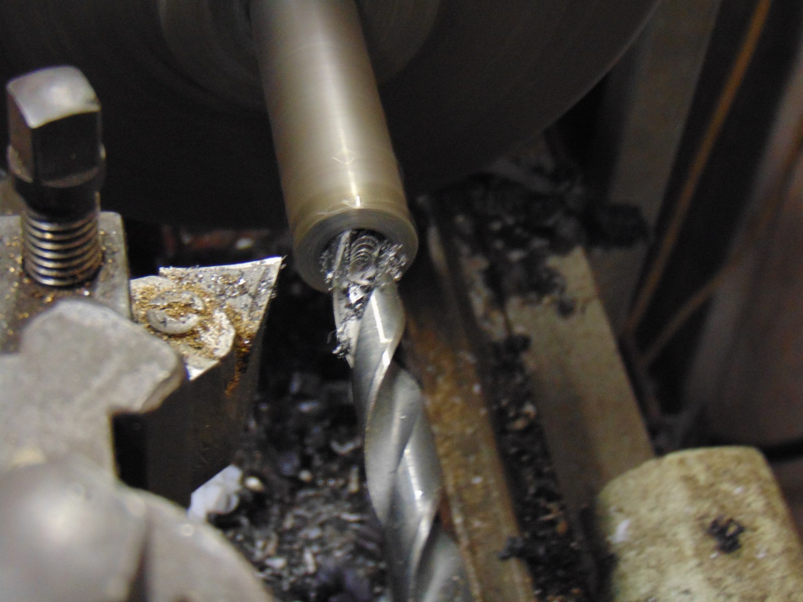

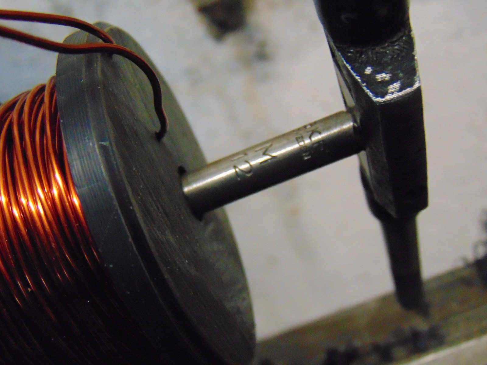

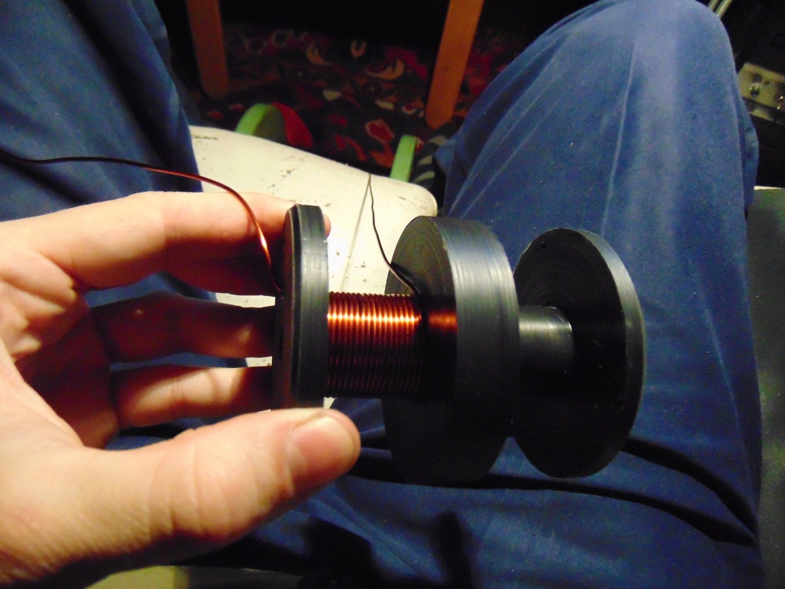

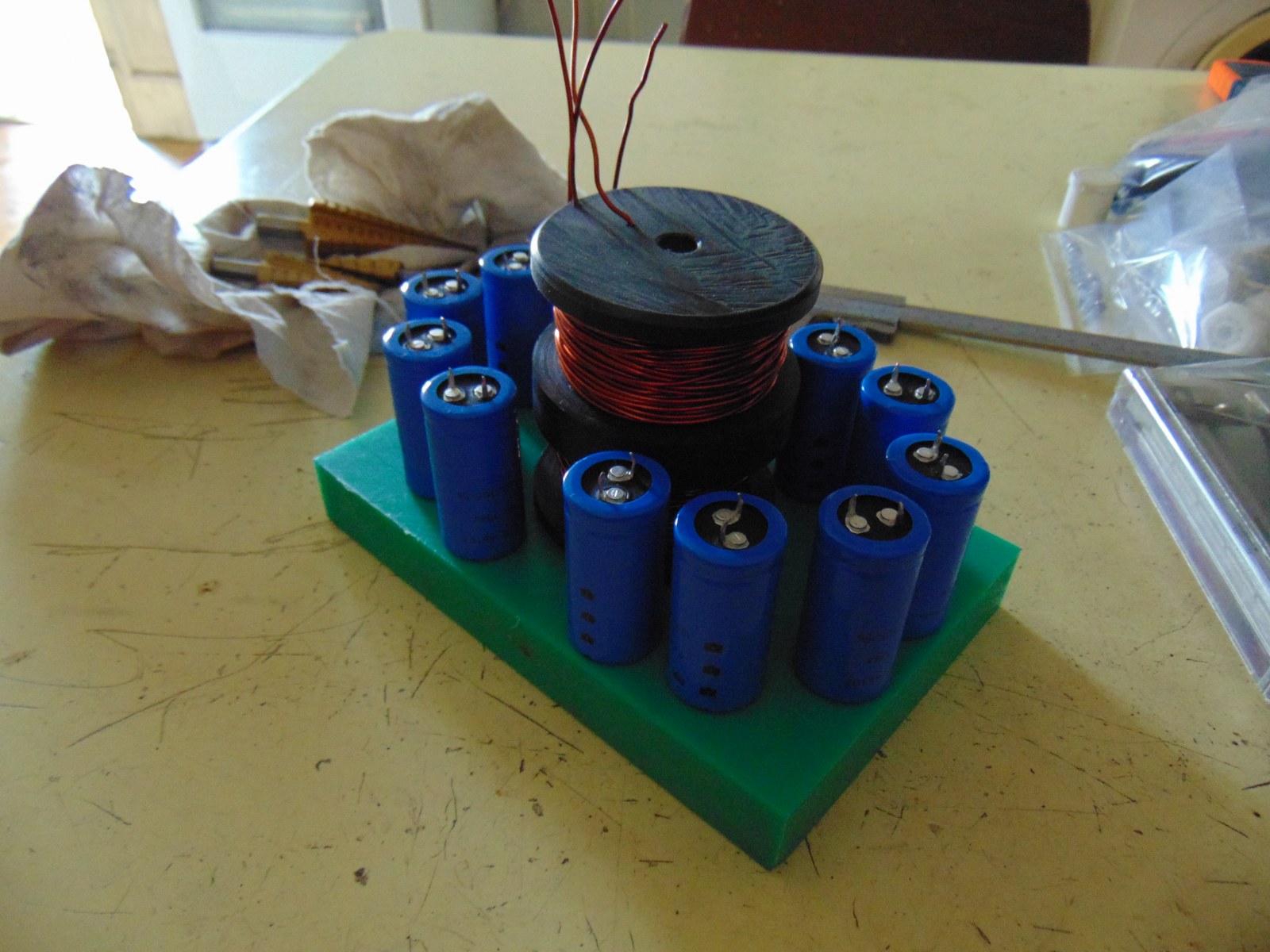

Power supply unit is a little beast, 120000uF capacitors array, dual, combined with 2mh air-core chokes. Coils bobbins are made in nylon loaded with molybdenum disulfide, 1,32mm copper wire. I want to use the green polizene panel to keep capacitors in position, like in plasma tweeter project, it's Always useful to have a stand alone power supply unit, imho.

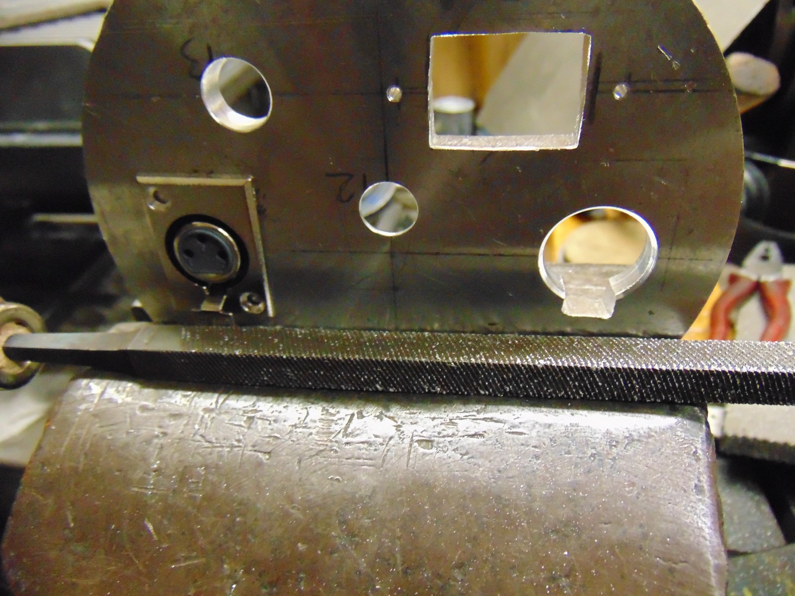

I'm trying to focus on the frame, it's a bit hard to choose a position for the black granade. I found a good front panel, want to make an high pressure porthole style in the front.

coils
Attachment 17449 Attachment 17450 Attachment 17451
Attachment 17452 Attachment 17453 Attachment 17448

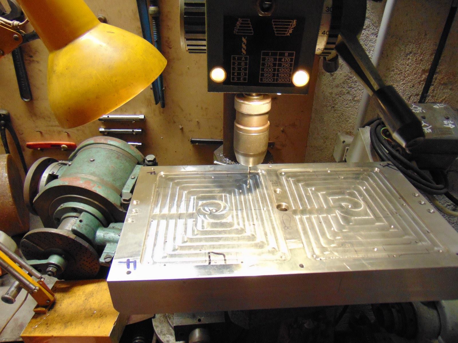

2 Attachment(s)

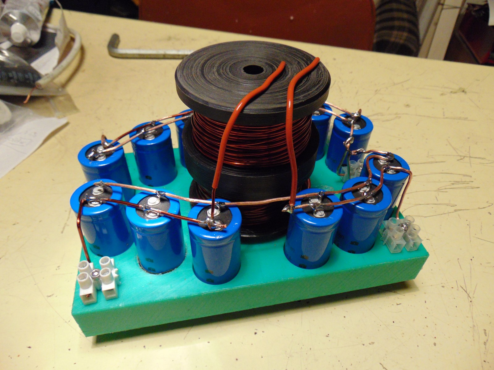

Power supply stand alone unit new layout
Air should be enough around coil. There is space for dual +/- gnd connection near the corners. I'm thinking about placing extraction holes around granade choke.
60mF, 2mH air core coil each branch.

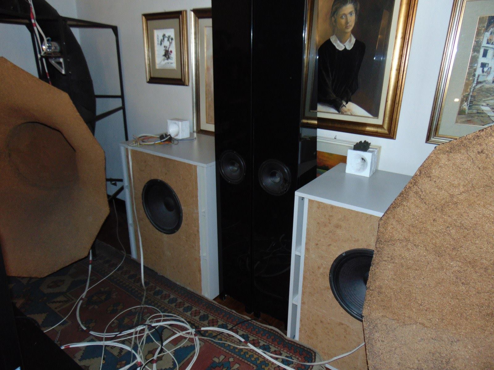

My favourite amp is a tiny ecl82 single ended, triode mode with custom made output transformers, it's only 1,6w but no troubles with my horns, about 110db\w\m.
I think it's the best amp I ever made, my old 2a3-6sn7-83 rectifier, was limited to "poor" quality output transformer. They were big, double C cores, well looking, but with the experience of now, they said too much power for wonderful specs. The results, the frequency range was far from 20\20k. Errors of Youth!
I would try a pair of Quad esl! A friend is refurbishing a pair of set in Holland, and he tells me great things about these speakers!

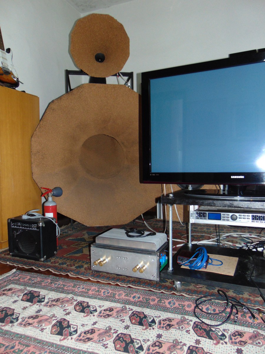

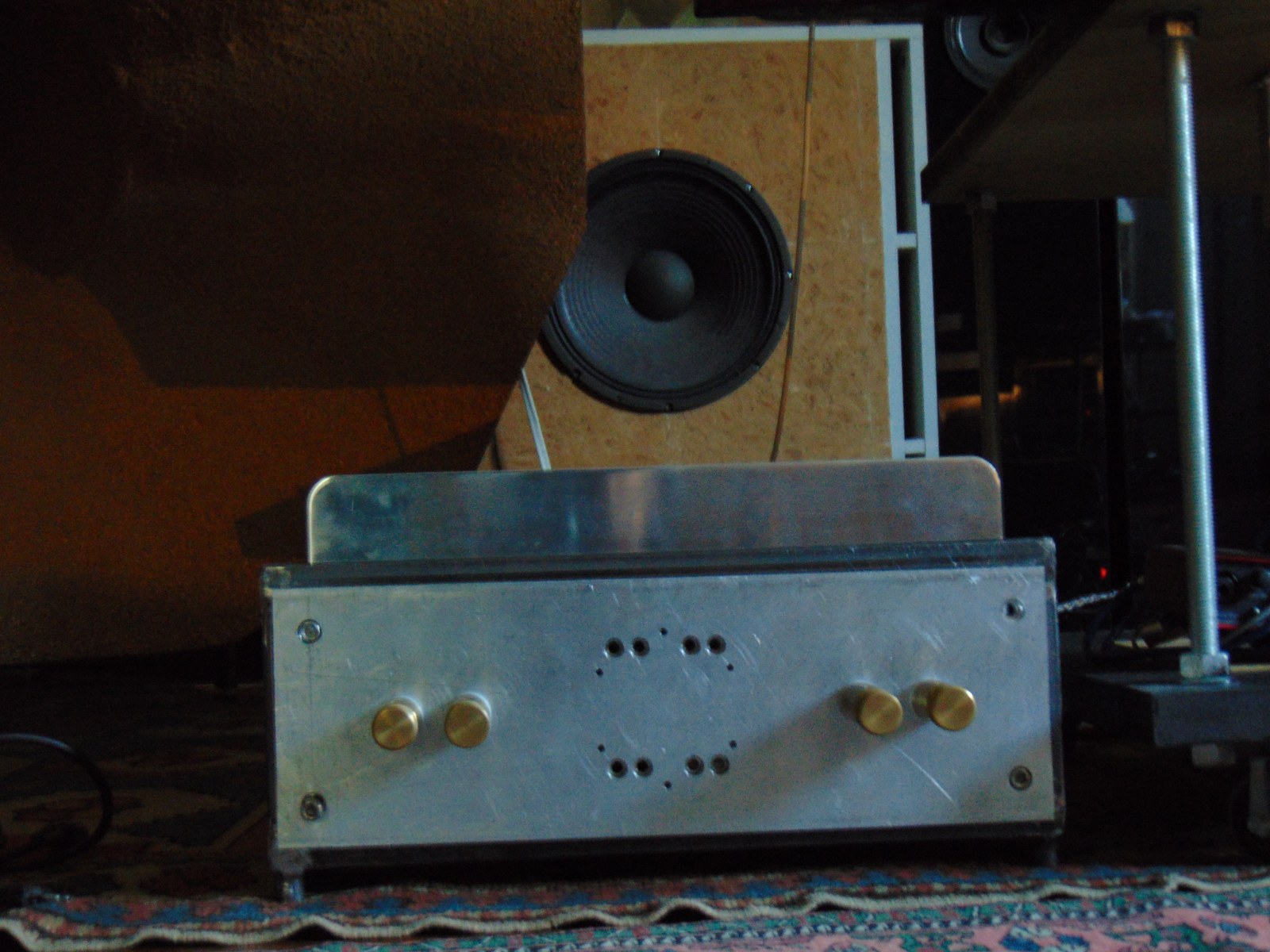

That's my actual setup, i'm trying to build a plasma tweeter , but I have to make some more test

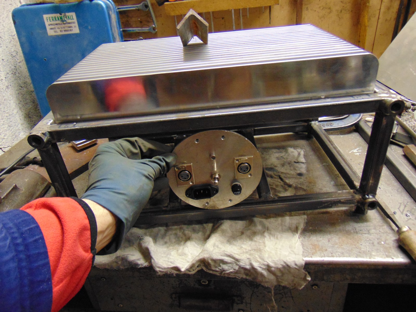

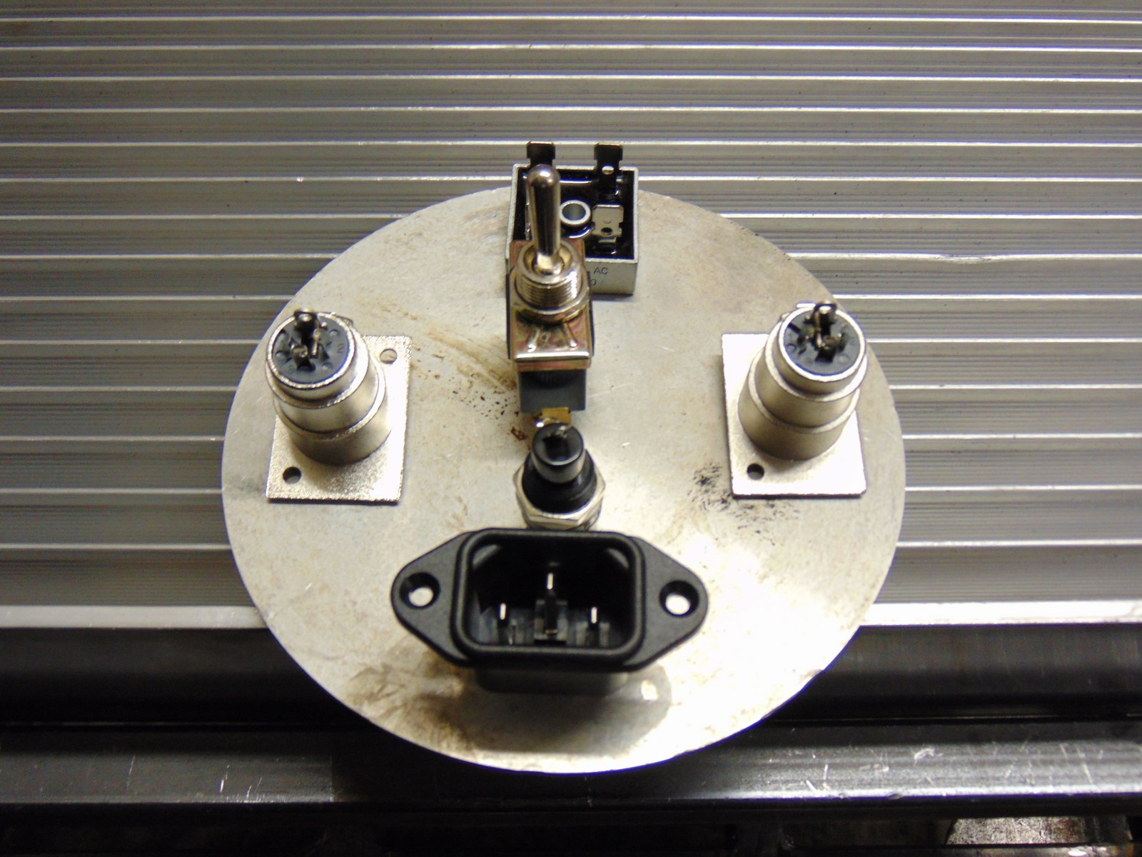

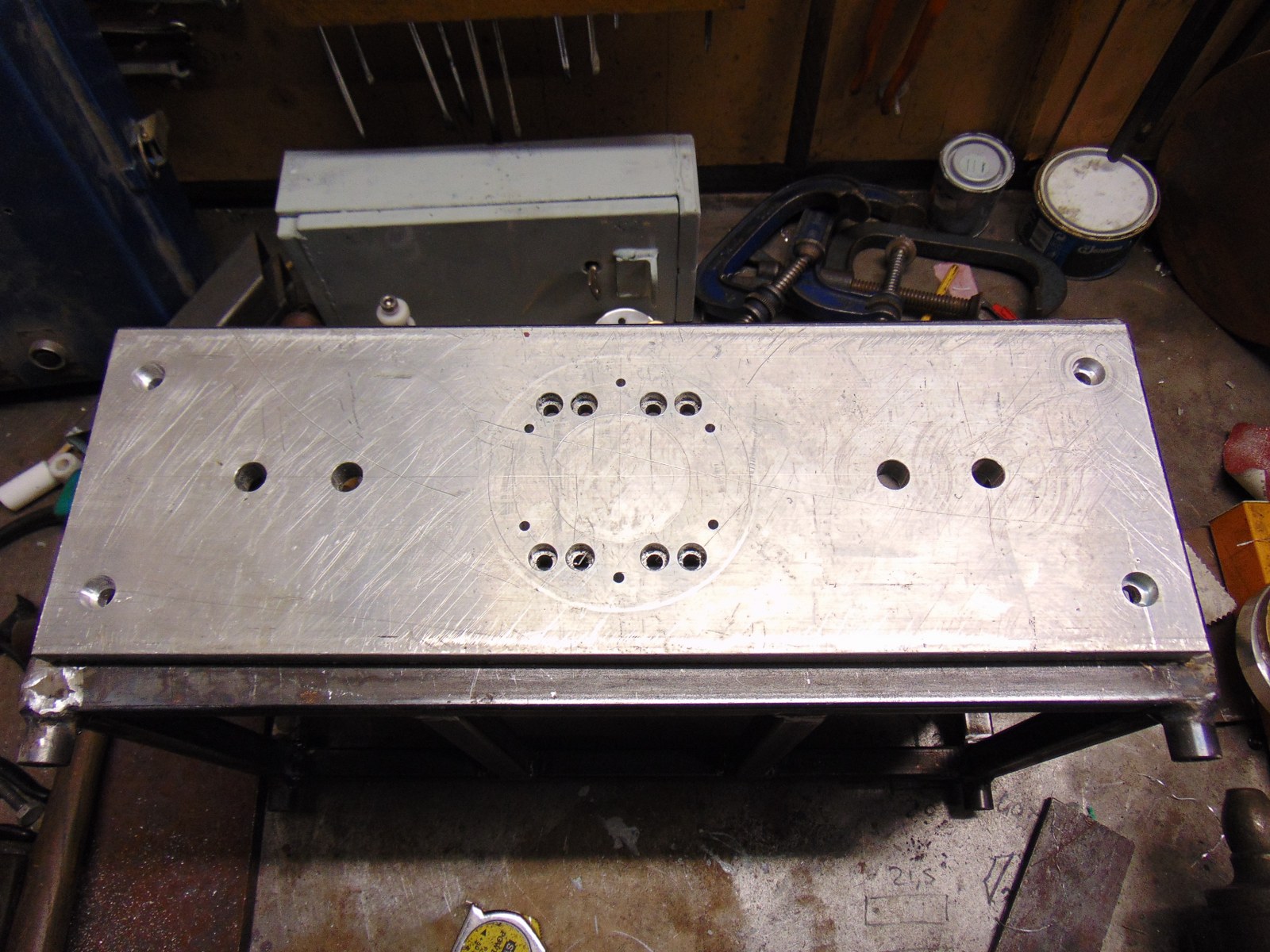

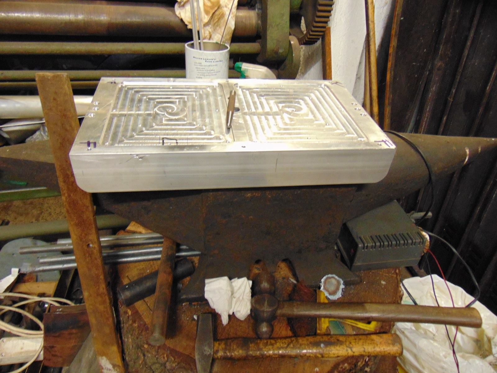

14 Attachment(s)

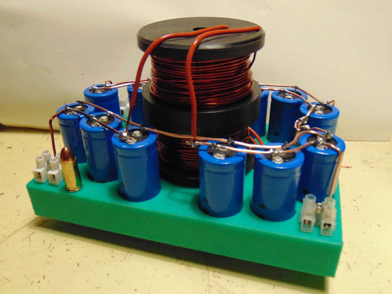

Update, dual power supply unit almost completed!
Bridge rectifier will be mounted directly on the solid aluminum rear panel.
As usual mammut connectors for +/-/gnd. 120mF, 2x2mH air core chokes, max +/-25v dc each rail.

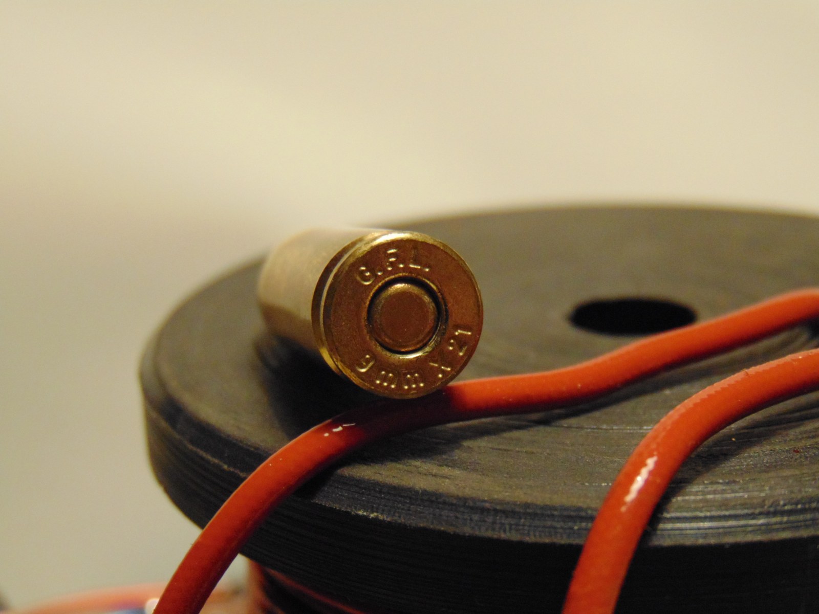

For size comparison the bullet is a 9x21mm, this unit is pretty big, but compact.
Next step, tubular frame!
Attachment 17521 Attachment 17522 Attachment 17523
Attachment 17524 Attachment 17525 Attachment 17526
Attachment 17527 Attachment 17528 Attachment 17529
Attachment 17530 Attachment 17531 Attachment 17532
Attachment 17533 Attachment 17534

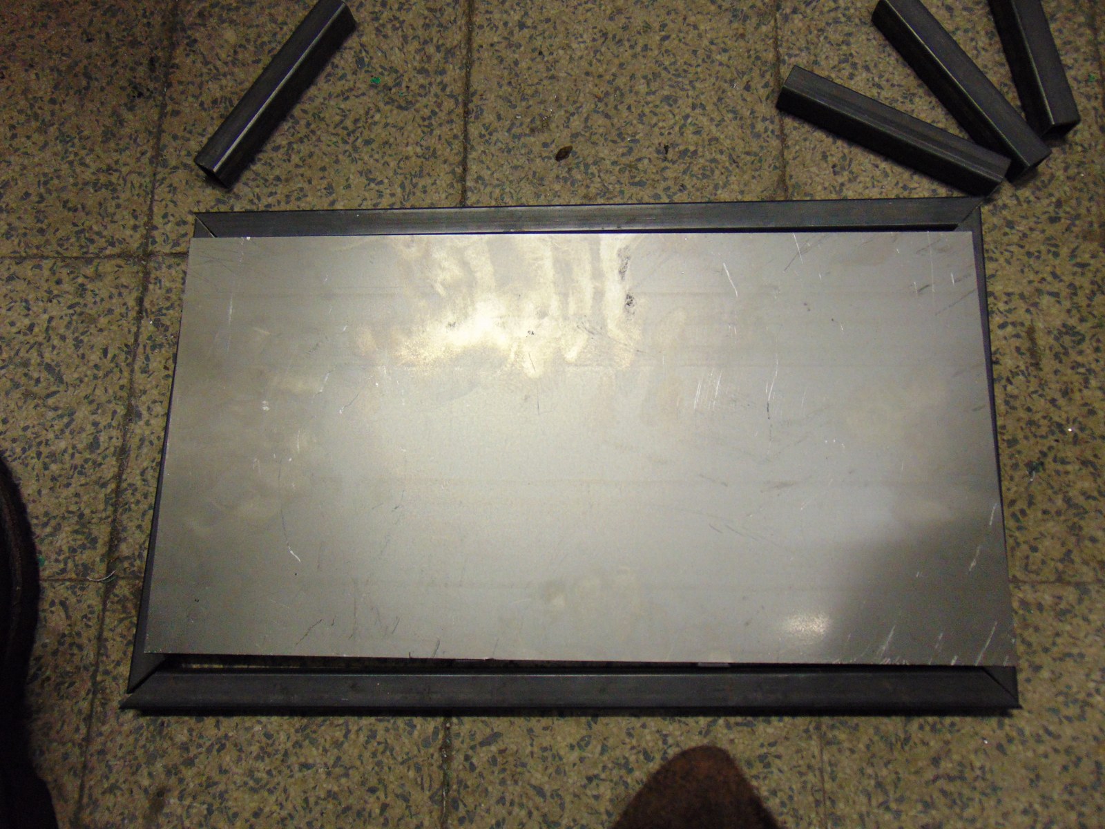

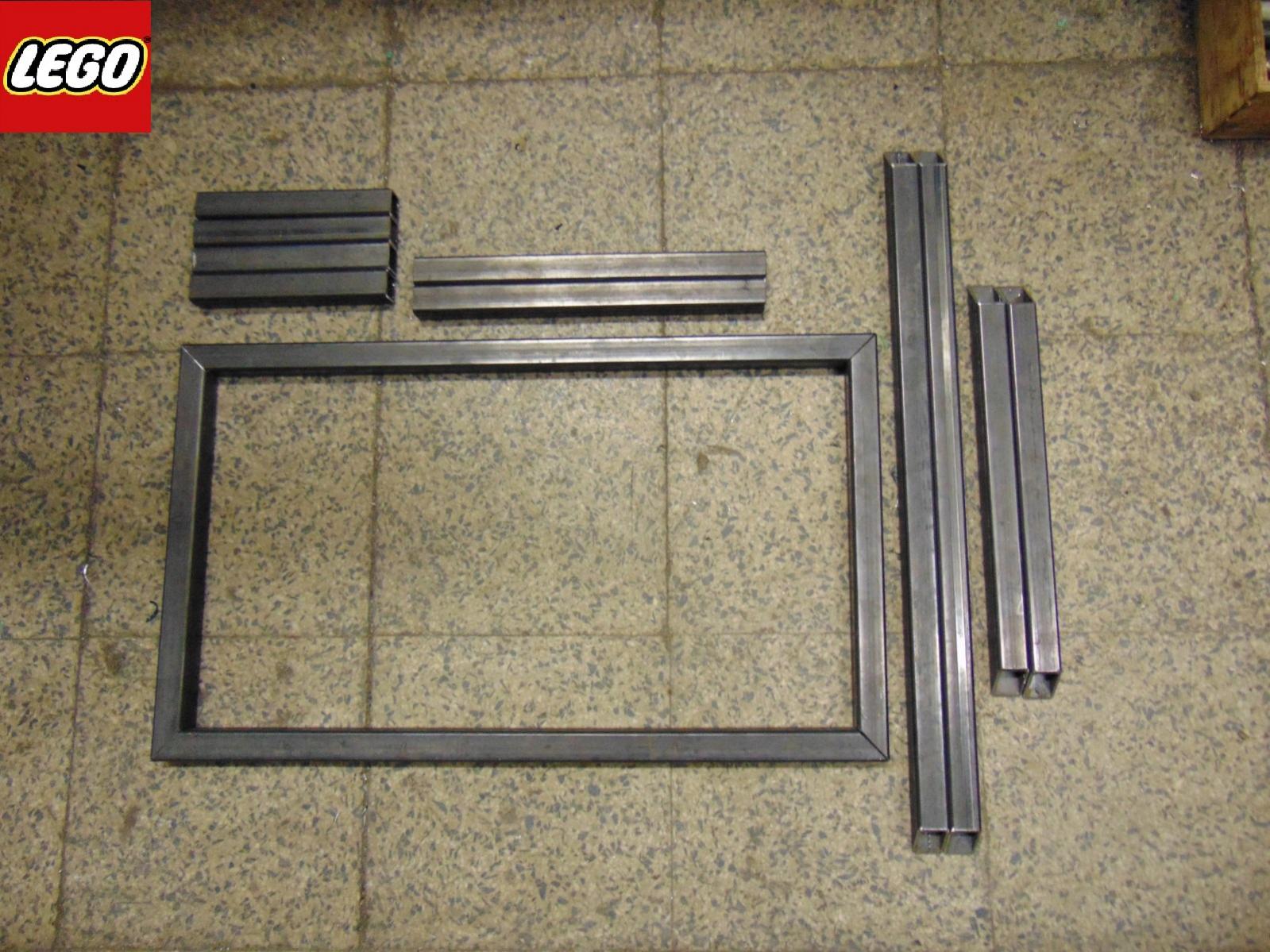

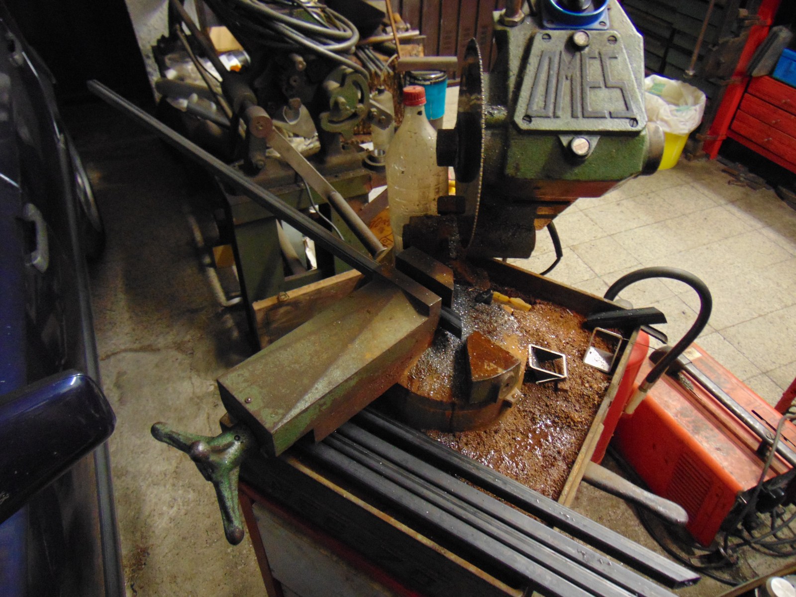

11 Attachment(s)

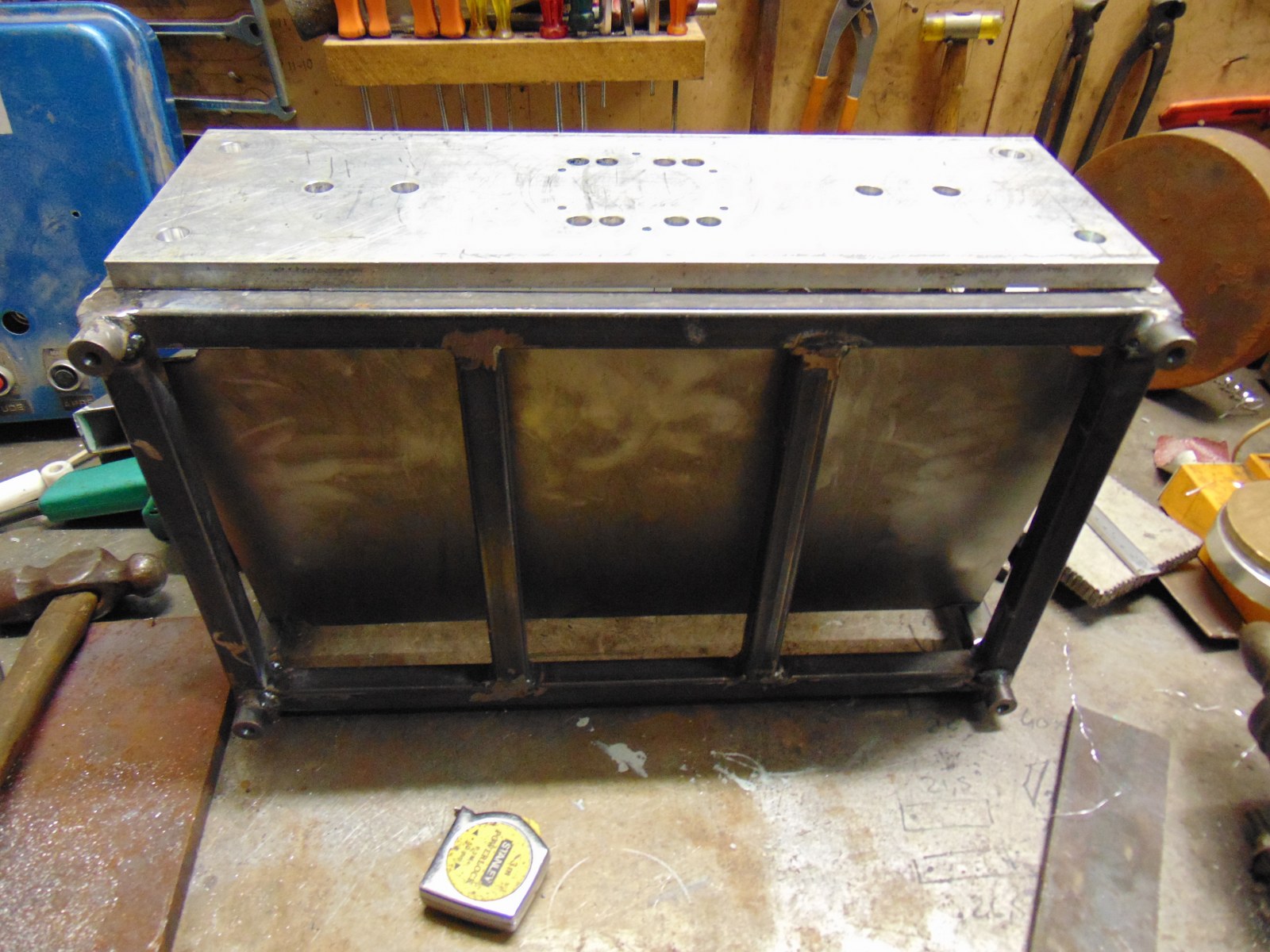

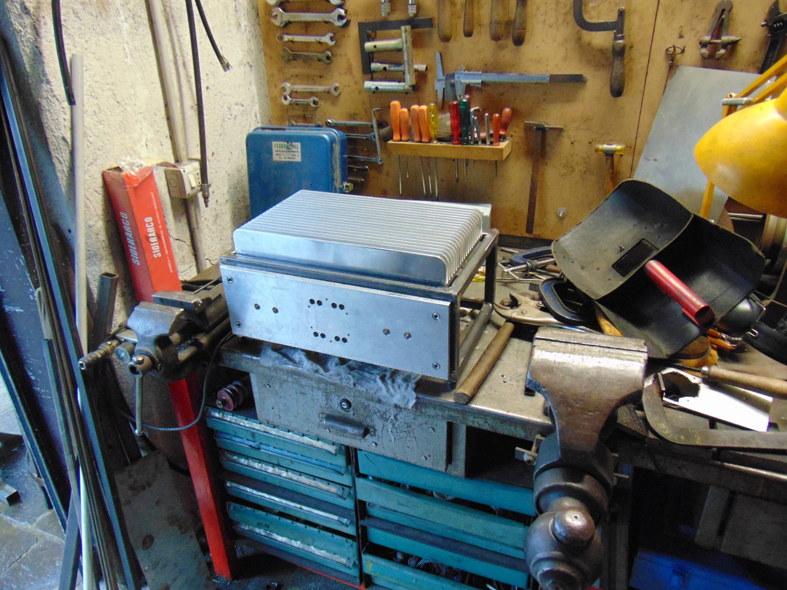

Hi all!

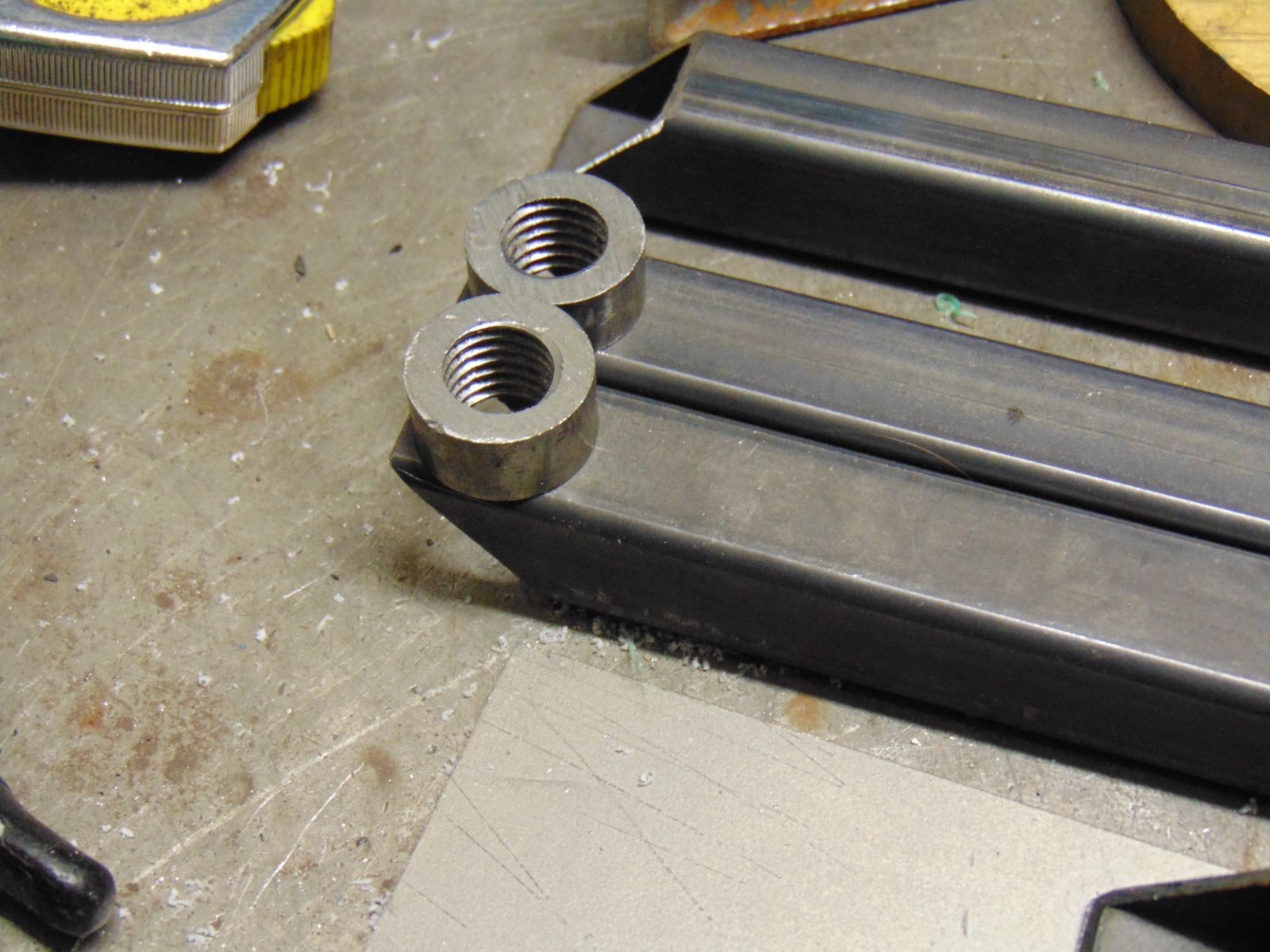

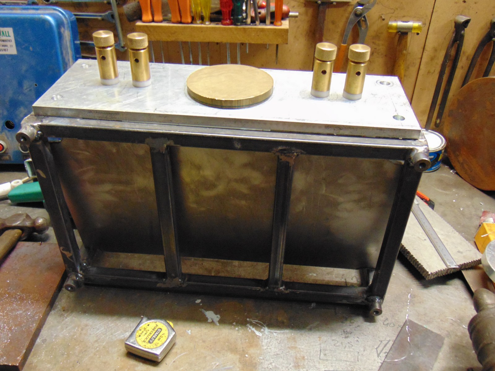

Tonight I started the frame of the new amplifier.

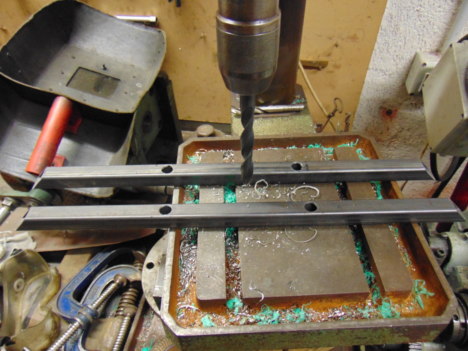

Square steel tube 20x20mm, 2mm thick, sturdy. I wanted to add a very nice complication, the tubular frame will be completely insulated from vibrations by filling with river sand. I drilled holes for internal paths, four filling nozzles will be mounted on the back part of the amp.
I love to care for the details.
Attachment 17577 Attachment 17578 Attachment 17579
Attachment 17580 Attachment 17581 Attachment 17582
Attachment 17583 Attachment 17584 Attachment 17585
Attachment 17586 Attachment 17587
I always have loved the peace of mind and satsatisfaction that over-engineering gives me. Tell me I have a compulsive disorder, I don't care. Glad to see that I am not alone. Good idea.

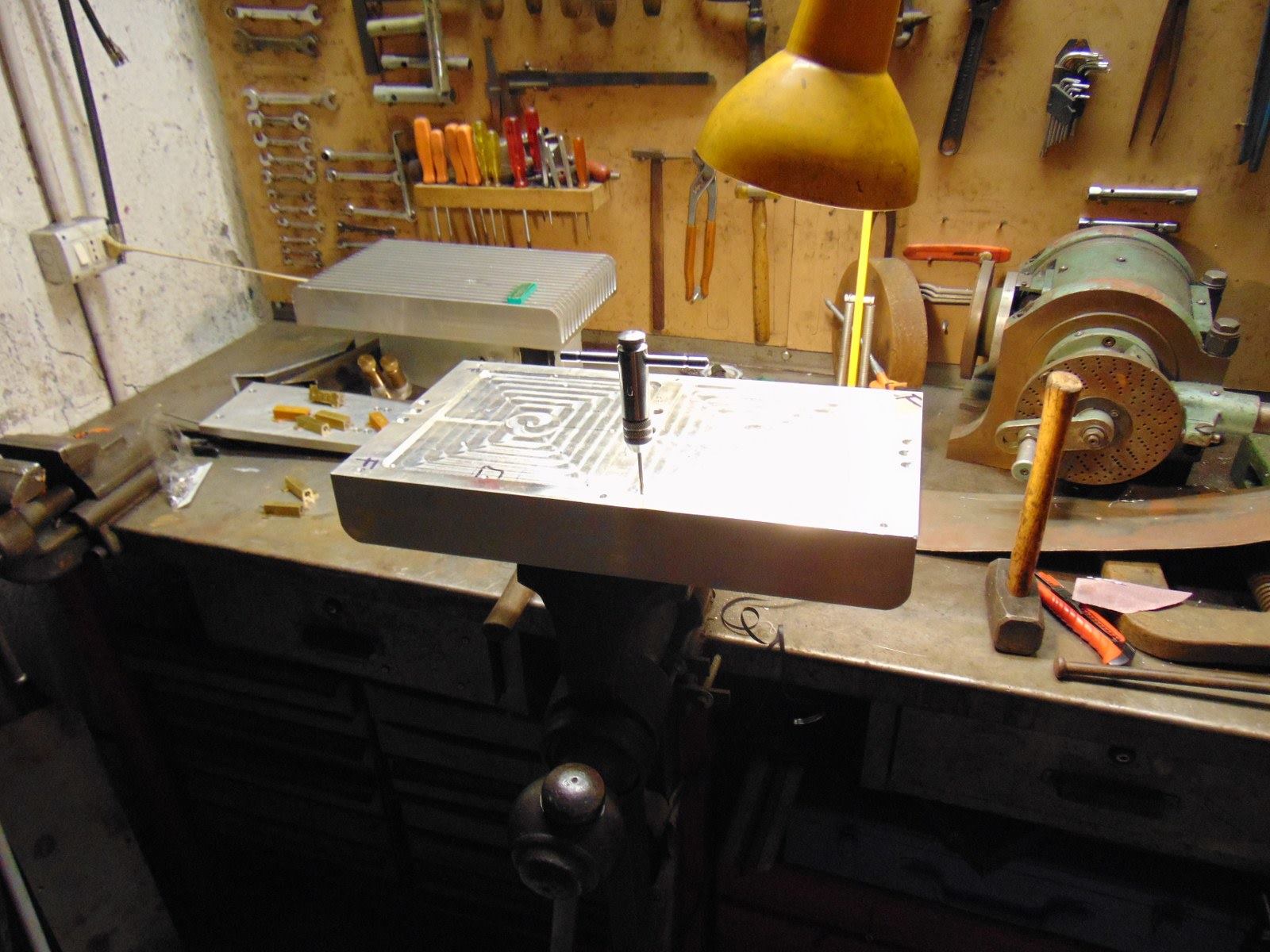

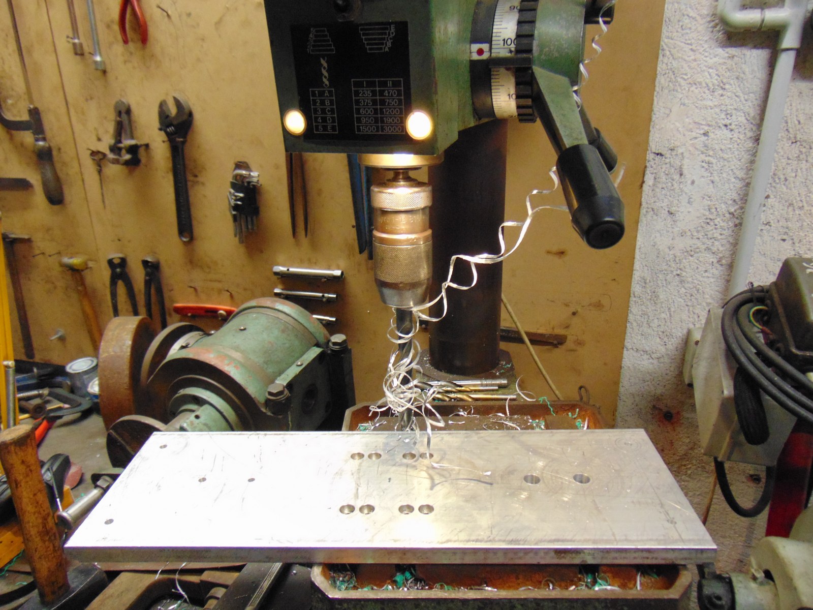

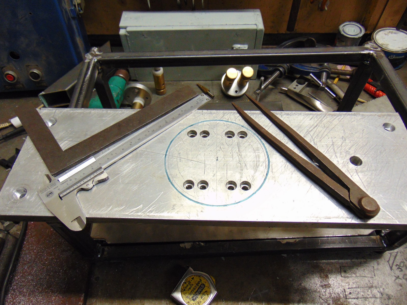

10 Attachment(s)

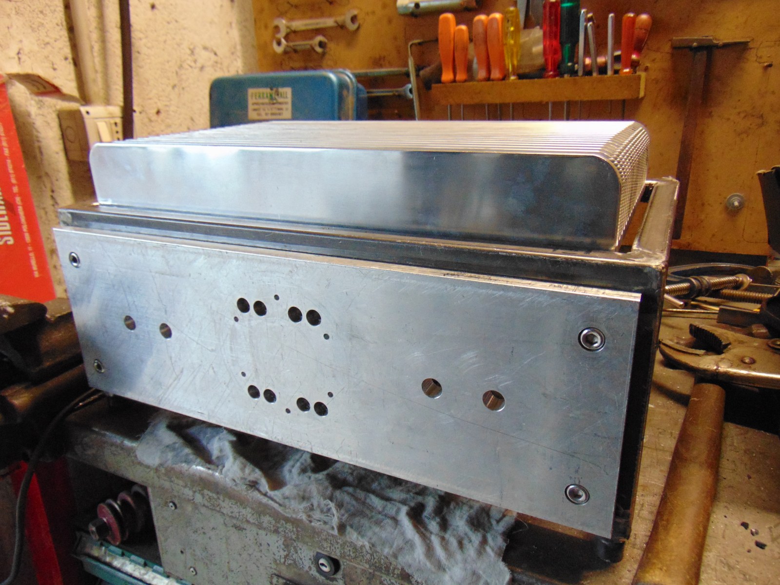

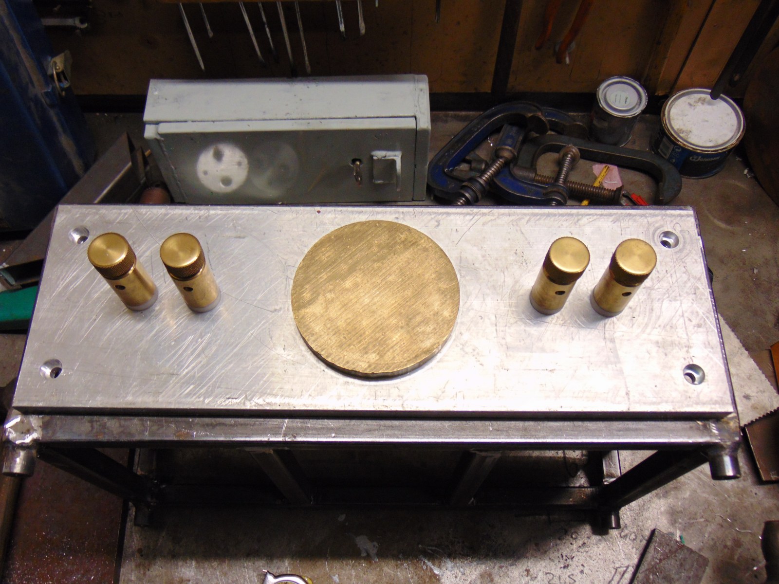

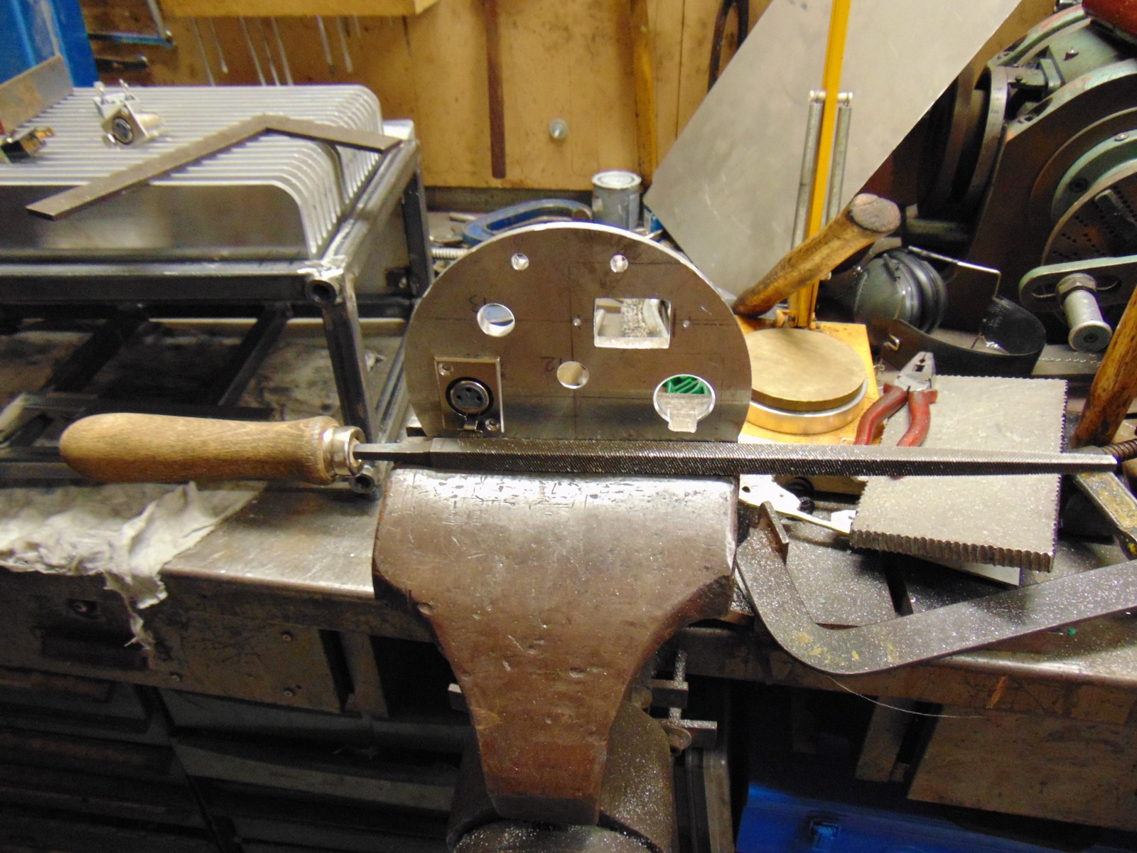

The amplifier begins to take shape!

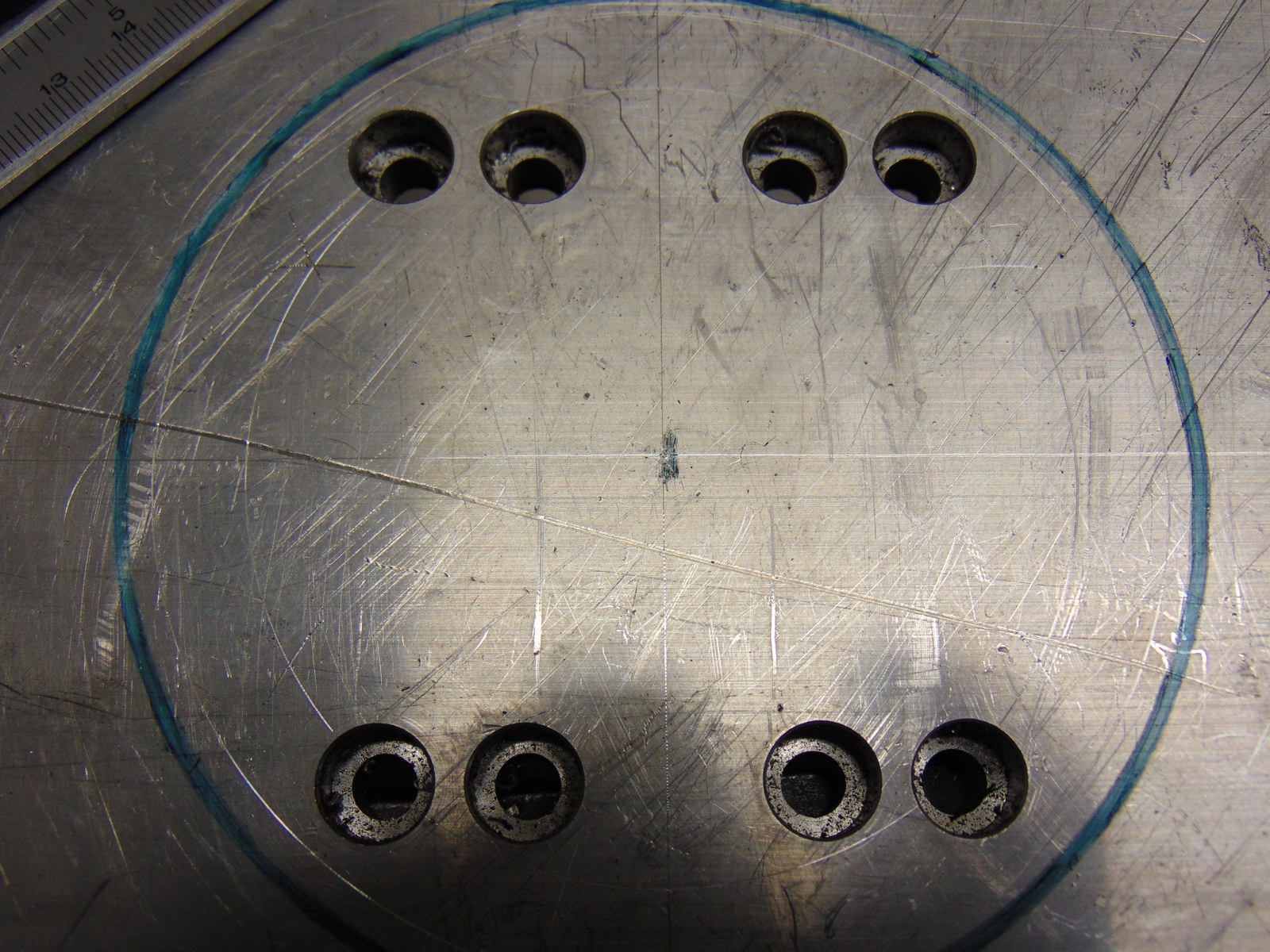

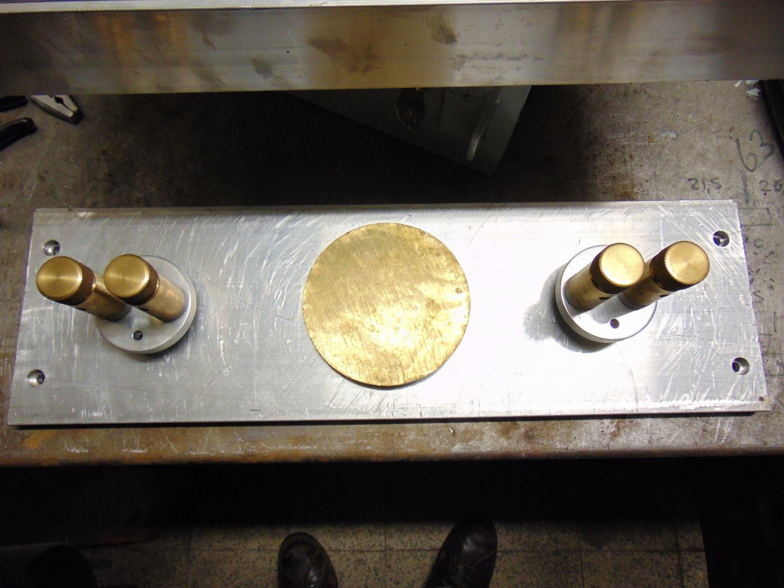

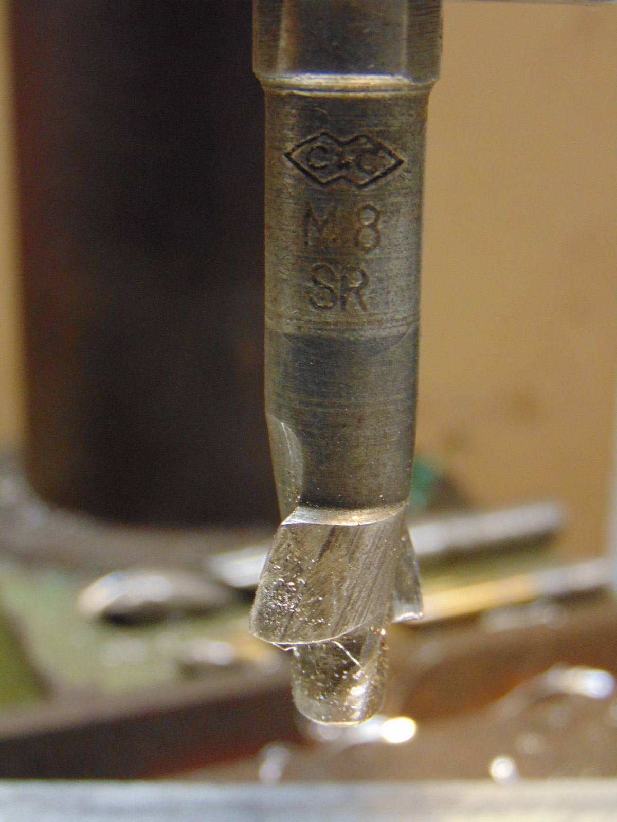

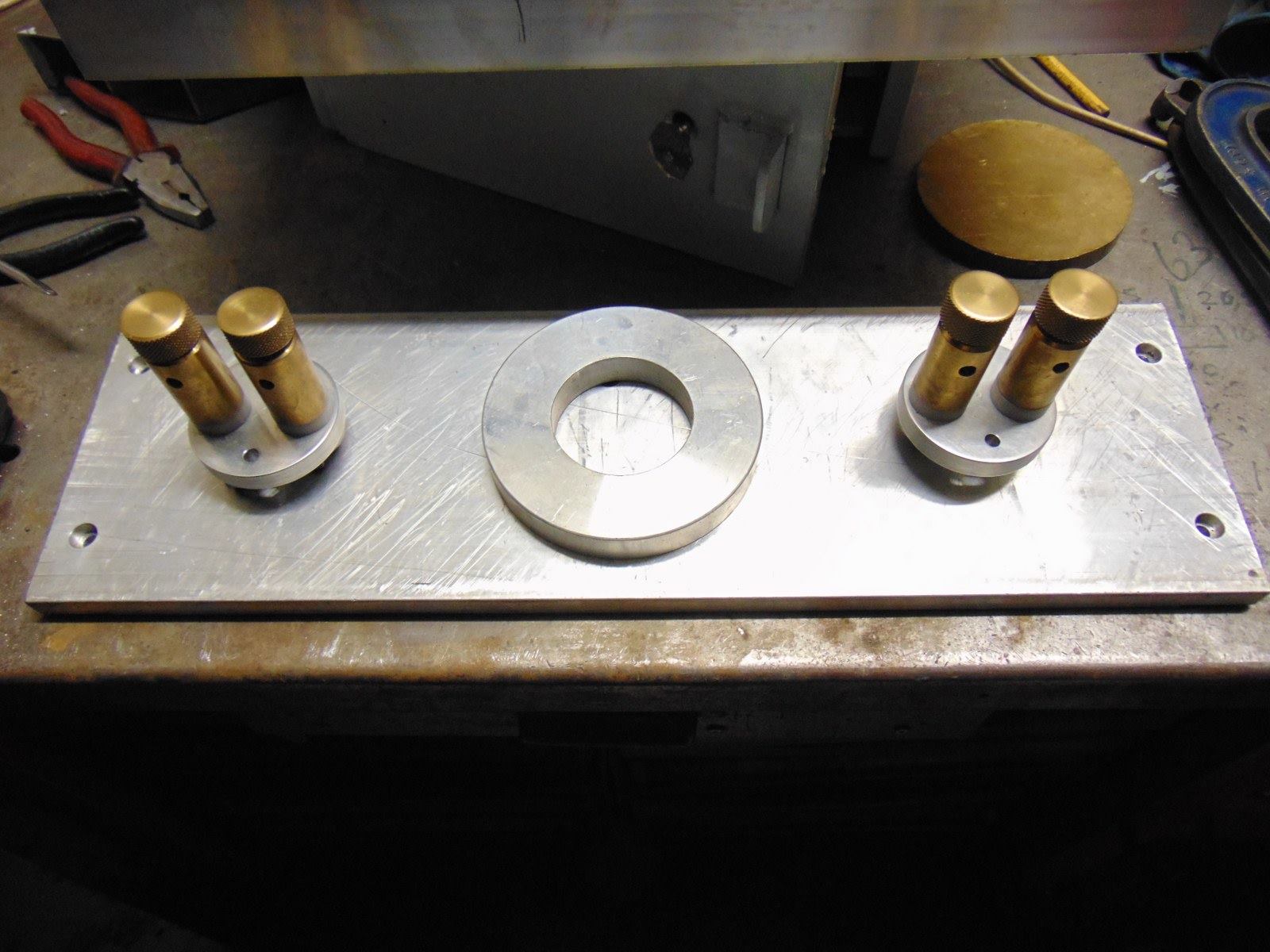

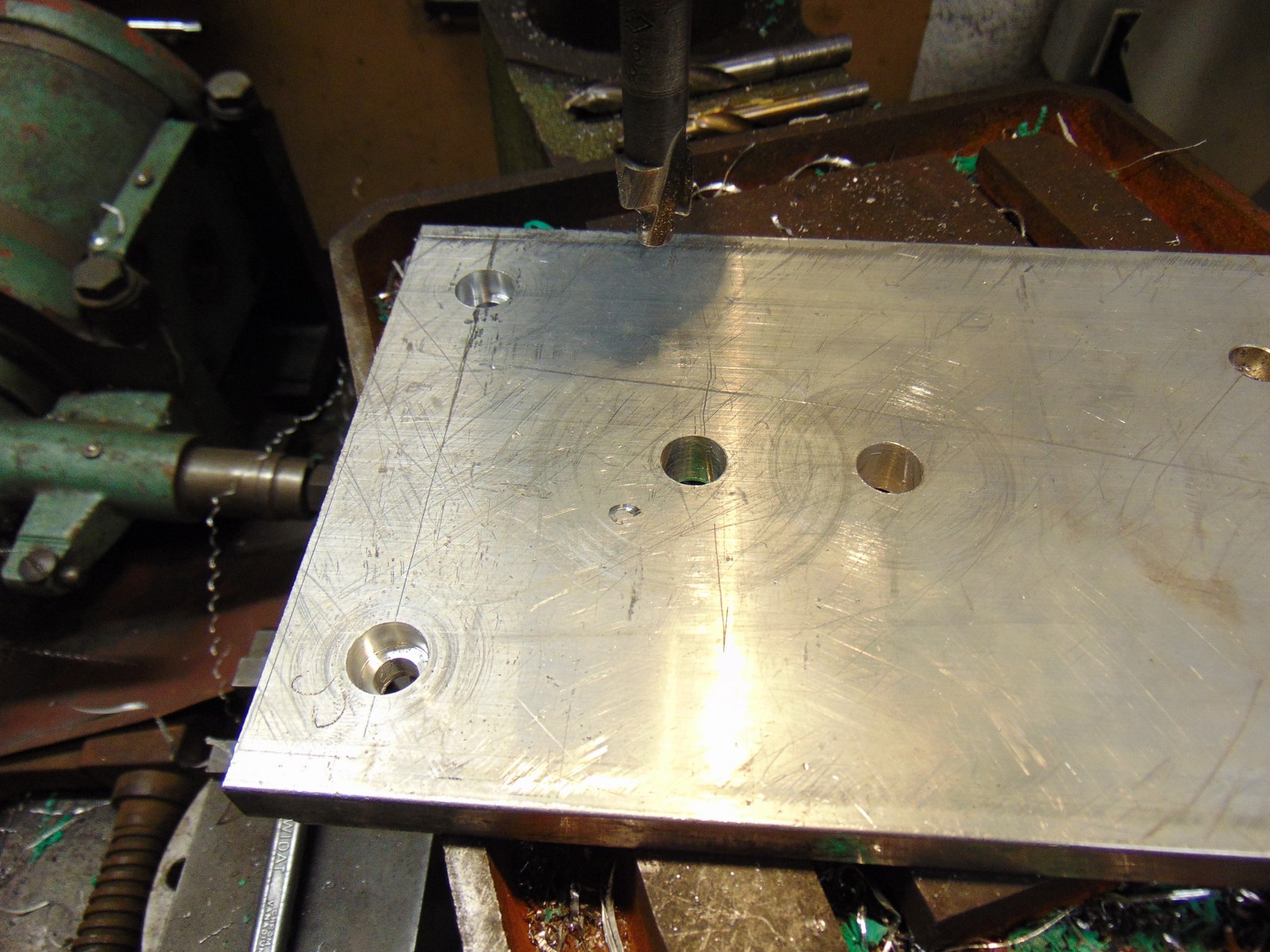

The front panel is 15mm thick, I want to make a high pressure style porthole, not because it's audiophile but because I like it. Heads of allen screws (lateral) will be aligned with panel, the screws of porthole will be external.

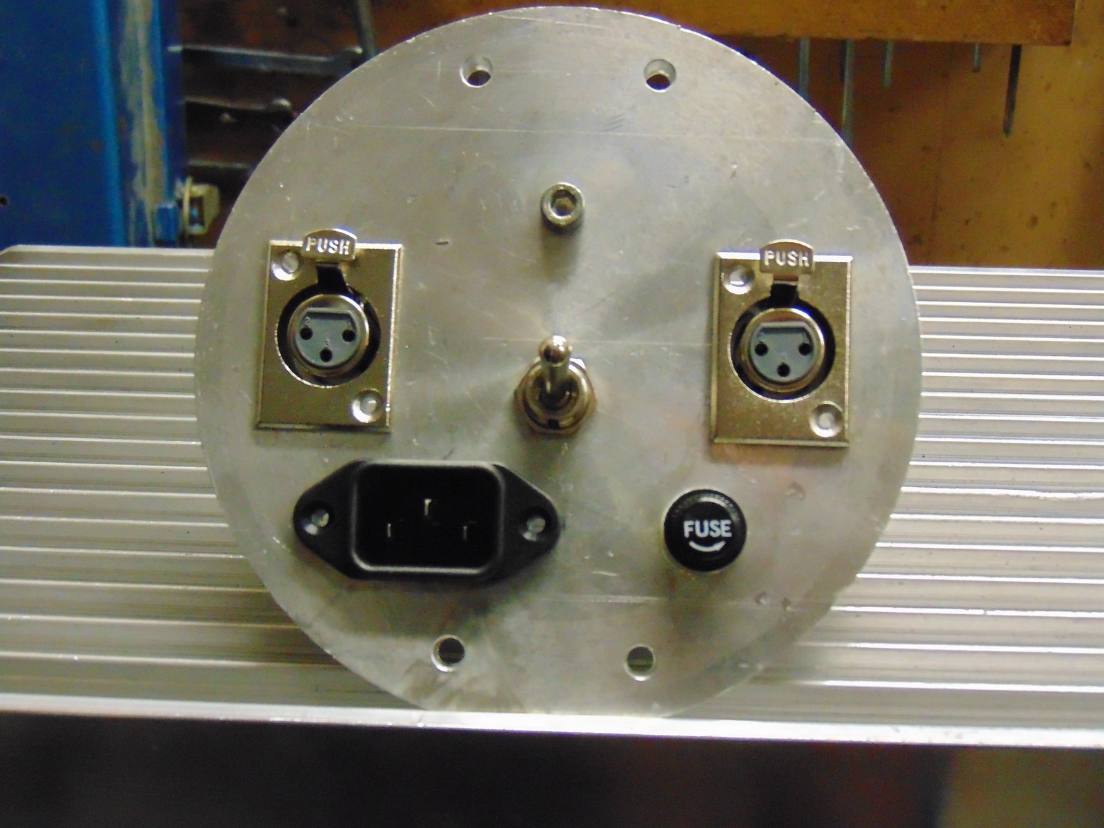

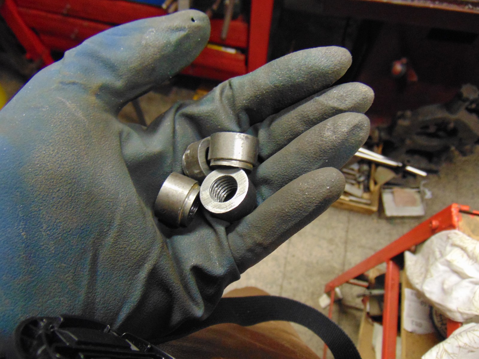

I'm still undecided about rear panel and sides. For the sides got some carbon fiber plates or good wood (teak, oak and walnut). I don't want to use a full size rear panel, I still prefer a short one with all connectors attached and the back open air. There is not need to cover, no high voltage inside, main voltage parts will be insulated. Binding posts are granade style, 25mm dia I made some months ago with lathe.

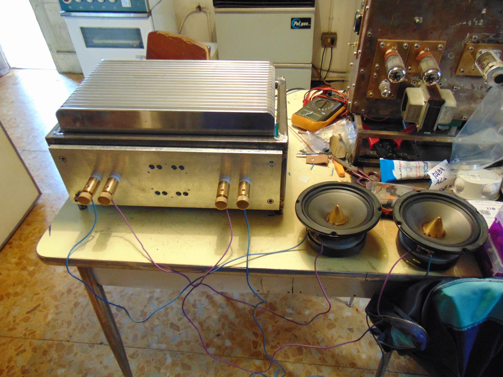

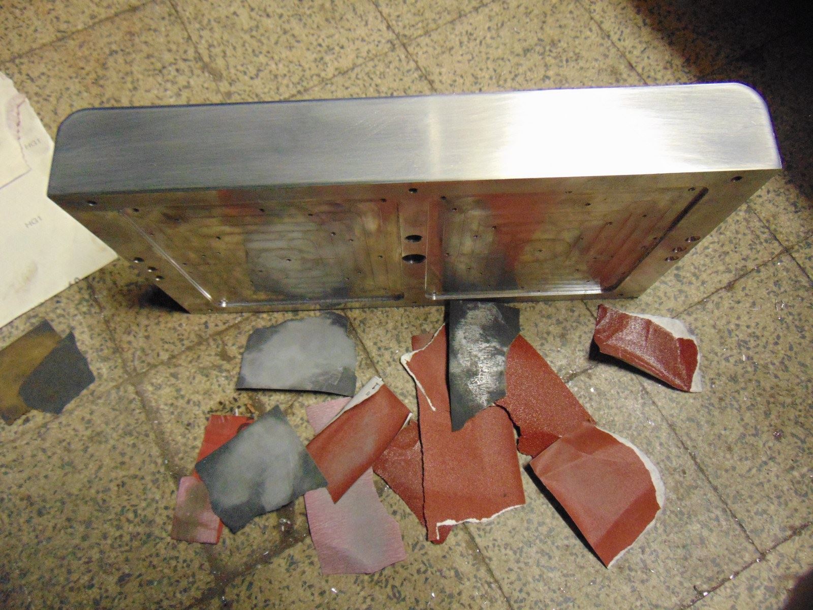

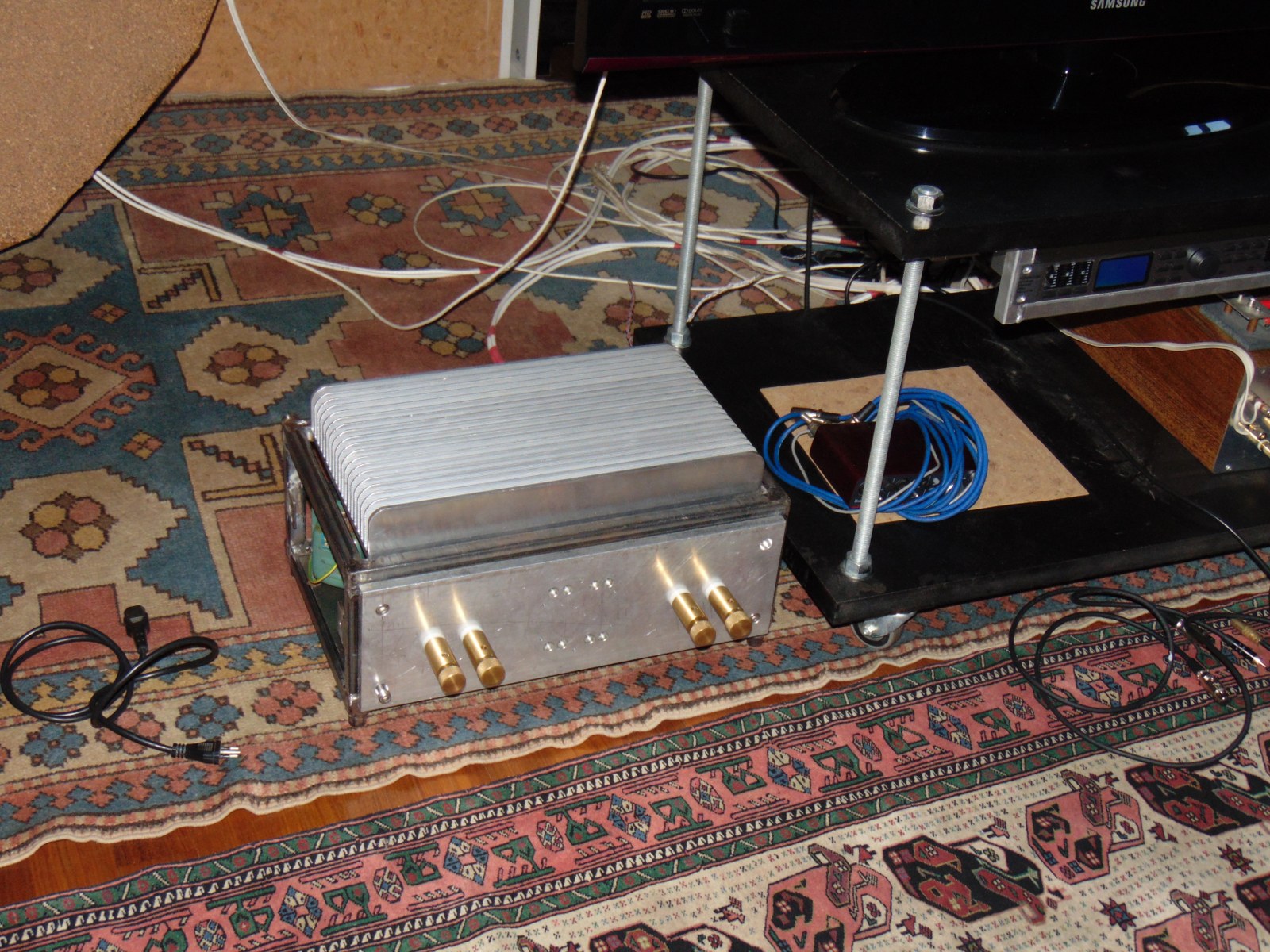

New update!
The prototype is running!
Unluckily I have no time now for playing some music with my horns. I tested one hour this afternoon, The impression is pretty positive with cones on table, but I want to make some break-in and wait the Thermal stabilization before saying something about sound. Amplifier take 30 min more or less to reach temperature, power supply is dual 13v dc, power output should be around 2,5\3w, the 250v 1A fuse is still good. I understand now the words of mr Pass to pur resistor on a separate heatsink, the greater the amount of heat comes from them. No hum, no strange sound even with long and not shielded cable inside (put with no sense, due to have power supply and transformer free to move).
