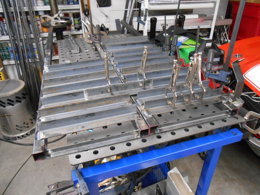

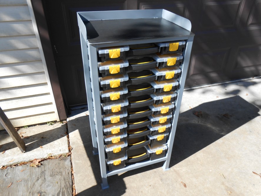

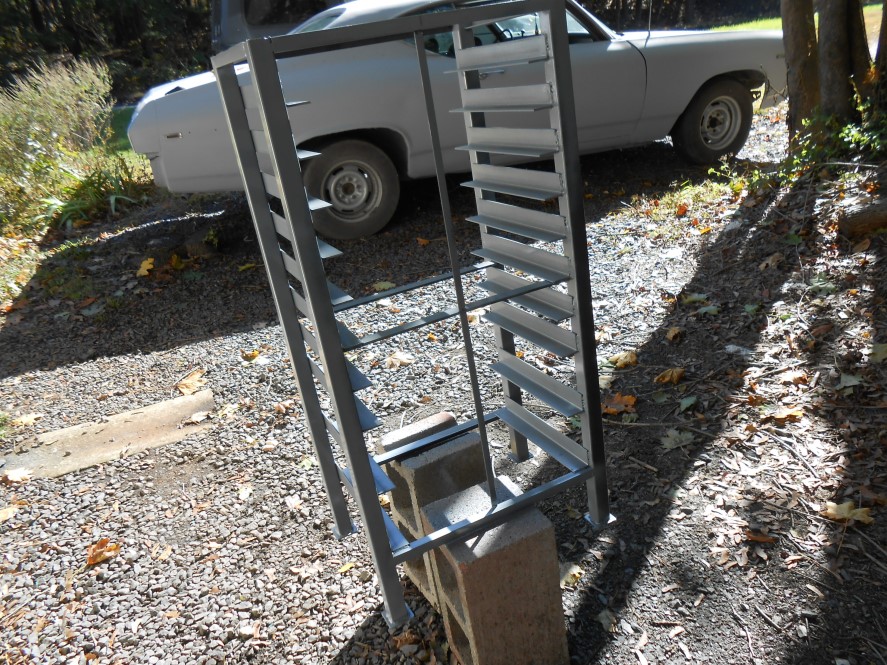

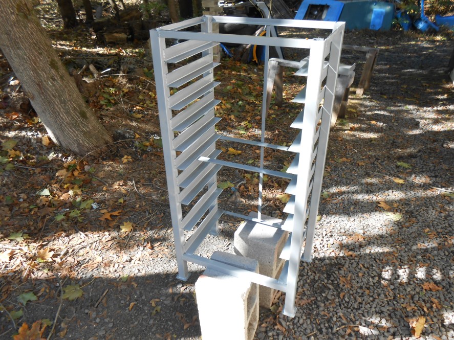

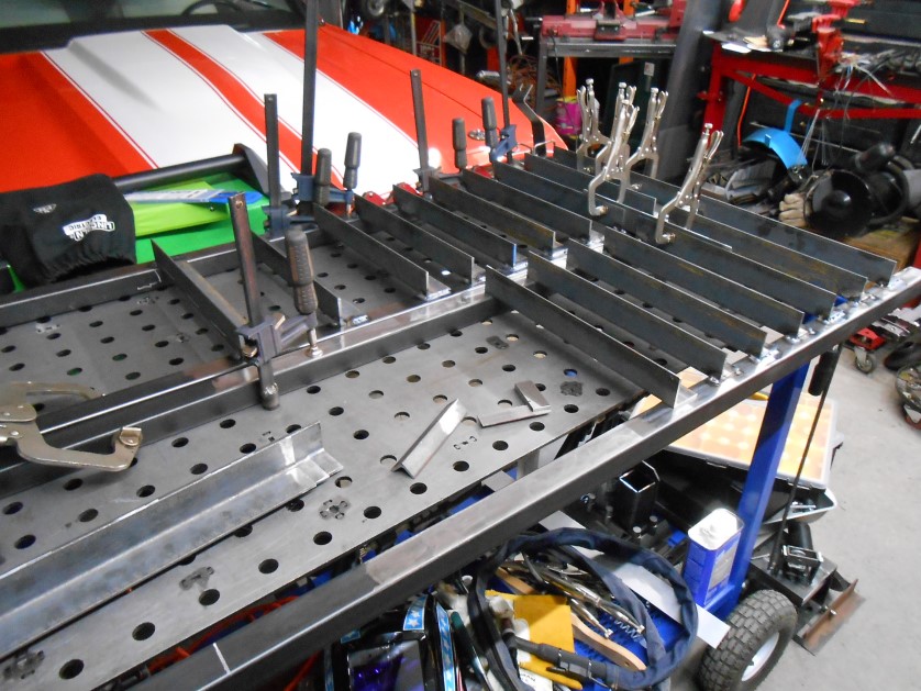

It seems everyone who's anyone these days on you tube has built a "Sortimo" rack. Most people make them from plywood, I was looking for something to practice Tig welding on so I made mine out of 1-1/4" 16ga steel square tube, 1-1/2" angle iron and the top from 14ga sheet. It should withstand WWIII. :D I was originally going to enclose it with sheet metal but I really like the "skeleton" look it has.

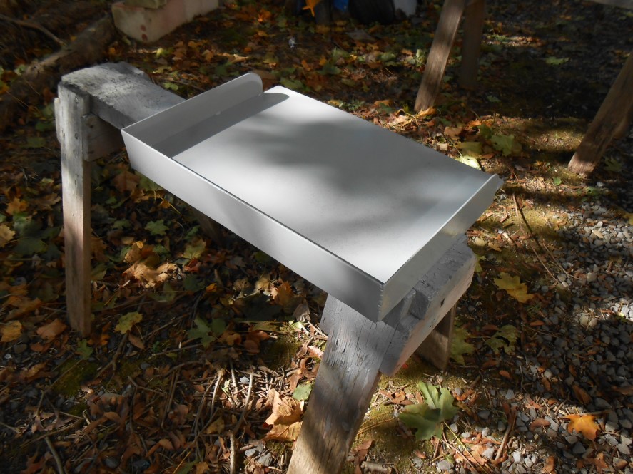

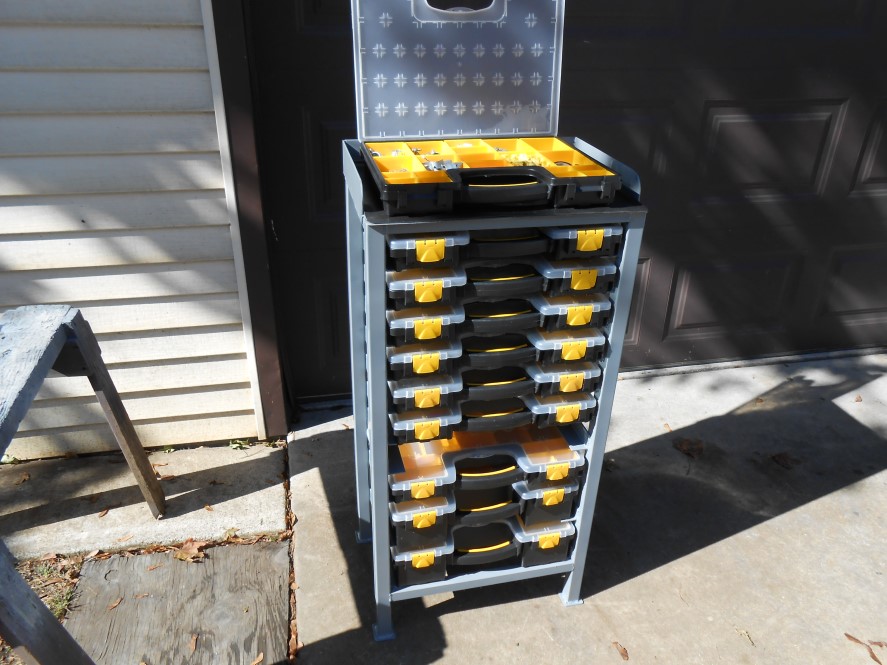

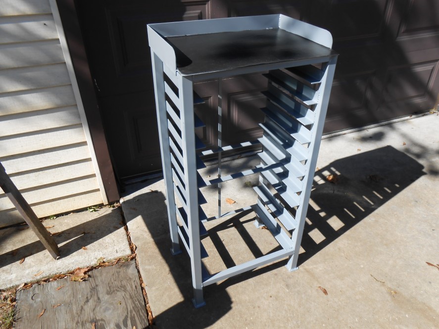

It features a wash basin style top so you have a place to set the case when picking the item out you need. (trick here will be to keep that top shelf CLEAR! LOL)

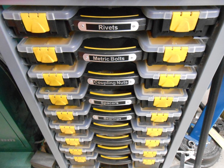

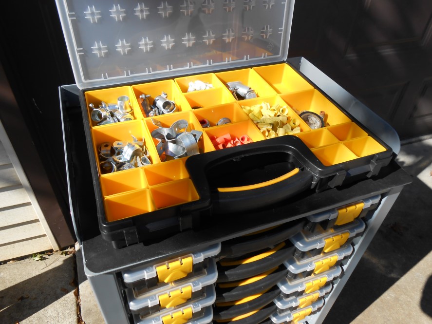

Cases are from where else, Harbor Freight. :p I have eight 20 bin medium cases and the bottom two are the large 8 bin units for a total of 10 cases.
