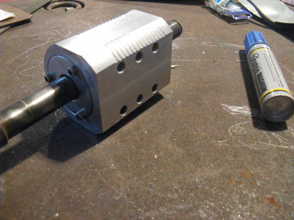

Soup can mandrel
Here is my mandrel which I will use to slow down my wood working Rockwell drill to make it more useful and easy to use in drilling metal at lower speed and with more torque. I poured aluminum that I heated in an old pottery kiln directly into a soup can. Then a buddy Rob,Attachment 3163 in Edmonton machined the flats and drilled and tapped the bottom for bolts. He also made pockets for the 3/4" I.D. bearings and fastened the large washers as retainers. During part of this he was giving me an excellent tutorial on how to setup and run the Haas CNC mill. Naturally I immediately forgot a bunch.
Cool stuff. That's a nicely cast piece.
Al
Thanks again for the kind remarks. This is the first forum I have ever truly participated in. I like that everybody keeps it clean> As it says in the country song " If your going to throw dirt you are going to lose ground."

That's homemade? Great work!
I like it. The ribs from the can are stylish.
Thanks for sharing, ALUMINIUM ROCKS
So cool, I like how you left the ridges on the casting, kind of "Andy Warholish" It looks exactly like something that would fit on my Gingery mill quite nicely.
