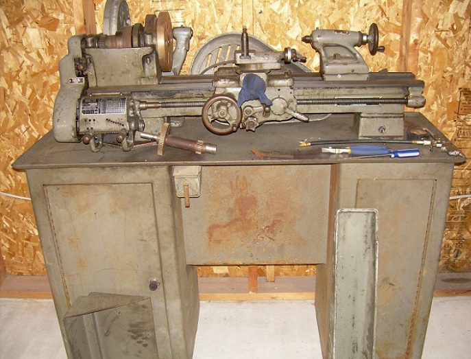

I did most of the way cleanup by hand. I used scotch pads and soft bristled brushes. The bed portion was done with a pneumatic wire brush. The bed casting had the most flaky rust. It was one of the last pieces I did so I rushed through it. If you have significant rust, I would recommend electrolysis. You can make a quick setup with a battery charger, baking soda, and a scrap piece of steel. There are several write ups and videos on how to do it. I did all the other parts that way and it made clean up very easy. The rust disappears and it doesn't remove any extra metal. My bed was 4' long and I didn't have a big enough bin to submerge it in. If I wasn't in a hurry, I could have built a large wood box and lined it with plastic. In the long run, it probably would have saved me time to build a larger bin for electrolysis and it would have been a more thorough cleaning.
