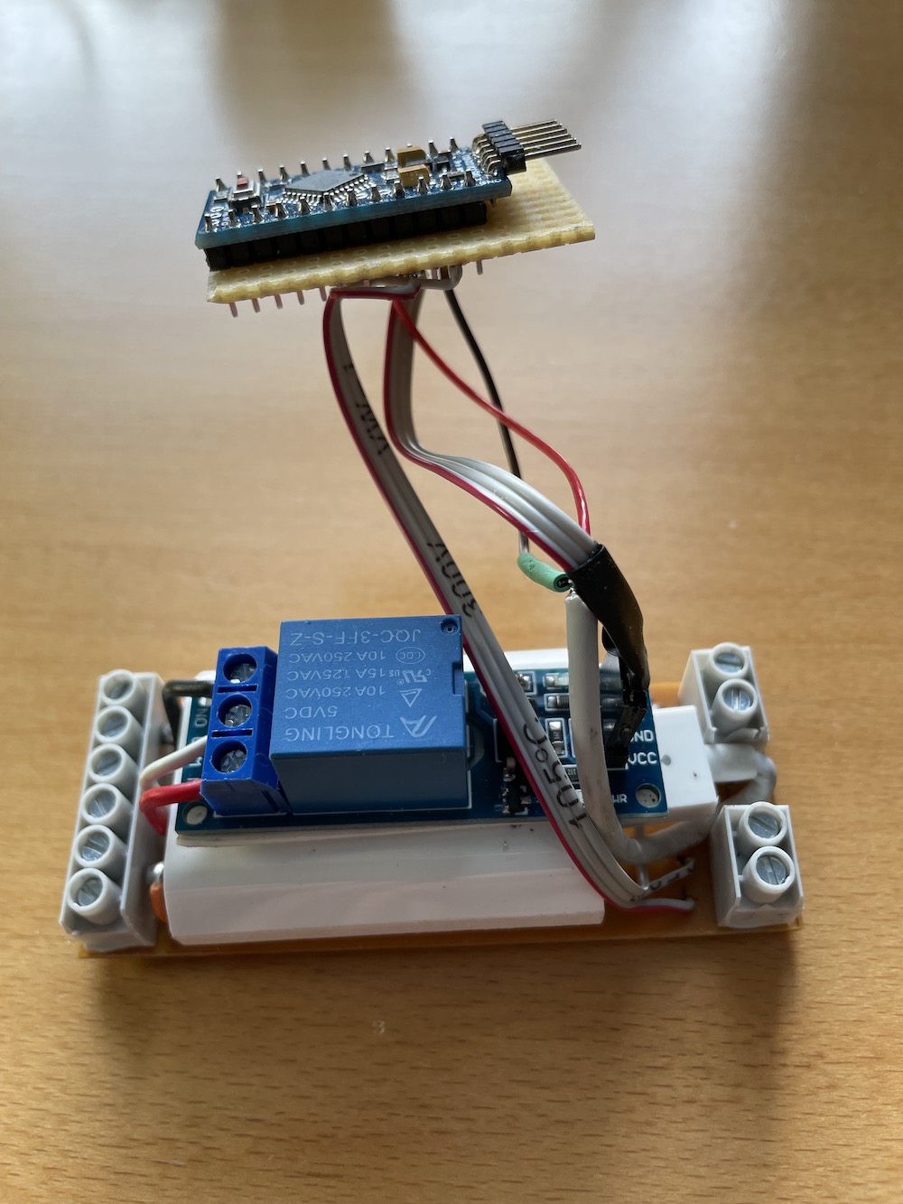

Here is a picture of the wired internal parts of the thermostat. The Arduino has the FTDI pins fitted so it is possible to reprogram it even when it is fitted in the enclosure. In order to be able to fit the iPhone charger the wall plug pins had to be shortened and the width of the charger filed from 35mm to 33mm. The relay board is mounted on the charger with double sided tape.

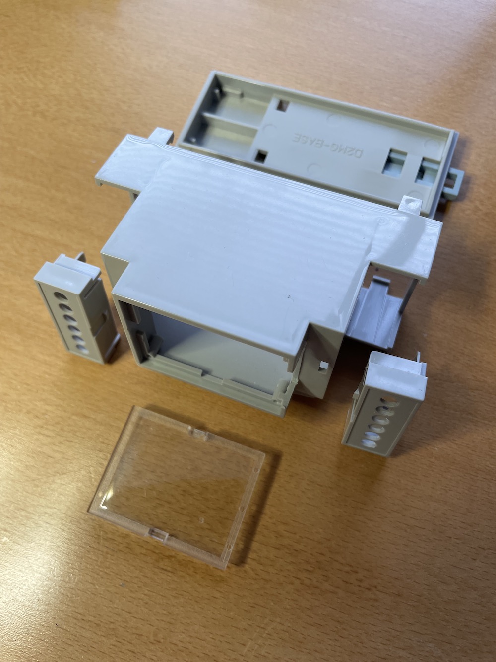

The Welleman D2MG enclosure.

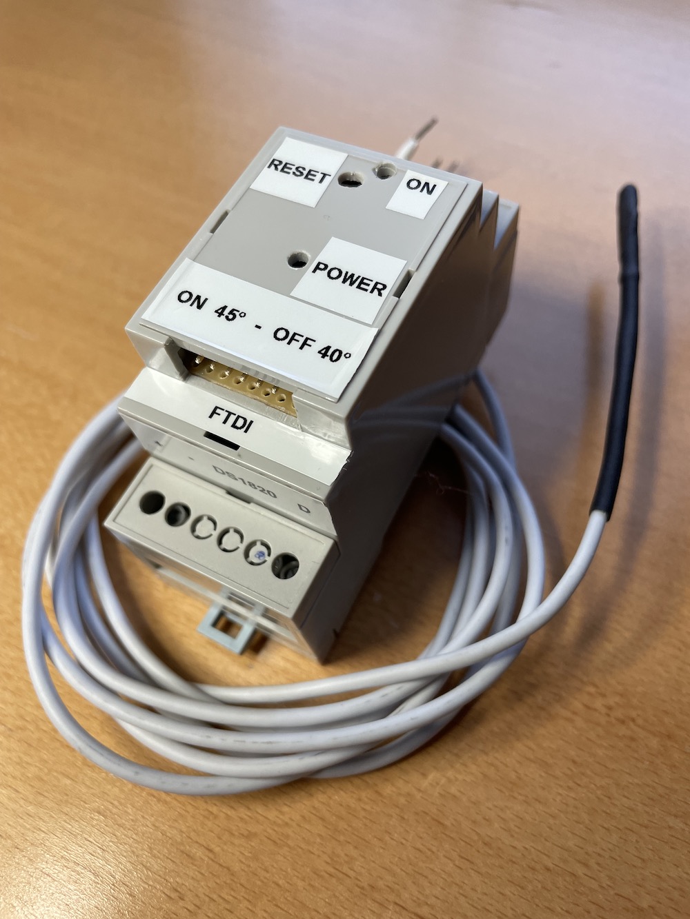

The assembled thermostat and sensor cabling.
