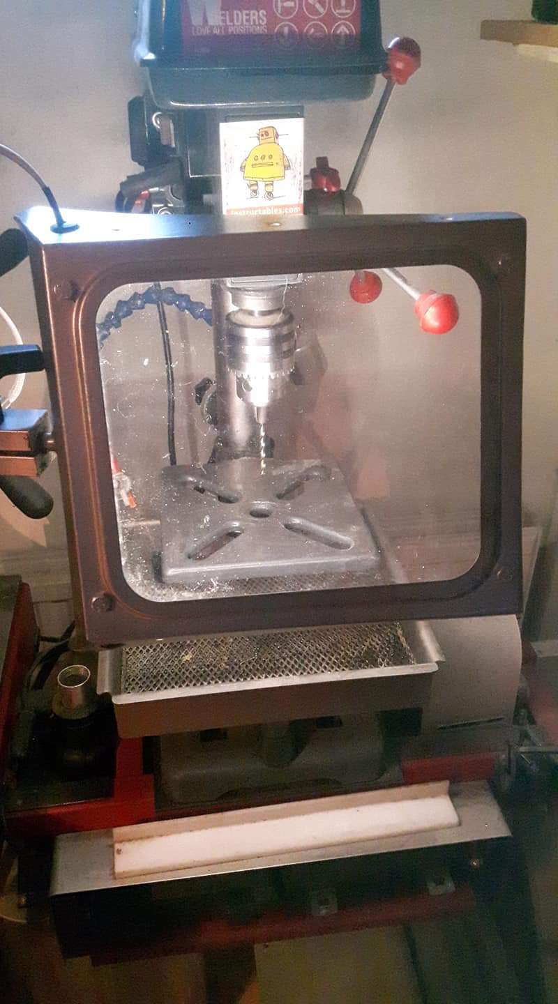

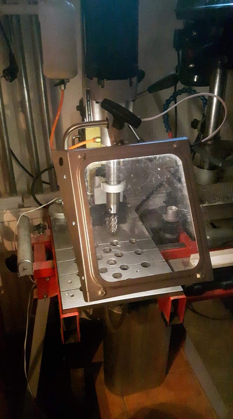

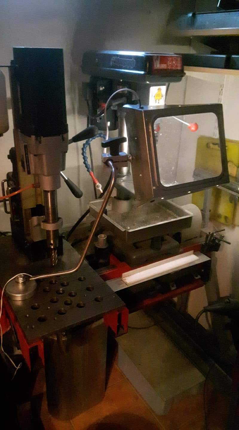

Splash guard..
Splash guard with light.
Light comes from led-stripe.
Connected to table with strong magnet.
I use it with dremels / rotary tools also.
Specially tungsten carbide cutters throw annoyingly sharo splinters.
Attachment 26860
Attachment 26861
Attachment 26862
Because use of magnet for mounting, its easy to remove or turn a side if its on the way.
