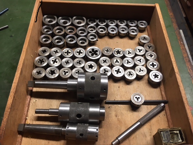

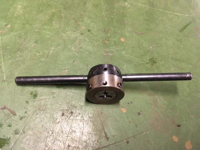

Hi All
This is the setup I use when using split dies.
About 20 years ago I spent a couple of days machining a couple of tailstock die holders and different size split die holders.
The idea is once the split die is set and cutting the correct desired size/fit, it remains in its own die stock holder until such time it becomes damaged or blunt.
If I haven’t got the correct size die set I simply grab another die stock holder and set it up. After it has been set and used it is stored in the draw for the next time it is required. The obvious advantage is once set, you know it will cut the same again and again. These can also be used in a standard hand held die stocks but the biggest advantage is the time and effort they save.
Attachment 21535Attachment 21536Attachment 21537Attachment 21538Attachment 21539

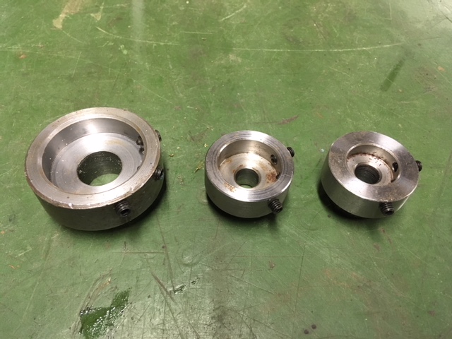

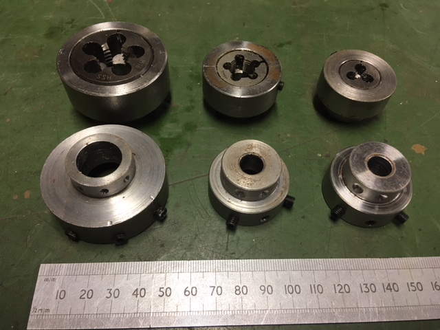

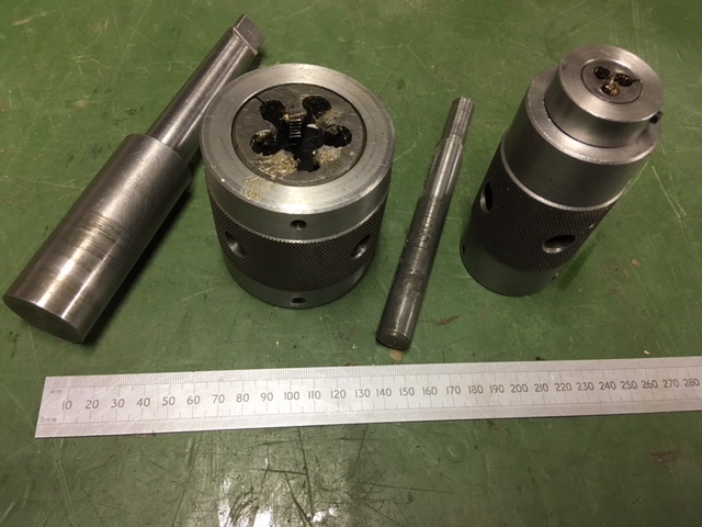

Split dies can be adjusted to give different types of fit. You can either spread the die open which makes the cut thread a tighter fit in the female mating part or compress the die to make the die cut more material hence making the thread slacker/looser fit. So, they need to be set each time they are removed from the stock. To overcome this, I made the die holders. This makes life a lot easier especially if you are constantly needing to change thread sizes. Set once and leave once set.
There are three grub screws set around the outer diameter of the stock. The two outer plain cup screws compress the die and are set at 90 degrees apart and the middle cone grub screw fits in to the split in the die so when screw in spreads the die. This screw is set between the other two screws is set centrally to the plain cup screws (45 degrees either side)
So as a time saver once I have set the die to the desired fit I leave it set and it then cuts the same fit/size that I require every time.
I hope this helps your understanding if not please get back in touch
