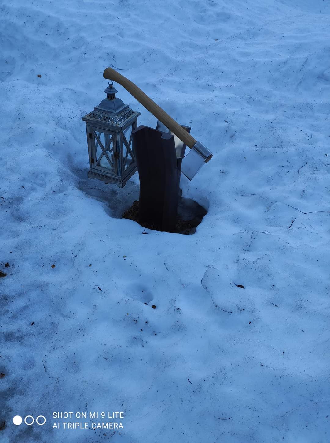

After first winter outsides, and its still the same.
Some dirt, but that's it.

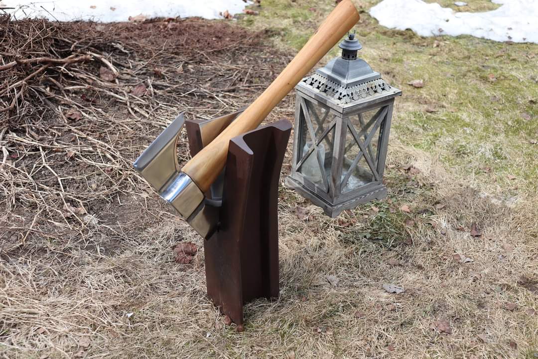

I made an upgrade.
New axe is also made from a railroad rail.
Now it fits better to the theme.
Attachment 39404

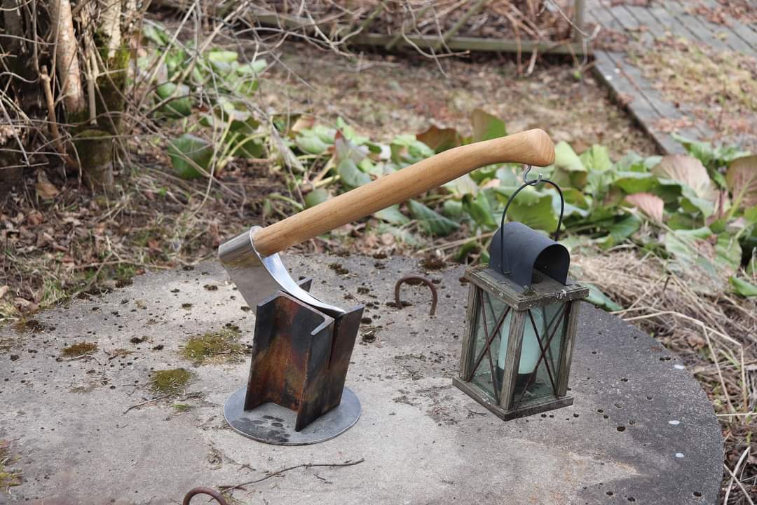

Old axe is weld to stand made from two u-channels.
Attachment 39405
