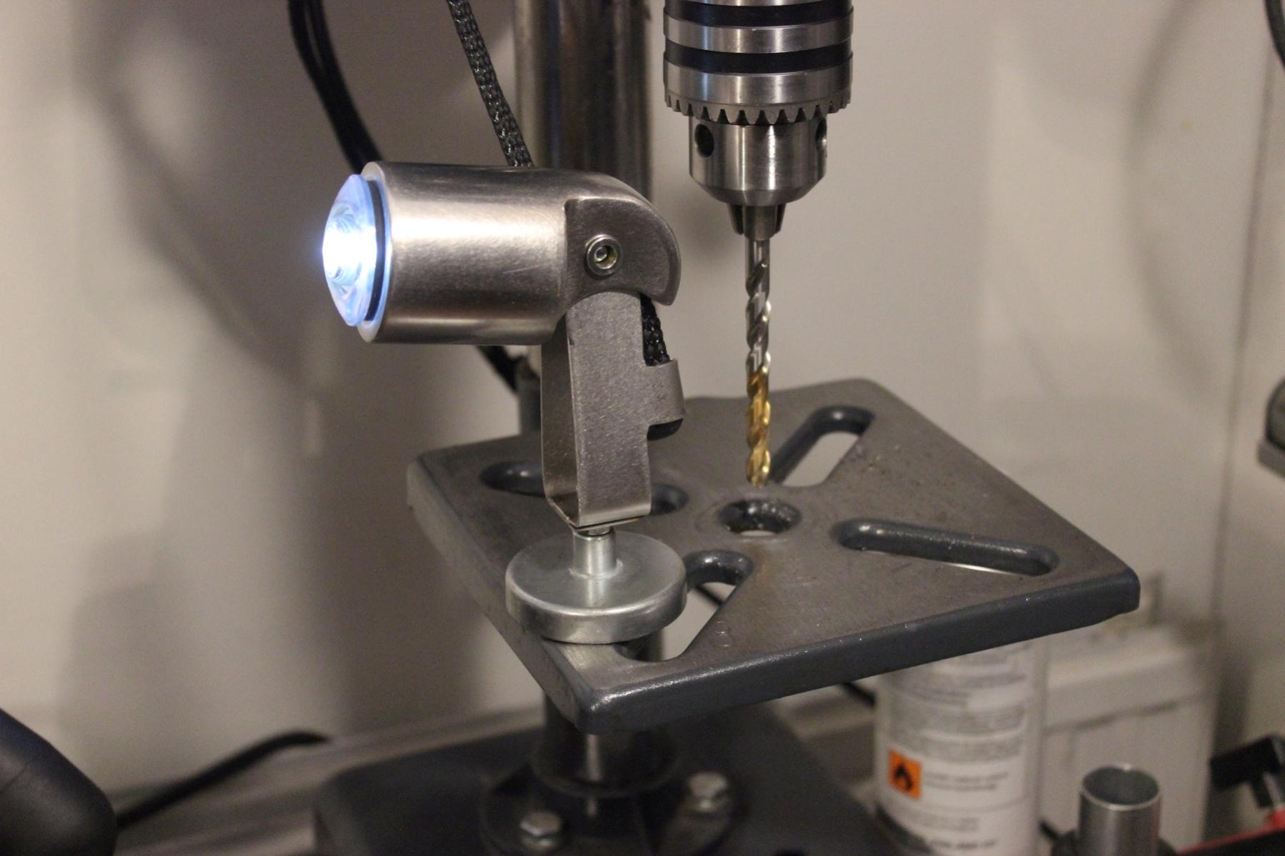

Made a spotlight.
It has magnet as a stand, so it can be mounted to metal objects near me when i need more light.
Used 12v led, transformer, 45mm diameter stainless pipe with 1mm wall and 0.85mm stainless sheet.
Welds with tig.
Magnet was 3€, Led 6€ inc resistor.
Attachment 20644
