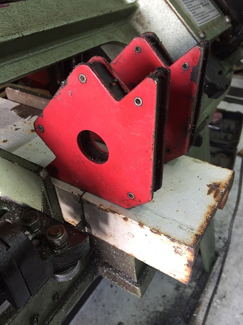

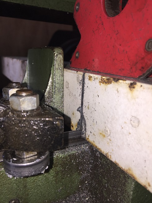

Not much of a tool, but works for me.
I hate it when the piece of metal you are cutting on your bandsaw drops to the ground.
What I do once the blade is blade depth into the steel is to use 2 magnets to keep the would be falling piece from falling and giving me the fright of my life.
Attachment 26207Attachment 26208
