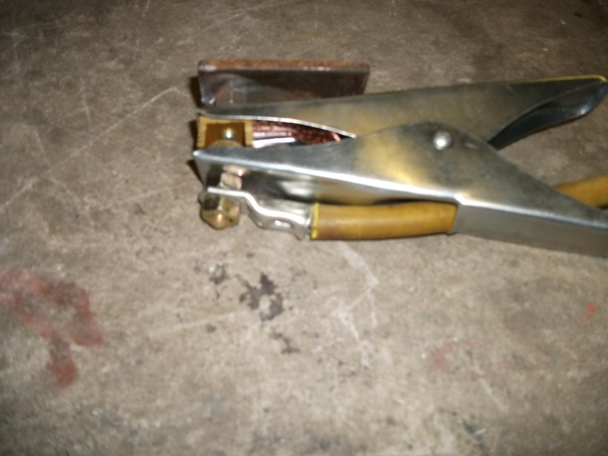

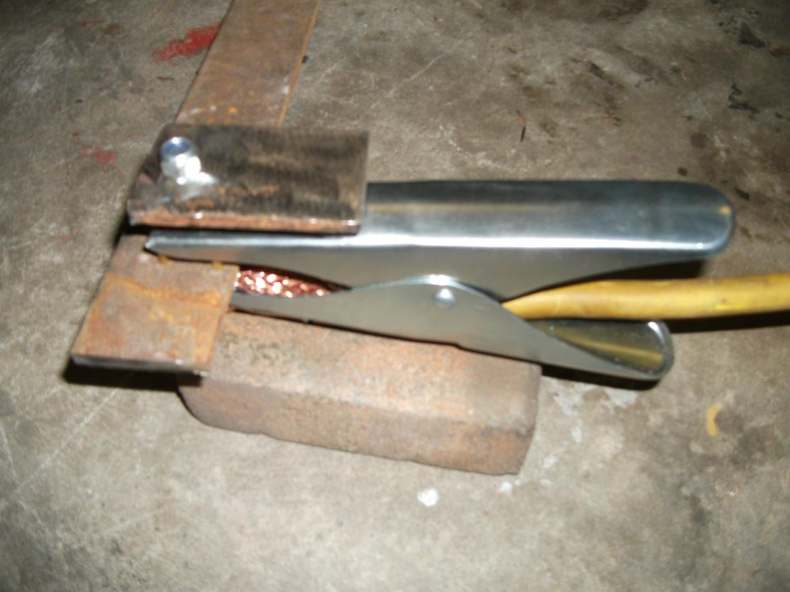

    striking plate for earth clamp on arc welder
    heres an earth clamp with a striking plate i made i normaly strike the new rod on the plate to heat it up and start off then transfer to the workpiece it saves marking the job with spatter
    Attached Thumbnails Attached Thumbnails striking plate for earth clamp on arc welder-004.jpg   striking plate for earth clamp on arc welder-001.jpg
