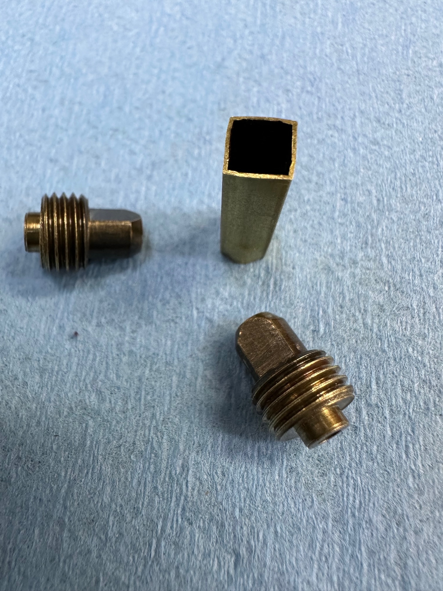

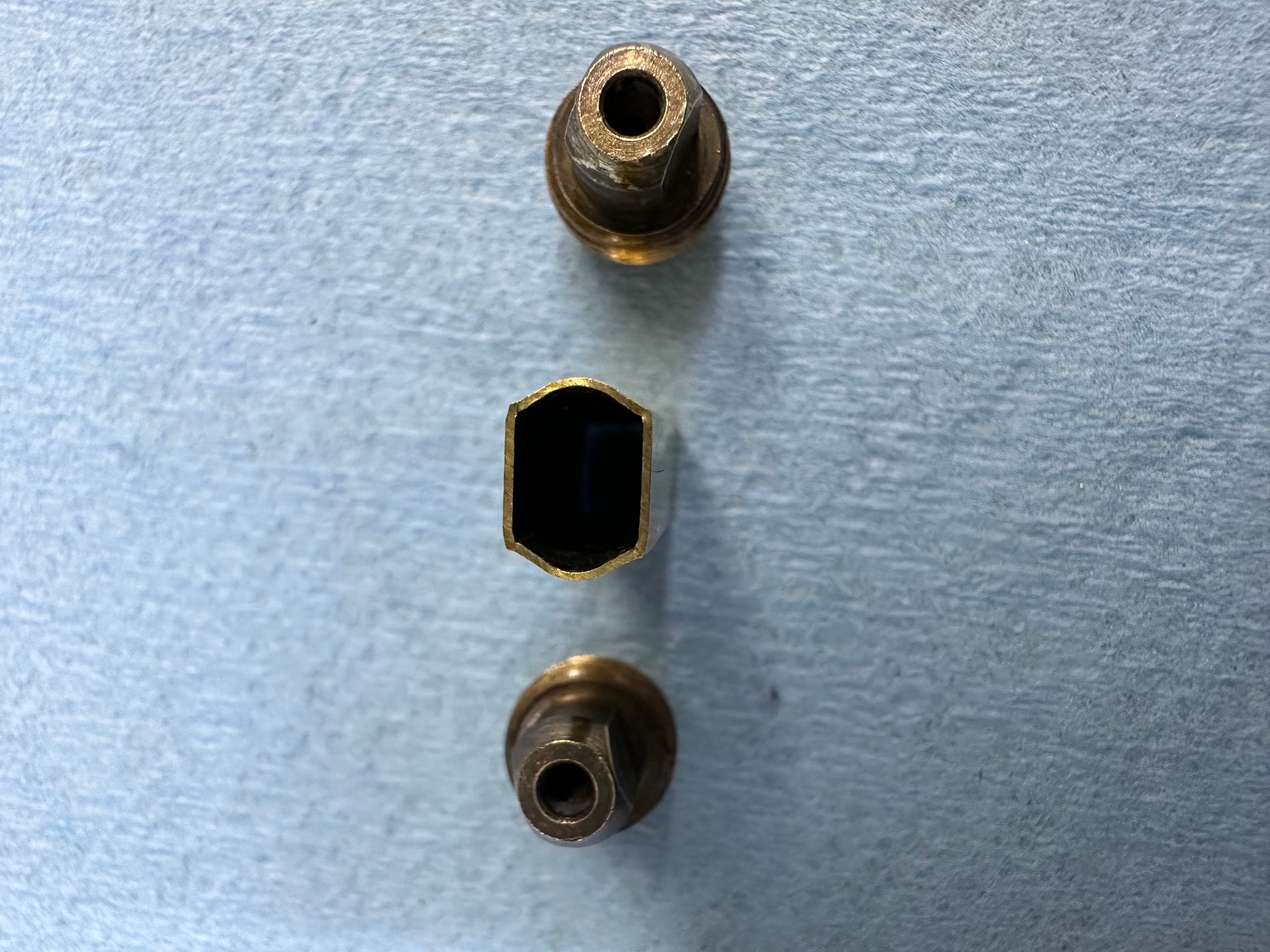

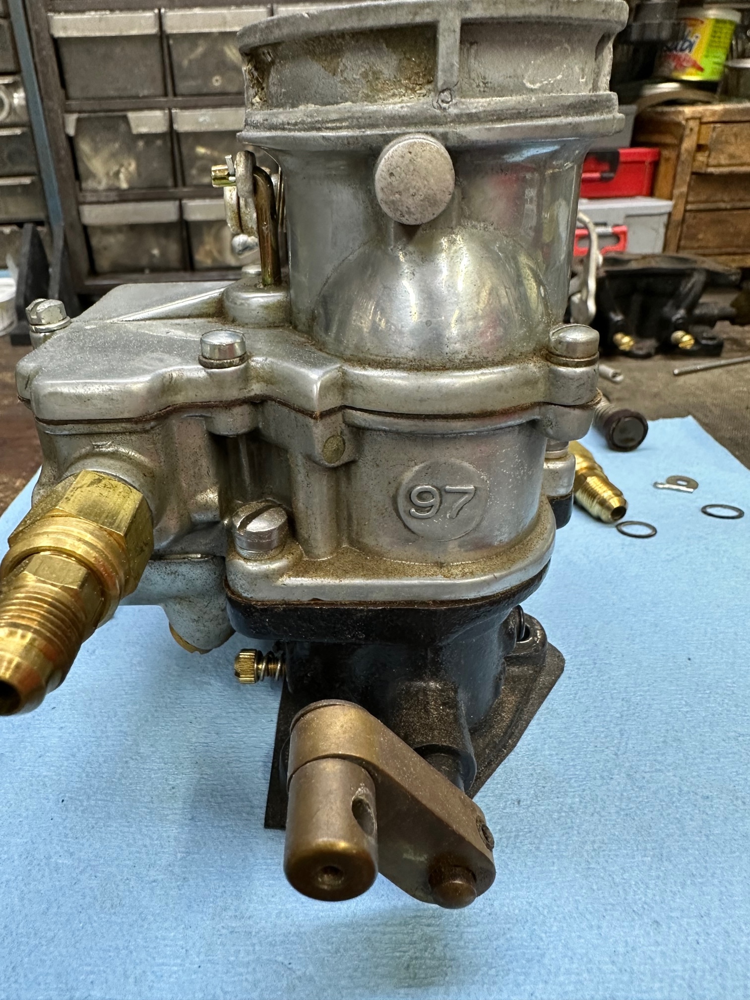

A client brought me his vintage wooden race boat with a flathead Ford equipped with Edelbrock heads, Offy intake and two Stromberg 97 carbs. The carburetors had been sitting with water in them over the winter. I tore them down to put them in the ultrasonic cleaner. The main jets require a special tool which I do not have.
Attachment 45786

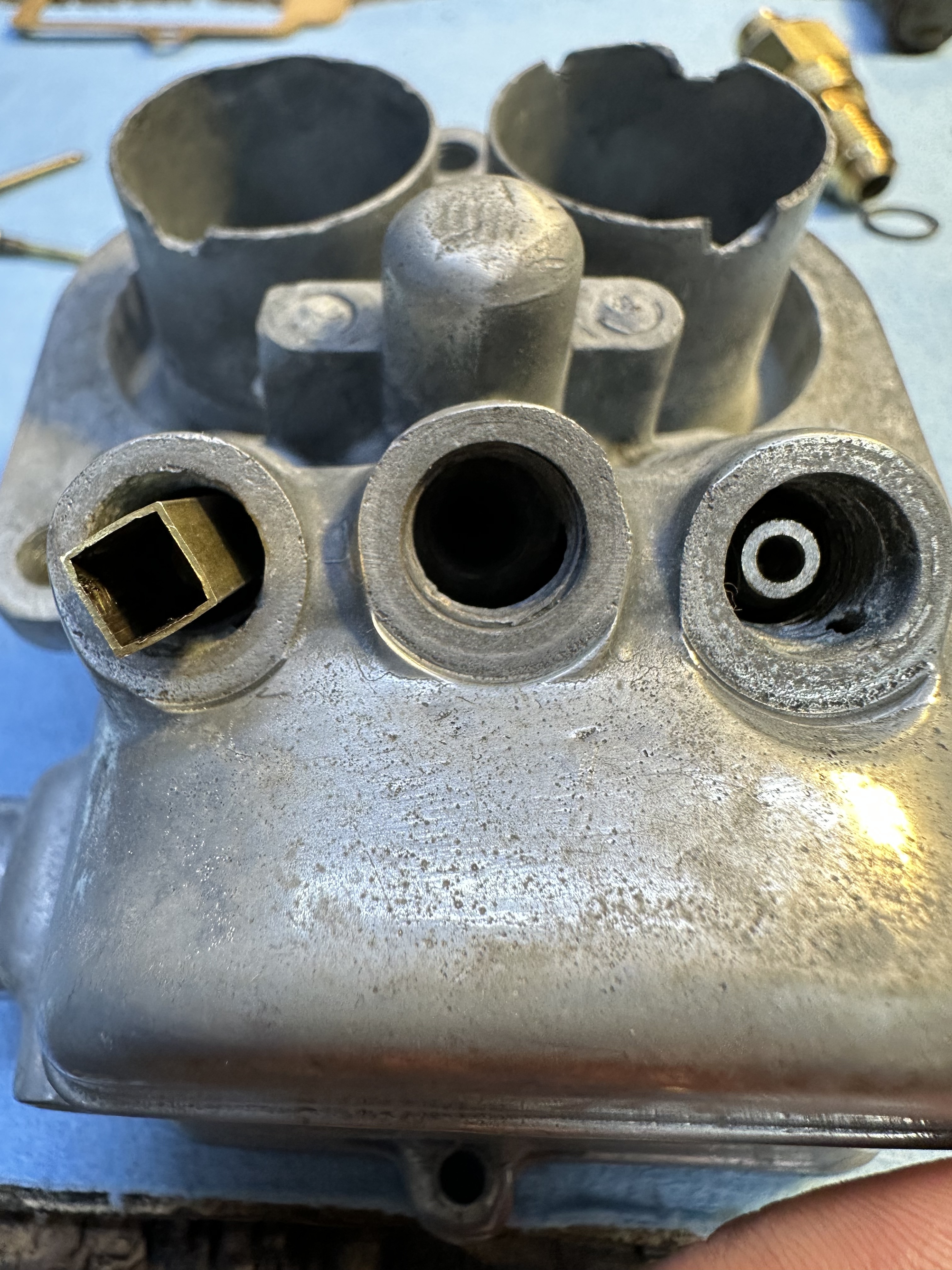

The cavity for the tool is small and I had nothing that would directly fit.
Attachment 45787

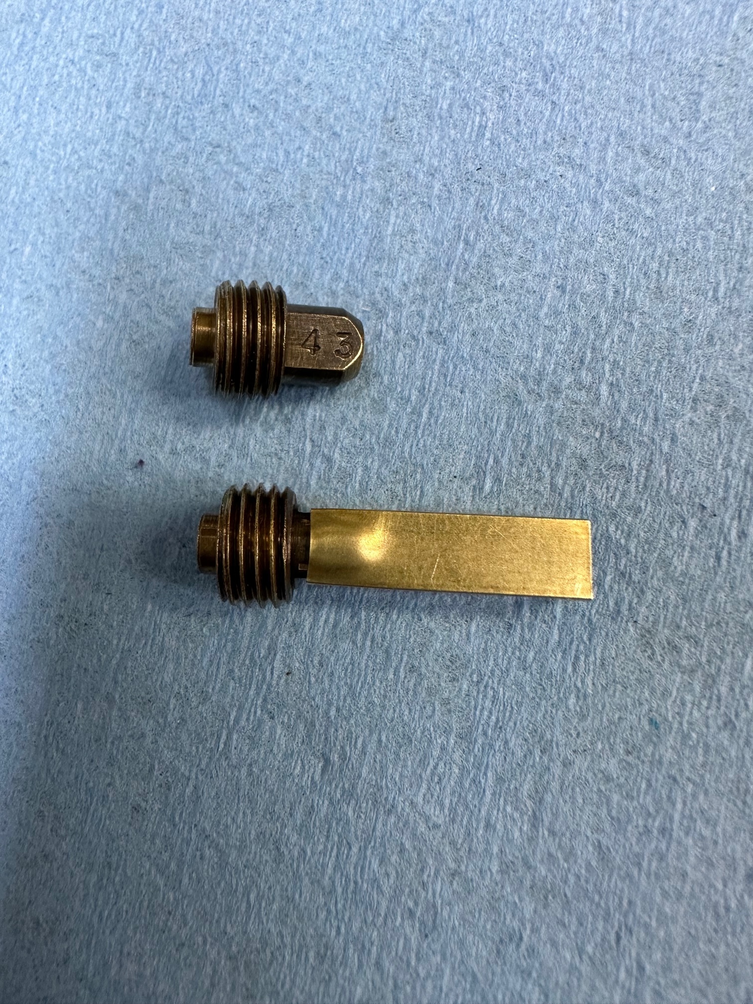

I found a short piece of 7/32 square brass tubing that when hammered on worked perfectly.
Attachment 45785
Chances are I will not need it again but I have it and it only took a minute to make...

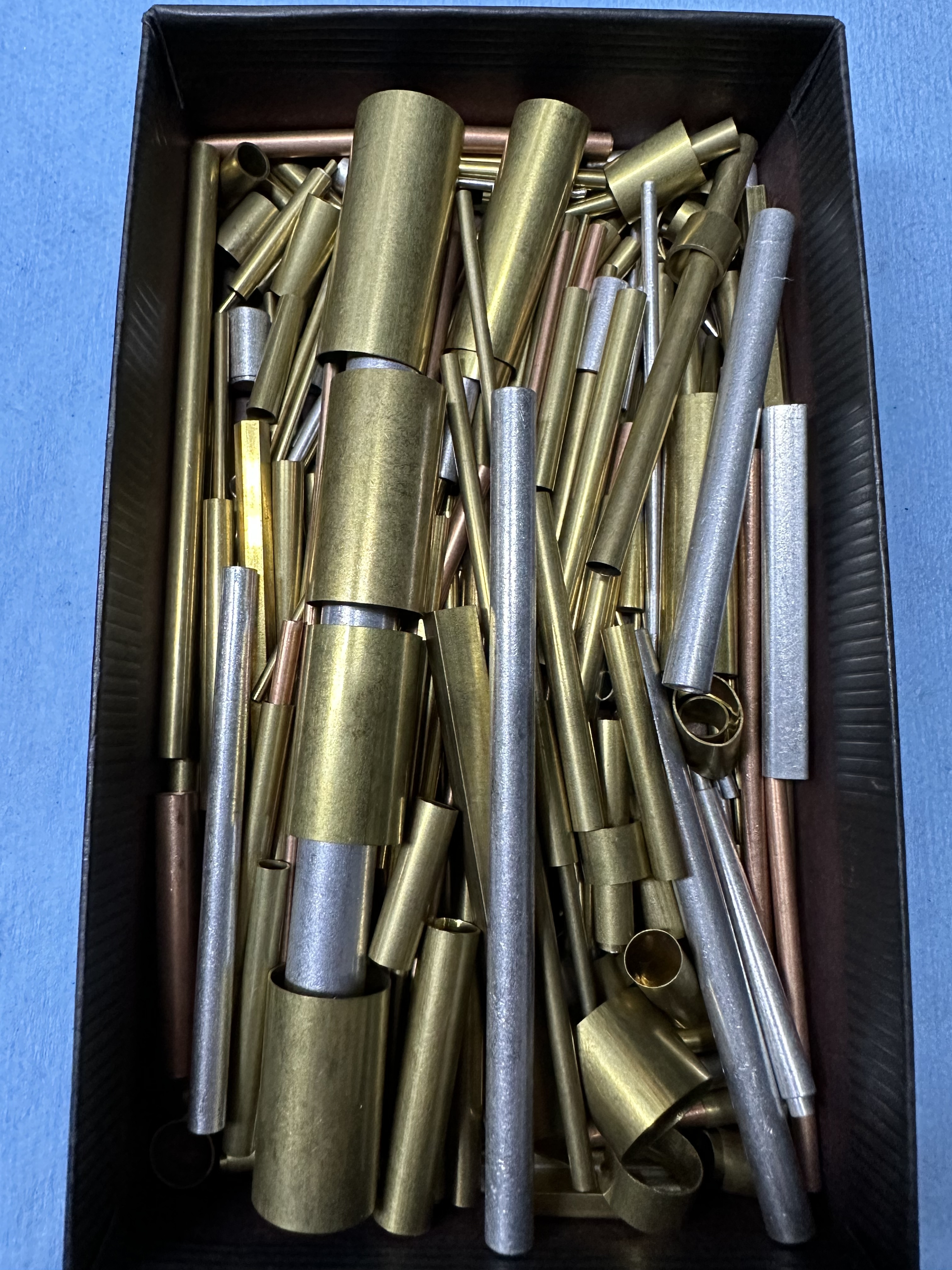

I had the brass because years ago I purchased the bag of scraps from somewhere on line...

1 Attachment(s)
I did clean the carb first and I'm sure that helped. I did find quite a few 97 jet tools available online in the $20 to $40 range, but why buy one when I can make one at home...Attachment 45797
