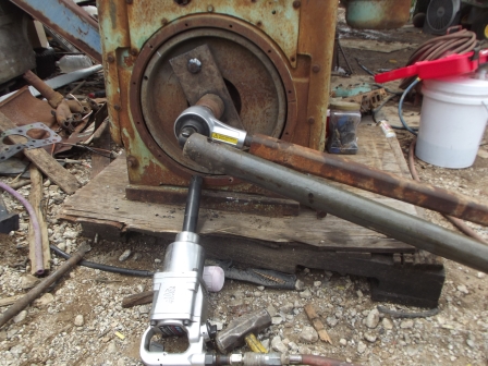

Stuck engine tool

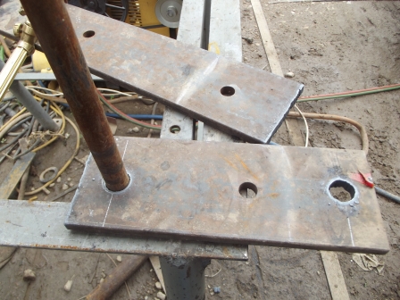

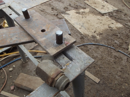

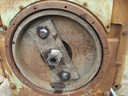

Working on my White engine conversion I made this tool to assist me in breaking it loose before tear down.
As with many of my tools this one is about as simple and straight forward as they come
it is made from a piece of 1/2 by 5 flat bar 1" round bar and a 2" hex scavenged from a hydraulic fitting
Attachment 11503
