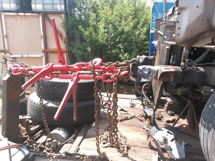

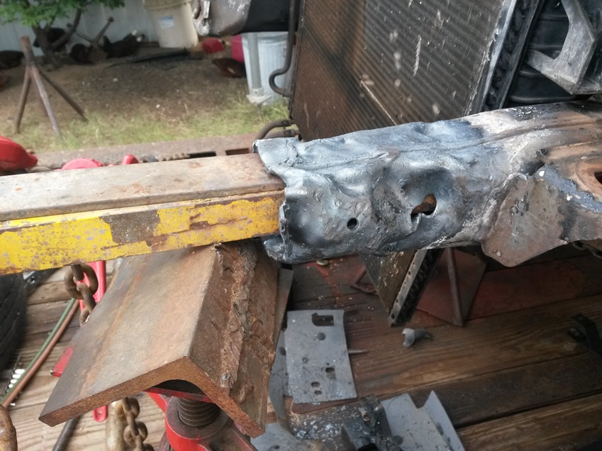

In repairing the frame on a 2007 Ford Ranger I have used many things that were made for other things as ntools to do something entirely different than what they were. My trailer has become a frame machine among other things.
Today I decided that since I haven't been able to locate any cut off or replacement front frame horns or the bumper mount as it were.

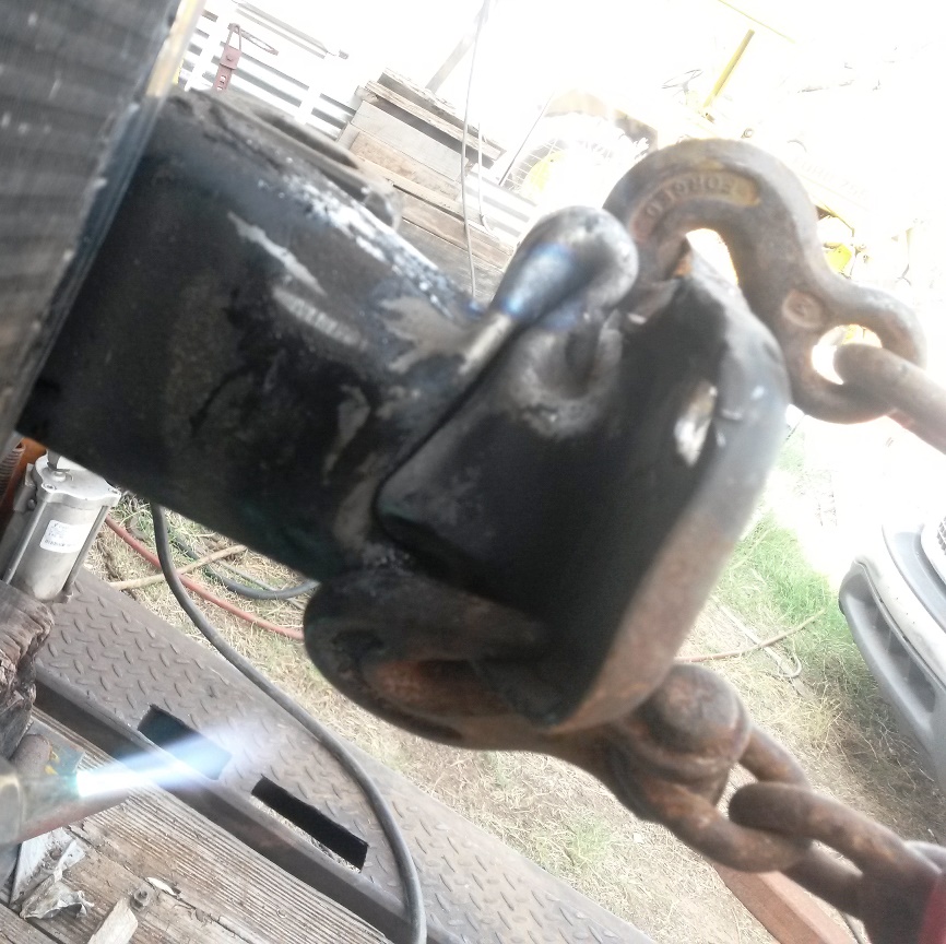

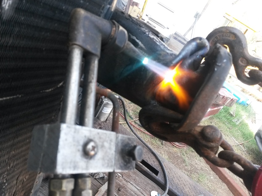

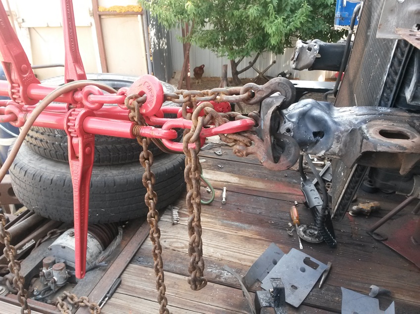

I used a piece of 1 1/2" by 6" by 28" long flat bar as the pull post 4 screw type load binders and some chains and a torch to try and stretch the horn back out.
Attachment 25181
Attachment 25182
Attachment 25183
Attachment 25184
then I set up what I called a fulcrum anvil. A famous man said a long time ago with the right leaver and a fulcrum you can move the world. Blacksmiths have always said the world can be reshaped heat an anvil and a hammer. So I combined all of this to reshape the horn
Attachment 25185
Hi Frank,
Not intended as a criticism, I understand the fun of doing something just because you can, but why did you not simply cut it off and weld on a piece of RHS?
There is a couple of reasons for not doing that.
Had I been able to locate a section of frame with good horns I would have simply cut out the bad and welded in the good. an hour's job tops.
Had I welding in a section or Rectangular hollow section "RHS" I would have had to calculate and drill or add in structural weakening areas to maintain a crumple zone which would be similar to factory I have in the past created crumple zones on tubular frames it is really not a big deal. On RHS frame you drill holes in the 4 corners of the tubing and in the sides this will introduce structural wreaking points to serve as energy absorbing buffers to the rest of the vehicle.
I might plan on building a custom bumper for it which in the event that I eventually sell the vehicle this becomes more important that the frame retains its factory intended crush capability.
Heating and straightening the horns back to as near factory look as possible will not create a liability issue for me should the truck be involved in another accident even with a custom bumper If anything the heating forging and reheating may ultimately reduce the structural strength of the horns slightly.
Selling of vehicles under a certain age in some states which have an accident flag on their repair history requires a full disclosure of parts replaced and repairs performed.
SO there is the long answer for a short question. If I were to keep it for a couple of years or sell it at auction all of this work would be for naught.
