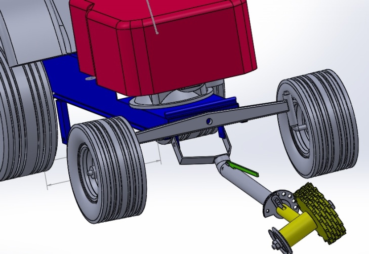

One thing you might consider especialy is you are wanting to do this on the cheap without a lot of right anbgle gear boxes and drive shafts to get the power from under the engine to the grinder is to.
First off make an arm to extend out the front of the mower on a pivot which will allow the grinder to be raised and lowered. V belt drives can successfully be made to change their rotational plane from vertical shaft/ horizontal pulley to a horizontal shaft vertical pulley providing the extension arm is of sufficient length.
the grinder head will require a couple of bearings a shaft, and a housing to attach the pulley on 1 side and the grinding head on the other. a couple of idler pulleys may be required to insure that the belt does not come off at either end. a means of raising the attachment like that of the mower deck another means of de-activating the grinder (IE clutch) can be accomplished by shortening and lengthening the control arm.
I will draw up a generic model to offer a better explanation of what I am trying to convey.
Thanks for help
As promised here are some rough renderings of how you can make a stump grinder
Ypou may have to modify the front end of your lawn tractor enough to allow for the belt that drives the deck to come out the front but a lot of the lawn tractors this is possible without too damaging of an effect I have 1 lawn tractor that I have added a 3rd pulley below the 2 originals
have a look at the pics and if you have any questions I will be glad to help wherever I can
by changing out the cutters a large disc with blades could be attached like that of a small brush chopper to give you something like a 36" brush hog an appropriate safety cover would be necessary

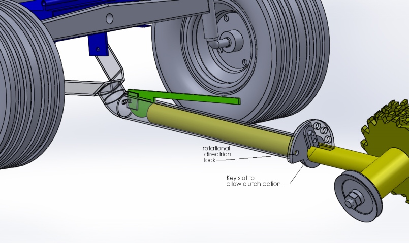

Attachment 17730

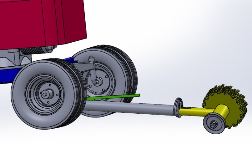

the assembly would be raised by the deck lift lever a link would have to be made to attach to a tab under the main grinder mounting assembly
Attachment 17731
the clutch lever is nothing more than a cam lever that forces the inner support tube to be extended.
the slot key and rotational lock is so the grinder cutters can be angled for best grinding action
Attachment 17732

Good invention May have to build one. How many Hp do you think would be needed ? What is the Diameter of the grinding blade ?
G.Paul,At thje time I drew it I didn't know it but after searching later I found that I had I based the design in part at least to that of the DR 16.50 stump grinder
https://youtu.be/fQIL3WZBrUw
but since the OP stated that he has a 25 HP riding mower I took that into account as well. plus the fact that limited power can be transmitted through a drive belt which will fit on the pulley of the mower.
For this I drew the model with a set of 10" diameter 16 tooth cutters 1/2" thick the DR has 3 cutters I show the 1 that I drew with 6.
I further took into account that most modern 2 cylinder lawn tractor engines have a max RPM between 3200 and 3600 I have 1 that is governed at 3200 and 3 that are governed at 3600, my lawn tractors are older and have 6" Diameter power pulleys. The target RPM I was trying to aim for in the design would be between 4500 to 5500 or more This would offer in my opinion a good start point if I were to build 1 for myself (Which I may just to prove the design)taking that into consideration I drew the cutter pulley at 4".
there are a couple more features I had thought about but did not bother to design in as of yet since this was not to be a set of plans on how to build one but a guideline of 1 man's rambling thoughts portrayed on paper to another for 1 possible way to make a stump grinder.
Additionally to the camover clutch lever I drew in I feel that` there needs to be a way to adjust the belt I did not add this since there are many way by which this can be done. As I mentioned in my first post there would probably need to be some idlers added to insure the belt stays straight near the engine since it is being twisted up to 105° out of its intended running plane I left these up to the person deciding to make one the same with safety guards which are extremely important in my opinion
Also you may want a way to swing the grinder from side to side while sitting on the lawn tractor and 2 belts may be needed to transmit enough power to the cutter
