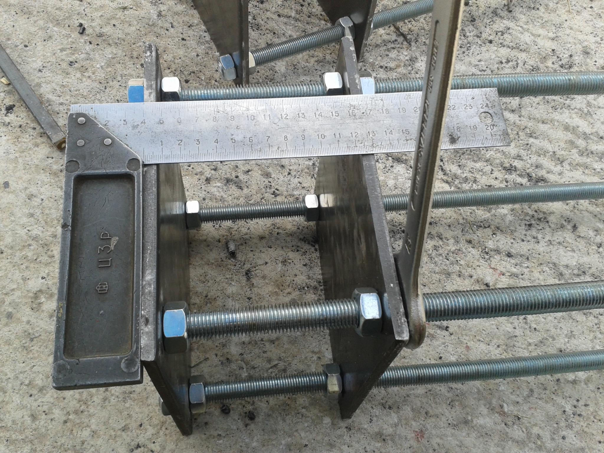

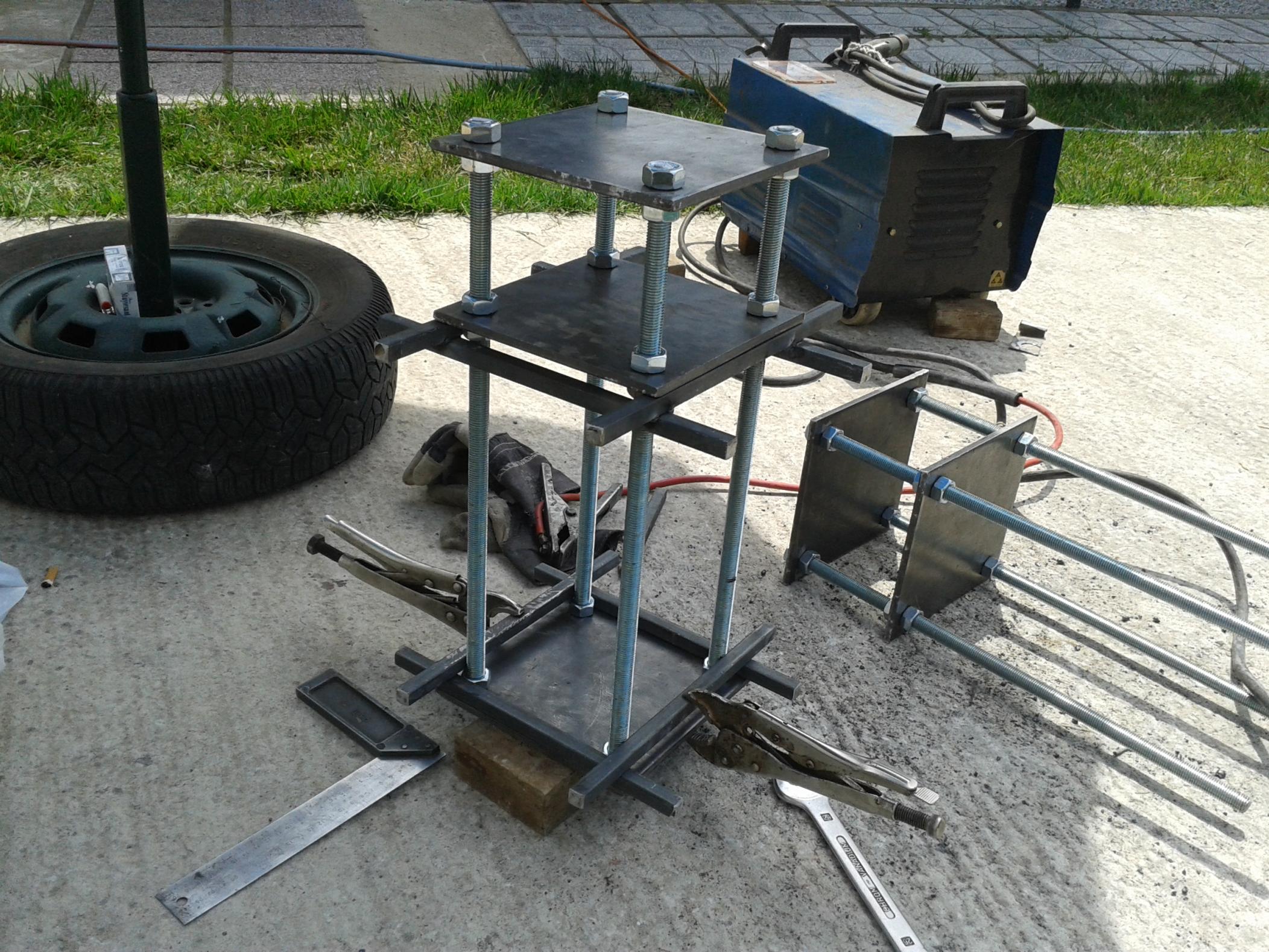

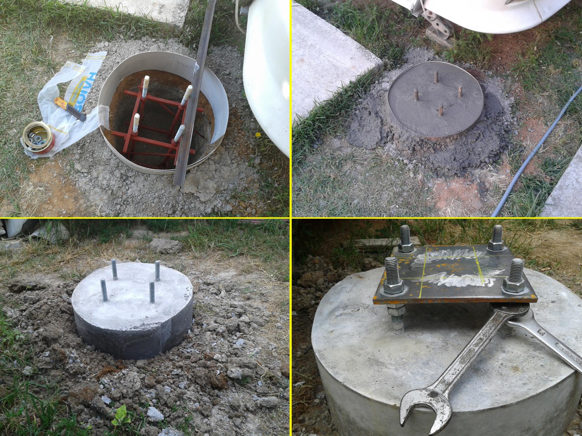

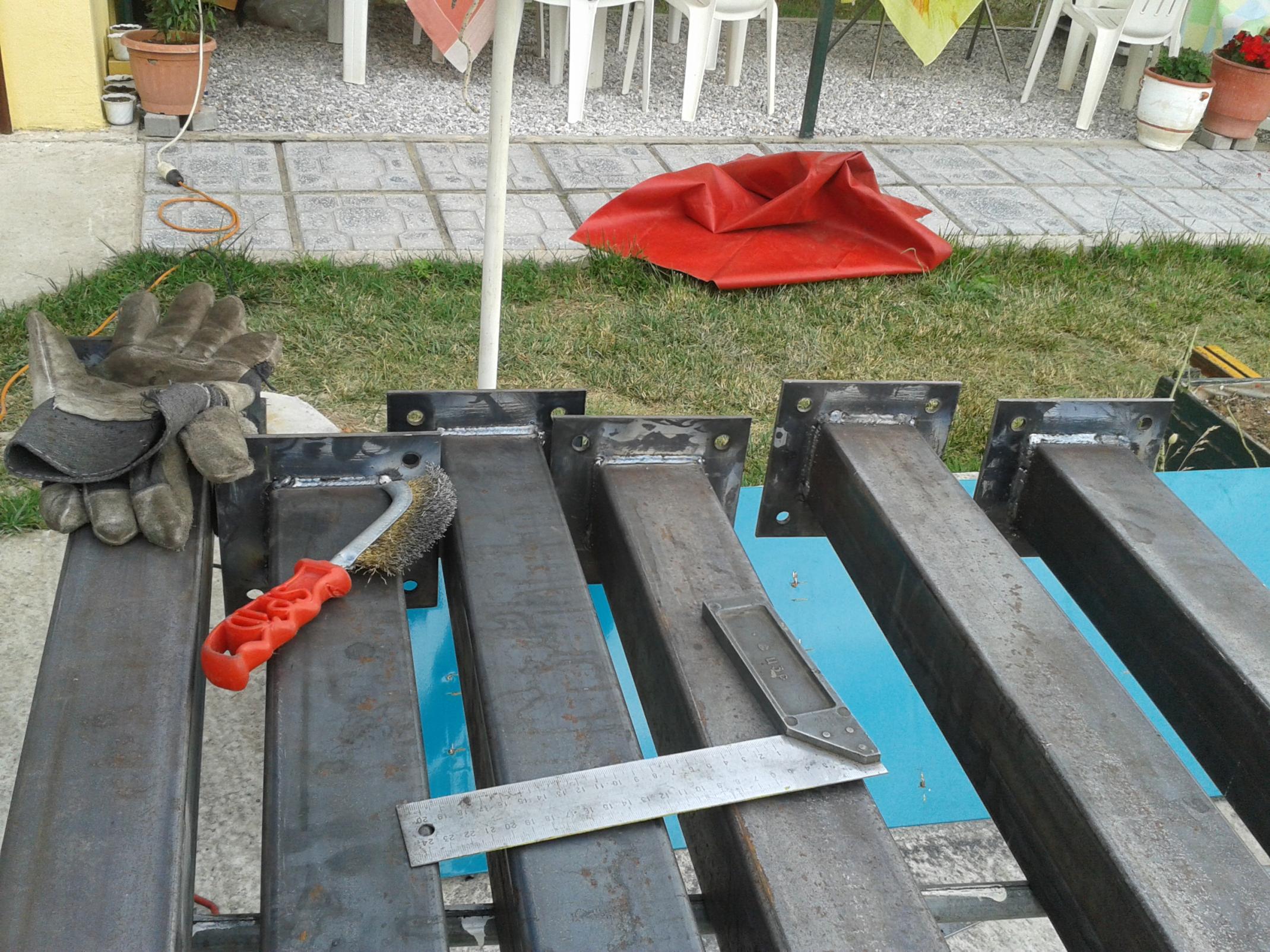

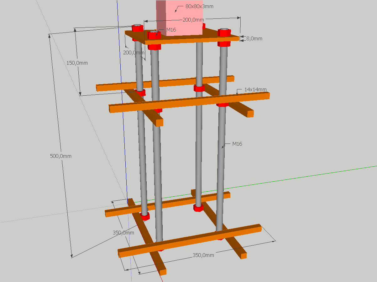

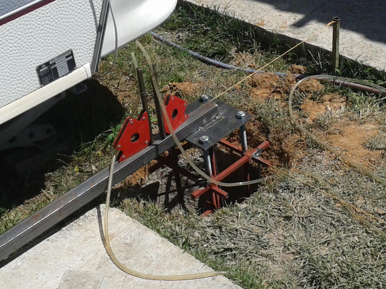

Materials: Threaded rod M16x500mm, Nuts M16, Square bar 14x14mm, Sheet Metal plate 200x200x8mm,
Sheet Metal plate 150x150x5mm, Tube 80x80x3mm, Round bar ø8mm, Cement, Sand gravel,
