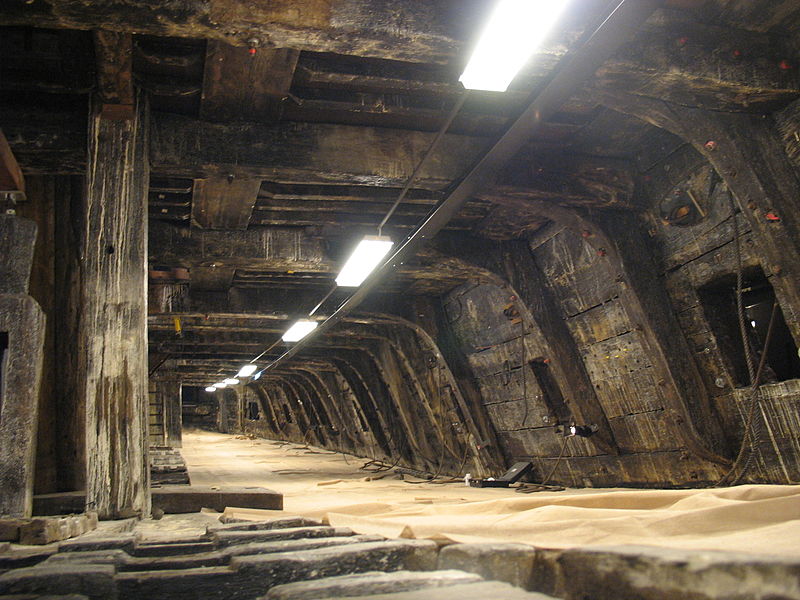

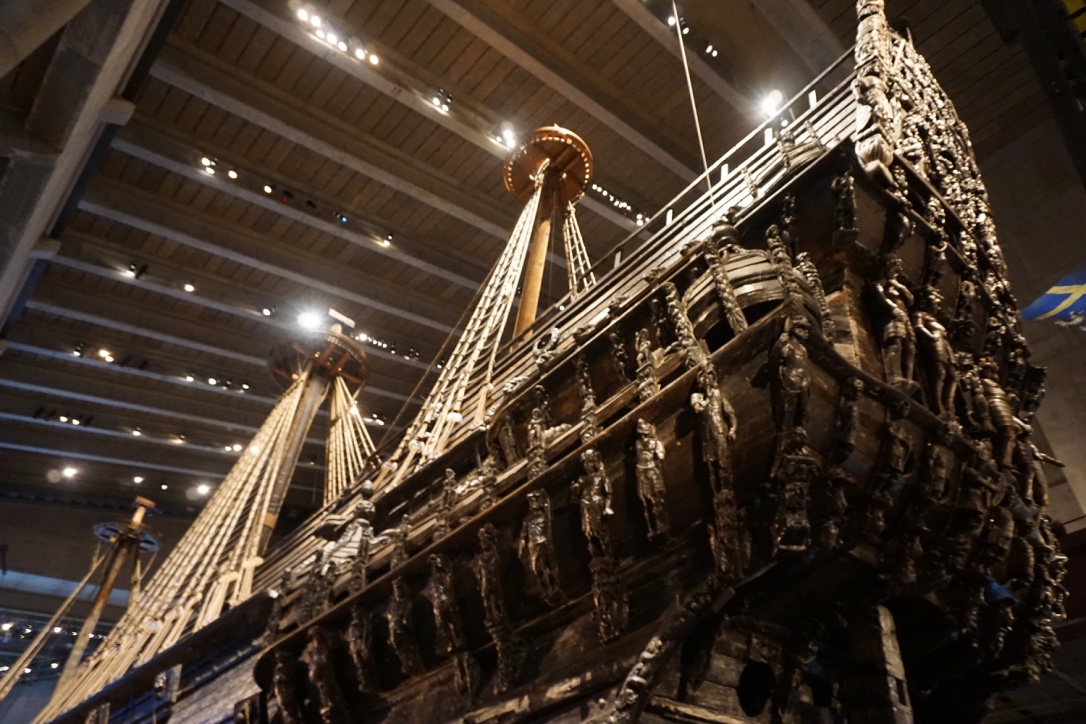

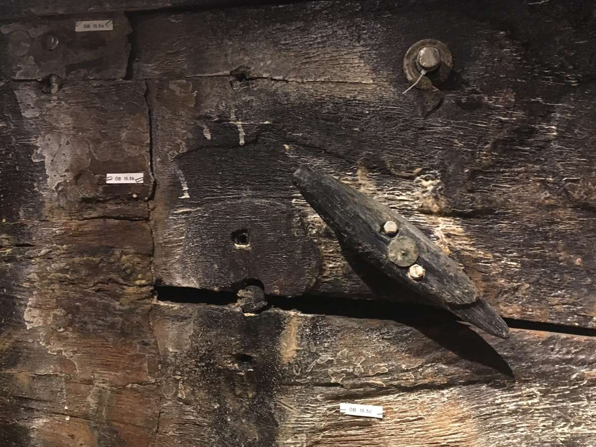

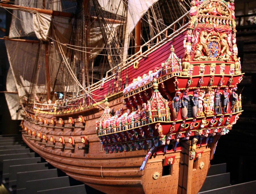

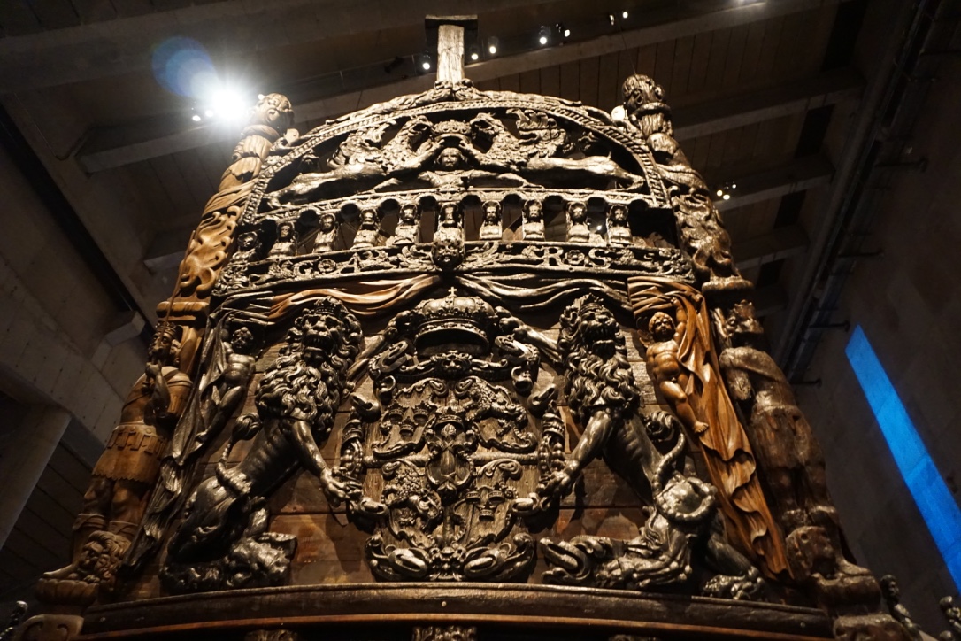

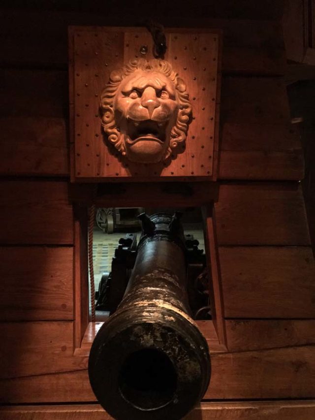

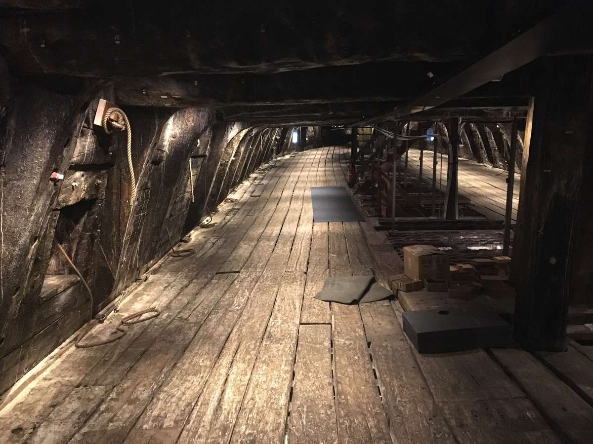

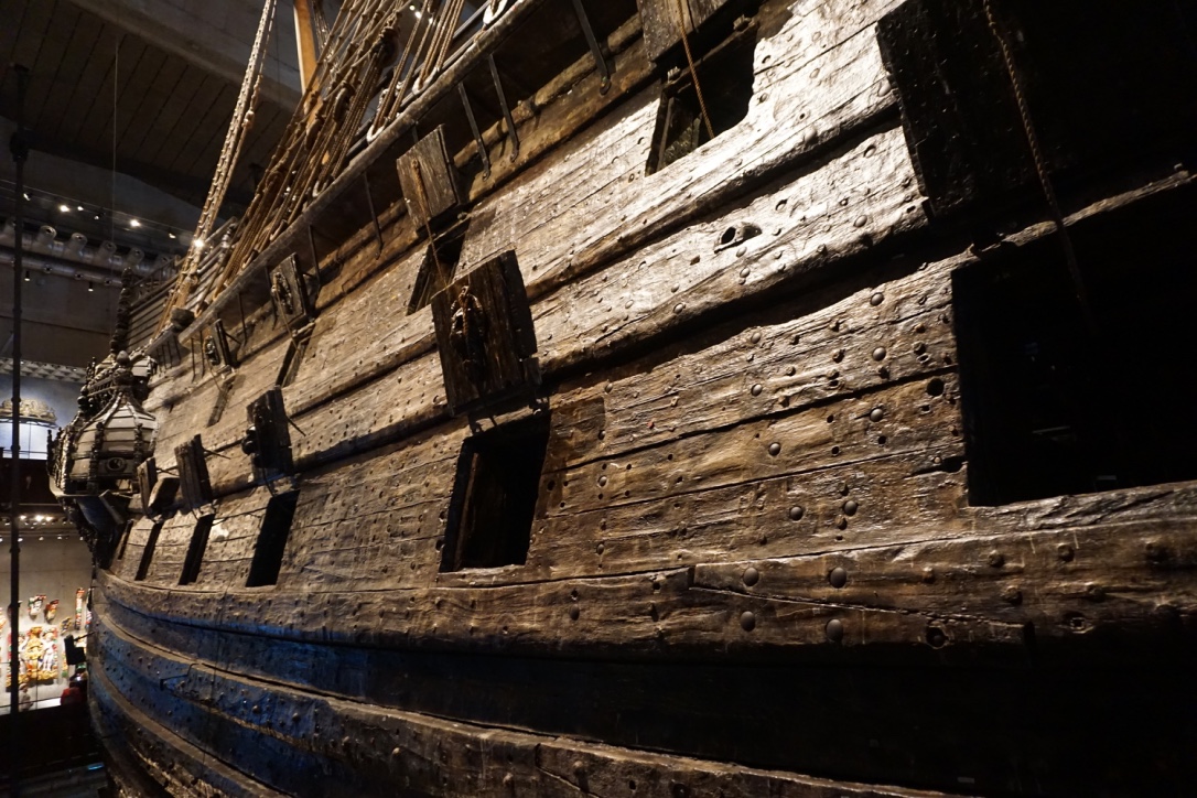

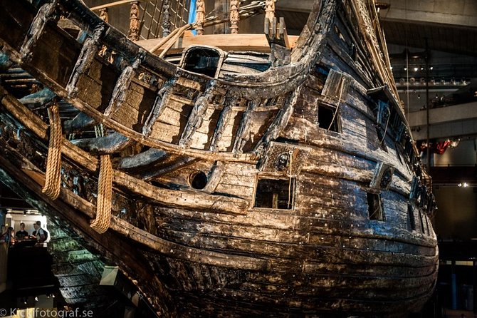

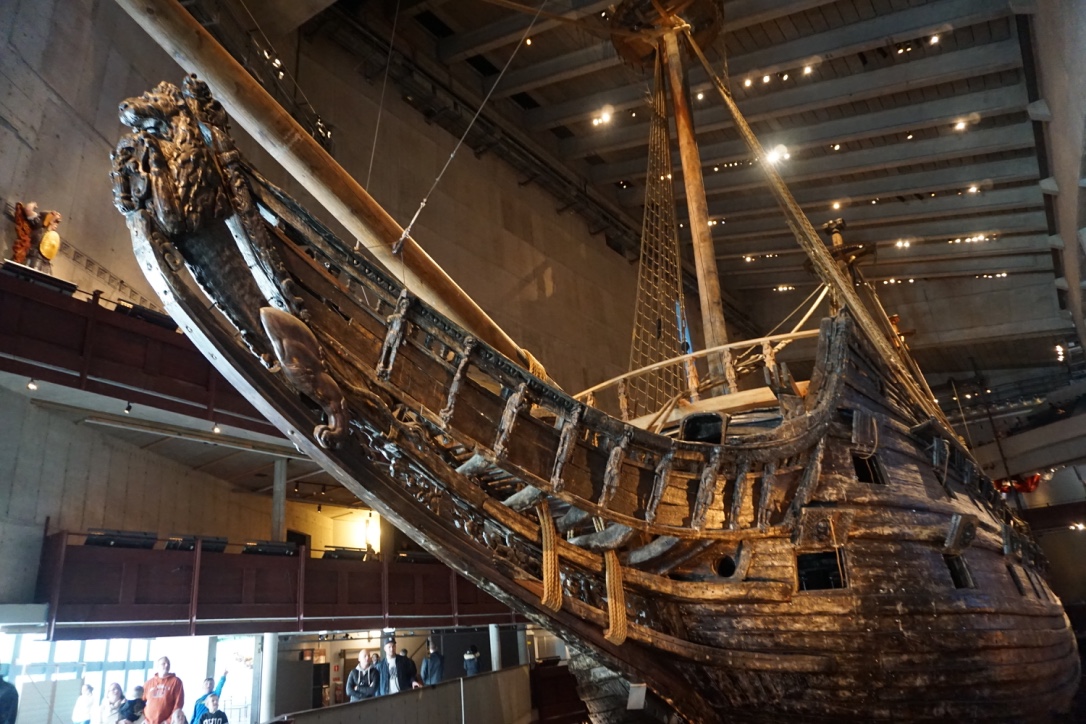

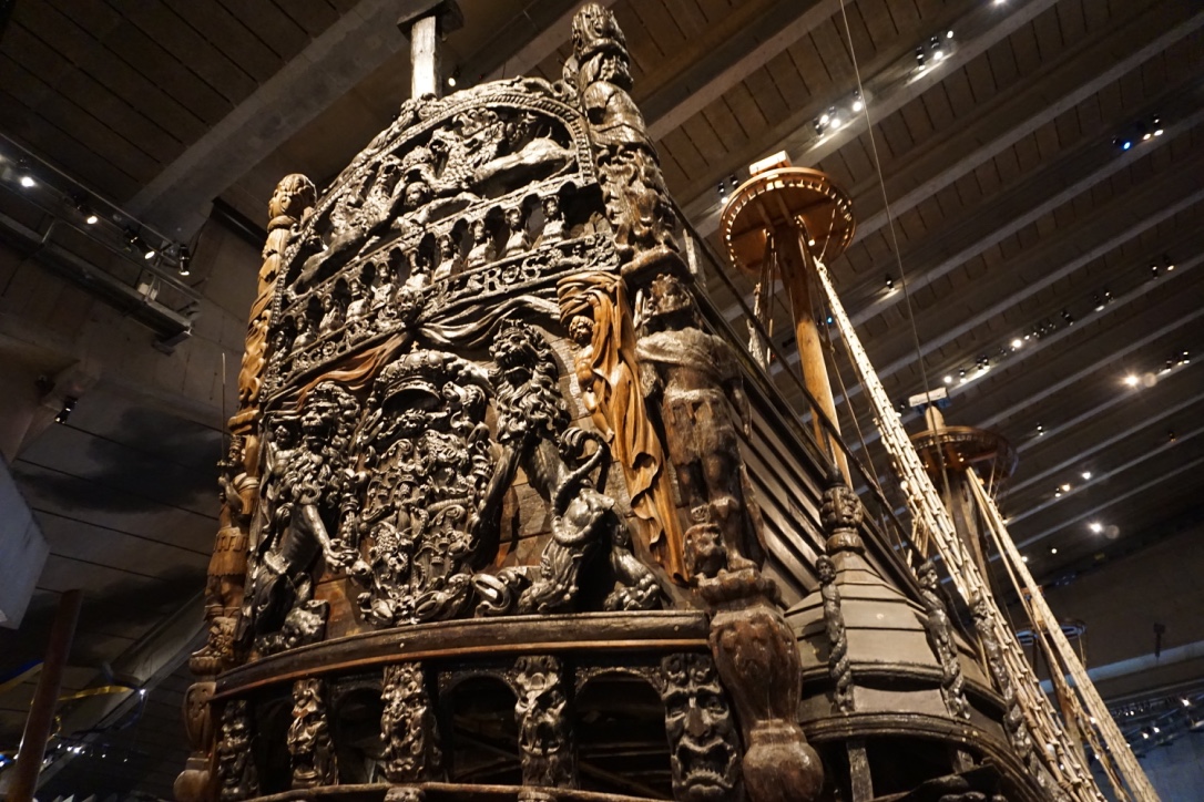

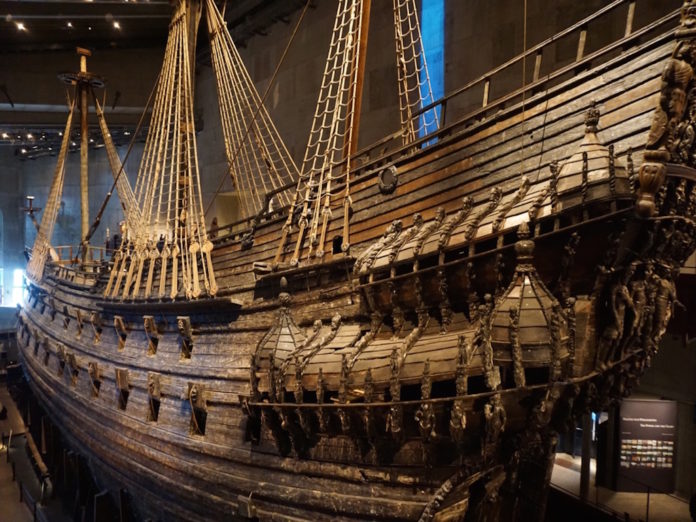

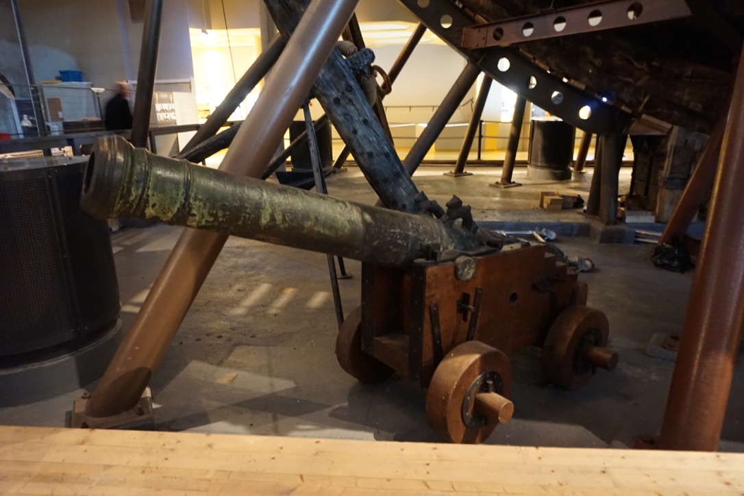

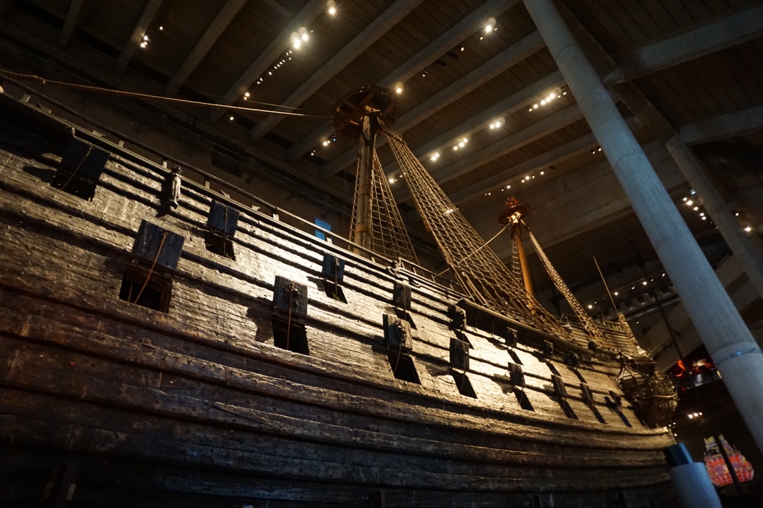

Attachment 38799 Attachment 38800 Attachment 38801 Attachment 38802 Attachment 38803 Attachment 38804 Attachment 38805 Attachment 38806 Attachment 38807 Attachment 38808 Attachment 38809 Attachment 38810

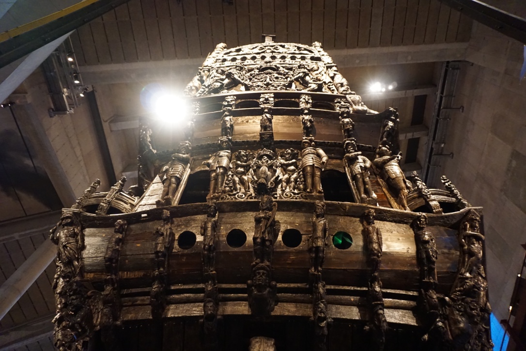

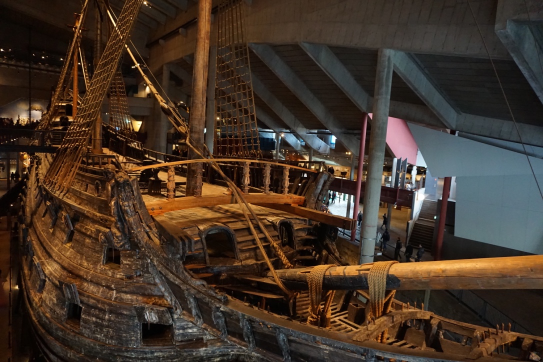

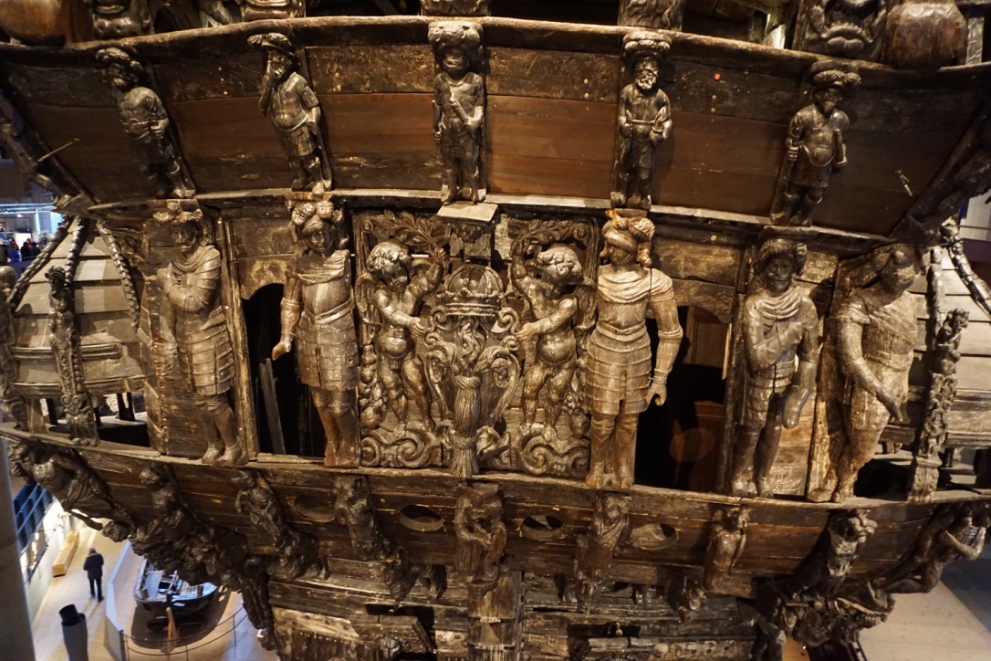

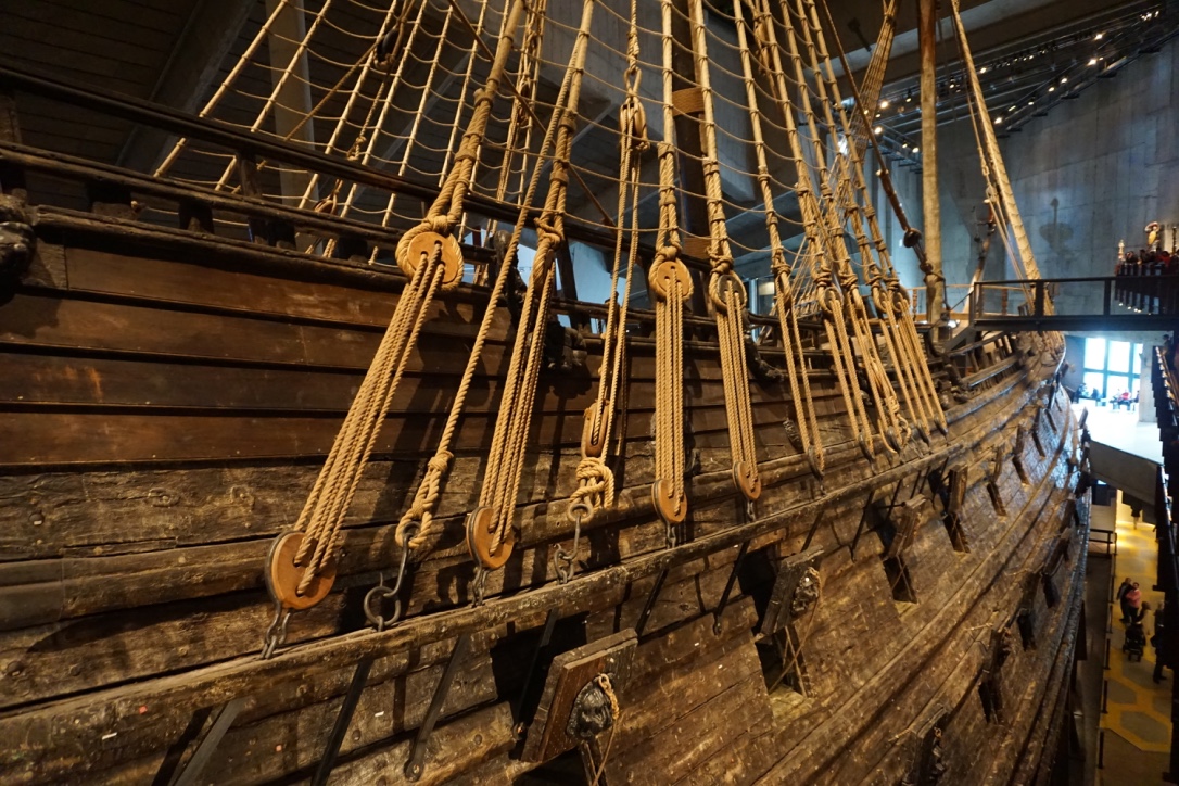

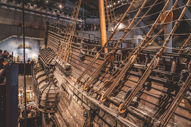

totaly awesome!!! I didnt get to see the ship in the leonardo D museeum in Milan as they had something special going on and pushed us all out....I spent a lot of$$ to get there and they just pushed us out.some kind of gala or something...makes me wonder what a museum is for...:( although I did get to see a lot there I probably missed half due to the gala.
It really is a work of art! Think of the time it takes to build something like that. It is a pity that ships of this type were used for war and destroyed in battle!
Wicked Cool! Truly the Volvo of warships. <img src="https://www.homemadetools.net/forum/images/smilies/smile.png" border="0" alt="" title="Smile" smilieid="1" class="inlineimg"> To see it in person would be the thing. Is it bigger or smaller than imagined. Are museums free? How much to see$. How big is it, by the way? Every square inch is a detail. Wood...weather...What did it look like new? Was it under water? Et cetera. Tell ya what. I can't take my eyes off of it. The displacement is barely imaginable. I wonder what Archimedes would say/think.
Those old ships were indeed so awesome. No power tools around when they were built. It was all blood, sweat and tears. There is nothing about them that is not totally awesome. This one is indeed a spectacular example. But even those much less ornate are still amazing.
https://en.wikipedia.org/wiki/Vasa_(ship)
Today: -Sweden's single biggest tourist attraction with over 1,5 M visitors 2019 (before Covid hit).
Yesterday: -The Pride of the Royal Navy, the most powerful battleship of the Baltic Sea, that just couldn't keep afloat.
FWIW: THIS particular ship didn't do any fighting at all, 2 years after Peter Minuit bought Manhattan for 24 bucks,
on Aug 10th, 1628, it simply keeled over on its maiden journey after abt 2 NM of sailing in light wind.
It was utterly unstable, had top-heavy rigging, an extra cannon deck added, sub-optimal material for keel ballast etc.
More info at: https://www.vasamuseet.se/en (No admission due to the pandemic until further notice)
On the disaster:https://www.vasamuseet.se/en/vasa-history/disaster

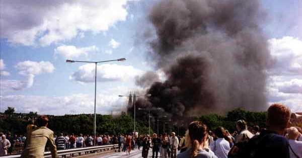

PIO hits again, 4 years later - now in central Stockholm (sic!) in an annual festival with several ten-thousands of spectators:
Attachment 38820 Attachment 38821
4:55 long video, 1st stall starts at 2:00:
https://www.youtube.com/watch?v=mkgShfxTzmo
Morale: Today's bad engineering can provide tomorrow's clickbaits and big tourist attractions in a few centuries...

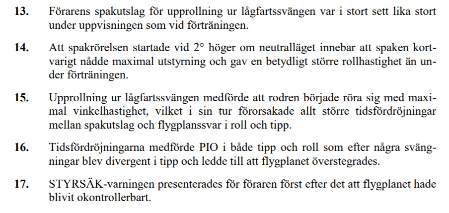

The Swedish Accident Investigation Authority (NTSB) has great FOI transparency,
where a "JAS 39" web search renders 13 hits, and the entire accident report is among those:
Link (Pdf in Swedish only): https://www.havkom.se/assets/reports...JAS-39-F-7.pdf
From "Investigation results":
Attachment 38833
Freely translated (grammar, terms most probably not correct):
"13. The Pilot's joystick maneuvres in the roll-out from the low-speed turn was overall the same in angle at the show as in pre-training.
14. That the stick started operating first at 2 deg starboard (due to the alpha >20 deg: the auto-disconnected roll auto-trim) meant that the stick momentarily hit max deflection, which led to quicker roll angular speed than in pre-training.
15. At the roll-out of the low-speed turn the rudders moved at their max angular velocity,
which in turn led to bigger and bigger time delays between stick movements and aircraft roll and pitch responses.
16. These time delays induced PIO in both roll and pitch, which after a few oscillations led to a/c stall.
17. "Rudder Security*"-warning light (for preventing precisely these flight conditions) was presented to the pilot
1 second after the a/c had become inmaneuverable.
The show flight sked had a max allowed alpha of 20 deg, and a lowest permissible altitude of 1000 ft -
The low-speed turn started at 750 ft @ 150 kn and full afterburner with a 21,7 mean value of alpha.
* Max rudder angular velocity reached: A "-Lean off the stick"-instruction...
Later simulations has also shown that it can be stalled at alpha less than 20 deg too...
(Personal: -Nowhere in the report are actual METAR data displayed,
which could've been great for evaluating the density altitude of the flight,
and given the low flight level aerobatics involved, having a low pressure,
high temp and humid air doesn't improve maneuverability.)
-Oh yes, I almost forgot: -No more jet fighter aerobatics in central Stockholm allowed. Ever again.
