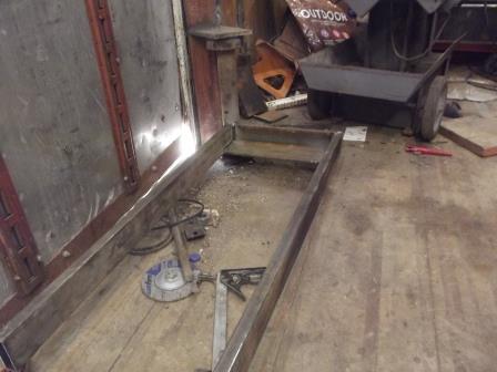

The frame is 1 x 3 x 1/8" rect tubing with a 3 x 4 x 3/8 " angle iron cross bar.
Attachment 9125

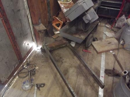

Then to make it off side arm stiff like the primary side I boxed the angle iron cross bar
Attachment 9126

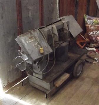

After mounting the saw, it is now in the same relative position it always was. As you can see by the strips in the floor it extends almost halfway across the width of the floor.

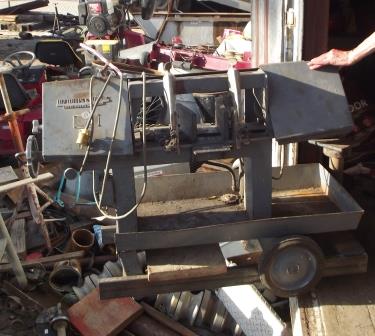

in this picture it is swung all the way outside. With the door secured in the open position later I can make a clip on roller or shelf to attach to the cargo hold slots in the door to support long materials
Attachment 9128

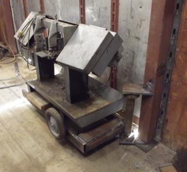

In this position the saw fits nicely against 1 of the side doors taking up much less floor space allowing free access to the front end of the van

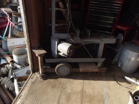

Since it doesn't block the second door where we go in and out of the trailer we will hardly notice it being there when not in use.
Attachment 9130
I still need to make a stop lock to hold the saw in whatever position I need it to be in at the time.
