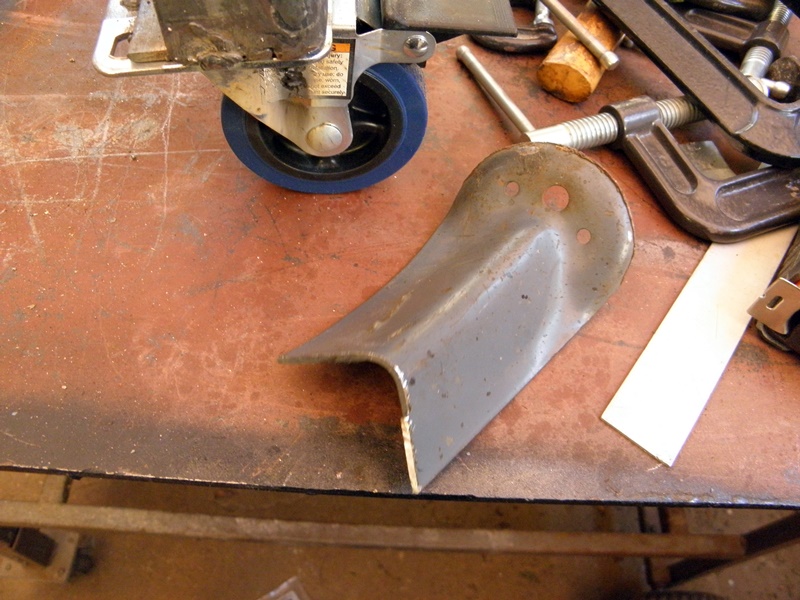

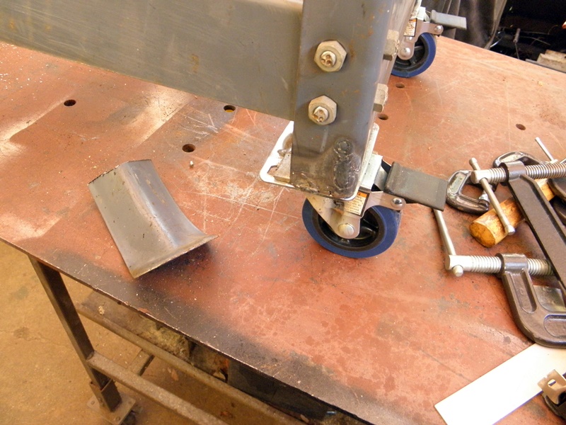

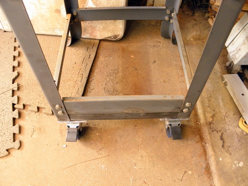

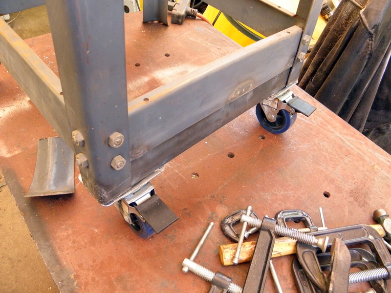

Table Saw Mods-Fixed wheels with brake. made from 1 1/2 inch angle iron with wheels welded to it.
Attachment 6277Attachment 6278Attachment 6279Attachment 6280

Captain,
I like the locking wheels with the longer locking tab for ease of access. Who makes these locking wheels and what is the rated load per wheel?
Thanks for the detailed photos.
Paul
Hi Paul, Harbor freight special 3.99 ea 3 inch not sure of the rating but they work fine for 150 lbs.
Thanks and I definitely need to spend more time walking around my local Harbor Freight store for parts and building ideas (and bring my son's pickup truck :lol:).
I have bought so much stuff from HF that they put a store 2 miles from my house true story....:O)
