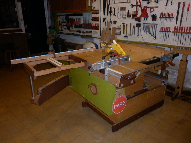

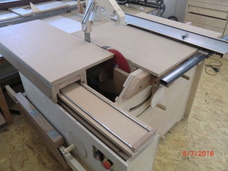

Hello Jon!
Thanks for the welcome. What you have listed as a Panel Saw is actually the 2009 version of my Table Saw. There are two more versions (modifications of the original) which saw the light in 2014 and 2015. Eventually the 2015 edition became the "prototype" for the 2016 one that was built by André Wagner from Germany. This one incorporates all the latest improvements and is the subject of the plans we're offering for sale.

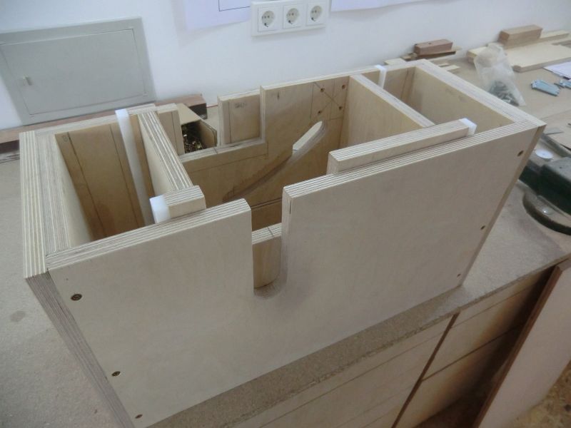

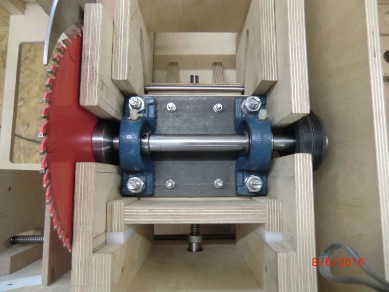

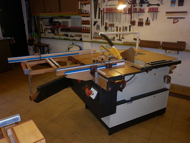

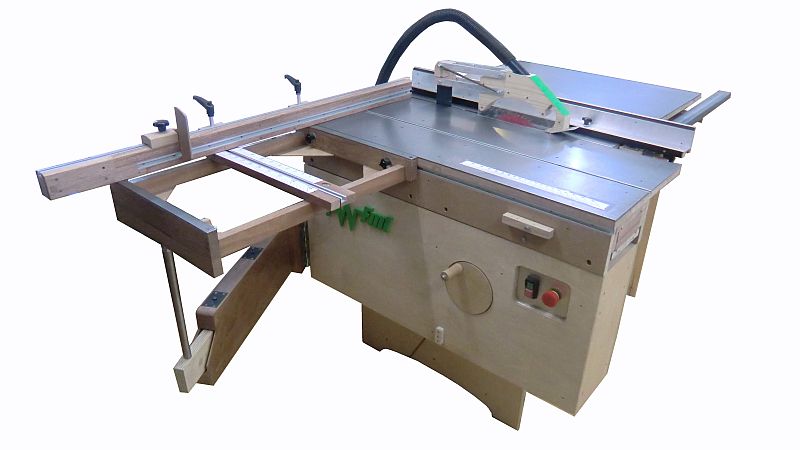

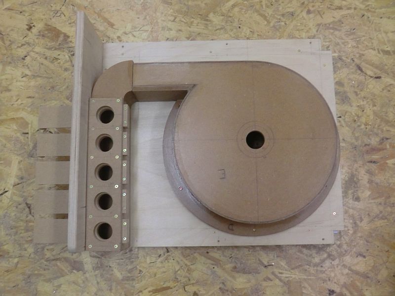

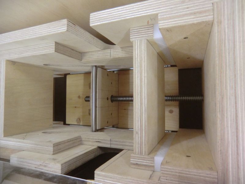

As requested, here are some photos.
Attachment 18700 This is the saw as it looked in 2014
Attachment 18702 And in 2015 up to the present day. This one is what we called "prototype" as told above

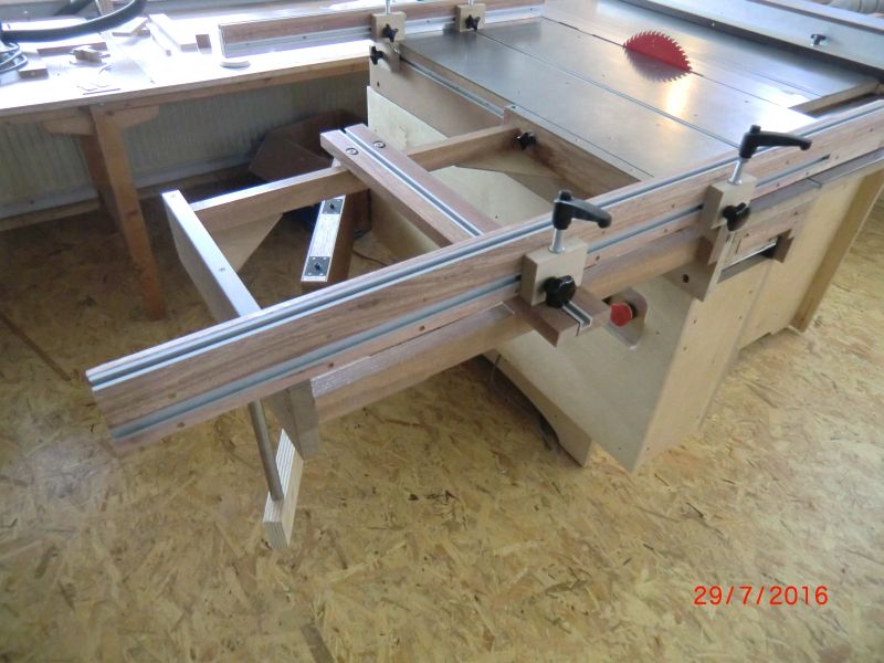

Attachment 18703 This one is built from the plans we offer in our website: AW-Thinkbold

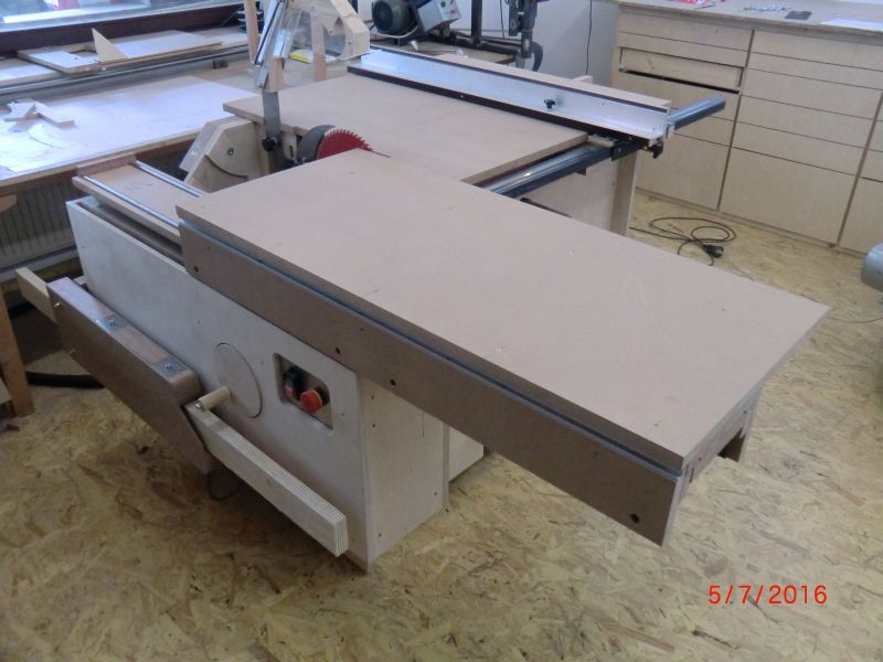

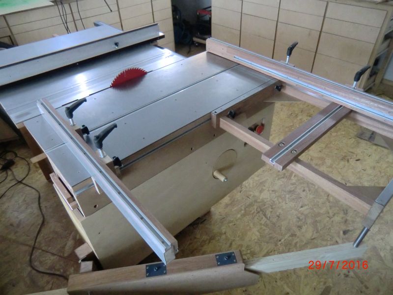

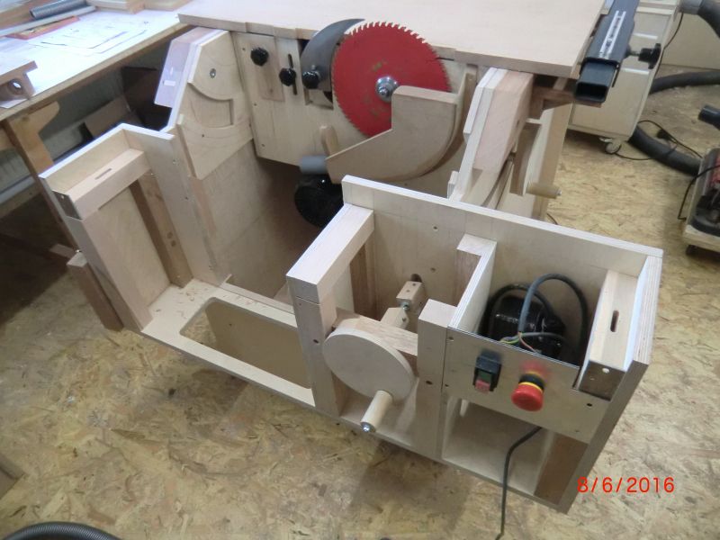

Attachment 18704
Attachment 18705
Attachment 18706
Attachment 18707
Attachment 18708
Attachment 18709
Attachment 18710 A view of the Thien Separator and Blast Gate Manifold
Attachment 18711 The Sliding Table Support Structure
Attachment 18712 Pulled to the front
Attachment 18713 Pushed full to the back
And a YouTube video of the saw in action: www.youtube.com/watch?v=FbIMJMPeWfs
I hope you like the above and look forward to hear you comments.
Best regards
Hector (Tacuabe)
P.S. Could you please amend my name for the forum. It should be Tacuabe NOT taacuabe (which was a typo!)
