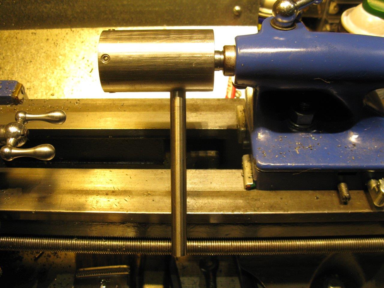

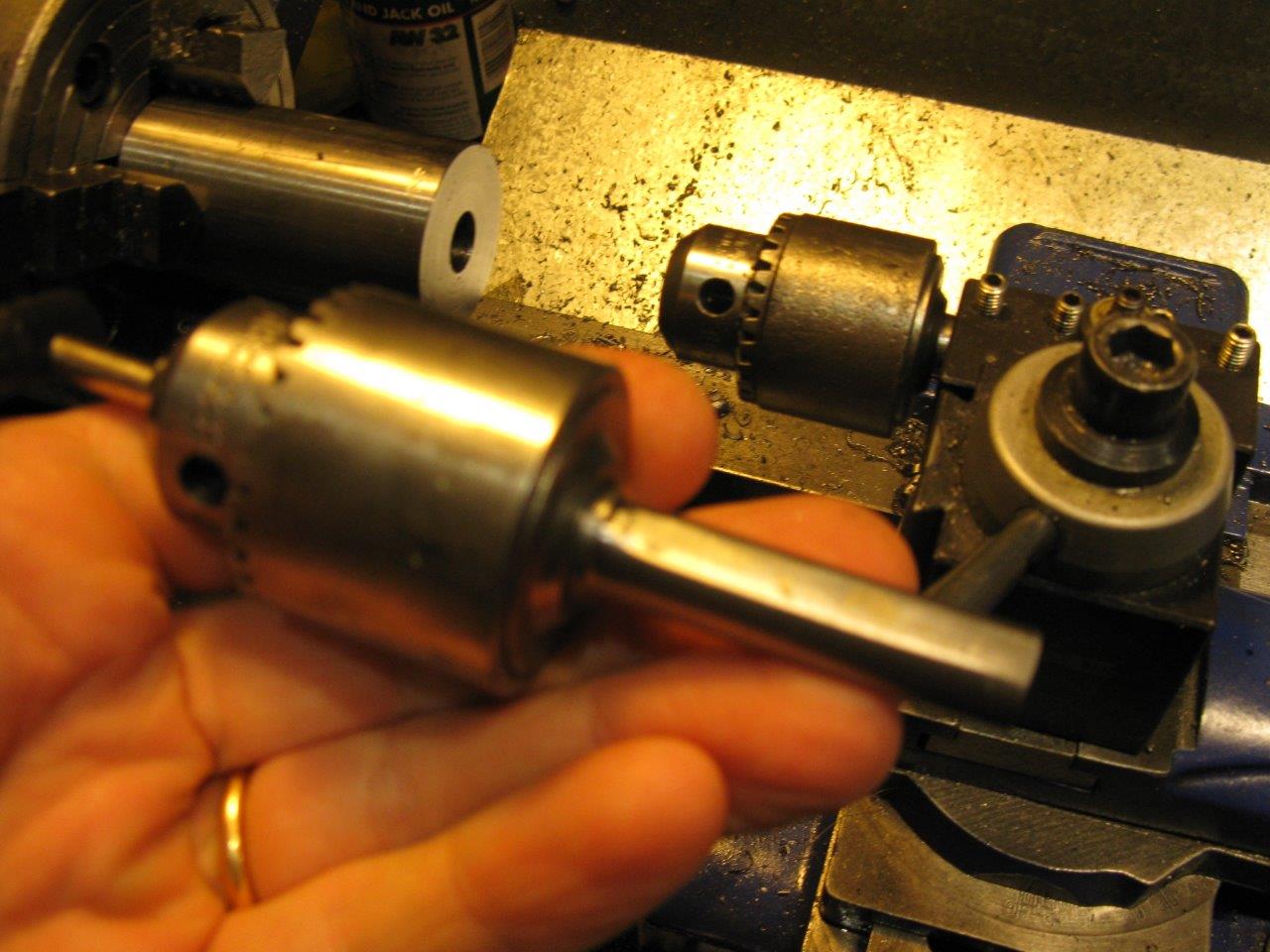

I've long had issues starting dies straight, perhaps because I have crap dies, perhaps because I'm not doing it right, but either way I thought this was a neat project to do. Also, seeing jjr2001's thread on it helped :)

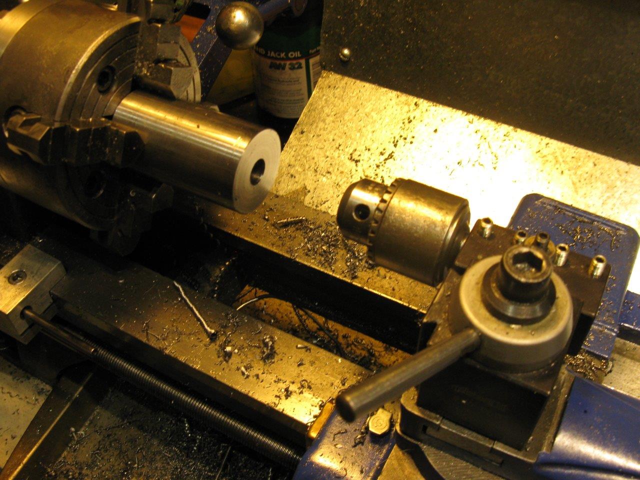

A chunk of 2in steel rod was hacksawed off and faced both ends, then dialed in on the 4 jaw.

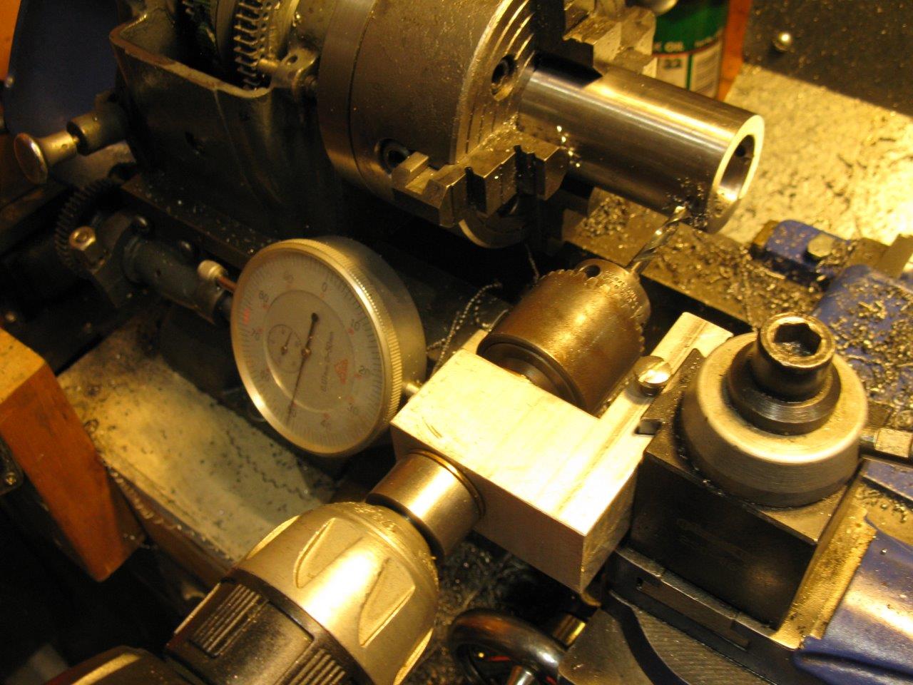

Using my toolpost drill chuck - an absolute necessity on a lathe with 1 1/2in tailstock ram travel - I drilled the rod out to 1/32 or so under 1/2in diameter. Then I reamed it to 0.500 dead on. I thought that was an over reamer, but now I know!
Attachment 14809

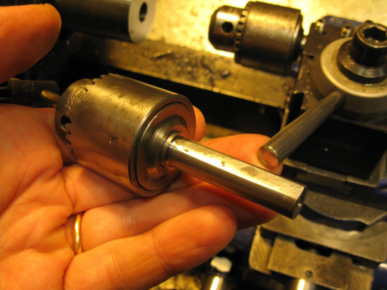

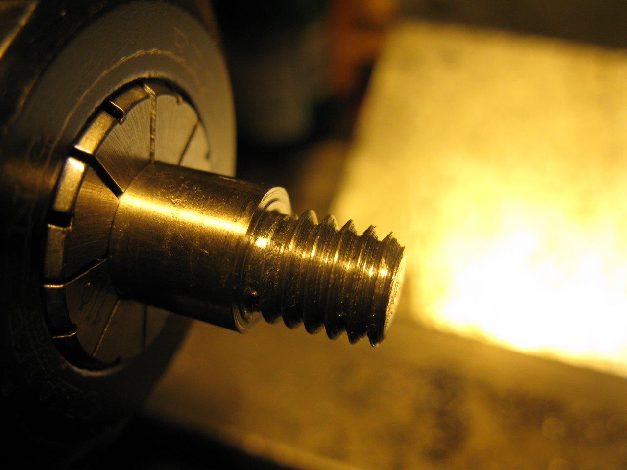

couple of pics showing the 3/8in shank arbors I made, one for a 3/8" chuck, the other for a 1/4" chuck
Attachment 14810Attachment 14811

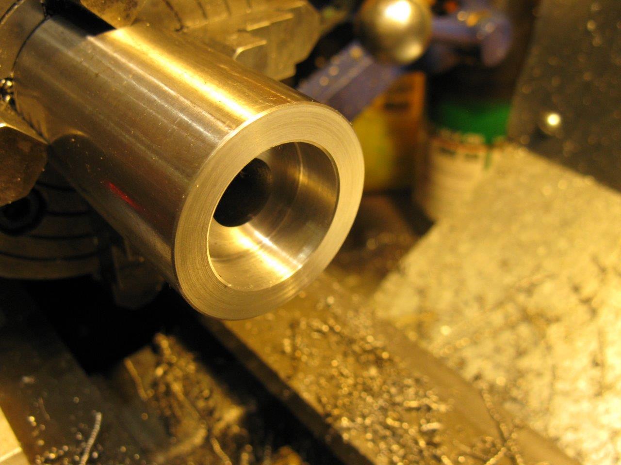

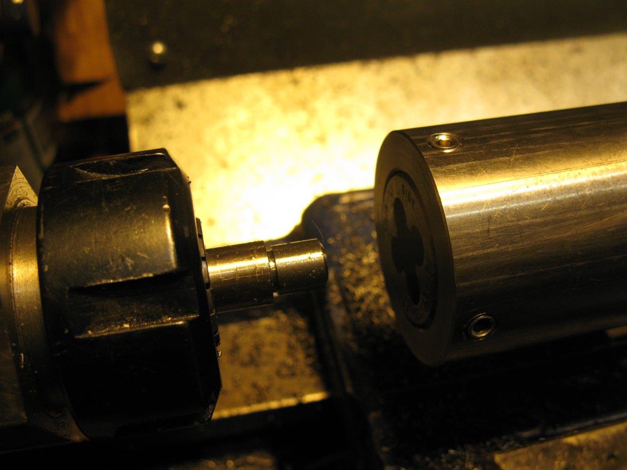

with the work still in the chuck, I bored the face to accept a 1" die
Attachment 14812

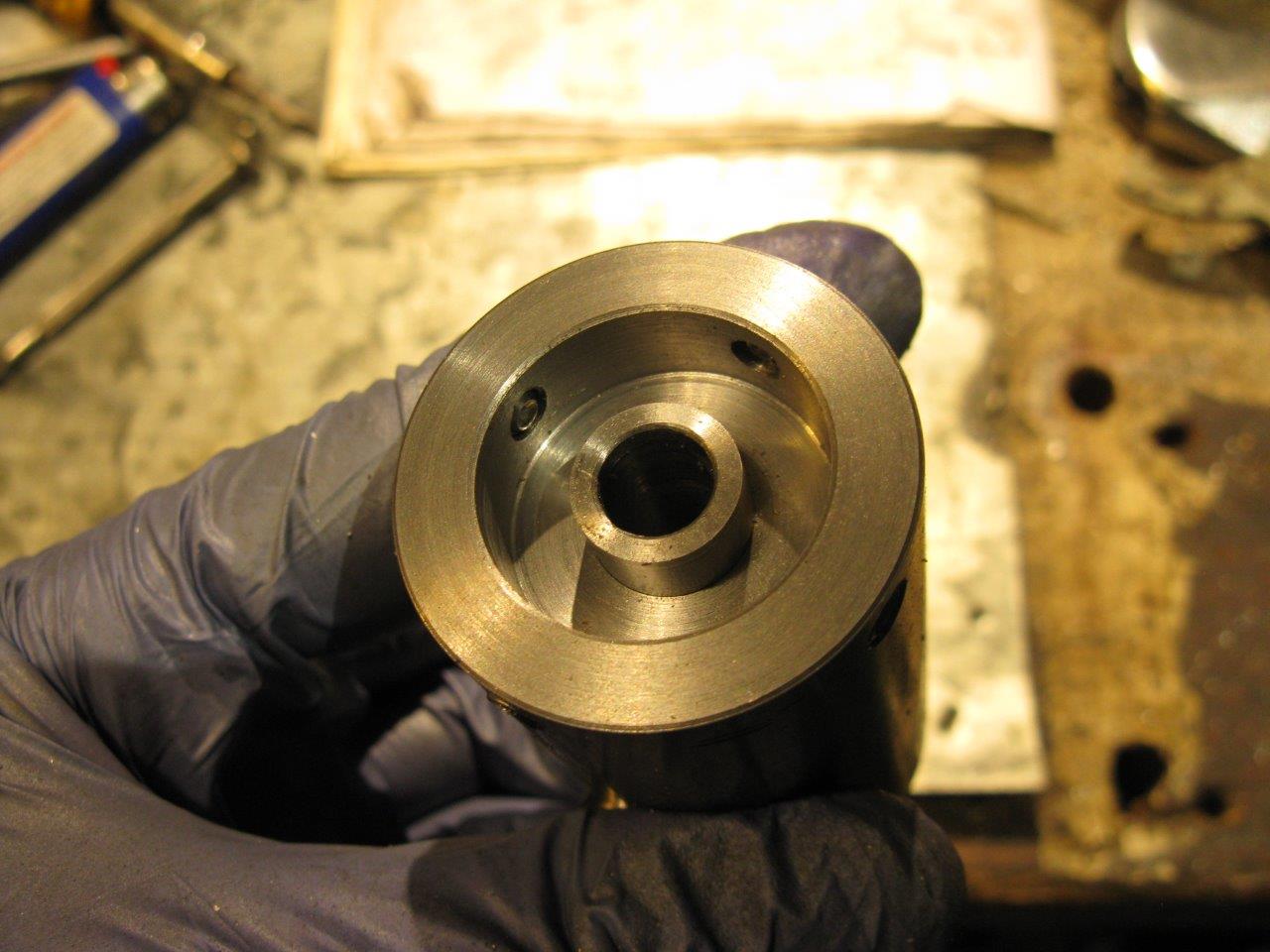

then cross drilled it at 90deg around the circumference to tap holes for 10-32 set screws
Attachment 14813

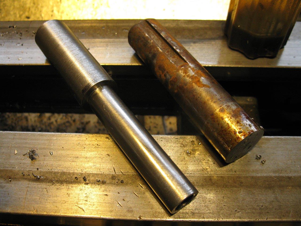

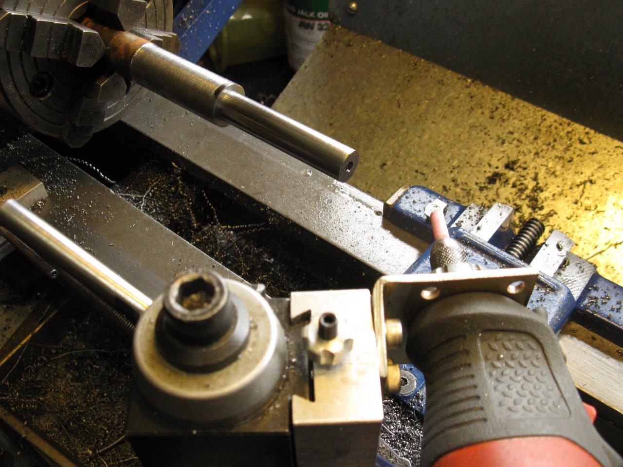

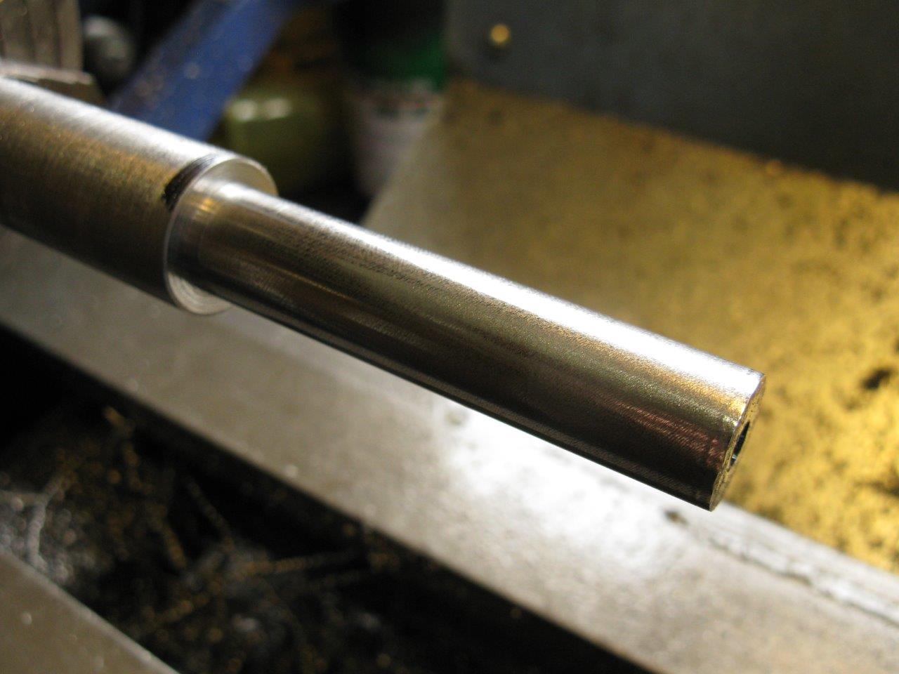

next up is the arbor, using a rusty old 3/4" ex-axle. Faced then center drilled for a dead center. Then turned it down to around 0.501.
Attachment 14814
then ground it to fit using my Dremel and tool post attachment (first use!). Wasn't perfect, but with a bit of patience and some sand paper got it down to 0.499-0.4995, so a nice tight slidding fit into the die holder.
Attachment 14815
Parted it off, turned it around and cut the MT1 taper (not shown)
Attachment 14816

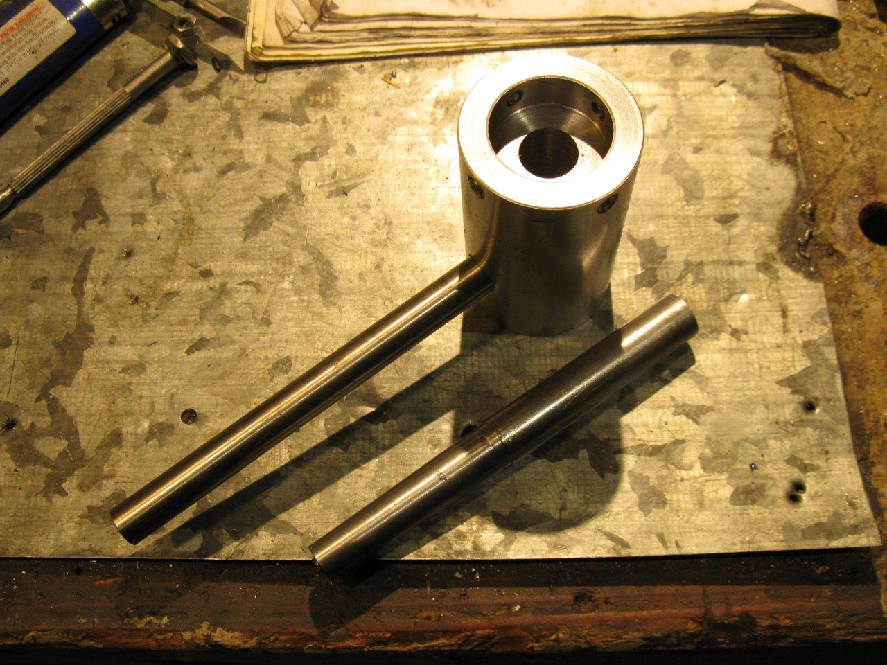

Turned down the handle to the major diameter for 5/16-18 (drilled and tapped a matching hole in the side of the die holder)
Attachment 14817
and threaded it using my tailstock die holder :)
Attachment 14818
all finished
Attachment 14819Attachment 14820
also made sure that the arbor was long enough to pop the die out - my USA made dies are a bit larger than my Chinese ones (which I think are actually 25mm, not 1")
Attachment 14821
anyway, feels good to get another little project done and another useful tool. Also got to use several different useful tools I made a little while ago :D
