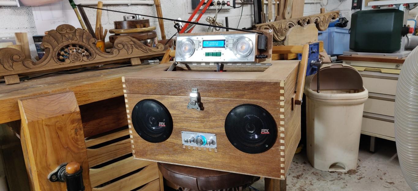

Here is my last invention !
It's a multi-function smart and talking tool box. :headscratch:
https://www.labellenote.fr/file/Dive...olBox_0035.jpg
It is really full featured, you can :
- Carry your tools (yep, it's a toolbox after all)
- It has a power bar in order to plug your mains connected power tools
- It also brings 5V USB in order to charge your phone for instance or power any small device.
- It has an embedded 12V DC 20A power supply. I can plug for instance my "corded cordless drill"
- Additionally, it is a multi-media sound station :
- Stereo CLass D amplifier, with dual speakers.
- FM tuner with deployable antenna for good reception, wherever you work
- MP3 player, with USB Key or SD Card pluggable music file bank.
- Bluetooth Audio, allowing to play the music from your smartphone for instance.
- The tool box can also light up your work on the job site, it has a couple of 35W equivalent LED spots.
- It has an embedded clock, displaying time with second precision.
- It has a programmable clock alarm to wake you up when it's time to go. Plays sound and light alarm signals.
- And last but not least, my Toolbox has a very special feature. It is connected ...

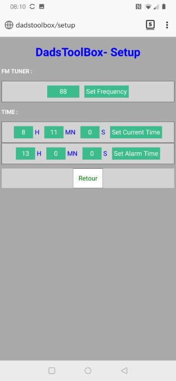

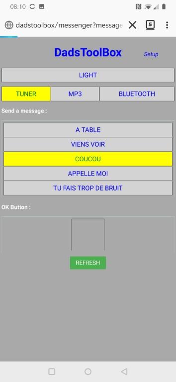

- It has a Web server embedded
- All the features of the box can be remote controlled through the Web interface
- Moreover, whoever connected to the home Wifi network can open a Web browser, type the address "DadsToolBox", and get connected to the box.
- My family, through this Web interface, can send me messages in the shop. The messages are displayed on the screen, and there is a vocal message played.
- If for instance I have my ear protections on, or I am using a noisy machine, I can anyway get the message because the light is blinking while the message is broadcasted.
- The possible messages are :
- Time for lunch !
- Come and see me !
- Hello !
- Call Me
- You are making too much noise !
- In order to show I have seen the message, I press the OK button, and the emitter receives an OK message on the Web page.

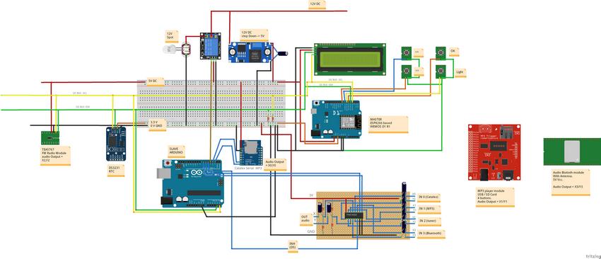

I can show however the general chart of the electronics parts, it should give you an idea :
https://www.labellenote.fr/file/Dive...zing_small.png
For short :
- The main board is a Wemos D1, which is an arduino formfactor board, but powered with an ESP8266 module, much more powerfull and Wifi capable.
This board hosts the Web server and the main application, written in C++ - The main board connects also the physical buttons on GPIOs and is connected to all other equipments through an I2C bus
- The non I2C equipments (analog mux and message serial MP3 player) are connected to a slave Arduino, which is connected to the main board through I2C
- The Clock, FM tuner, LCD screen are connected on the I2C bus (mixed 3.3 and 5V)
- There is an analog part which is a 4 stereo inputs / 1 stereo output audio multiplexer, commanded by the arduino slave board. This part is homemade.
