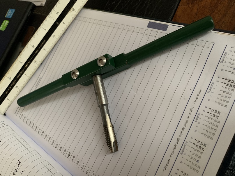

Yesterday for the "N"th time i had to tap a M12 tread using a small shifting spanner. :flame::flame::flame::headshake::headshake::headshake:
My tap handle can only handle to a M8 and that it even battles to do as it is partially seized and I have to use force to get it to open past M6.
I had some 12mm x 12mm bar so thought thus couls not take long. I have seen them made 1000 times, but it turned out to be a 3 hour job. I try and keep track of the time spent on jobs just to have some idea if do I buy or do I make.:headscratch::headscratch:
I used my adapted 1/2 drive socket to round off the touching part. Perhaps this is not necessary if you are in a hurry because with the socket set up I had to do this in 3 stages. Only letting about 30mm stick out at a time. But I had the time...we are in LockDown.
Then in to the mill for a small cut to flatten where the "V" would go. This type of material is not very flat.

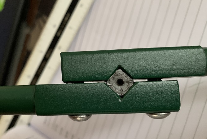

I like to have at least 1/2D left on a side if I drill into square bar, so the initial thought was 2 x M6 to clamp the 2 pieces of square bar together, but a clearance hole in the one side of 6.5mm would have left less than 3mm a side so I opted for 2 x M5. Drill and tap one side and clearance holes on the other.
Bolt it together and mark where the :V would go and back to the mill to machine it out. Several small cut not to destroy my only 10mm end mill.
And after a few coats of paint, I am very happy with the end result. The handles needed to be a little shorter than what ergonomically looked correct, but that is to clear the saddle when I tap using the lathe and tail stock to do tapping. :idea:
Another reason why "MAKING" was the correct decision.
Attachment 34718 Attachment 34719
Stay healthy.

Just seeing this I now know what another tool does in my garage.
Years ago i found a similar tool in a second hand store. Think it cost me a buck or so. Nice job otherwise.
garage nut,
Nice quick way to make a useful tap handle!
Nice! I like making little tools like this. These days you can exceed the quality of purchased imports with no effort at all. That to me is key as a quality tool is a joy to own.
