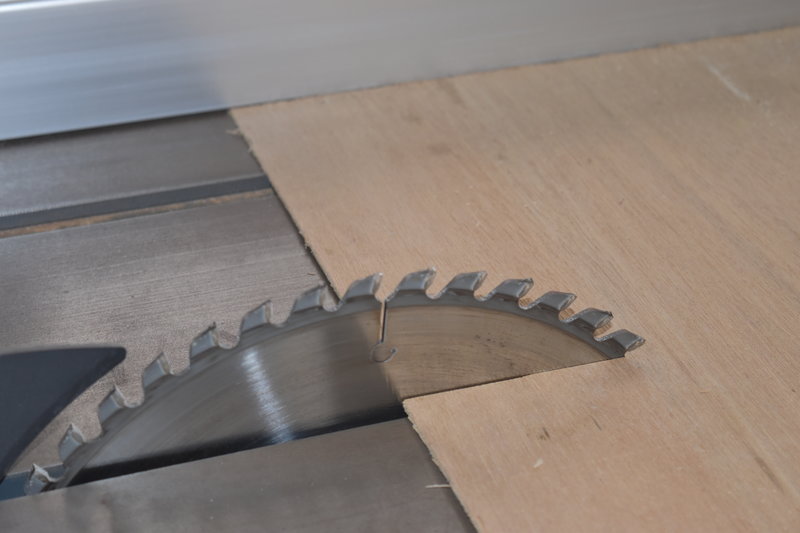

    I really needed a zero tablesaw insert but time was the essence. What if i did the same for that saw as I di for bandsaw.
    I tried it and it worked very well. Simply ran a thin sheet of offcut ply part way through the saw (just before 1/2 way worked for me) and clamped to table so as I could still use rip fence.
