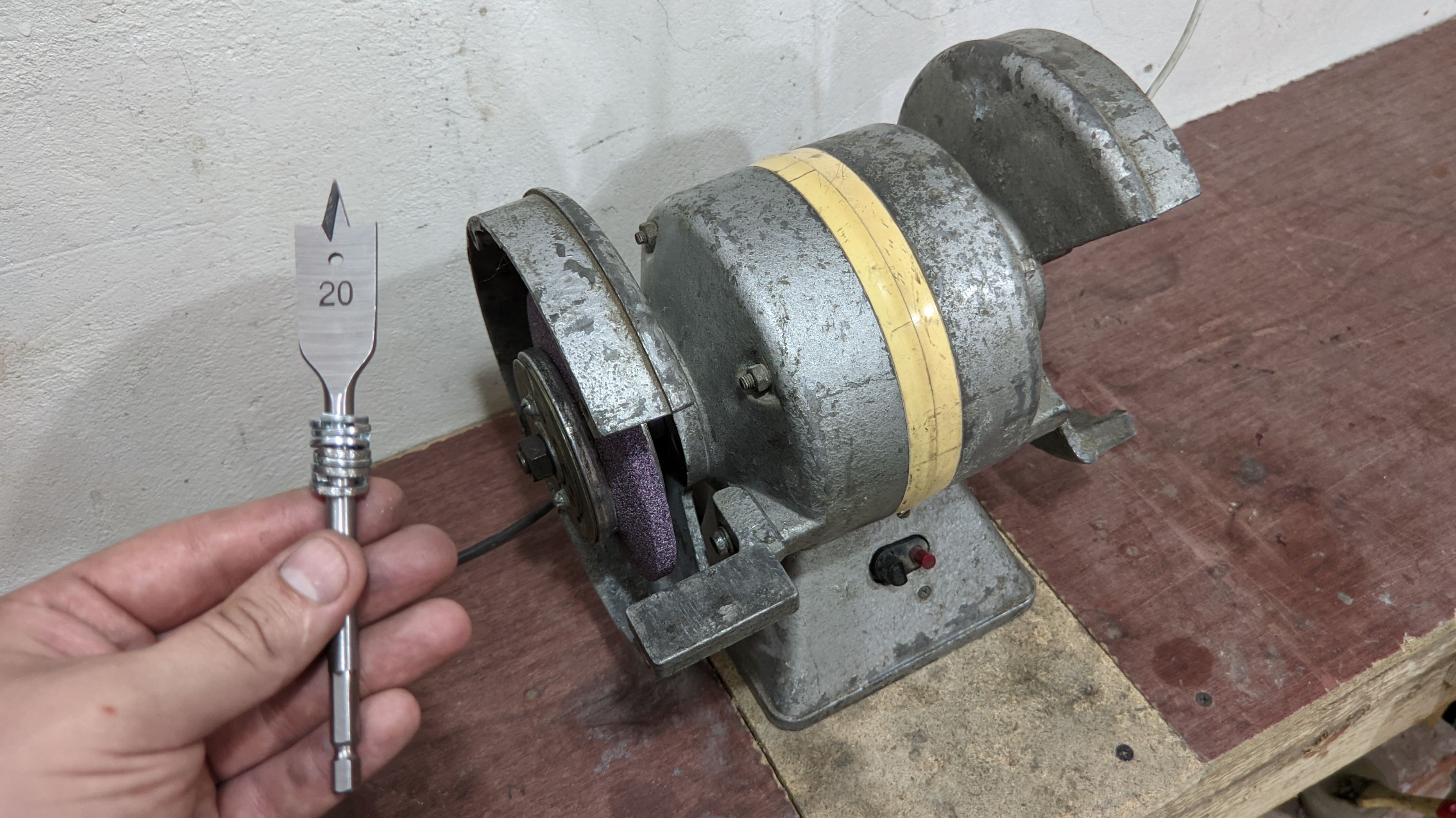

why not leave the white wheel turning under power when touching the diamond disc?
Handy tips. Thanks. Another tool is a broken piece of that dud wheel you replaced. Defective wheels get broken so they cannot be mounted but the bit can be useful for many things.
You don't have to use a diamond concrete wheel, you can use an ordinary grinding stone as well. It gets dusty, but you don't need to turn the grinder off to work, done it many times with power on.....
I think that at the beginning of processing, when the out-of-roundness is large, you need to start this way - I suppose it is safer than running at high revs.
I like the diamond wheel dressing method.
I've used star lock washers to do the same thing in the past when the Desmond dresser was too worn and the boss wouldn't buy replacement disks.
The diamond grinding wheel dressers you can get off of Amazon work really, really good. You can obliterate a few millimeters of stone diameter in just a few seconds. You can pick them up off of Amazon for about $15.
The lock washers are a neat trick. I've never seen that one before.
Brilliant. And especially the lock washers. Basically, you just made a Desmond-style dresser, there, so cool! (I googled a little, and saw another video where someone used a piece of thread-rod with a couple of nuts on either end to retain the lock-washers, rather than just put them on a spade-bit, but whatever.) And love the little 'joggly drill-bit' test-for-true, on both face and sides. This SO demonstrates so many ways of clear, smart, simple thinking -- triumphing over Buying New Stuff. :-)
As tennis pioneer Arthur Ashe said, in a totally different domain, but I love this: "Start where you are, use what you have, do what you can." Good advice for life, but also for the shop. :-) I just love "hacks", and especially when they make me sit back and appreciate good clear thinking. This was just full of them - as well as really good, thoughtful presentation! - so thank you.
And definitely want to reinforce the wearing a face shield (cute how you "put it on" (over the camera)). If you're dressing an old, out-of-true wheel, the risk is significantly higher of it actually having let's say "integrity failure", "mitosis" -- i.e. "experiencing transformation from one to more-than-one piece rapidly" -- at 1725 rpms, towards you.... I supposed I could calculate the rim speed of that for a 6" Ø wheel if I really tried to remember high school geometry, then add in momentum or something for a given weight hunk from physics class, but let's just go with "fast" and "bad", respectively. >;-) Wear yer shield (not just goggles; shield) - unless you think facial scars are "colorful".
