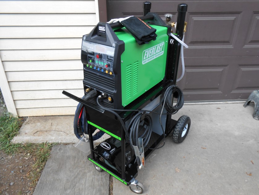

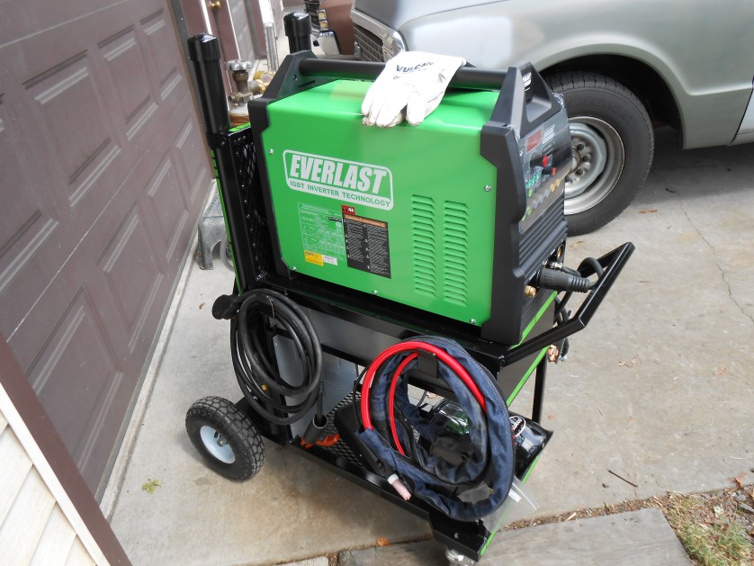

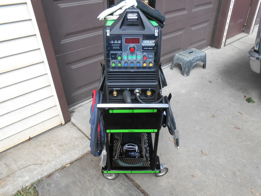

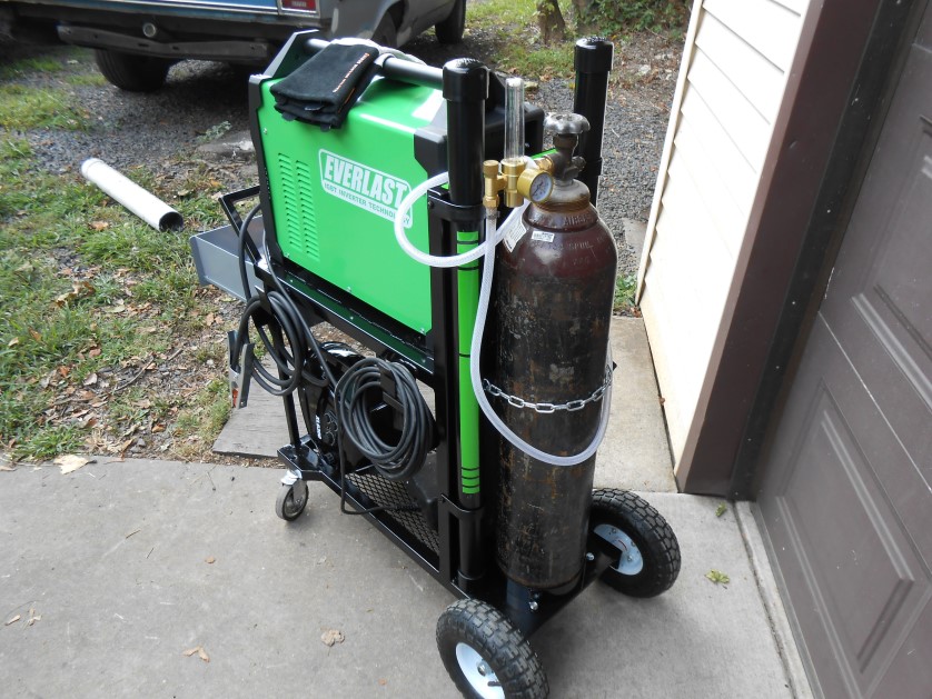

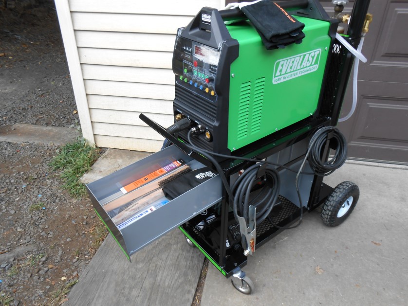

I recently purchased an Everlast powerTig200DV welder so it was time to build another cart. Today I present my Tig welders "ride." :D It's based on the other cart I made here: https://www.homemadetools.net/forum/...798#post140231 for my mig welder & plasma cutter but with changes as needed. It's "tricked out" with green vinyl decals and gloss black paint.

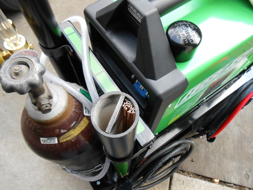

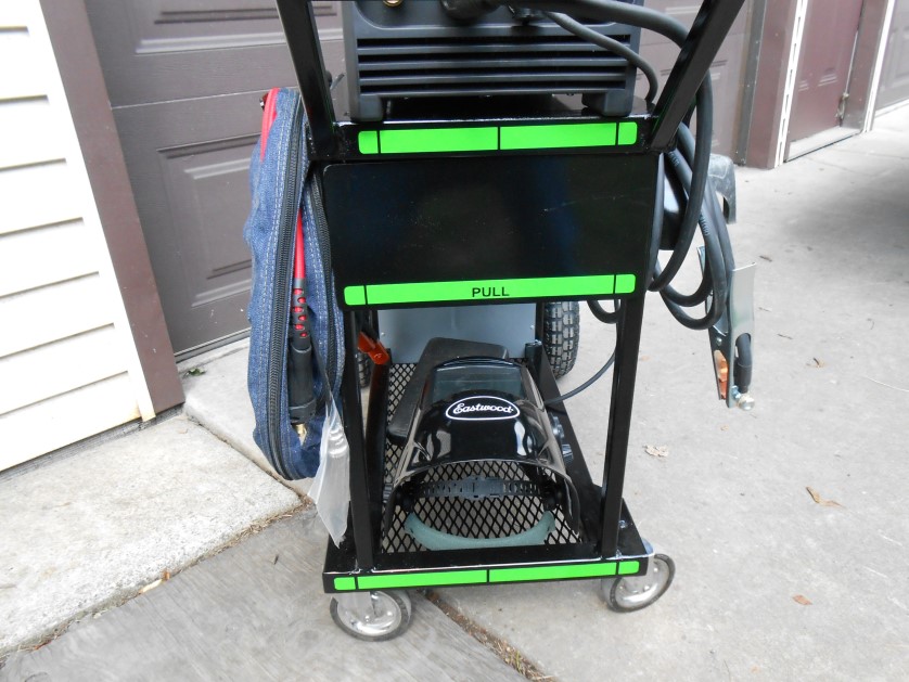

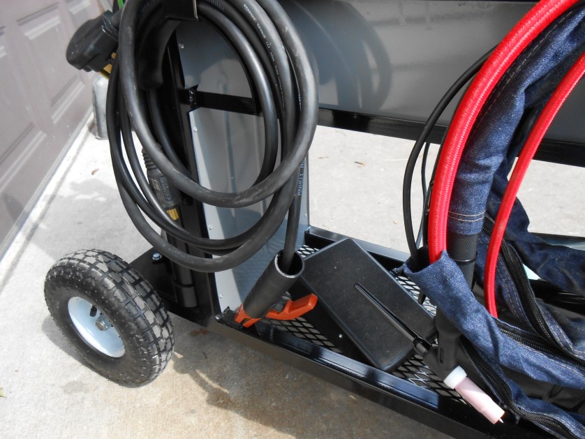

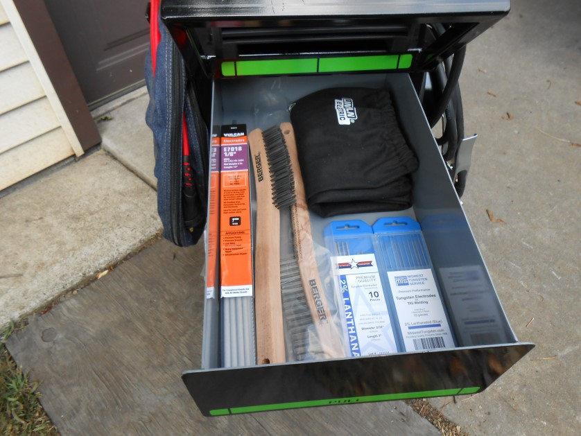

It features an open lower shelf made of expanded metal for the gas pedal and a welding helmet and a nice deep drawer made of 14ga steel for some consumables & various supplies. It also has (2) 1-1/2" PVC pipes or "stacks" on the back for storing tig filler rods. They were painted satin black with plastic fusion paint and they have dividers to store different rods. (can probably hold 7 or 8 lbs or rods each)
Being a Tig welder this cart won't be seeing much mileage except for the odd stick welding task outdoors, it will mostly live in the garage but it's nice to have everything all in one place and moveable!
