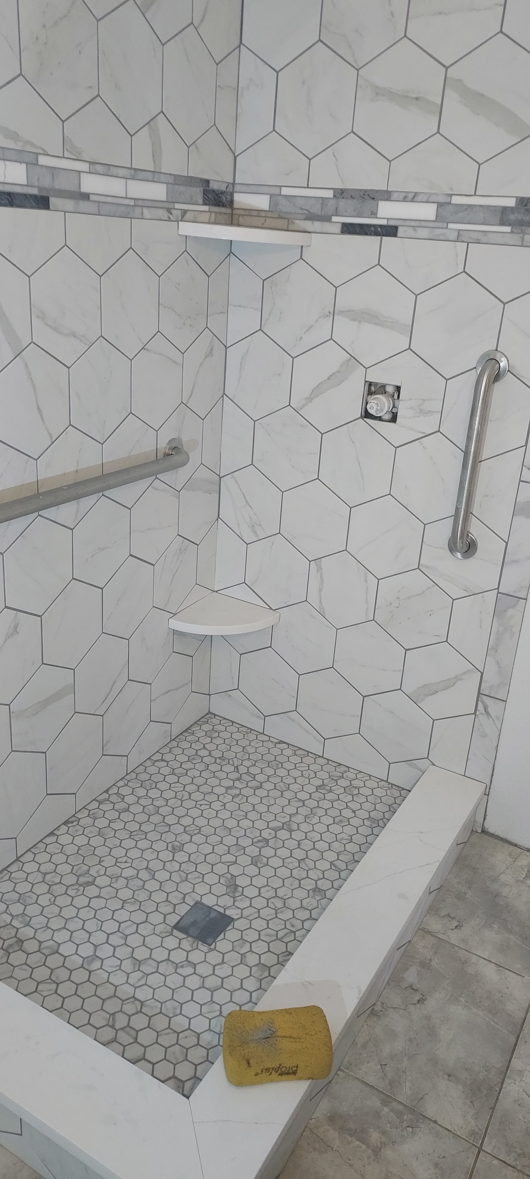

I think the attached will be my last tile job (50+ years is enough)Attachment 46417
