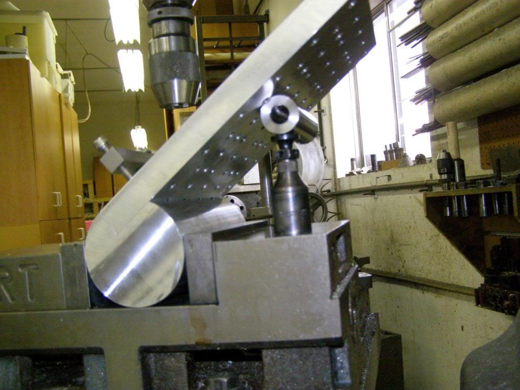

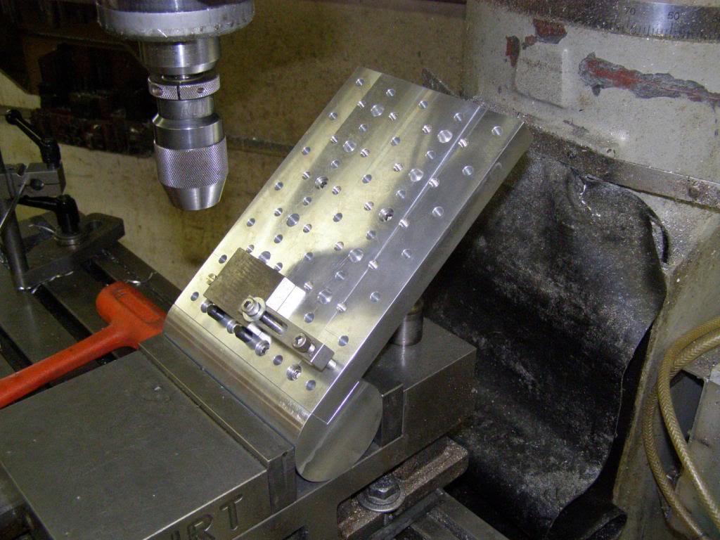

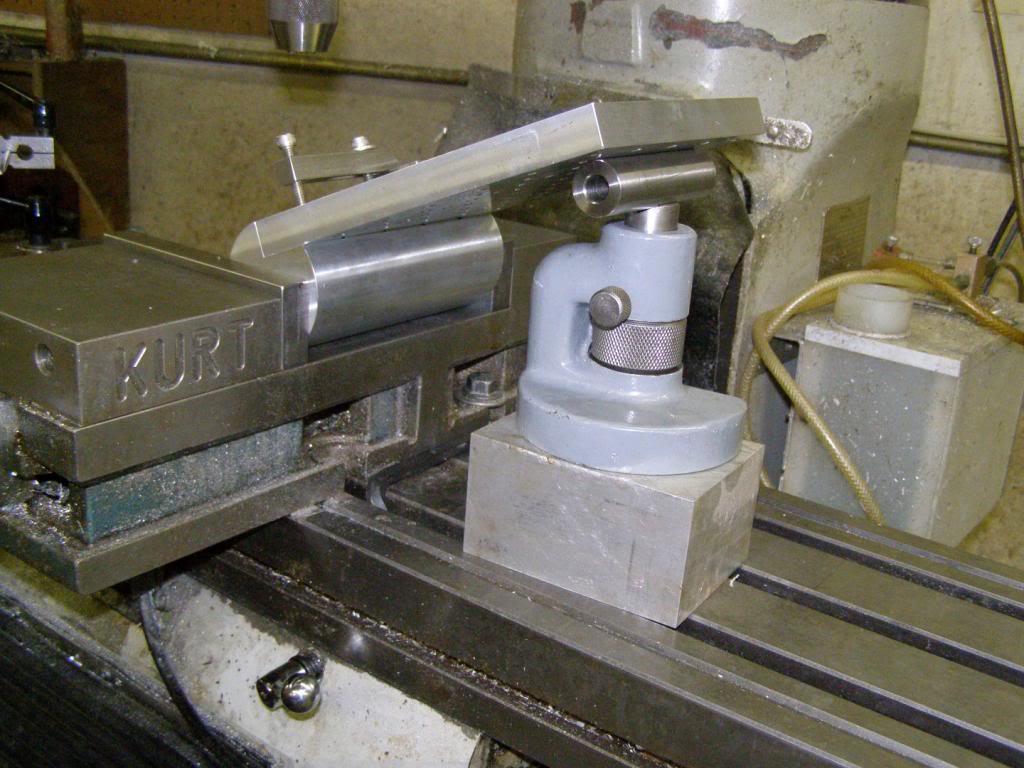

Over on the The Hobby-Machinist forum, a link to this YouTube video was posted, and at 27:54 there is a simple tilt table being used. Several Hobby Machinists posted their versions of this table, and here is mine.
My plate is 3/4" aluminum, 6" x 8.5", tapped 1/4-20 holes 1.25" OC and 0.2505" reamed holes, also 1.25" OC, offset from the other holes. The large roll is 2.725" in diameter. I also added an additional adjustment roll. It is movable in 1.25" increments.
