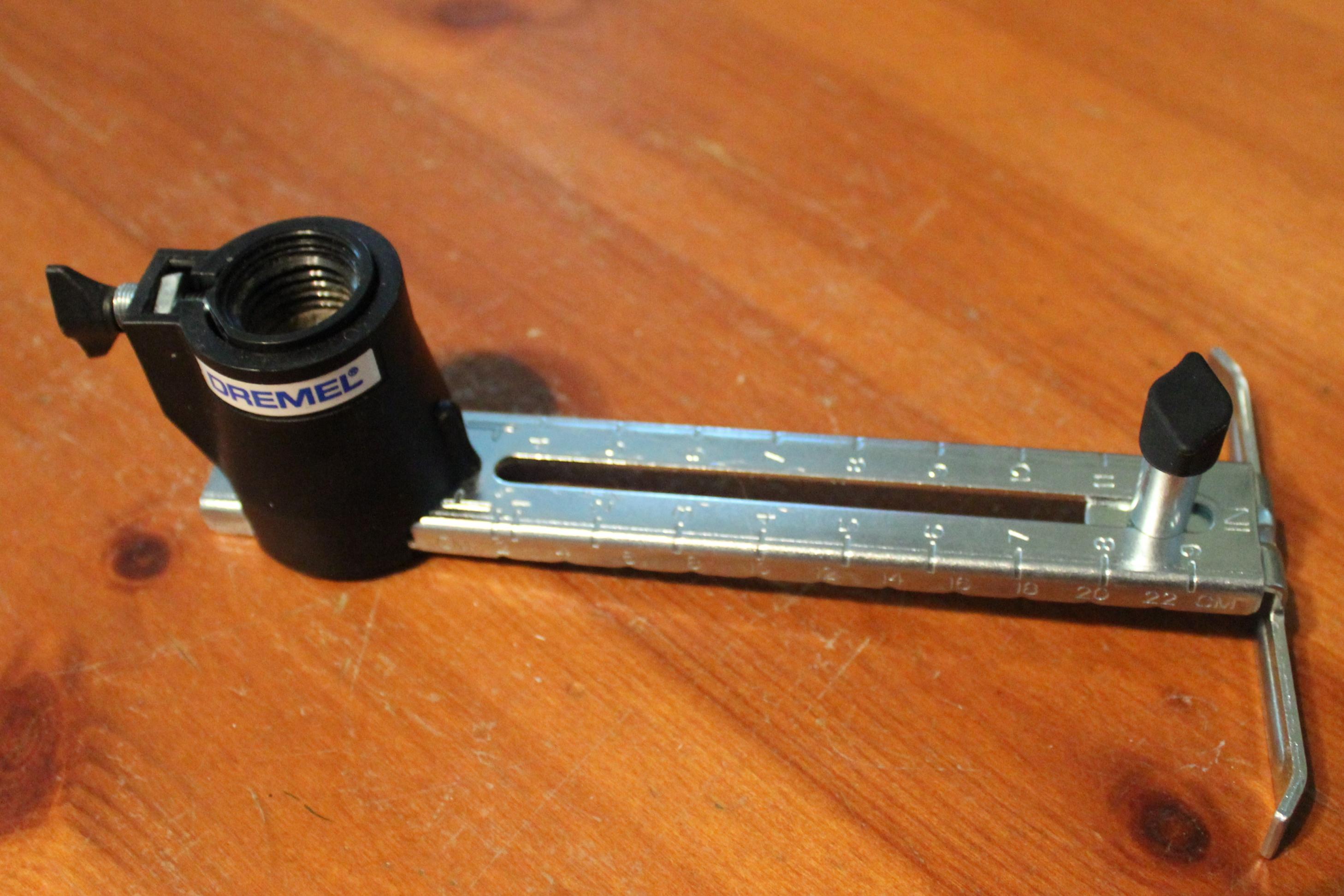

Used Dremel circle cutting guide, i had one spare and it has nice height adjustment, so it made things much easier.
Attachment 11849

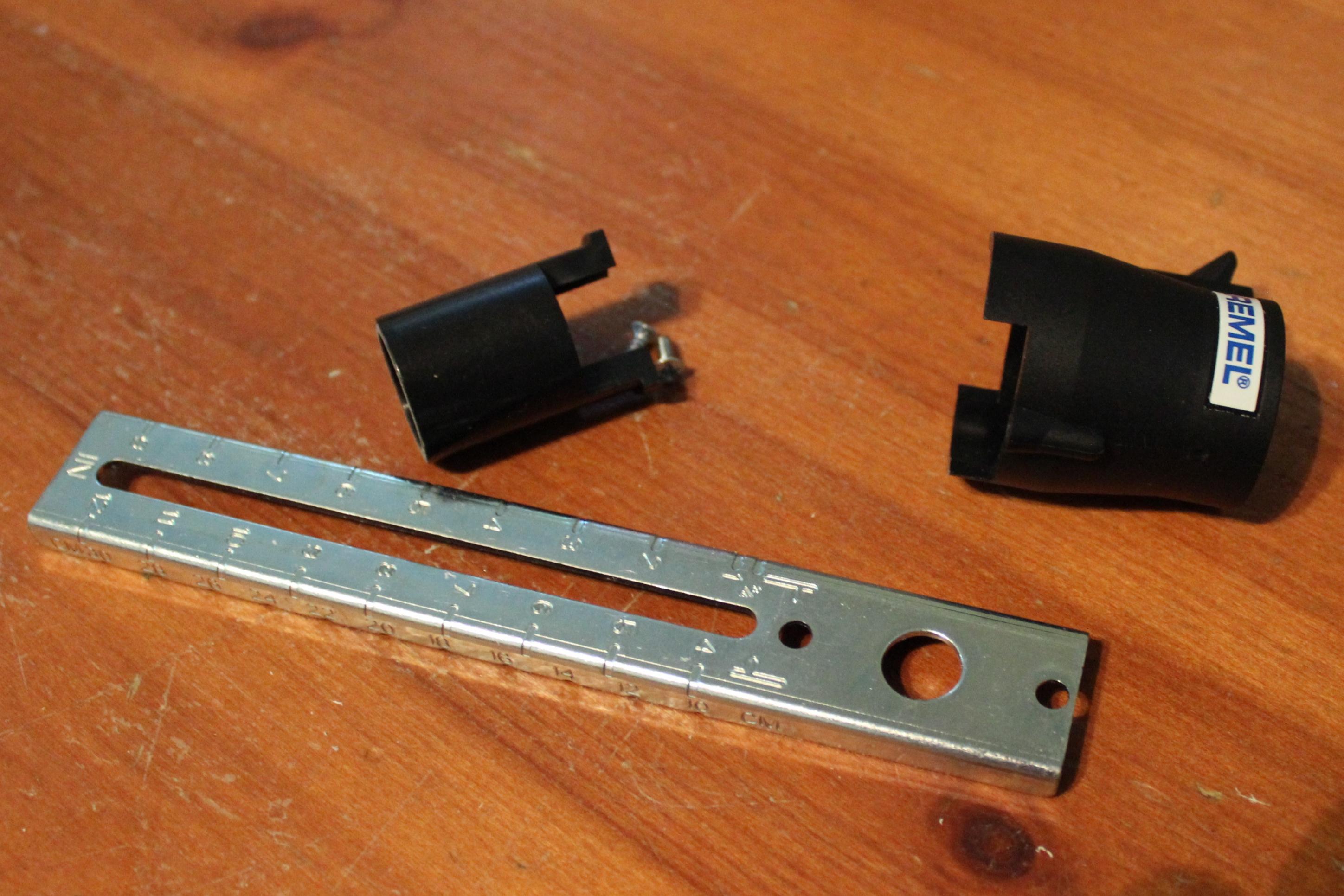

Ripped off..
Attachment 11850

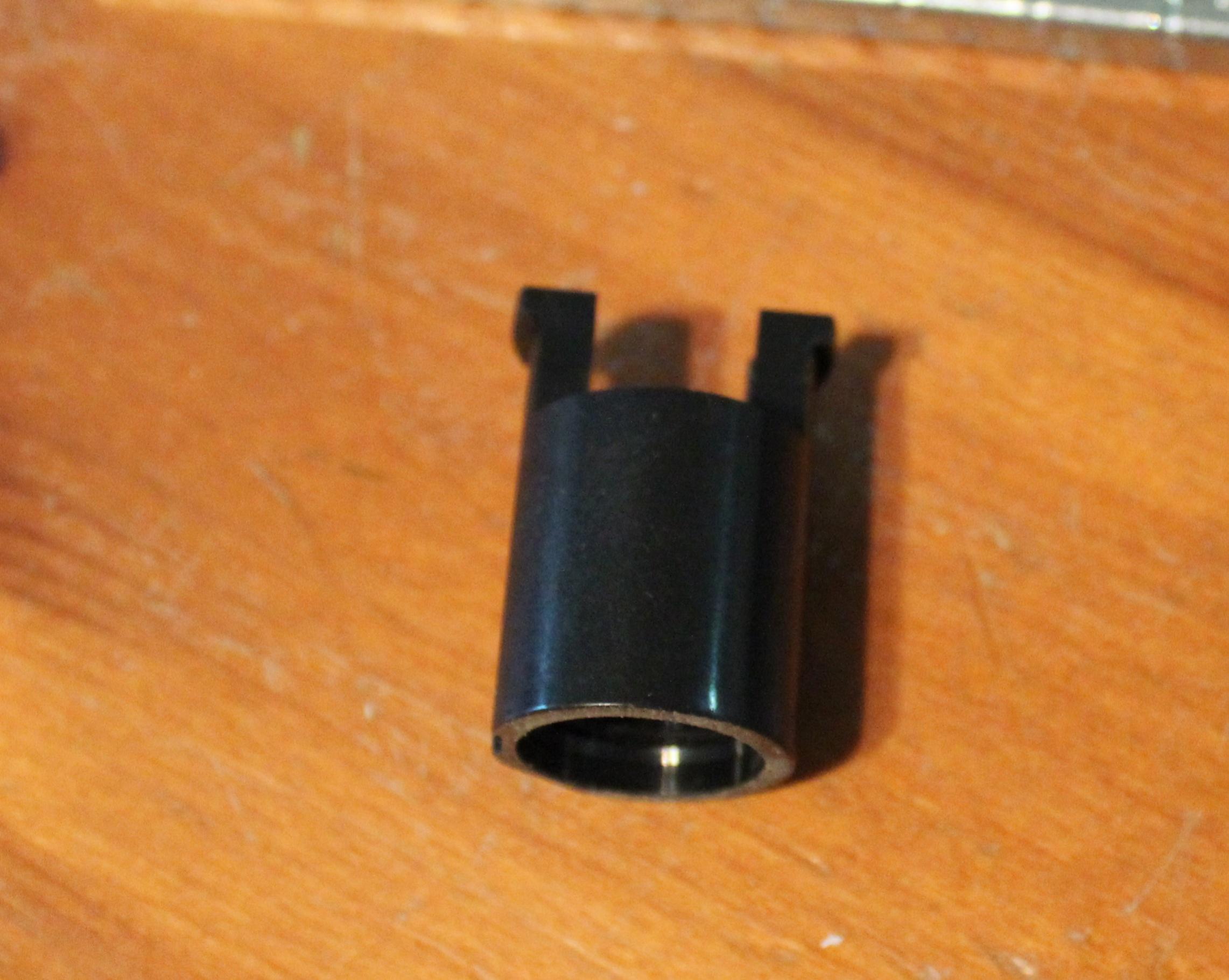

Shortened these fingers a bit to get larger scale for the height adjustment.
Attachment 11851

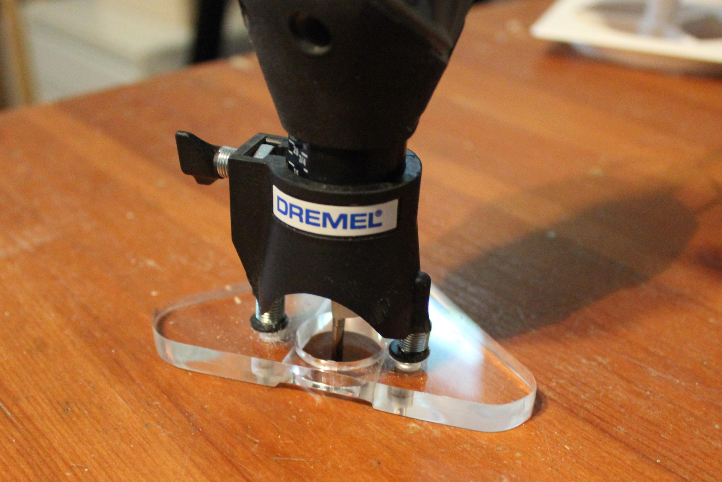

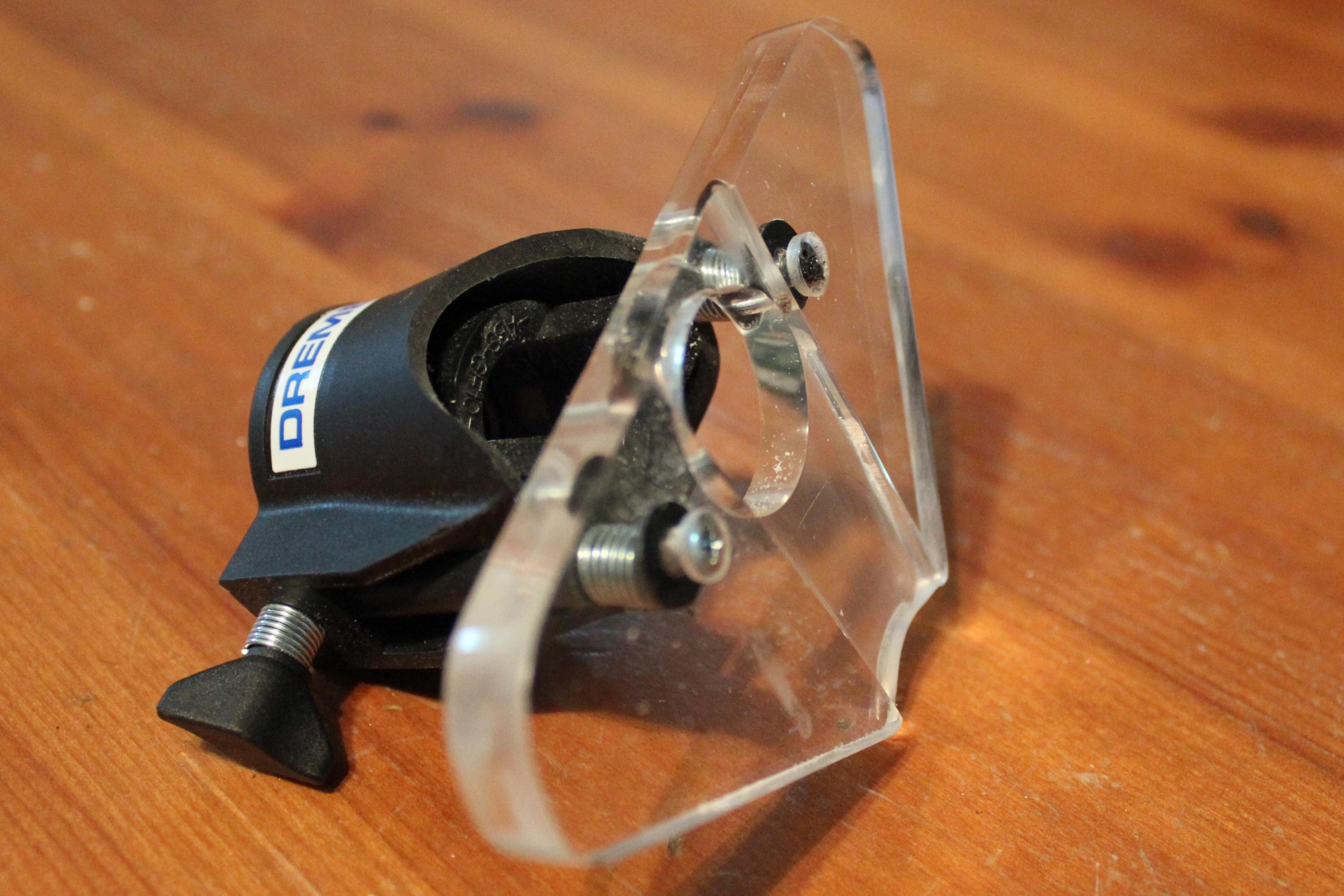

Made the base from acryl, polished it and shaped the original frame to get better view to workpiece.
Attachment 11853
Piece of tape in the routing bit blows the dust away. It actually works.
Attachment 11854

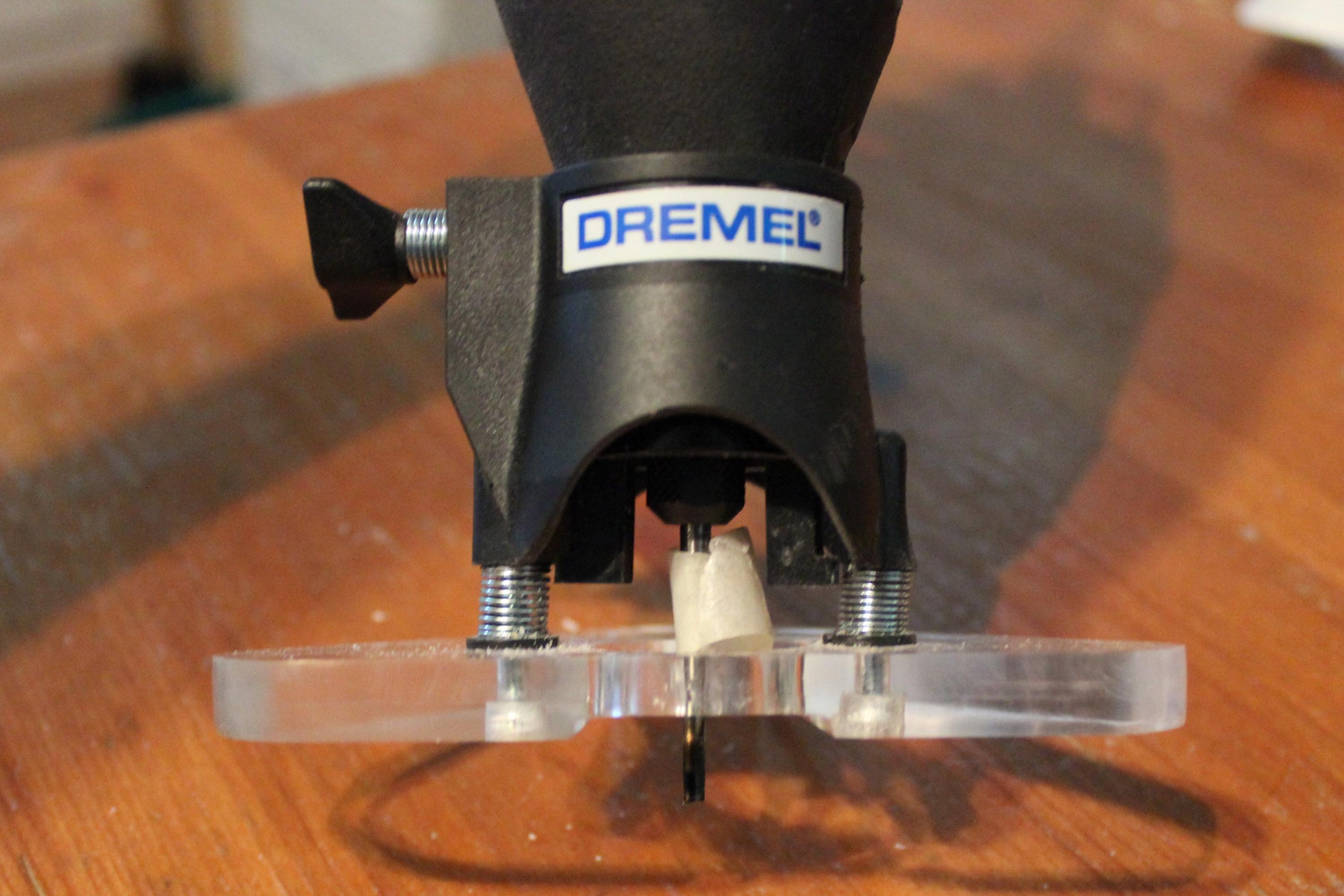

Final product has 1-5mm depth adjustment, enough for most of my doings, and its much more precise than dremels own plunge router attachment. Also very quick to install and remove. I use it when routing details to wood and acryl. It also works with engavings too.
Attachment 11855
