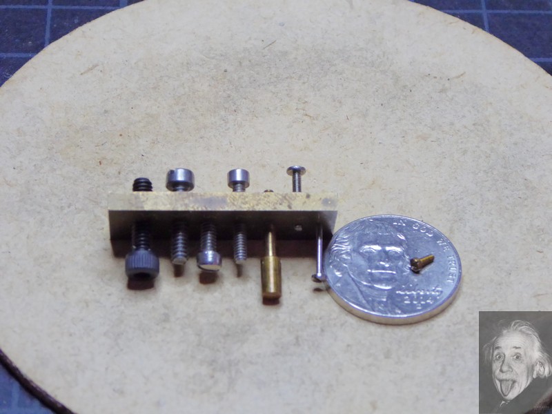

If you make miniatures you certainly don't have to use a lot of material making a thread checker plate. This one...
Attachment 22823
is 1.25" long and covers most of the sizes encountered in my model making. From the left, the threads are:
5-40, 4-40, 3-48, 2-56, 1-72, 0-80, 00-90. The screw lying on the (0.75" diameter nickel) is a 00-90. Missing are the 000-120 and 0000-160, both of which are watchmaker size. I try to avoid them.
