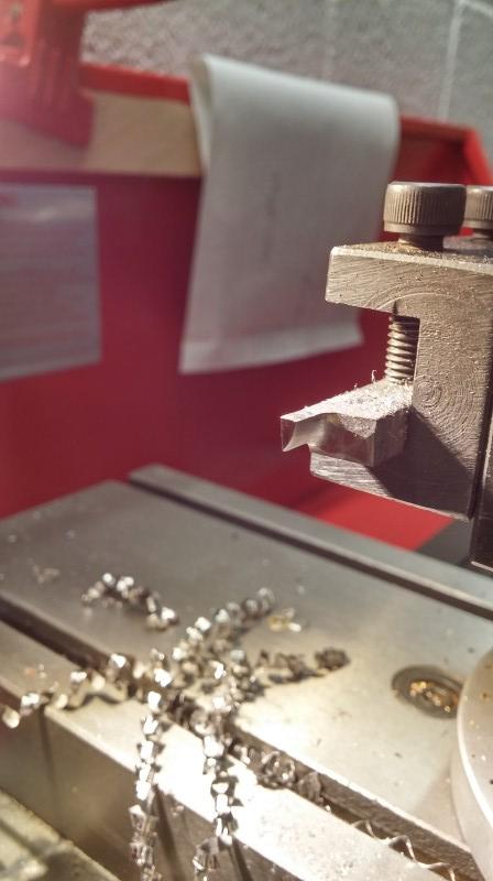

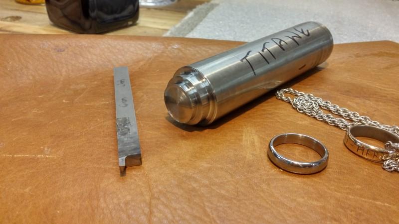

I also discussed with a French colleague who showed me a similar method for cutting the ring without using an HSS drill, but using a purposely made carbide tool.
The tool is used to dig into the end of the stock for cutting the inner part of the ring, and then the same tool is used to part off the ring.
Of course, as explained by Brian, the key to success is to turn at very very low speed !
Here is the tool in question :
http://www.labellenote.fr/file/Metal..._Titane_09.jpg
http://www.labellenote.fr/file/Metal..._Titane_02.jpg

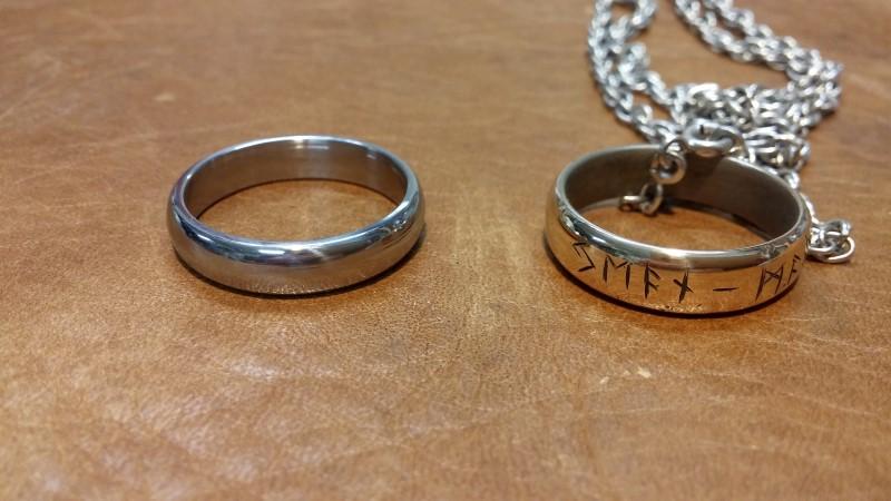

and here are some result :
http://www.labellenote.fr/file/Metal..._Titane_08.jpg
On the left, a titanium ring, on the right a bronze ring (used as a pendant)

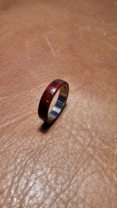

http://www.labellenote.fr/file/Metal..._Titane_11.jpg

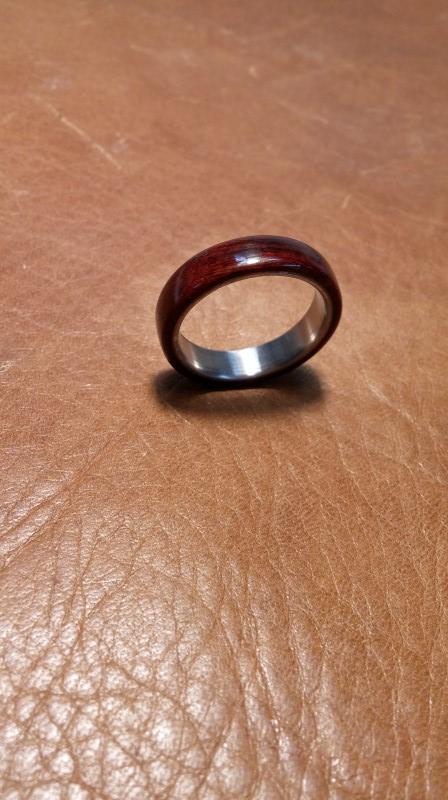

And this is a mixed wood and titanium ring I made for my wife. It's made out of Red sandal wood, finished with CA.
http://www.labellenote.fr/file/Metal..._Titane_12.jpg
