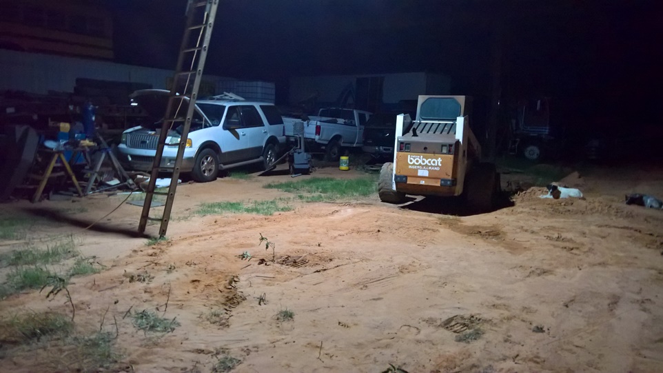

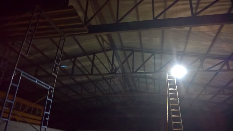

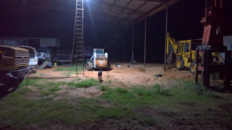

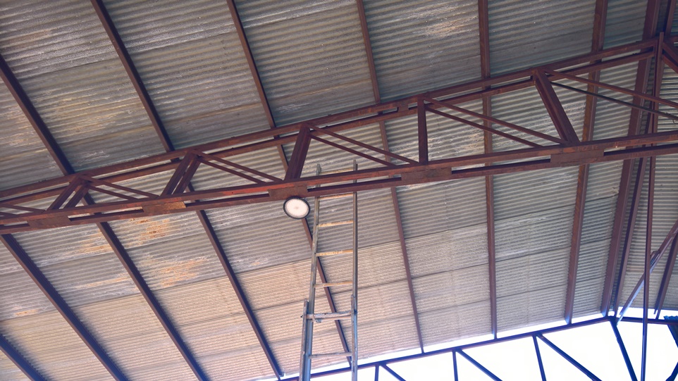

We are on the same page. Few things worse than working with inadequate or detrimental lighting. I have 12' T-8 fluorescent fixtures and a good supply of tubes. Thank you Habitat for Humanity/ Restore! How I arrived at quantity bought? Took an old photography light meter to work, the mall, every shop visited for readings. Those with lighting good OR not enough for machine environments. Then I contacted manufacturer of said lights, they have a PC or CAD program that determines layouts based on room dimensions, intent of work going on, even orientation of the fixtures themselves.
After ceiling goes in, I'll mount direct to surface, preserving every possible inch of headroom, originally 15'8". Makes bulb replacement easier than when they hang by chain [though tubes are just 4']. Thought is to wire them 3-way in 3 separate banks, controlling them from either door [entry & roll-up].
Over the years, noticed certain jobs are not done under light other than incandescent, which are now LED. Typically jewelers, precision assemblers, some types of inspection, etc. Where I have that going on will get augmentation, by secondary LED lighting, suspended from above, and controlled there.
