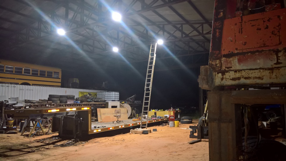

I been in shops that didn't have lighting that good installed for normal use. It's surprising to me that two 100s are giving off that much light.

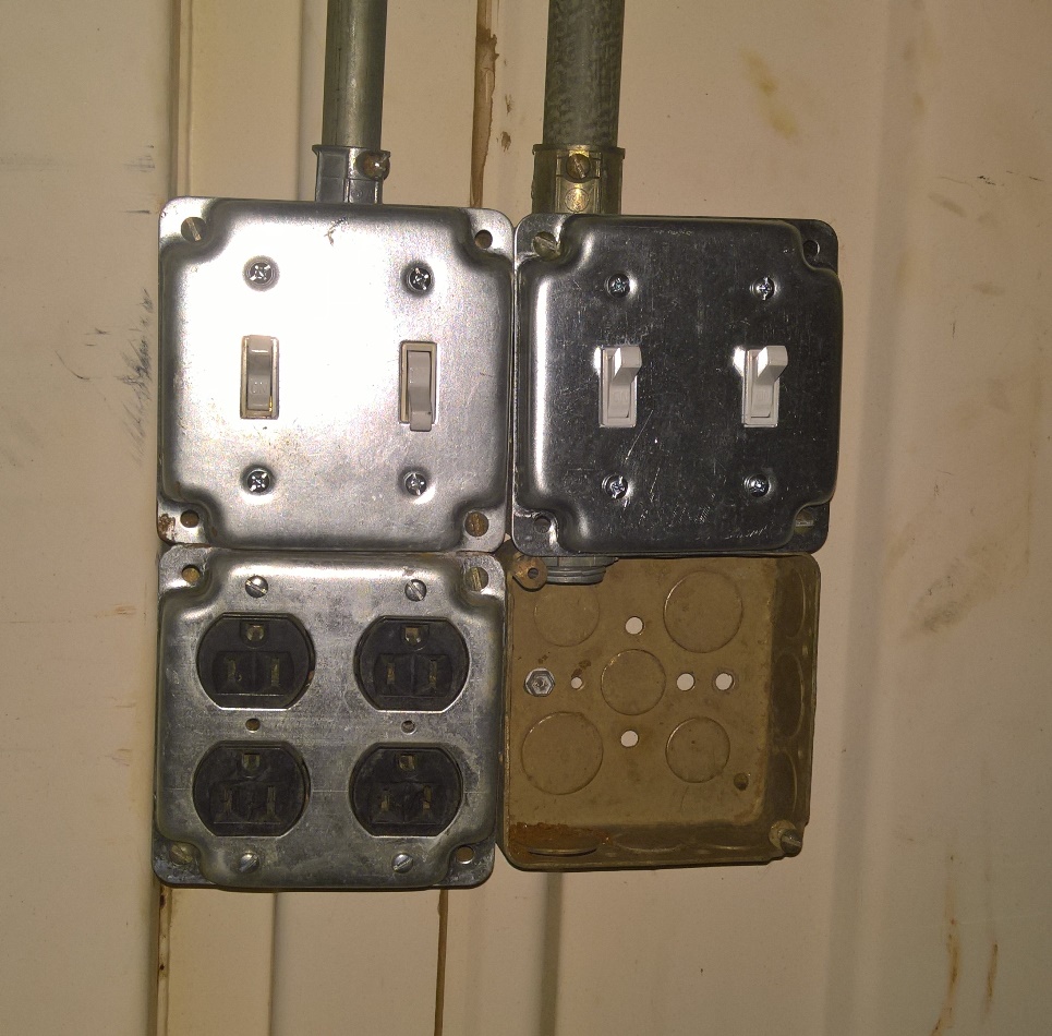

Well I now have 4 lights in my shop completely connected Eventually there will be 4 to 6 zones in the main shop area I probably won't have more than 500 wats per zone.
Right now I have them divided into 2 zones
Attachment 36556
the switches on the left are for the inside of the container one switch will light it up enough to find stuff while #2 will make it daylight
the 2 switches on the right are the first 2 zones in the main shop I ran 3/4EMT to each zone so I can add as many conductors as needed later

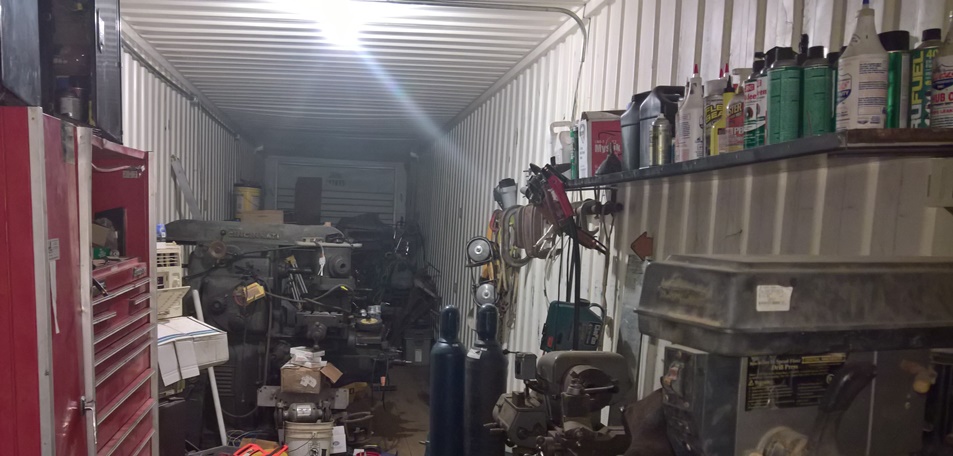

This is what a single 15 watt light does inside the container
