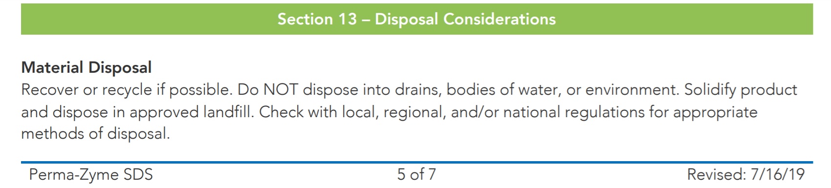

MSDS sez 70% proprietary and 30% water. (also sez "material not to be disposed of in the environment"*...

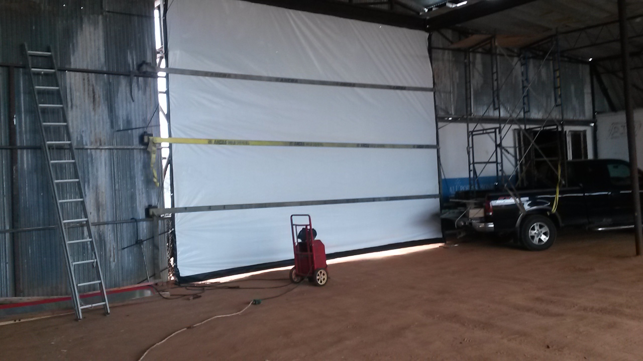

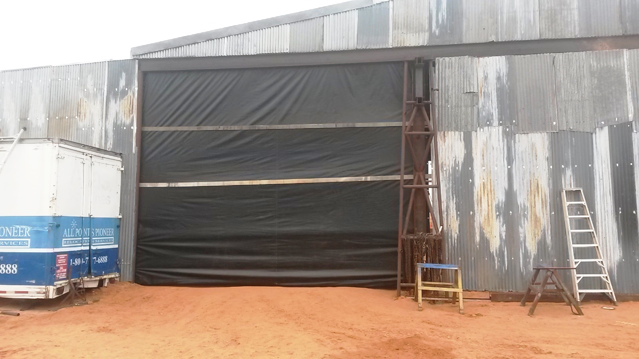

I closed in the East side of the shop yesterday with a section of new billboard tarp.

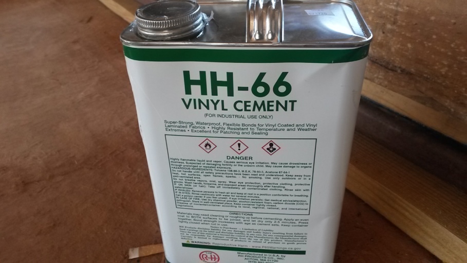

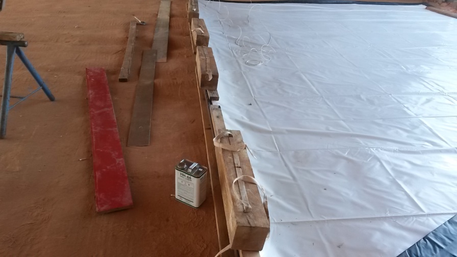

First off I needed to serve off the cut end of the tarp to strengthen and provide a means of hanging I, I started a few days ago by painting a 6 inch wide swath with a special vinyl tarp adhesive.

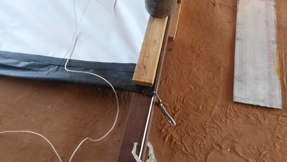

folded that over and pressed the surfaces together then once the glue had set I stretched a 3/16" braided nylon cord from end to end at the center point of the now 3" wide strip brushed this with the glue again and folded that over and pressed that together left it over night. this would become the top of the door. I repeated this process for the 2 sides once those had each cured over night I added a series of #3 sized stainless steel grommets to both sides .
I predrilled some strips of 3/16 by 3/4" flat bar on 12" spacings then hung the tarp on the flange of the header beam by clamping it between the flange and the flat bar then drilled each hole through the flange and bolted it in place using 1/4 20 bolts and nuts. Then secured the sides to the wall by the grommets with rubber tarp straps. Then used 4" nylon load straps inside and outside attached one end to the wall and welded strap winches to an angle iron on the purlins on the other side
it only takes a few minutes to release everything to open the tarp to allow passing through the door and later I will add a pipe in the pocket in the bottom of the tarp and a couple of pulleys to roll it up.
These lightweight billboard tarps are supposed to be rated for some fairly high wind loads, so I guess time will tell at any rate it makes for a simple cheap way of closing off a wide open hole in the wall for now at least.
