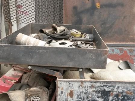

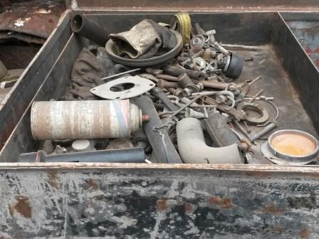

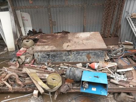

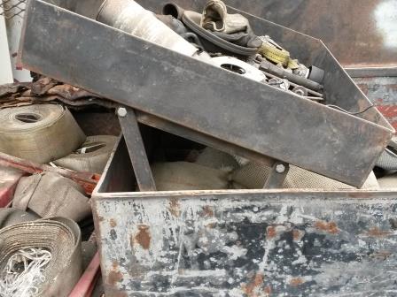

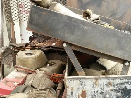

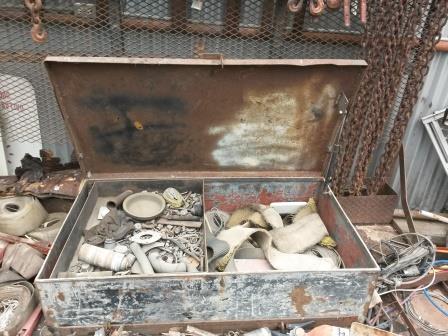

    Another of my few remaining tools and equipment I made long ago.
    Back in the late 80's to early 90's we needed a headache rack on one of our trucks this was what I did
    the headache rack was made with locking bars for the chains binders and below them there was a locking rack for straps. Since the truck had a long wheel base I mounted it on a drone which served as a platform to stand on for retrieving and replacing the load binding equipment as well as a mount for the tool box. in the tool box I made a tray which could be lifted up and clear of the box allowing clear access to the bottom of the boxTool box drone headache rack and lift out tray-20161007_151618c.jpg Tool box drone headache rack and lift out tray-20161007_151634c.jpg Tool box drone headache rack and lift out tray-20161007_151701c.jpg Tool box drone headache rack and lift out tray-20161007_151723c.jpg

    Nice one Frank. I love the idea of those kinds of hinges but they are tough to lay out. Did you do it through experimentation or CAD? Or have an example laying around? Those kinds of hinges like on hoods like what I've seen Astro make are cool but a mystery to me.

    C-bag that was done with a COC program, (chalk on concrete) a good 8 years before I even touched the keyboard of a computer and 10 years before I got my first computer with Solidworks 99 installed.

    Those are called 4-bar linkages, and while a CAD program is helpful, it's not necessary either. As Frank S. states, he uses Chaulk on Concrete. I like to draw on the steel table with a whiteboard marker, and then use cardboard and thin wood strips with stick pins to simulate the movement. The length of the arms, and position of the holes is critical to determining the actual movement and final location/orientation vs initial location/orientation.
    The simplest 4-bar linkage is a parallelogram, gives fairly parallel movement within reason. There are specific names for some linkage sets, and has to do with the length of the arms and how they are arranged. You can read a lot more about them here: https://en.wikipedia.org/wiki/Four-bar_linkage
    Do a simple experiment, and cut out 4 cardboard strips about 1" wide, and 6" long. Anchor one of them to the table top, this is your base or ground link. Then place a link on each end, these are called Crank and Rocker, and use stick pins to make the pivot. Now add a top connecting link, using 2 more stick pins, and now you can hinge it back and forth. If you kept everything spaced evenly, you will have a parallelogram linkage.
    Now shorten just one of the links by 1/2" and see how it affects it, start with the Crank. Now you have a crude model to test and learn, and determine what you want. Small changes can have big effects, so watch out!
    I will often do this before I go to CAD, and then after I've modeled it in CAD as a final verification.
    If you have an existing 4-bar linkage, based on the length of the links, equations will tell you what type it is, and predict the movement.
    Many car hoods and trunk lid "hinges" are 4-bar linkages.
    Hat's off to Frank S for making a nice example of this with his tool box tray, you can see that he put a dog-leg in one of the links so that it clears the top edge of the tool box.

    Thanks Kent. I particularly like the cardboard/stickpin approach. Those are things I have readily available and should have been an obvious choice to model 4 bar linkage with. I often let the fog of war/just want to get 'er done get in the way of proper planning.
    When I let Frank's 4 bar linkage just sit I could see the apparently simple parallelogram but the crook in the back pair threw me. What's really intriguing though is the way that crook raises the leading edge of the drawer to clear the side, but makes it end up level and the crook ends up being the stop. I'm always drawn to simple genius.

    If you look at pic #3 where arm goes over the edge of the box there's a bend in the bar link there. Just barely visible.
