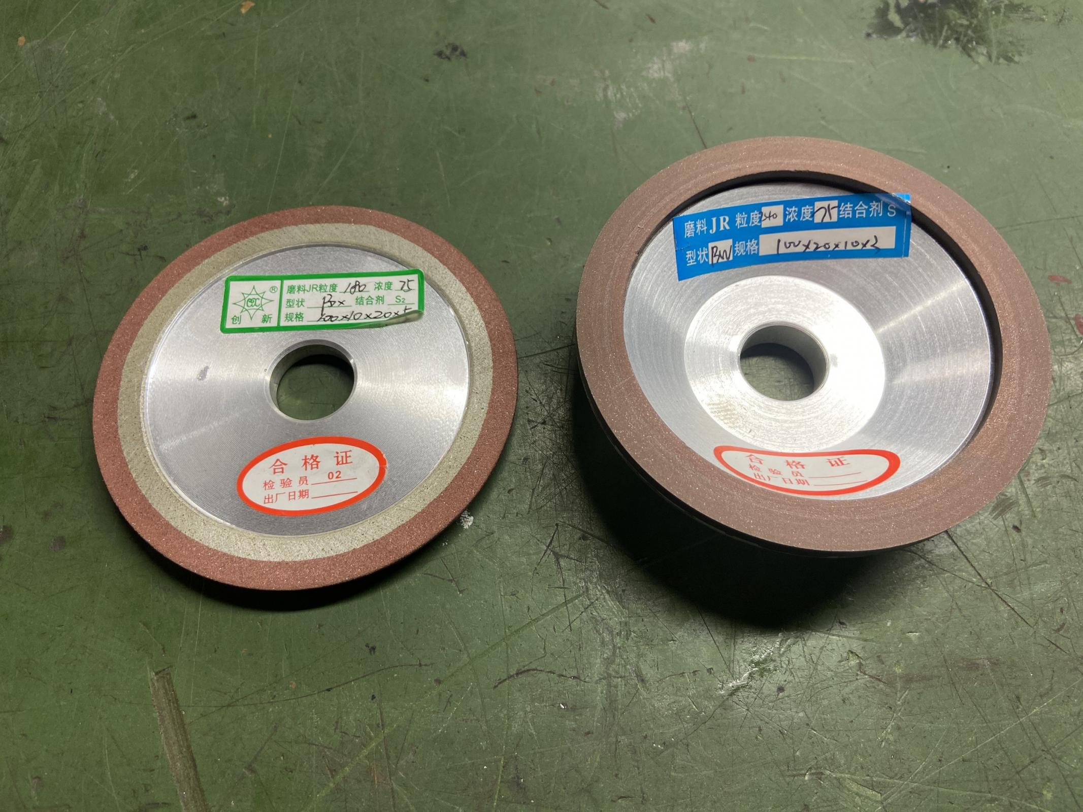

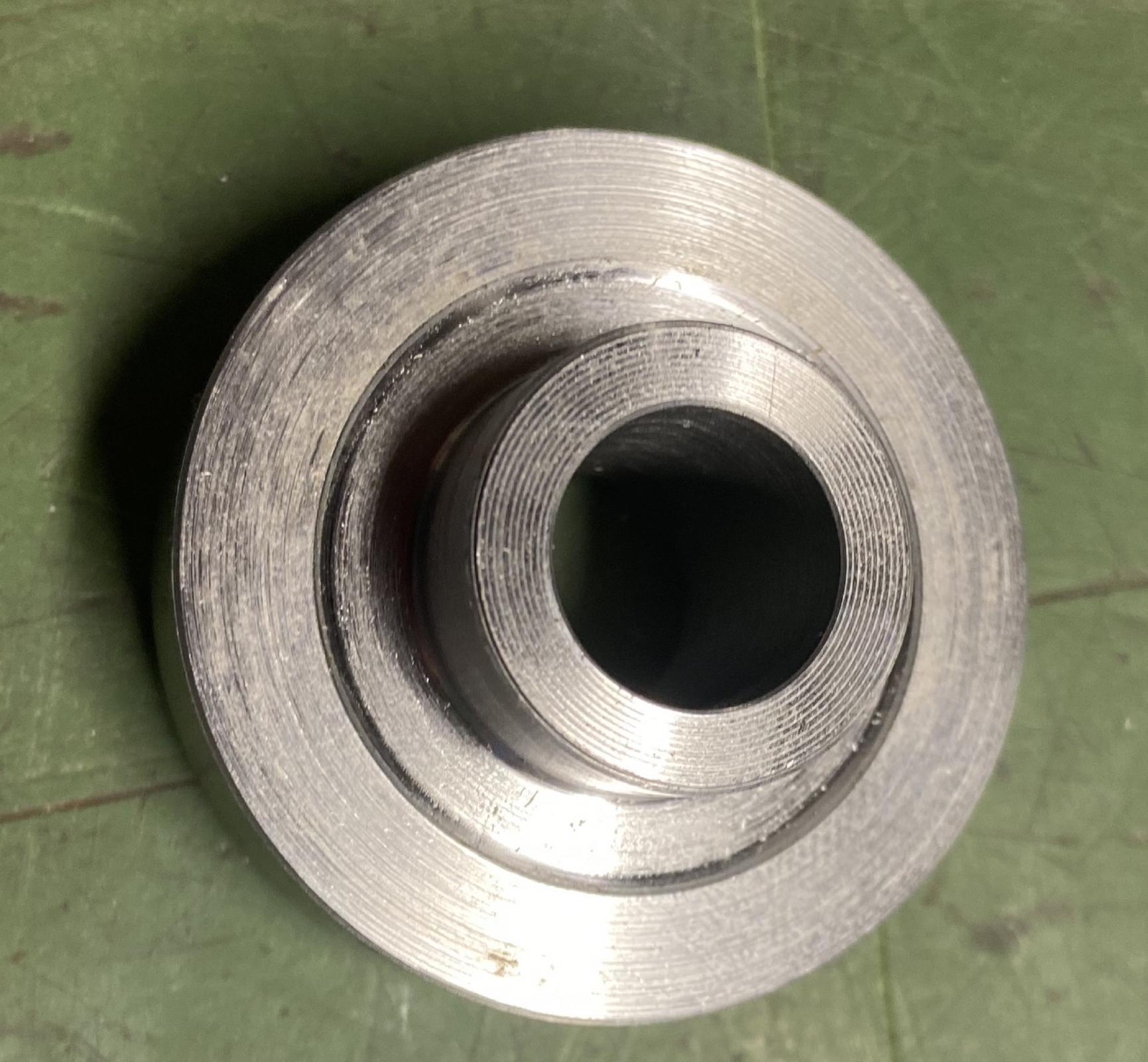

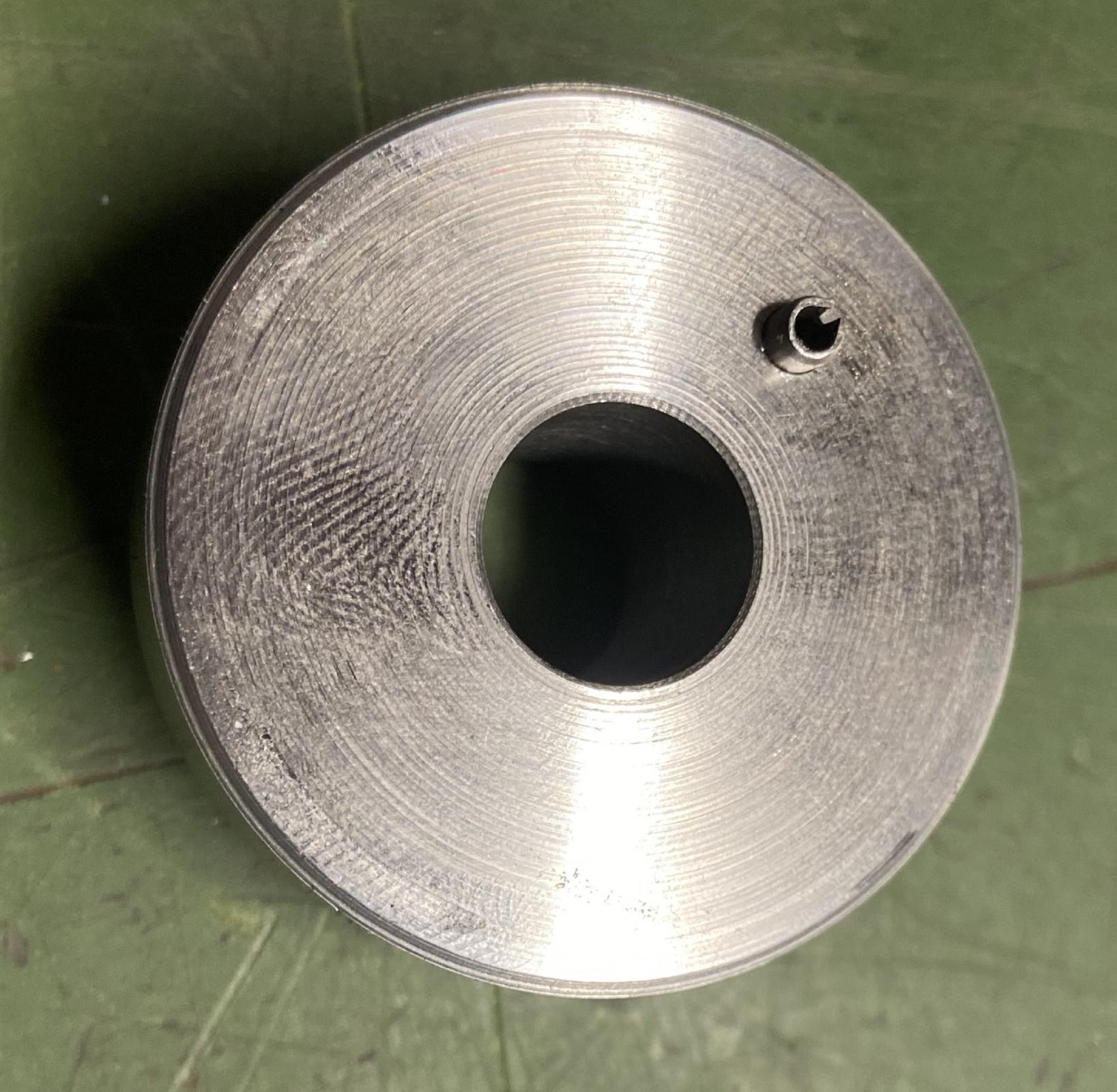

Hi All
I bought some cheap diamond stones from China for my tool and cutter grinder but they are supplied without plastic bushings. The wheels are 20 mm diameter and the grinder shaft is ½”. I have been working on a project which needs some special cutters making, so at last I have had to make a bushing so the wheels can be mounted on the grinder. I could have sourced and purchased some but a 20 minute job to make one from steel I couldn’t see the point.
This is a very simple turning and drilling exercise and will last.

Photos below show bush and grinding wheels
Attachment 33610
Diamond wheels
Attachment 33611 Attachment 33612
Front and back view of bushing

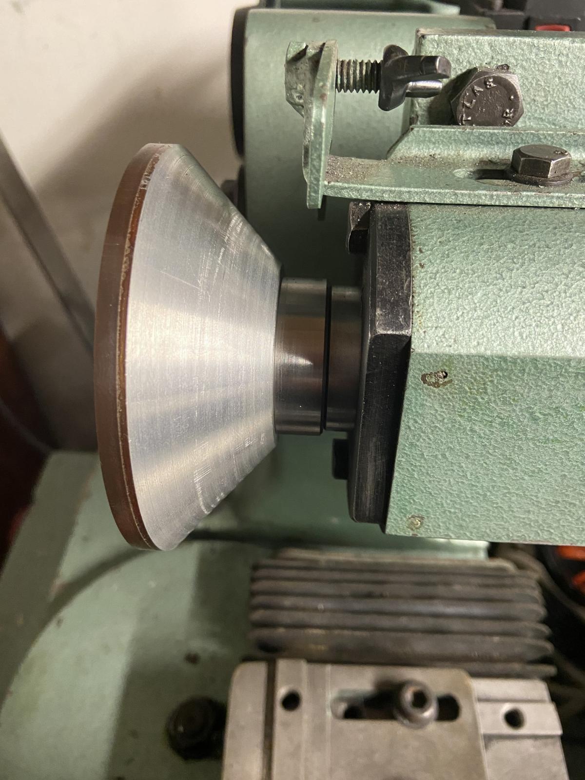

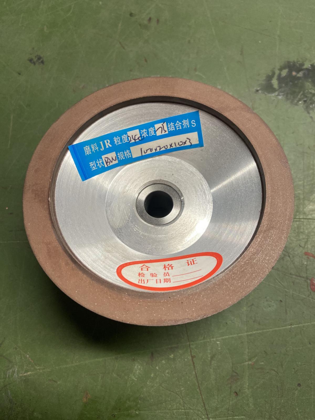

Attachment 33613
Wheel mounted on bush
Attachment 33614
In place ready to use
